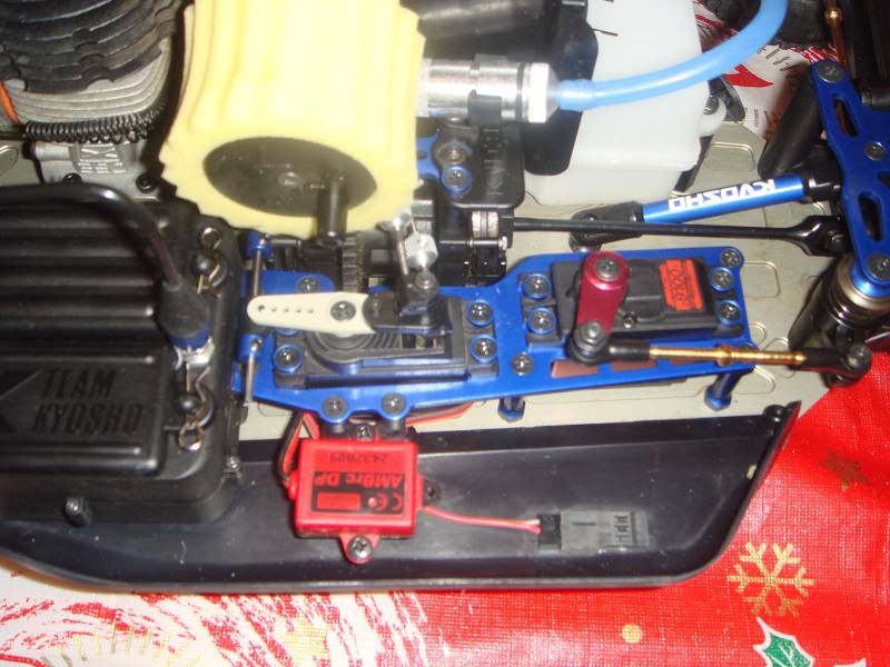

Default RE: Required Servo Torque
im runnin a airtronics 94758 for my throttle at 122 onces i think at .06 and a jr 9100t for my steering at 370 ounces.
