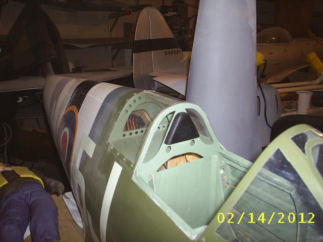

I use good ole color match rattle can primer from Wal-Mart at $1.12 a can. I spray it over the tape, give it a light sand and pull the tape with great results.
Jeff
