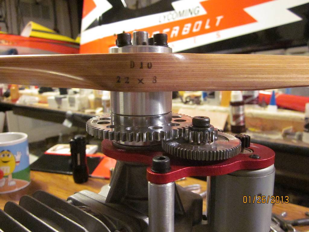

First CA the snot out of the holes in your prop second but a dab of Blue locktite on the prop bolts if it is a new prop check the bolts tightness after the first couple of flights and retighten as needed, problem solved , the problem is that your props wood is compressing thus the bolts loosen, follow these very simple instructions and once the set up is broken in your problems will be over until you perhaps break the prop then it begins again , harden the prop holes with ca and then retighten the bolts after the first couple of flights and it will stop and become very much dependable, there is no need to convert to a single prop bolt when you tighten a metal mechanical fitting against a soft wood surface it will compress against the load unless it is hardened with CA to stop the woods compression against that load, if you harden the prop holes it will only compress to a certain point then stop just like how a motorcycle chain will stretch under load to working tolerance and then stop. just my .02 but it works 3 plus years on the same prop and no failures to date ya gotta look at it as if what kind of scrutiny would I give it if my ass was sitting in it.
ORIGINAL: hellcat56
At our field
We love the DLE 55
BUT
several of us have converted the prop adapter to a single bolt
which after a while are breaking the bolts that hold the adapters on
Does anyone else have this problem with the prop adapters
we have use adapters from two different sources

Maybe i am missing something... wouldn't be the first time. Once the first bolt is through the prop, through the spinner backplate and started into the engine hub all the others should be lined up.

change out the bolts thay look like grade 8 but thay are not broke all on my dle 111
Yeah, I think you missed the issue I'm describing, or I'm not explaining it right,
see picture of the spinner type the OP is referring to.
http://www.gabahobby.com/produto/e0c...625bacf0_2.jpg
Each prop must be drilled to aligned with the spinner slots and the back plate at the same time so it fits the slots. The only way to do that is how I described earlier or make a jig that will drill each prop to match the spinner back plate. The OEM drill jig in itself doesn't achieve that, those just align the 4 or 6 holes.

I still don't see the issue.
You jig drill the spinner backplate with the same drill jig as the prop, or drill a prop with the jig then drill the spinner backplate. You only have to drill the spinner once unless you dork it.
I mean, they aren't like the plastic spinners with alignment tabs, as long as you have four holes it should work.

It's exactly like a plastic spinner's alignment pegs,, but it's the screws that hold the spinner to the back plate instead

Well ...I, for one, understand what you all are saying. Once you establish the relationship between the multi-hole prop bolt pattern and the location of where the prop blades exit the spinner, you must maintain that pattern/relationship or you will not be able to put the spinner back on and have the prop blades center in the cutout openings in the spinner. If you drill the bolt pattern in the prop off location the spinner will not fit. You MUST maintain the bolt pattern relationship between the engine,prop,and spinner.

I understand what you are saying... you are using the adapter... we are all saying ditch the adapter and use the engine as designed. That is the solution. The one bolt prop system is allowing the prop to work the adapter loose causing a failure.
If your back plate has some sort of alignment issues, I would change to a different spinner also. It is crazy to need four attachment points to secure a spinner.

In the past, Iv'e had a DL50 and a DLE30 with these adapters. The main reason I converted was because I had multi bolt props shear off on the ground and in the air! To SAFELY install multi bolt hubs is to have a torque screwdriver so all the bolts are the same torque. The adapter MUST fit absolutly flush to the engine hub, no tiny burs, etc., then the screws need to be a higher quality and red loctited in with a good inch pound torque wrench. There is really no need for all these holes drilled in the prop hubs, it just weakens the center of the prop. If a single bolt hub comes loose the prop just spins free but the whole thing doesn't nessisarily come off. The BME 110 extreme used a single bolt hub with no problems.
