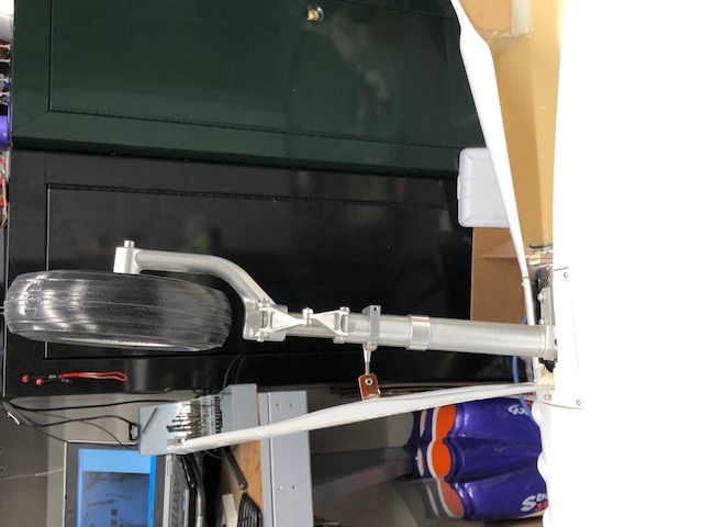

The gear are sierra. They really look nice and almost a straight drop-in install. some sanding of the rail mounts and sides, but that was about it. CARF did a great job adding the CF support to the inside of mount aera at the factory. the whole mounting of the gear is really solid. As recommended, had to cut a notch out of the gear mounting rail, since it interfered with outer door hinge, taking away one screw hole on the gear.

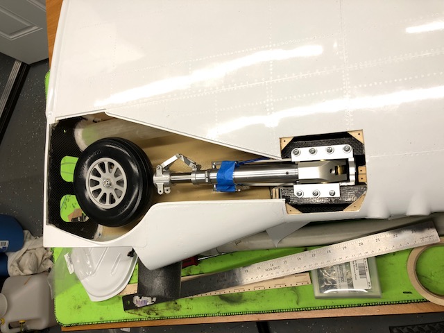

Installed inner and outer gear doors and added the inner door cylinder. I like the CARF design of not having the hatch for the flap servo. It gives a real clean look on the underside of the wing. Just added a nylon spacer so the wheel to be more aligned with the strut.

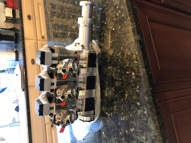

The engine showed up today. All I can say is WOW... I understand now why the attention to aft weight is required. Heavy engine... It is much larger than I thought it would be. Below is a picture of the IL-230 next to my Moki 300cc.

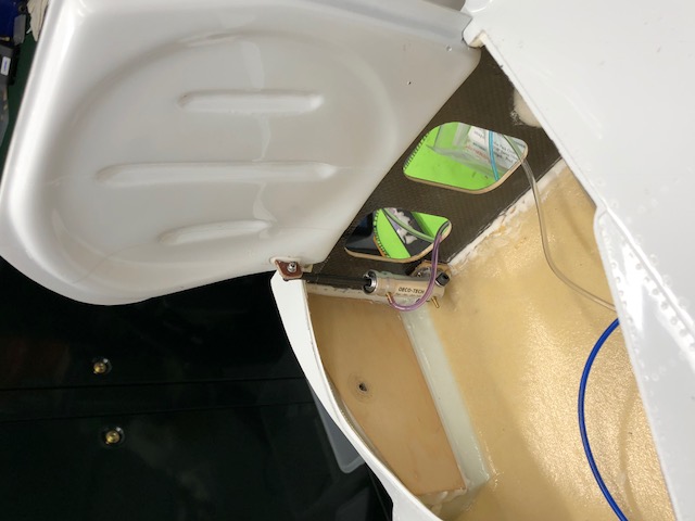

Had time to work on the GG. I decided to take a few ideas from folks and I placed air valves for the doors and gear inside the wing along with the air tank. I then built two small boxes that are recessed into the wing surface. One for the gear valve and one for the tail wheel airlines to connect when assembling. I decided to use a JMP high volume air valve for the gear. Old school, but I never had giant scale gear hang on me. I used a Xicoy e-valve for the inner doors that I installed into one of the wheel wells. Suggestion from CARF's photos they sent. When the wings together I think it's a nicer and cleaner look on the out side and easier to attach wings at the field.
Also have just one connection for servos for each wing.

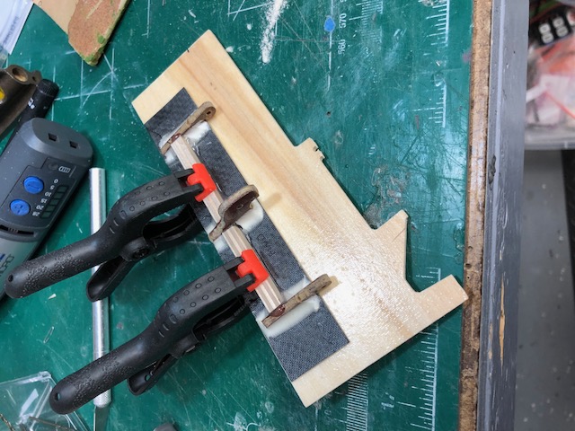

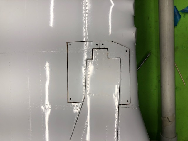

The rear gear doors really had a large bow in them, almost 5 mm in the center. So I cut 2 plywood strips for each door and epoxied to inner part of the door. It really stiffened them up. Now the doors closes nice and flat. I'll then sand and paint the inner part for the doors.

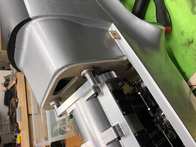

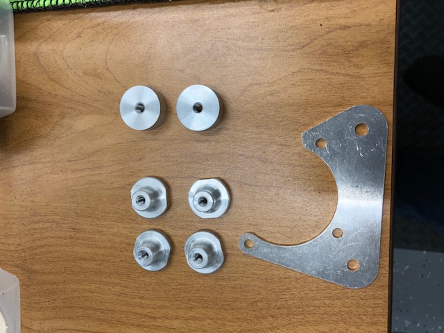

Received the kolm mounting hardware. They sent 4 standoffs and a front mount bracket to support the engine. The 4 standoffs will need to be drilled 6 mm so the threaded 6mm bolt will slide through. They were not specifically design for this and had different threads on each end. So, obviously that won't for this setup, without boring them out. . I then drilled ( 5.5 mm) and tapped the four mounting holes on the engine. The 6mm mounting bolt will push through from inside of the firewall and thread into the engine.

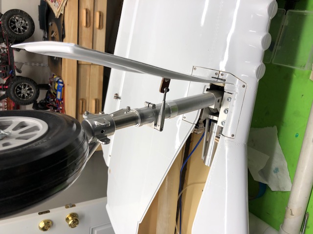

Set up plane and ran a gear test. I shorted the sequence by 1 second between the inner doors and the gear cycle then what's in the video.

tail wheel test. this was before I straightened the doors, so they look a little warped in video

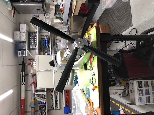

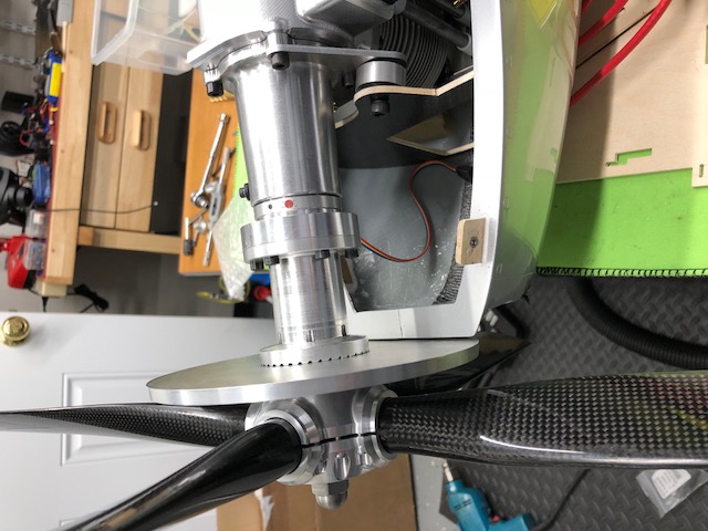

Test fitted the engine. It's definitely not a one person job. I did manage to get it in, but extremely awkward to hold and try to bolt. But between the CARF install kit and the Kolm install kit, they seemed to nail the positioning of the spinner back plate. The gap between the spinner back plate is nice and tight, but not too tight. So, the aluminium stand off and one of the spacer washer fits as they designed. I wanted to put the engine on a test stand prior to installing. Not sure, may just install. I have to admit it does look intimidating with the prop on.
The small alu standoffs was designed to work with the rubber-mounts. the 5mm goes to the engine and the 6mm takes the rubber-mount. this is why the have 2 different threads inside.
but . you found a solution for that :-)
Looks awesome! would be cool to find out how big the difference is depending on power output from your prop to Ramoser Varioprop. the varioprop blades looks much more scale ...but the performance, i dont know.

Hi Tom. I felt this way by having a 6mm bolt all the way through gave a real solid mount for the engine.
