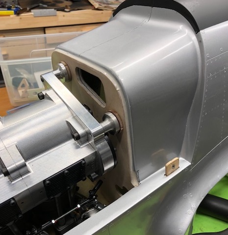

Test fit the engine again to get the exhaust tubes to fit out the bottom. Took several times to get the holes aligned. Now that they're centered, I just need a little more trimming. Used hysol to mount the engine front support bracket to the lower cowl. All seems to align nice with the spinner. Need to install throttle & choke servos on the other side of the firewall.

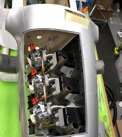

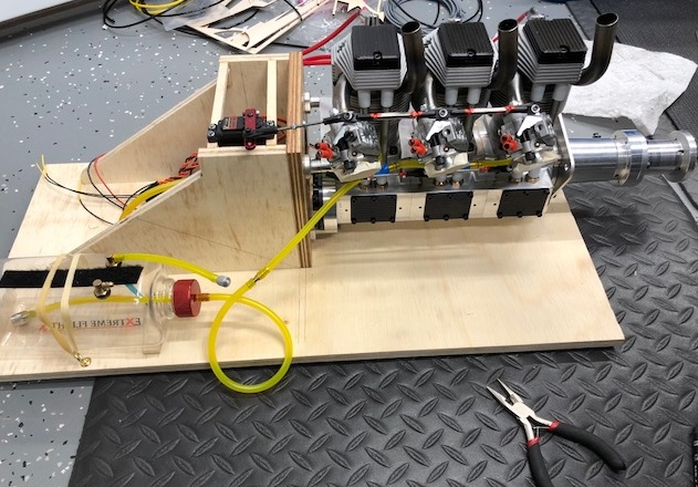

I was just going to mount and test the engine in the air frame, but decided to build a test stand. Since the needles are difficult to get to, it made more sense to test run first and think a little on how to get access to them once the engine is mounted. I'm going to see if I can add some sort of channel to each set of needles that I can access outside the air frame. This trouble is on the carb closest to the firewall. The next two carb I should be able to access a little easier.

One more point, my engine was mounted not only with the Kolm aluminium stand-off but also the phenolic washer that was supplied with the CARF Engine installation kit. See picture. So the total stand-off length is slightly longer then the just aluminium stand-off. This should help you get really close.

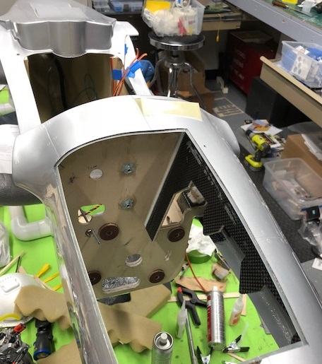

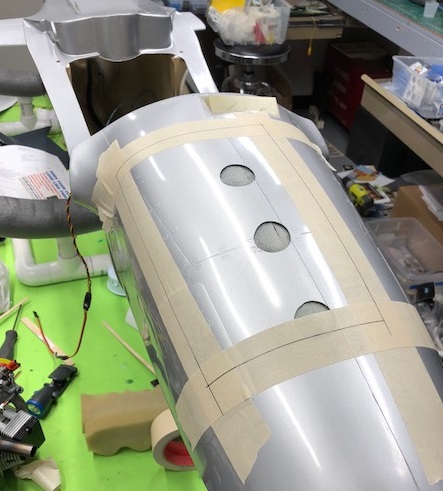

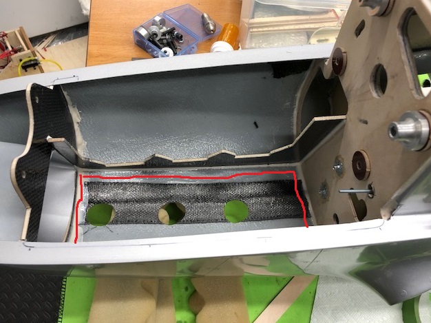

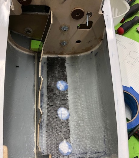

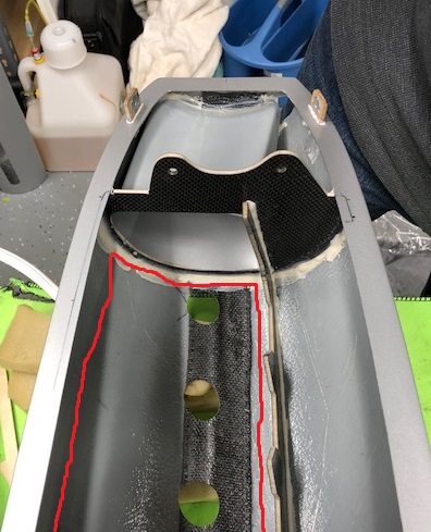

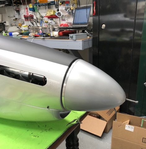

I'll be tightening the holes a little. but I'm still trying to figure out how I'll get access to the needles, and just as important, is access to the cylinder heads to take the caps off and make valve gap adjustments. The GG has the IL-230 extremely tight in the cowl. The only way you'd be able to make valve gap adjustments would be to remove the engine completely from the air frame. Not a simple task. I'm open for discussion on this, but I'd like clear access. I'm thinking designing an access panel. It might be tricky with baffles, air intake and front engine support bracket in place. Otherwise I'd just make the complete lower half of the cowl removable. So, anyone else working on the GG and a Kolm, I'd be interested in hearing your thoughts. I understand that once the engine has settled in, these types of adjustments are not made often.
#64
this is how i did on voodoo
i want also to have acess to check the valve-gaps without pull out the engine. so i builded this hatch. the balles are cutted in this area. this is not a big problem.
#65
ahh... excellent. I was looking at this last night and almost the same. I outlined in red in my photo to show where I was thinking of cutting. So, very similar. I'll probably cut it a little tighter then I show.
#66

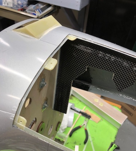

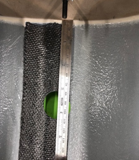

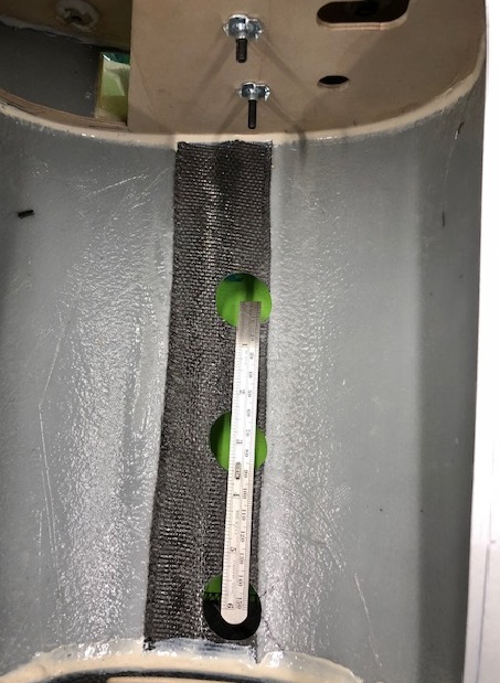

OK... making progress. Now have full access to tuning needles and able to easily take of cylinder head covers off for valve-gap adjustments. I'm feeling much better now! I first glassed the inside with 2" west systems reinforcing tape just to give a little more support to the hatch. After I cut the hatch, I added about a 3mm-4mm reveal around the opening with thin G-10 strips. So it will seal up nice as not to affect the movement of air for cooling. thinking either round head 4/40 or even 2-56 round head screws or a countersunk flat head. It's also nice that I now have access to the throttle linkage in case of an issue.

I made some tab's for the hatch out of G-10. Then used blind-nuts and decided to go with 2-56 x 3/8" flat-head screws that I'll counter sink slightly. It will have a clean look on the outside with the screws set in. When the plane is upright, you really can't even see the hatch. I CA'd all tabs in place and then put a bead of hysol around everything once it was all lined up. Definitely open to see how others solved this. I'm also open to suggestions. Rob

#72

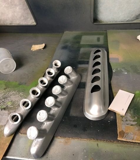

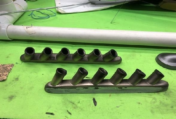

I'm not going to detail the plane too scale like, but I do want to add some panel weathering, a little airbrushing in areas, and just enough detail to highlight to the plane. The exhaust stacks that came with the kit are nice, just a little boring. So I thought I'd detail them a little. I cut each exhaust pipe open. The problem is they are so thin that I had to back fill each exhaust pipe with hysol before cutting them open. It made for a much more solid pipe in order to cut. Then weathered with my airbrush to give a little used look.

Here's a link to my test start of the IL-230. Before I install it in the plane I wanted to test. Since I'm added a fuel pump, I first wanted to ran it without the fuel pump connected. I then plan to hook the pump up test run, tune and do a final valve gap check before installing. I know when I added the same fuel pump to my Moki 300, I had to lean the carb a little. So just making sure it all works since this engine isn't easy to take in and out of the air frame. I couldn't go full throttle since I was by myself and couldn't hold the bench. You'll notice the stand starts moving even with a little throttle up.
