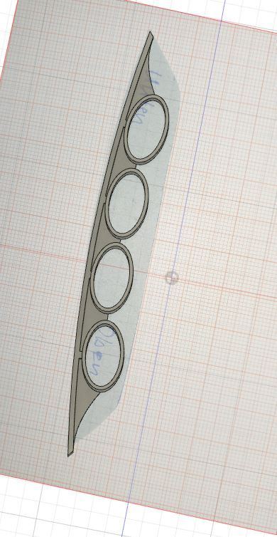

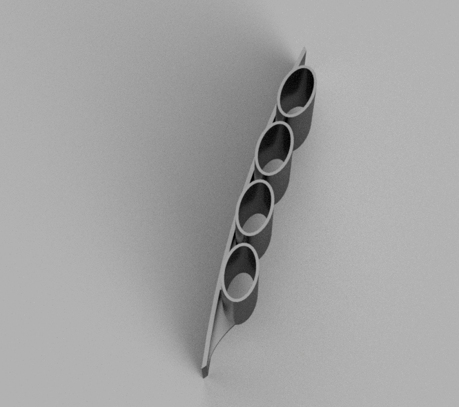

In addition to the fan I have designed a row of exhaust stubs that go into the Cowl. The follow the curvature of the cowl and dont reduce the airflow too much. I think they turned out quite nice

that looks very good Rev! Well done.
What cylinder temps are you getting on your 90? I am seeing high temps on mine though seeing the day temps can be around 35C hardly helps.
