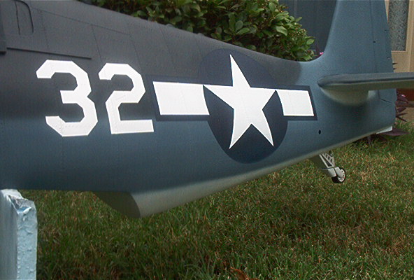

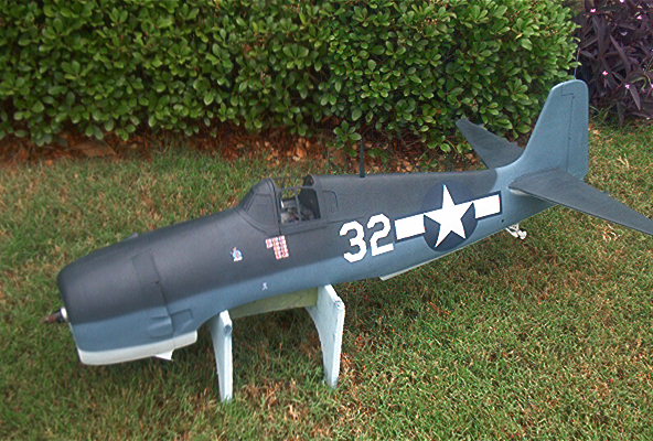

Hey John, I’m doing #32, you’re doing #33 right? I don’t know if I’m a southern boy yet, got my bib overalls and white tee shirt, just waiting for my mullet to fill out![8D] The stenciles are easy to use, now ANYONE can paint their insignia and aircraft #. Heck they are even making tiny stencils for the various small markings like “NO PUSH” and things! Lol
I painted my insignia and #32 on to keep up with Hal! I only had a few problems around the raised panel line and rivet areas. Only with the glossy white though, the flat blue went on without any problems. It was easy to touch up the very small areas where it leaked under the stencil.
I am going to pour a mold for some 1/8 scale machine gun barrels, I will cast them in black resin. The last picture shows the machined aluminum master.
I took these pictures on my front lawn!

Drool....Drool....Drool....
Man Luke... Those Painted on Markings and home made markings/decals really made her COME ALIVE!!!!!!!!!
Way to go!! Just something about all that Blue and White...So gorgeous!!
Can't wait to see it with its wing on and resting on its own legs![sm=thumbup.gif]

People, even tho these are very nice pictures of Lukes hellcat, they do not do it justice - it is a sight to behold when you see it up close and in person and even then I had to sit down after I saw it to catch my breath !! FER-SHIZZLE!!!
The guns are awesome guys,... I even got to hold the prototype in my hand.

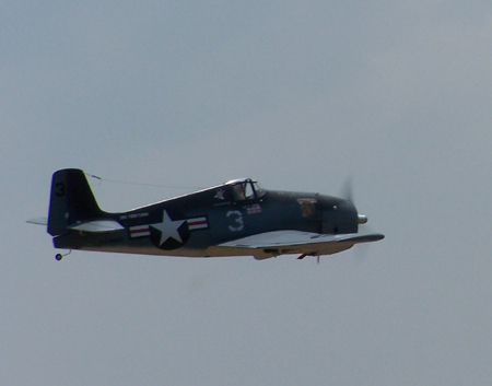

Here are a few pics of my CMP Hellcat taken this past 4th at our fly in. The wing was stripped and glassed. It was repainted using Model Masters paint. Powered by a Saito 100 which is perfect for this airframe. The retracts are a set of Century jet retracts which I reconfigured for my needs. It required about 7 ounces of lead over the engine to balnce it out. Flies great, and looks good as well. Hate to see it go, but a friend wants it more than I, so I will build another one soon maybe to a higher degree of scale.
Tommy

Looks good Tommy!! Glad to hear it flew as well as it looks.

Thanks John, thought you would like to see it. I used the canopy and engine cover from Dion.

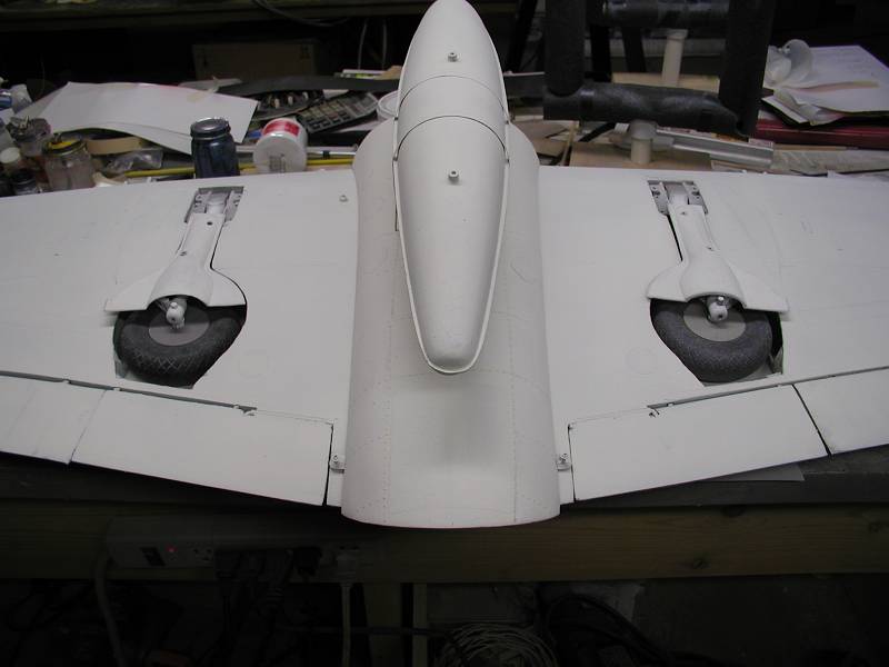

Pictures of the bottom of the wing. Now ready for some weathering.
