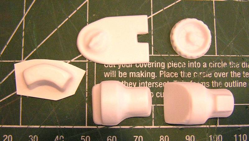

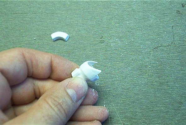

I've gotten most of the Cockpit pieces cut out but have run into a snag. Dion must have changed the kit from the time he did the partial instructions as the picture doesn't show the placement of some of the pieces. Maybe someone has a picture of the real thing or maybe of their cockpit construction and could help me out...
Bob

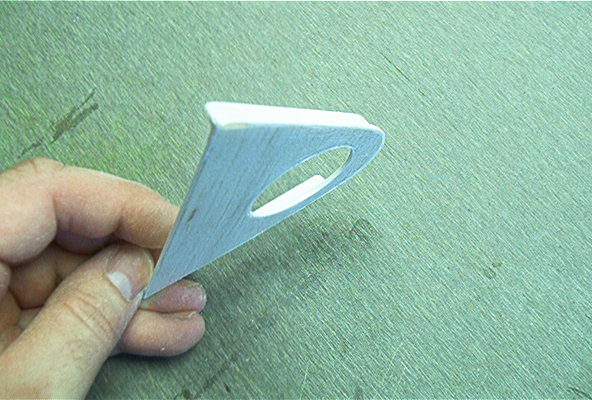

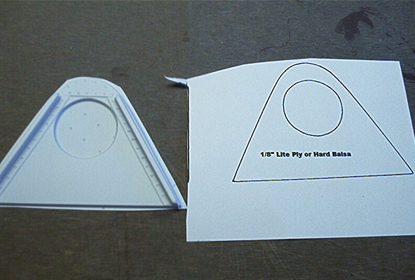

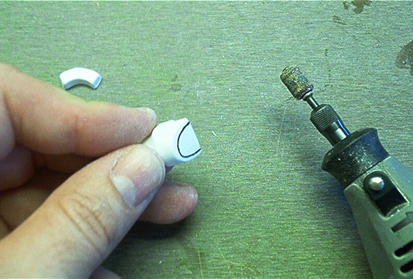

You are so close! That is the gun sight. Assemble the parts as shown and use the template for the gun sight glass to cut it to the proper shape. Some kits do not have the small rounded pad, I was in such a hurry to make the kits I forgot this part. I thought most people lost interest in this thing, didn't see one thing getting built. Now that I see you trying and someone brought this to my attention, it got my interest going again. You are doing an excellent job, I'll help whenever I can.
The last part before painting is the armor plate that goes behind the rear window, add some balsa to this. That's it, you're ready for painting.
I'll post my painting instructions here later tonight. For those that are wondering, I'm limiting my presence here for just this kind of thing, I feel obligated to my customers. Otherwise, not to much about RCU thrills me, so for now anyway I will only respond to questions about my stuff.

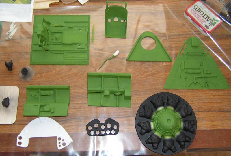

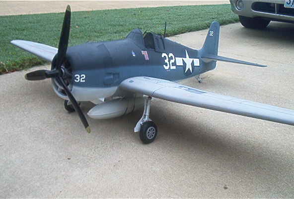

Yes, you can use my pictures, just give me credit. I've moved into an almost full time designing and manufacturing mode, I don't really have time to work on my own stuff or fly. I almost finished my Hellcat, still have not painted the wing though! I'm fine with my current situation, because I enjoy building and the type of problem solving that comes with making a new part for something. I will be moving to Texas in the spring, so I'm really looking forward to getting in touch with some old flying buddies. I'm sure I'll start doing more flying then.

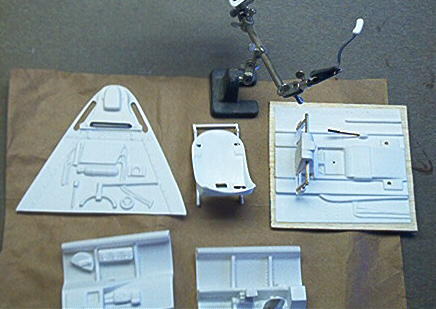

Here is a few pictures, it's as far as I got with my plane. As you can see I have the panels on it and the panel line tape, so it's pretty close to being done.
I'll finish the instructions, I already have all of the pictures, I just never posted them.

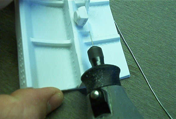

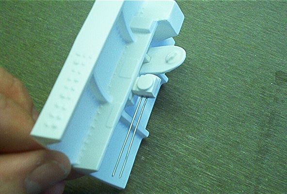

I started this as a limited production type thing, but I'm up for another run I guess. I do have about 5 Hellcat cockpits in stock and about 3 drop tanks. I am in the middle of filling a large order this week, let me get that out of the way and I'll get the Hellcat stuff out to who wants it.
I want to get everyone up to the painting on this project, looks like I have one guy! lol Again, good work Bob!
You will need to drill two small holes in the small trim wheel box on the left panel as shown in the first picture. Using the supplied wire you will make your elevator and rudder trim rods. Glue them in, they extend to the back panel.
Get your elevator trim wheel ready for painting by sticking a pin through the center and attaching it to some scrap balsa.
Now we are ready to paint.
After making a few of these I’ve found that it is much easier if you leave the instrument panel mounting former unpainted for now. We will get the instrument panel ready to mount with the instruments, glue it to the panel and then with a brush paint the remaining panel. You can either paint the entire panel black, or very carefully with a brush paint it Green Zinc Chromate, it’s up to you.

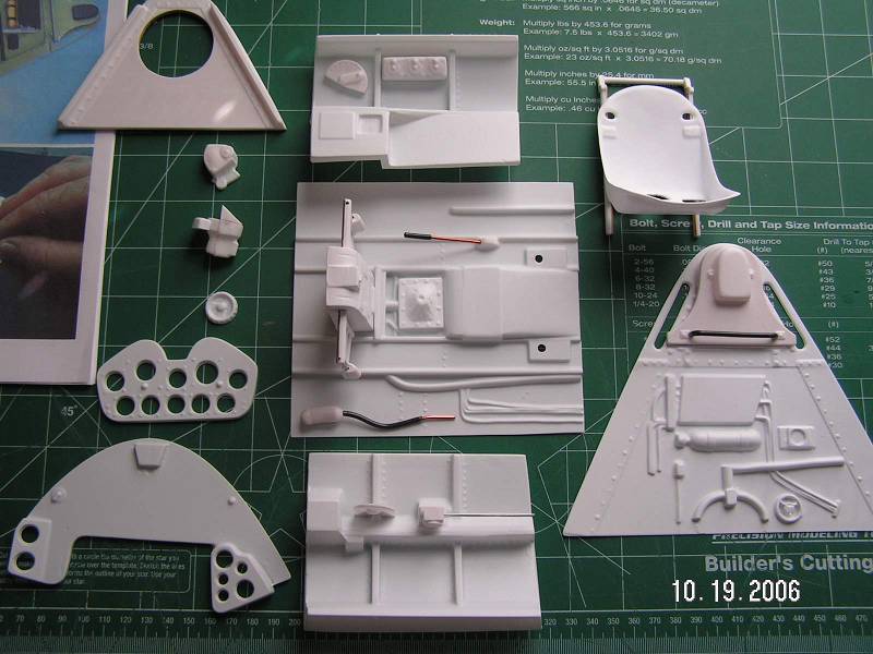

Thanks Pappy, I think I'm ready for paint now after a minor slip up in cutting the gun sight[:@].
In one of your posts you showed a cowl former and said you were sending everything to Hal, would you still have the templet? I contacted Hal and he said he couldn't get to his basement so it wasn't available.
The Hellcat looks great btw, can't wait to hear how it flys.

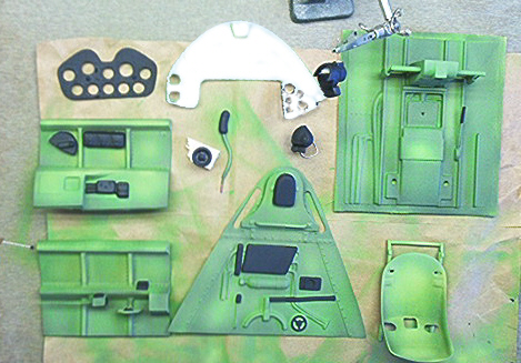

I finally got an air hose for the air brush and a little practice so I've gotten the zinc chromate and black painted, now the details... What the heck are all those push pins and other pins for?

Ok, I've caught up with the instructions, My hand painting skills "aint to good" but it doesn't look to bad at first glance.
Whats next Pappy?
