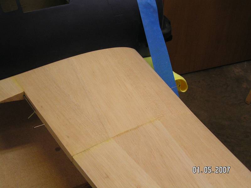

Hi Randy,
I'm getting ready to do the horizontal stab so I installed the wing and leveled it by measuring out from the fuse on both sides and found the center on both leading and trailing edges. I then measured up from the table at those spots. OK, wing level. I put the horizontal stab on and aligned it with the formed fiberglass, measured out from the fuse and measured up from the table. If you look at the view from the rear it matches the wing pretty well.
My problem is that the horizontal stab has (If I understand this correctly) negative incidence. The leading edge is 1/8" higher. If I give it positive incidence it will be out of whack with the pre formed part of the fuse.
Have you or anyone run into this or even checked? I'm leaning towards just putting them on like that...
Any opinions?
bigbird

Old 01-05-2007 | 12:27 PM
  #1417
Joined: Apr 2004
Posts: 1,859
From: chesapeake, VA
Default RE: CMP Hellcat
bigbird;
All I can tell you is that the Hellcat one of our clubmembers is flying flies great. He bought it already built and its previous owner was certainly no building genius if you look at the plane. I would clue the stabs on where the are meant to go and not worry about it. That's what I did.

Old 01-05-2007 | 07:31 PM
  #1419
bigbird007's Avatar
Joined: Jun 2003
Posts: 321
From: Shelton, WA
I guess your right, I tend to worry about things I probably shouldn't. It probably comes from my lack of experience.
bigbird
