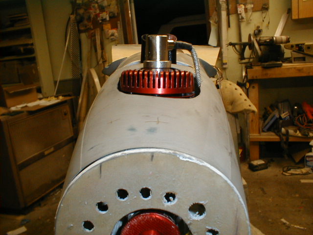

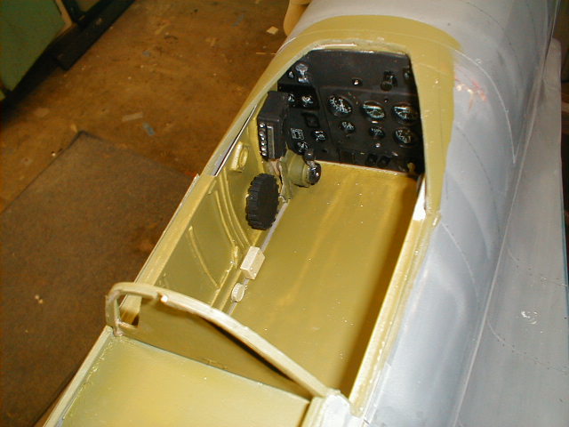

Finally got a motor for the Spit. MVVZ35 Made a muffler and got it all mounted. Do you think that will be enough cooling? Got the tail feathers all glued on and hope to get some paint on soon. I did have a bench crash, cracked the engine fairings and the fushlage. It's fun getting old and clumsy. got all the repairs done , just need to put some primer on.
Still have the cocpit to go . recieved a Brit piolit from FT. It is a little small 1/6 but I am on the short side too.
I plan on painting some aluminum paint on the plane first . then my colors. Maybe rub through with some steel wool to get a wearhered look. Wearthering is not my cup of tea so if you have any suggestions let me know. Rich

I made the mufler out of 1in SQ steel tubbing with 2 1/2 tube outlets. I need the nose weight anyway. Rich

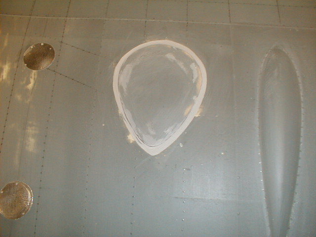

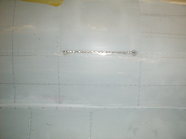

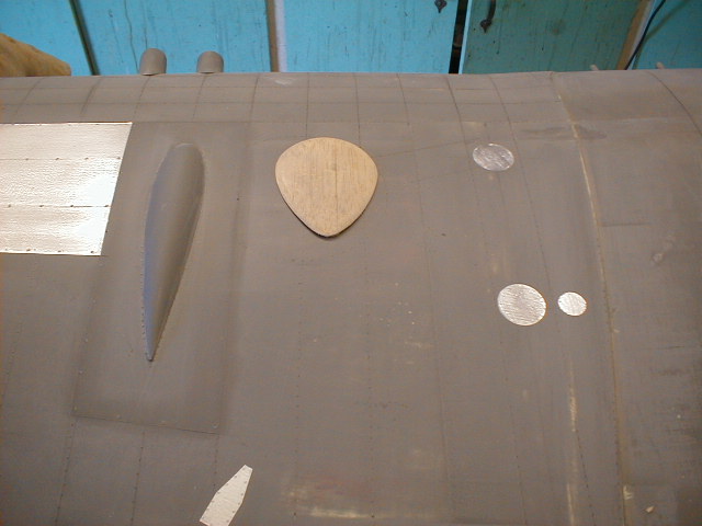

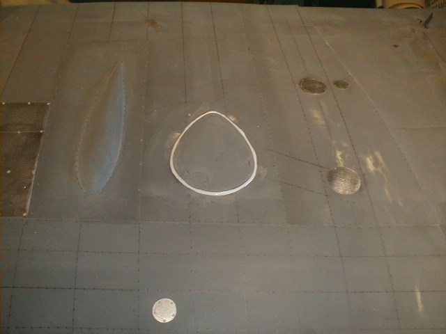

Got back on the Spit. With info I got from Chad Veich I made the wheel bulge in the wing. I made it from 1/8 balsa. glassed and primmered. I mounted it with white glue. The tape is to give me a clean edge . Then I added bondo and sanded to a nice couteur. also woked on the cocpit. The color in the pic looks gold but it is int green.
I talked to Gary at Get Stensils yesterday and I need to send him the info for the Stensil. He had a heart attack a couple weeks ago but is alot better now. Gary sounds like a real nice guy.

Rich, the Spit looks just great. Maybe you will sell me your set of plans when you're done with them eh? I'd like to use the Platt plan to build a Seafire XVII someday. The 1/8th event is October 21-22 and will be held at Superstition Airpark in East Mesa. I have been working 7 days a week for the last month (deadline to meet) and the T-6 has not been touched. I should be done today or tomorrow with work and get back to a more normal schedule. I hope to get my Top Flite P-40 put back together in time for the 1/8th event. No way the Texan will be done but I am looking forward to getting back on it. Will the Spit be done?

Looking nice Rich!

Thanks Guys. Chad I plan on comming down to th 1/8. I don't know if I will have the Spitt done should be close. I will send you a set of plans for the Spit next week. I got two sets when I got the Spitty. no charge. The MK xv would be very interesting too with the folding wing. You sur wouldn't see many of them.
