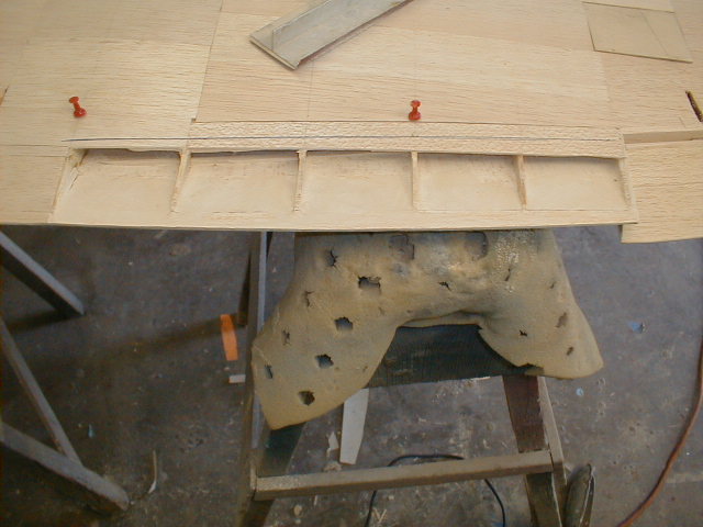

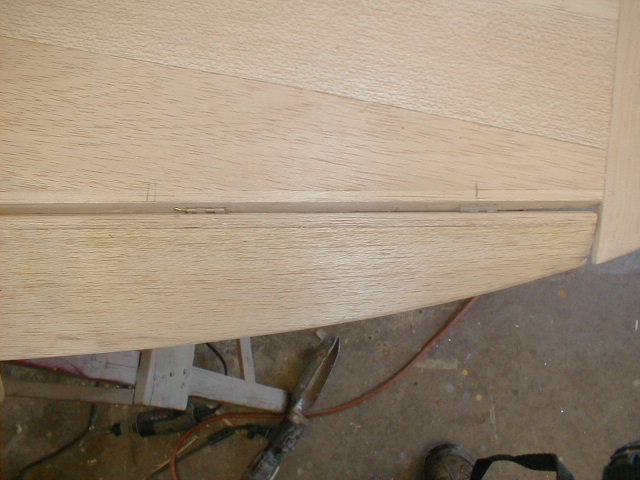

I recieved the Spit partly built. Cutt out formers for pull pull set up, Took out the 1/4 sq canop rails and added 1/4 by 1/8 rails cut slot with dremel for plastic strut H beam slider. also cut out vert stab for pull pull set up.
On the wing the plans show to cut the bottom main spar out for the retracts. I added 1/8 ply from top spar to bottom spar on both rails for wing support and retract support. <no pictures for that> alos added another main spar 1/2 by 1/4 spruce between w 3 wing ribs in front of the main spar and also a rear spar same size about 4 in from the trailing edge, beings that I am adding flaps. Their are not shown on plans.
Flaps

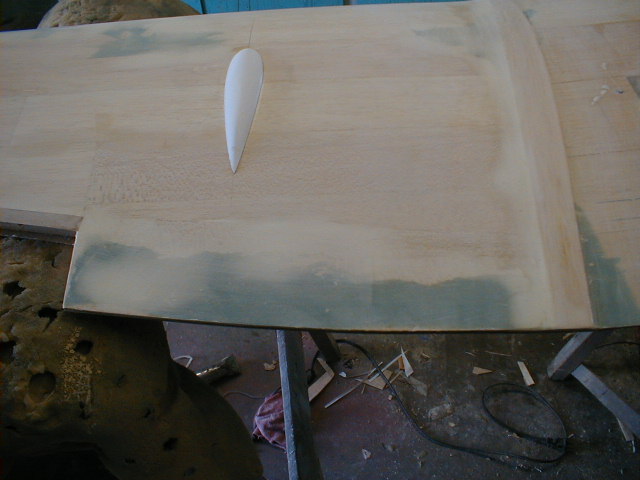

First I added a thin layer of bondo to the top of the wing where the flaps go to stiffen up the trailing edge. Then I cut out for the split flaps and added 1/8 leading edge. The split are 4 seperate flaps. I made the main tork tube from 1/4 brass and hinges from circutboard material. Beings the wing was allready built I put the hinges on the flap ribs.
For the angle on the flaps I made a simple ujoint from 1/4 aluminum rod and drilled a small hole for a steel pin that I solidered to the brass tube. I longated the hole in the aluminum to let it pivit. Then made an controll horn from 1/16 by 1/2 brass and brased it to the tork tube. This gives me one servo for all flaps . I wil usean 140 oz servo for the flaps. Most of this was done about a month ago. If you have questions just ask. More to come shortly Rich

I like those glass fillets.... Good luck...I've built 2 of these...fly great.

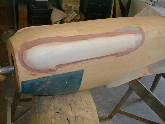

Solid bondo on the fillets, Thats a lot of bondo. I was lucky the guy I got it from what work he did was good. He got to the hard part of mounting the tail and wing to the fush and stopped but left the bottom of the fush open.'

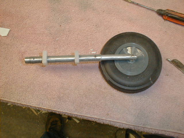

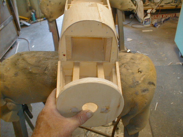

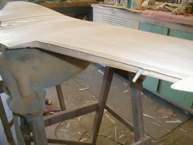

On the wing and tail I cutt out and added balsa blocks for the Robart pin hinges. Also added a pocket for all moving surfaces with 1/64 ply to cover up the gap.
I glassed the wing with 2 oz fiberglass cloth. Usually I use 3/4 oz cloth beings I didn't build the wing I figured a little more wouldn't hurt. The fush is covered with 3/4 cloth.
I changed the tank set up. The plans shows that the tank is put in from the front. That would mean if you had a tank problem you would have to remove the motor just to get the tank out. I cut out the former behind so it can go in from the back. All of the plumming is installed for the pull pull set up . 2 cables for rudder , 2 for elev. and 2 for the retract tail wheel.
I used a retract for the tail wheel from one I had. I think it is a B&D air retract. On the retract housing I made a 1/8 ply former with a pocket made from 1/8 ply. This way I just slide it in the pocket and put 2 screws at the bottom. Most tail wheel asmy are really hard to get to the upper screws. I have done this on just s regylar tail wheel asmy also.

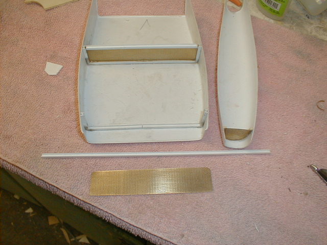

Got the griffen engine schroud mounted and made screens from K&S for the bottom scoops.[img][/img]

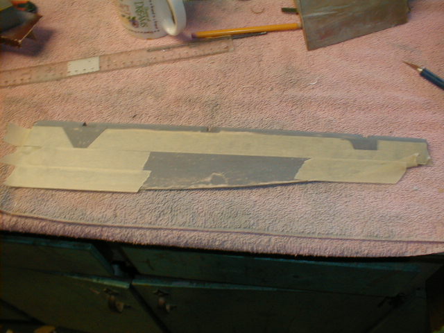

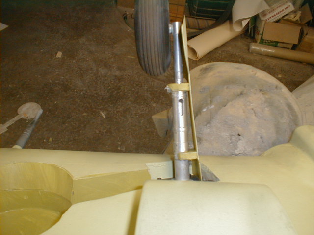

The struts an the Platt gear are terriable. After fileing on the gear to get them to lock up and down, Then adding a nylon spacer to take up some of the slack. The pin in the strut fell out just bu itself. I put a 2-56 bolt in it for right now. I plan on making a set of struts like my A&E Spit has .

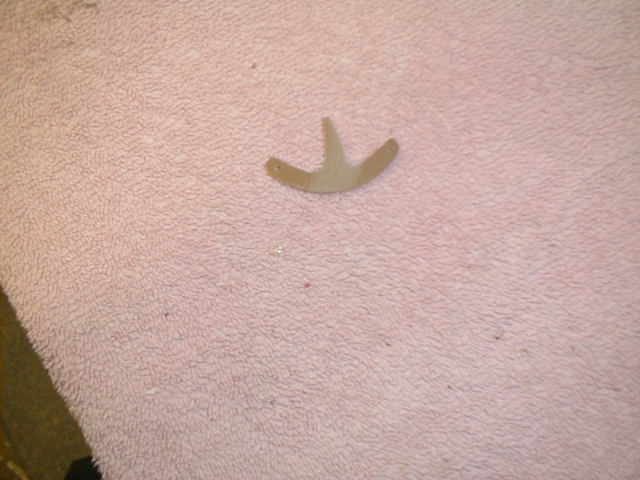

I made the rudder horn out of circut board material.

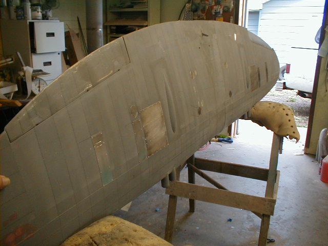

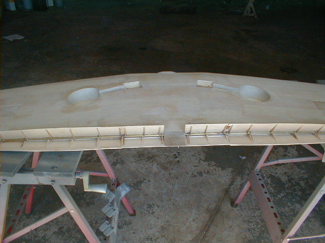

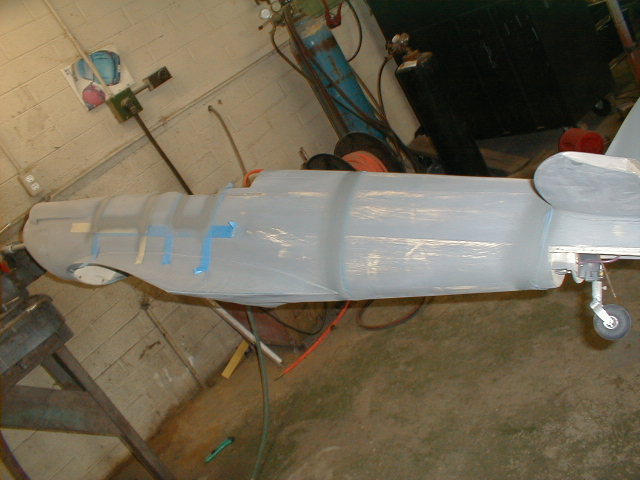

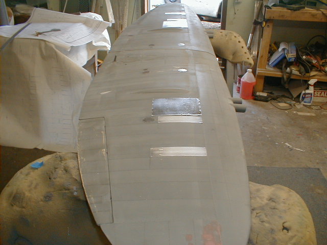

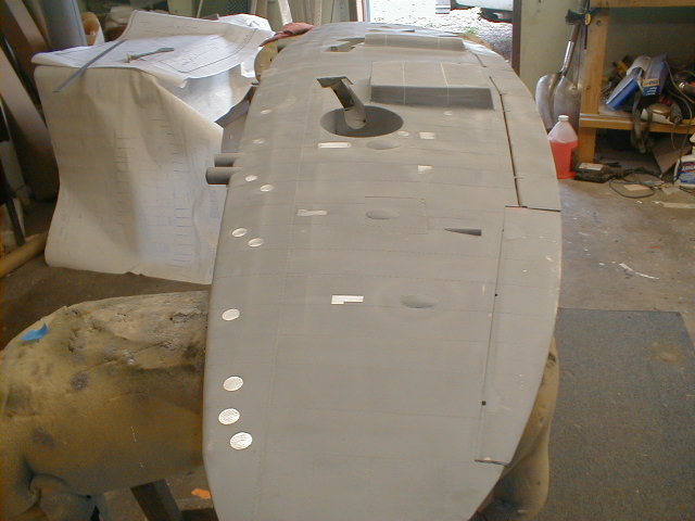

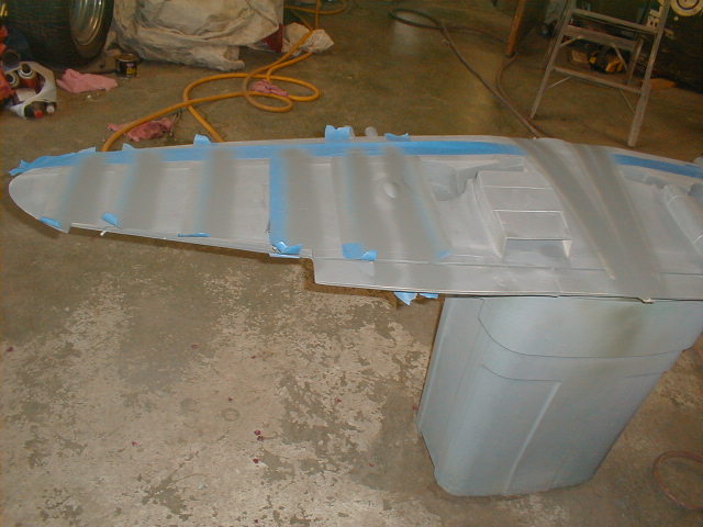

got a little more work done. The wing has all the detail done pannel lines ,rivits,used plu
mmers tape to simulate pannels and accsess pannels. Fusalage is primmered, got Griffen motor shroud done. Horizontal pannel lines done . now adding vertical pannel lines. I just put masking tape where I want the lines. Then use auto primer sprayed along the tape, several coats to make a good pannel line. I use an automotive touch up gun. you don't waste much paint and not much overspray.
I really haven't decided which plane I am going to do. Waiting on some info. Notice I left it a full wing. I still may make it a clipped wing. It will be either a MKX11 or MKX1V.
I also used primer on the ail and tail feathers to simulate scale detail
