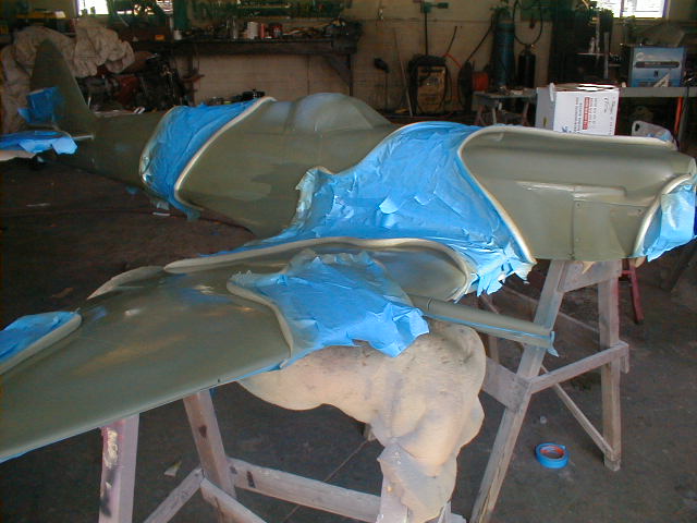

I am in the process of painting the camo and can't get the 3m foam tape to stick down very good. Any suggestions?
No problem Chad, glad to help. Thanks Rich

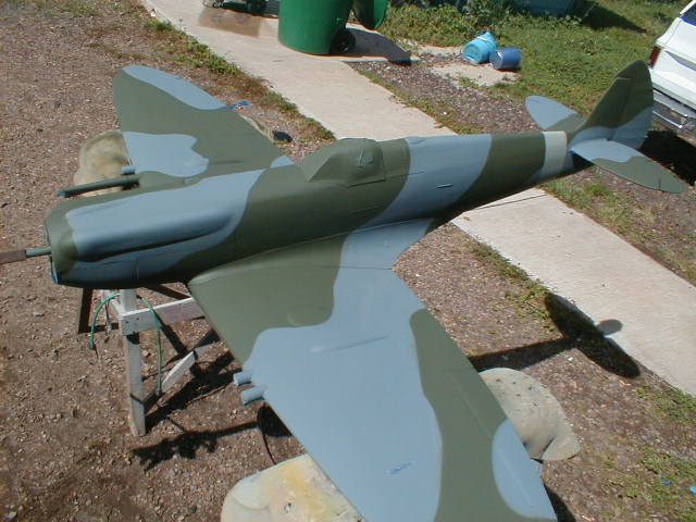

Finally got some paint on the Spitt. I used the 3m soft edge for the camo. I had a lot of trouble getting it to stick down good. I worked on the retracts today, hooked up the ailerons and flap servo. Should get the Stencil from Gary this week.
Chad I plan on going to the 1/8 AirForce this comming weekend. Hope to se you there. Rich

rich, i just got some of that 3m tape. what thickness are you using? i got the 1/2" size. i've heard it's good stuff and can't wait to try it myself.

Tibig They say it is 12mm which is close to 1/2 in. I am using latex paint for everything and it really works good. I did find if I rub the paint with a clean cloth and let it set in the sun for a little bit the tape will stick better. Rich

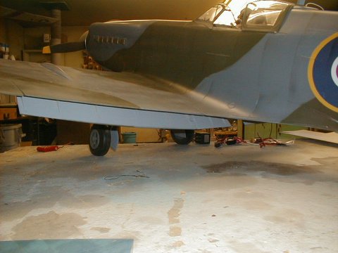

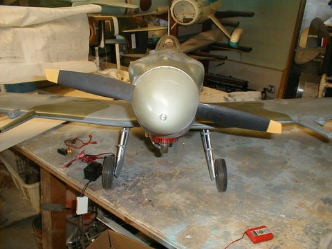

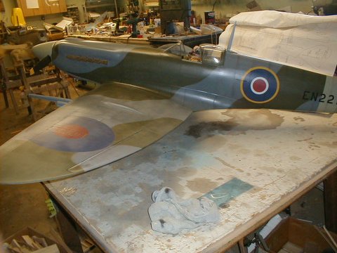

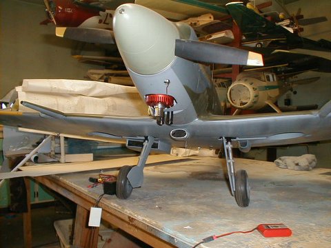

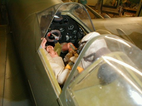

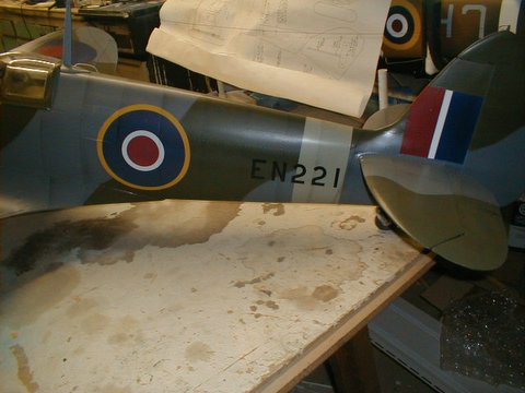

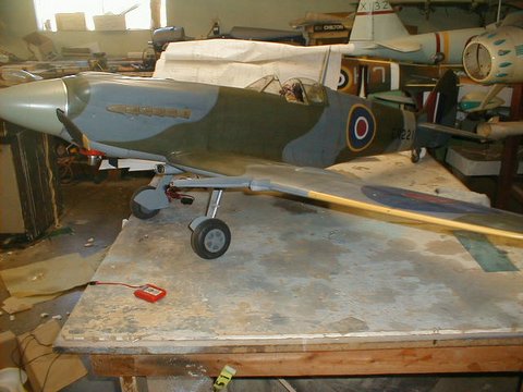

The Spitt is pretty much done.Sorry about the pictures it is just to cold out side. Will maiden it this spring or sooner weather permitting. It weighs 22 lbs with a MVVS 35 Gas motor. Rich

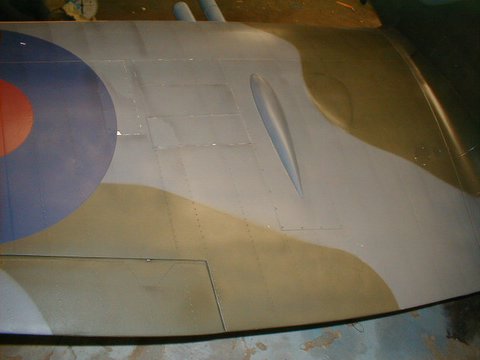

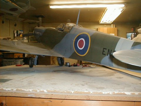

Old 12-06-2006 | 09:12 AM

Dang Rich, another fine looking bird. Can't say as much about that pilots knees they look almost as bad as mine.
Should be a great flier
Carl
Old 12-06-2006 | 06:56 PM
  #68
Joined: Feb 2003
Posts: 1,076
Default RE: Platt Spitfire build
ditto rich. excellent bird you have there. i especially like the shot of the wing. great weathering detail. very realistic.
Old 12-06-2006 | 08:32 PM
  #69
My Feedback: (7)
Posts: 1,736
From: Lakeside, AZ
Thanks Carl and Tim. His knees are like mine . Mine sound like rice crispys when I walk. The weathering is something new to me, useing artist chalk. But you got to go real light with the chalk or it looks overkill. Rich
