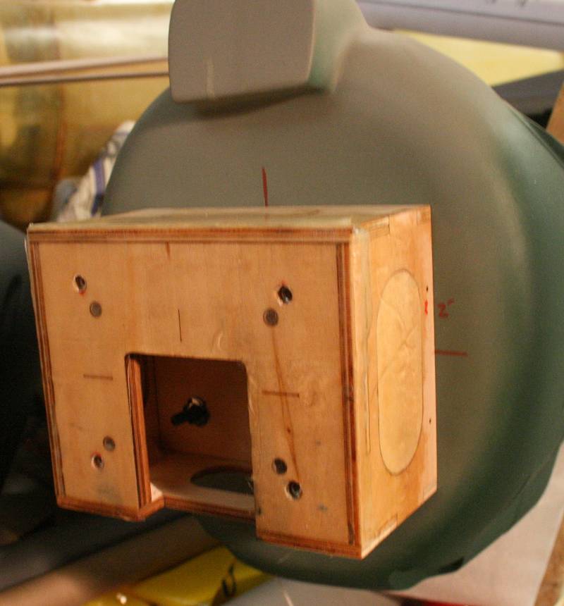

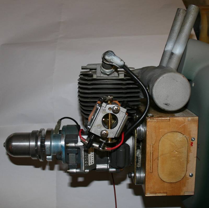

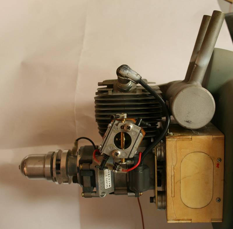

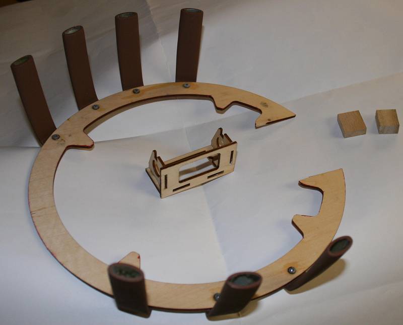

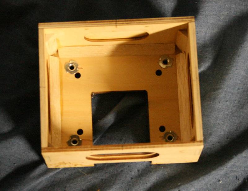

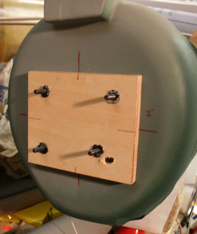

I've managed to get some work done on the engine mount. The first pic is of the provided firewall offset to the left .175in to the left, with blind nuts on the engine side. The second picture is the provided engine box slipped over the firewall mounted in picture one. I've added some of the box cutouts back in, three to be exact. then glassed across the box firewall and down the side of the box. The next step is to masking tape over all the blind nut openings that will be inside the box. then epoxy the firewall from pic one into the box, fiberglassing it just like theone on the other end ofthe box. Lastly foam the area between the firewalls.
Joe

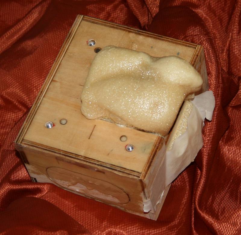

Old 09-02-2007 | 11:06 PM
  #105
Posts: 2,922
Received 6 Likes on 6 Posts
From: Vestal, NY
Default RE: CMP giant scale Zero build

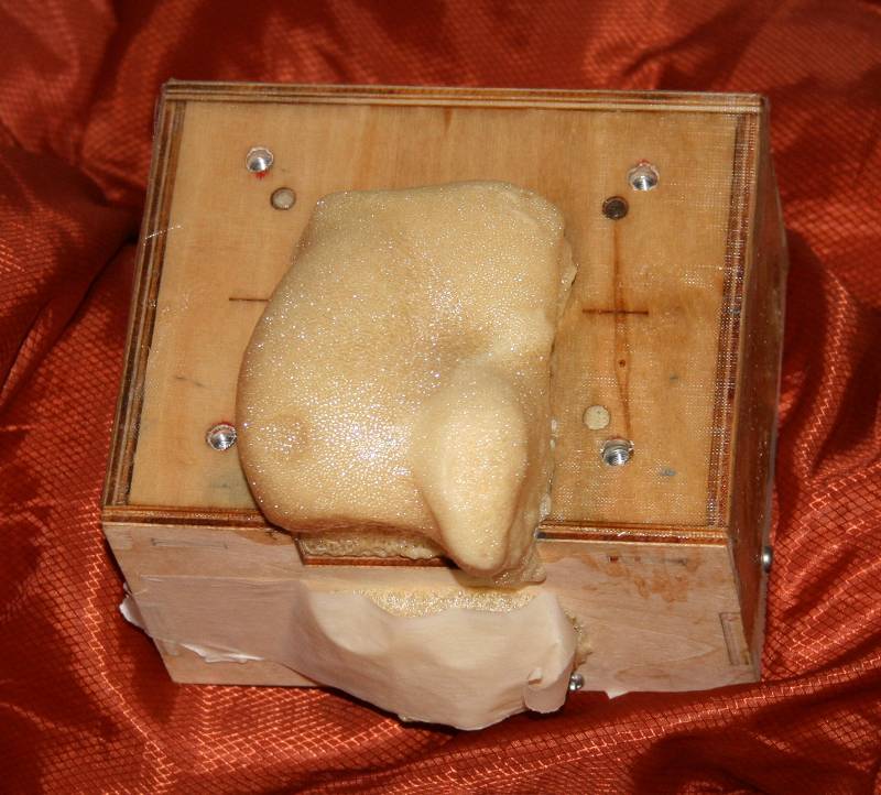

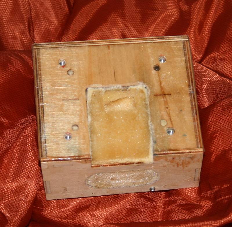

this shows the foamed box.

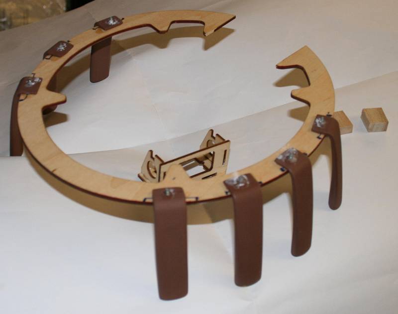

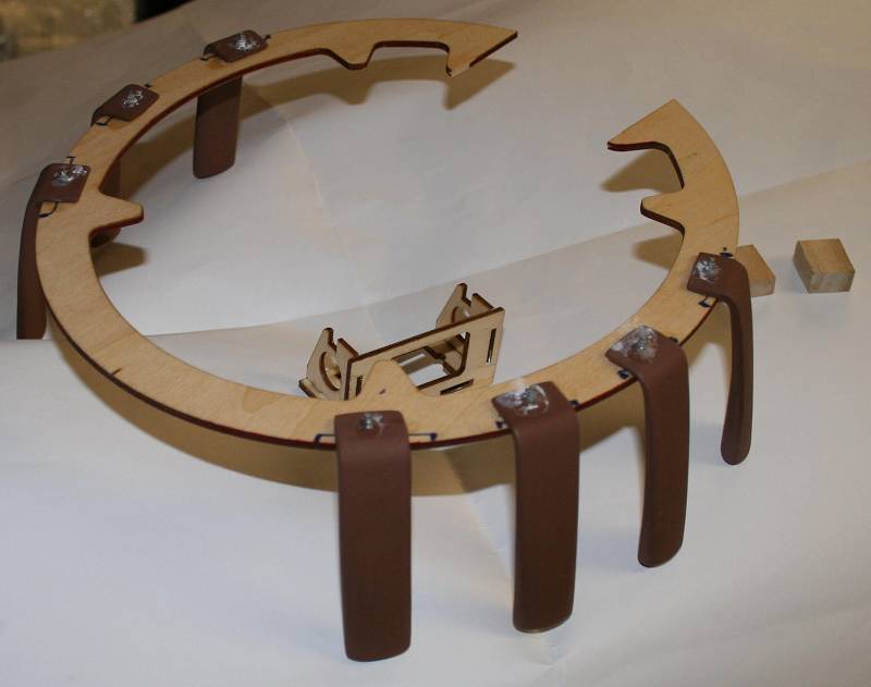

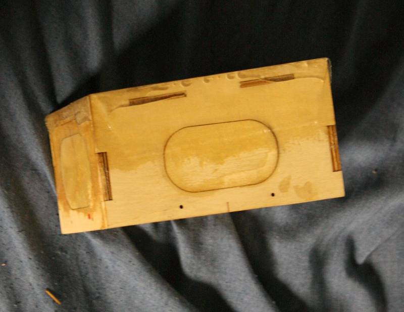

Some pic's of the engine install, cowl mount bulkhead.
Joe

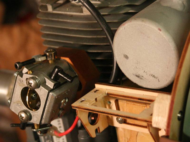

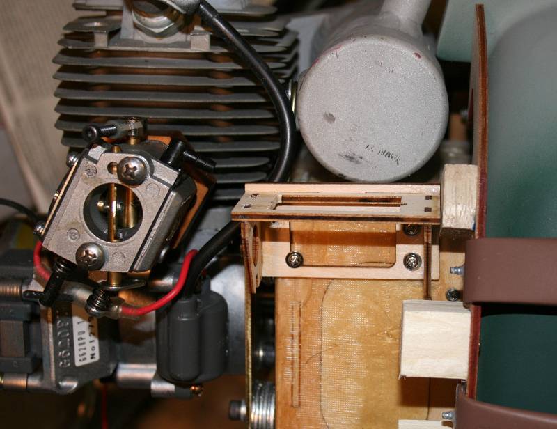

Old 11-25-2007 | 07:47 PM
  #119
Posts: 2,922
From: Vestal, NY

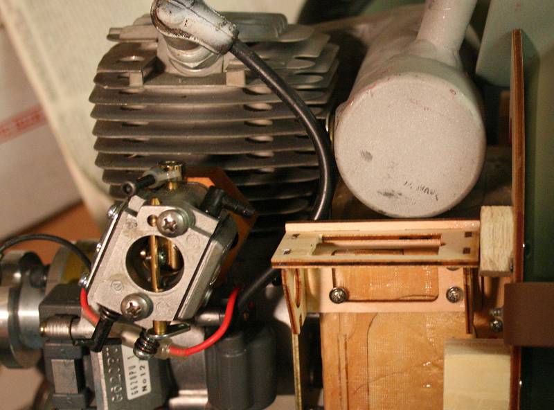

Added T servo pretty much a standard installation, I used a plastic clevis, aileron trunion, and servo output arm.
Joe

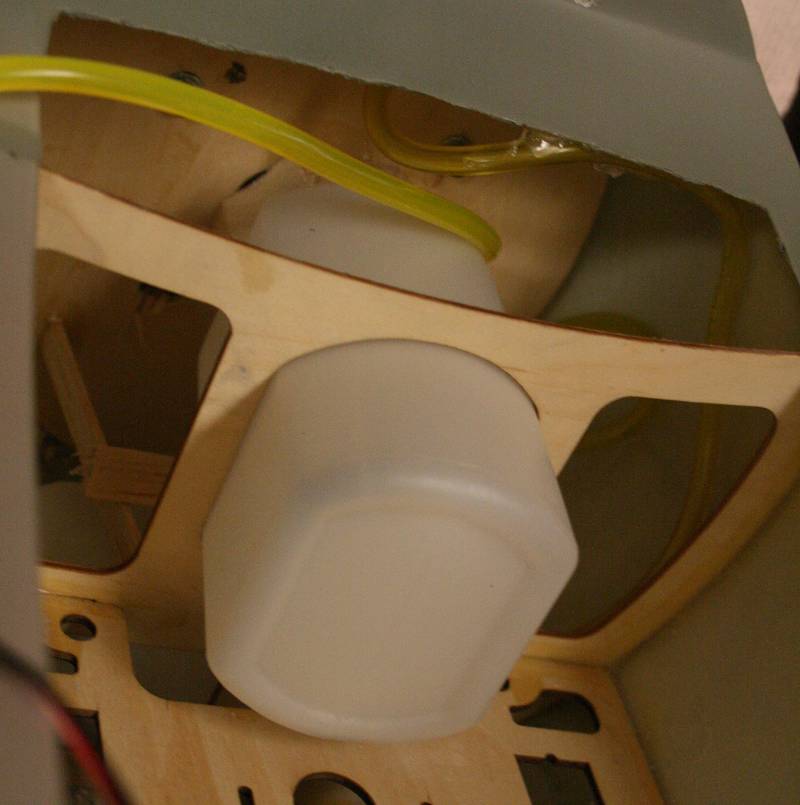

I plan to take this one to flyinns and I like to have 15minutes of fuel onboard for flyinns. I know that 16 oz of fuel in this g-62 lasts 10 minutes, the provided tank is less than a 16 so I added a second 8 oz tank. that should be enought to fly 8minutes and leave 6 for the clear to land. the tanks are built just like they were the only tank in the plane. i hooked the carb to the clunk in the larger tank, ran the overflow of the larger tank to the clunk of the smaller tank, and the overflow of the smaller tank becomes the overflow. I then mount the smaller tank above the larger and as far forward as posible.
Joe

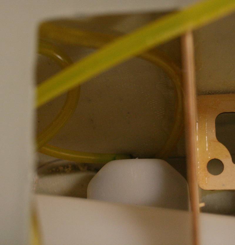

Old 11-25-2007 | 08:20 PM
  #121
Posts: 2,922
From: Vestal, NY

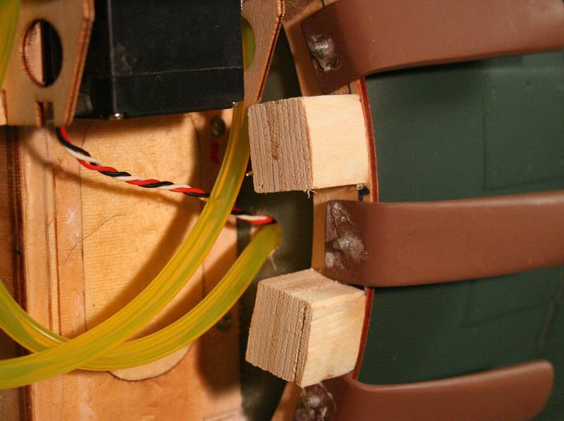

The hole in the firewall will fit the fuel tubing and the servo lead, 3/8 drill. when the install is finalized I will push some R6000 into the hole to act as protection against vibration, fiberglass and vibration cuts through anything in notime fast.
Joe
Joe , I am new to gas engines , I thought you were supposed to keep the throttle servo far from the ignition module ?
remember this is not a critisum , but a newbe to gas question

Proper installation is key....not location. Well-grounded ignition systems, be they EI or Mag types, assists greatly in preventing RFI. Isolating metal to metal contact with ball links, or other equivilant options using plastic connections between the metal parts is necessary.
Old 11-26-2007 | 09:00 PM
  #125
Posts: 2,922
From: Vestal, NY
I’m no expert on gas!!!
But this setup worked on this Zenoha G-62 in the last plane it was in. I’ve used as much plastic in the pushrod chain as possible (one of the places to use nyrods). Quite frankly the first time I fire it up I’ll be looking for any kind of glitching. If I get any It’s a toss up move the servo back and go to a non conductive pushrod, but the real problem is that it has picked up a RF noise somewhere. I look at moving the servo back as a Band-Aid, the real fix would be a new coil and sparkplug wire/cap.
Joe
