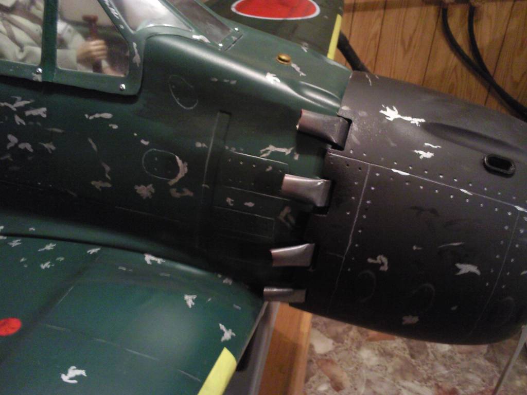

Well, you know I had a much smaller arf Zero (OK Models 45 size Zero) that had over 800 hours of hard flying time on it, same Saito .56 throughout its life too. Every year it got more oil soaked (oil smoke) heavier, and dinged from use but also looked more and more realistic. In all those years it became more and more of a fixture at the field and really helped get others in the club excited about warbirds, especially with good looking and flying arfs being so common these days. The challenge for me was trying to see just how long I could keep it going and how major damage could be repaired. It became a puzzle to solve (literally at times). I learned a lot from others at the field and from just plain experimenting on my own. In its last season (2007) I was flying it with the wing tip chewed up from another buddies prop. It flew okay but needed a bit of trim! A month later a newer pilot flying a hanger 9 Spit in our group ran into me at 300ft, cutting my tail feathers off and destroying both planes. The wood was just too oil soaked to take any glue and was just breaking up into granules as you rubbed it between fingers. After seeing how pervasive the oil had been on that model which was made of balsa formers and foam sheeting with a printed vinyl covering it was time for a new plane and I told myself it was going to be all glass. That's when another buddy in the group said he had just gotten a World Models 60 size Zero at a swap shop from a guy who hacked it together as an electric. It was rough (wing halves were not even at the root!) but Curt gave it to me and I started to cut it up and heat the epoxy free at the center. Prying and scrapping the soft epoxy I was able to get all the individual pieces free and clean and reassembled. The modes came from there, all small and relatively simple operations in their individual execution but they add up as a whole. I think anyone can do this, and better probably too, if you look at it that way. Small, individual projects.
Your Zero looks good and I'm sure it looks GREAT on a low, fast flyby! Besides you can alway add detail as you like along the way....

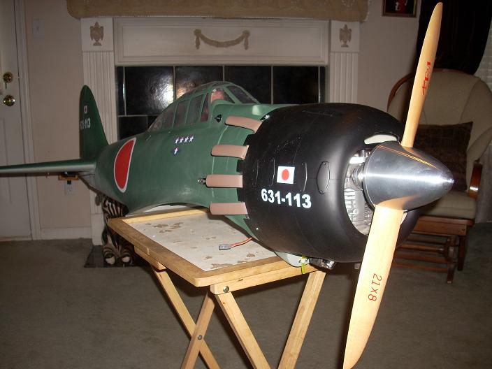

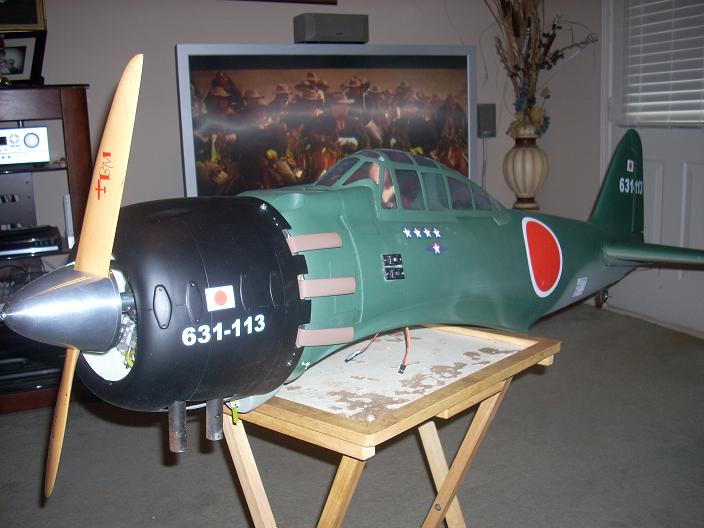

Attached are a few pictures , I used a Turnigy speed regulator on the flaps it works nice.

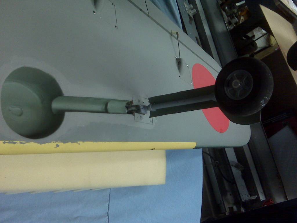

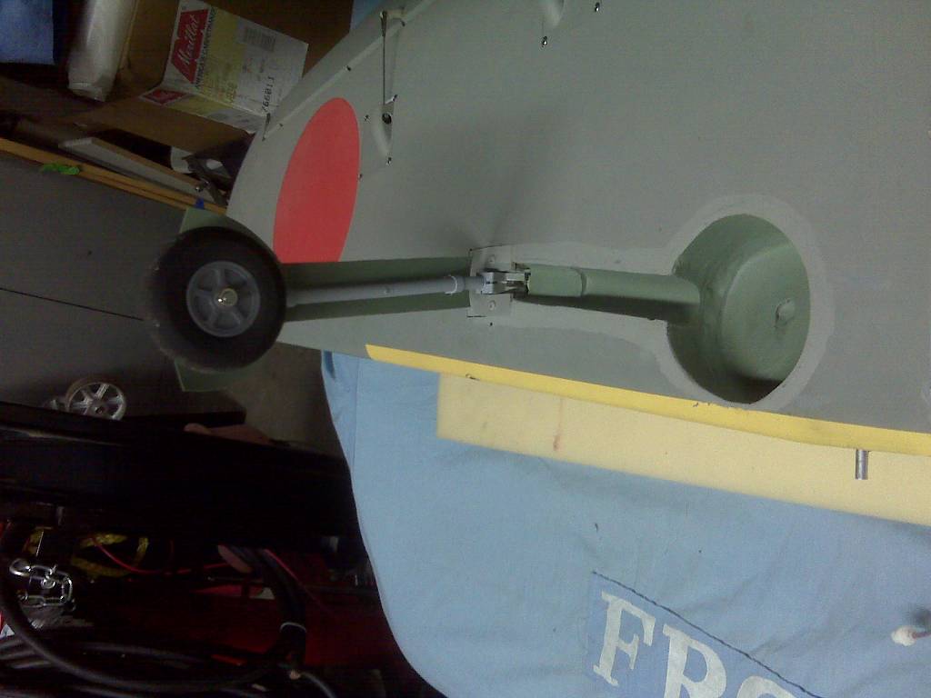

ckahoun, Looks great what retracts and struts are you using
Old 01-13-2010 | 12:53 PM
  #232
Joined: Oct 2007
Posts: 68
From: Crystal Lake, IL
Default RE: CMP Zero Makeover
Flyer 35
They are Robart spring down, with a machined solid half strut heated and bent to contour the wheel openings and robostruts 615? and slid over the machined half strut I would use the larger robostruts next time, I have to add larger springs or spacers in the struts to handle the 20.5lb plane.
Clay

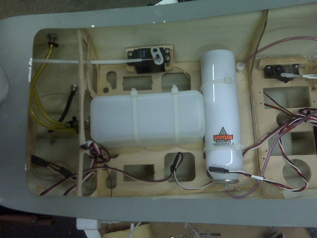

Well is have gotten started building this CMP Zero. I thought I would start with the fuselage first. I have all of the servo's and fuel tank installed in the fuselage as far forward as possible. I am using a pull-pull system for the rudder and tail wheel. I had a little problem with the Brillelli engine and mount.[:'(] The Brillelli 46GT with the engine mount I have is 6 1/2" long so I could not use the motor box.[:@] I laminated two 3/4" pieces of plywod together and mounted it to the the firewall. That puts the Brillelli 46 hub at 8" out from the firewall. I cut the cowl and installed a Dave Brown 4" spinner using a APC 20x10 prop. Everything looks good so far. This thread and others have been a big help. Sorry no pics for now. My Computer was stolen and I am using a friends to post this. I'll post some pic's when I can get another computer

I finally got the fuselage done. Here are a few pic's of the progress so far. I will now start on the wings, ailerons, flaps and landing gear now

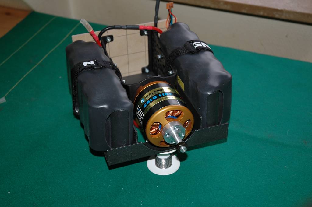

With 4 lbs of a123, it should balance ;-)

Yes I believe you are right your Zero will balance will the 4 lbs from your batteries. I have a light Brillelli 46GT gas engine installed in mine so I know I'll need at least 1 to 2 lbs of weight up front to balance this Zero. I am looking for a source of 1lbs lead weights.
