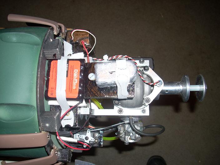

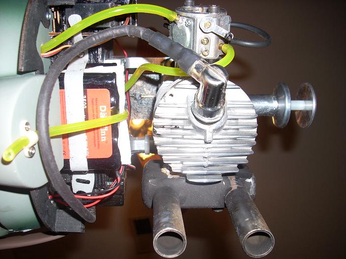

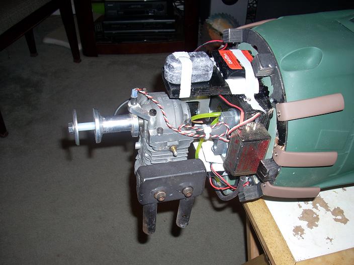

Here are a few pics of how I mount my Brillelli 46GT and batteries. You will see I mounted the 1lb fishing weight to a 3/8" piece of plywood and extended it as farword as I could. I also have a couple of pics that show I mounted the elevator servo's in the fuselage

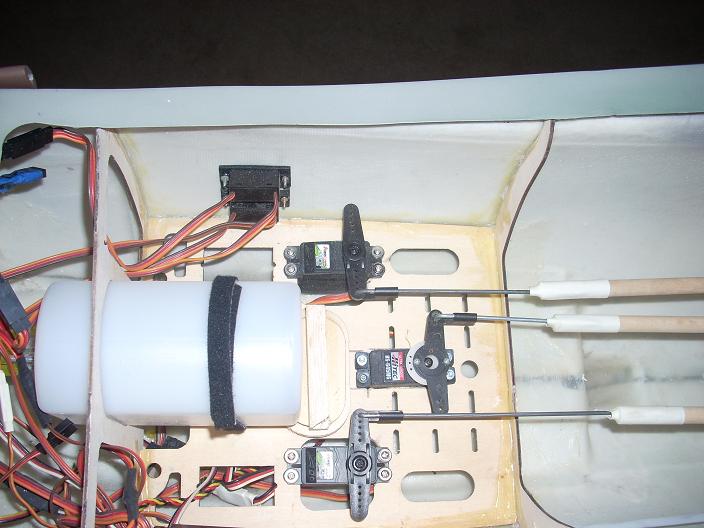

J one simple suggestion that I did on my CMP Fw190 bash , very easy to do at this point in your build .
1)go to the hobby shop , buy some white plastic tubes slightly bigger then your wooden rods .
2)cut some 2" and even 4" lenghth
3)slide them over your wooden dowl pushrod and support the plastic tube by glueing wood braces to them and the inside if the fuse .This will serve the following purposes , it will prevent any chance of flexing , it will keep the rods 100% straight under servo load and air pressure load on the flying surfaces .
I did this near by servos and cut a small panel out of the bottom of the rear fuse , added the supports and put the panel back in place .
Just a suggestion , good luck
Old 02-19-2010 | 09:43 PM
  #260
jstanton's Avatar
My Feedback: (14)
Joined: Aug 2002
Posts: 3,257
Received 26 Likes on 26 Posts
From: Millington, TN
Default RE: CMP Zero Makeover
LDM,
That sounds like a good idea. I used 3/8" dowels so I hope I can find the plastic tubes you talked about in that size I have everything done except for the landing gear I ordered. They should be here Monday and I install them and balance the Zero. I hope with putting the 1lb weight on the plywood extension and the elevator and rudder servo's in the fuselage I will not have to add any more weight

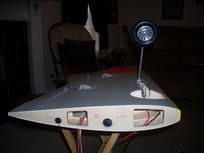

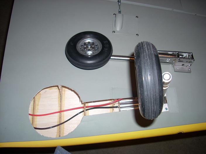

I Well I finally have one of the ESM landing gear mounted to a wing. Here are a few pics of the ESM gear and the wing it is mounted to. Now I am working on the other wing than I'll mount the air tank and swith into the fuselage.

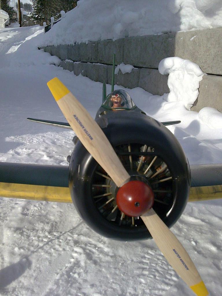

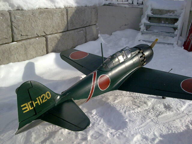

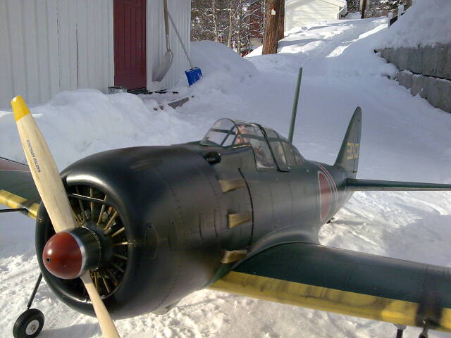

Here ismy zero, moved servos from the tail, fibergllassed wings, painted and ready for maiden. Pic are taken with my cellphone, sorry for the bad quality.

Viggkri,
Great looking Zero I really like the detail you did on the Plane. With your servo's moved forward what does your plane weigh?

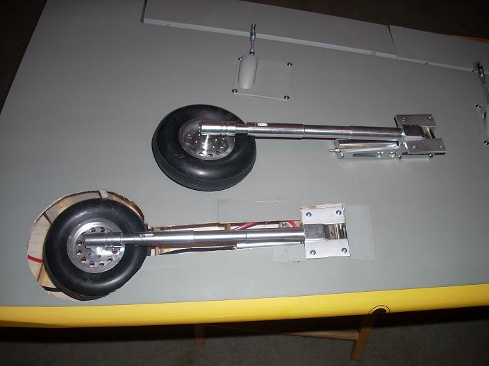

Get almost done. I just have to test the ESM retracts, engine and glus back in the forward wing mounted that feel out when I was drilling the holes for the aluminum wing dowels. [:'(] Then I am done. Here are a few pics

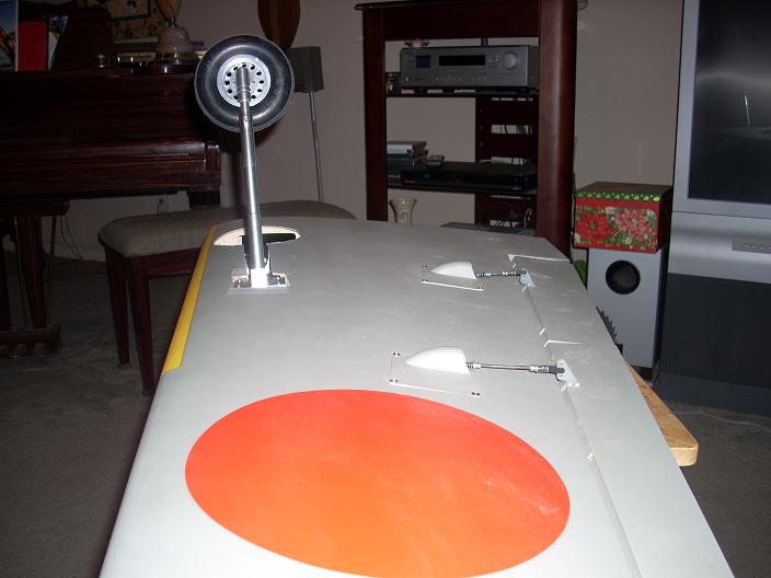

I found out the unit was twisting a little when installed all the way because it was not totally flat. I used a couple of washers to shim up the low end and now it is working Here are a few more pics and a small video I took the gear working

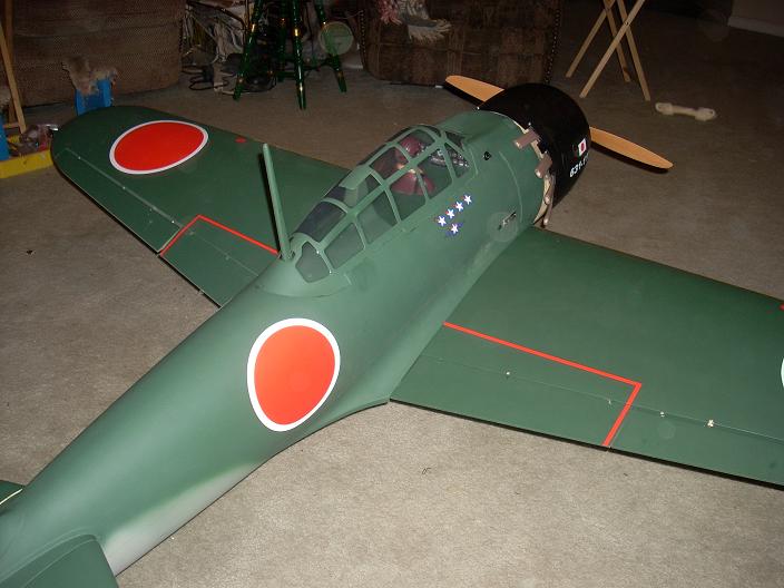

Wow this thing is really tail heavy! [:@] Even though I did not install the servo's in the tail and put all servo's in the fuselage I still will need 2 lbs of weight in the nose along with 3 batteries and ignition in the nose to balance this thing. [:'(] I was hoping to keep the plane under 20lbs, but that is not going to happen.[X(] I'll post some more pics of what I have had to do to get this plane to balance at 6"(155mm) from leading edge
