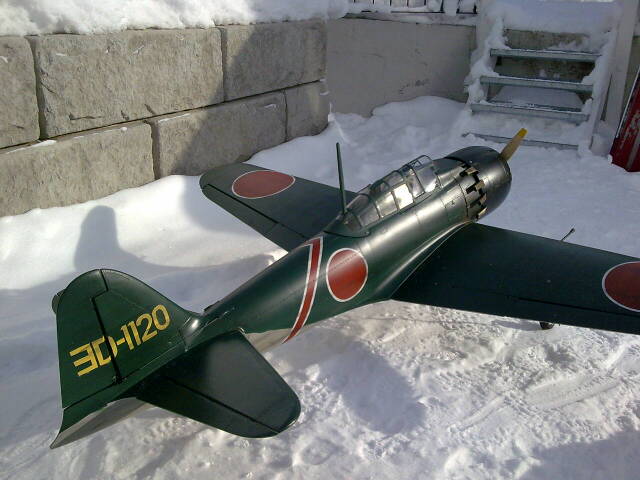

Hi
I Maiden mine yesterday, all went fine, tracking is good, no trimming needed, cg1 inch behind recommondation, Zenoah 38 for power, never needed more than 50% throttle.
I moved the 3 servos from the tail, and could take 1 kg lead away from the firewall, you do save weight by moving servos. But the weight doesent matter, it flys like a trainer.

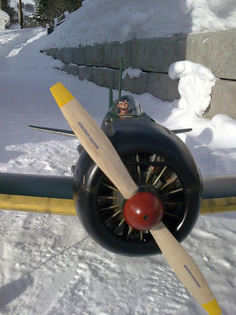

Hi Frank
sorry for my late reply to your question about the dummy, its a standard top flite 1/7 or 1/6 scale i think.
Just painted with humbrol in my airbrush, and clearcoted.
Been too windy for the Zero the last week but hopfully next weekend..........
Viggo
Viggo
