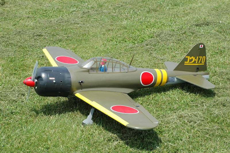

Yeah, I have not gotten a chance to work on mine yet but I have worked on my test plane....World Models .60 sized Zero I got as a basket case from a friend.
Brief history:
It was hacked together into an electric and promptly crashed a few times before the original owner (unknown) gave up and sold it at a swap shop. Wing halves were not only broken up but no glue on the crutch and misaligned wing halves. I took that section apart by heating all the parts with a heat gun, softening the epoxy. Wing centers were completely disassembled this way and reassembled. Lots of details along the way scratch built and issues specific to this models. As I said before, this was a test platform for a few techniques I will apply to my CMP 82." Zero Actually I was able to shorten the cowl to scale length and not add ANY lead. Nothing sticking out of the cowl either with scale exhaust porting too.
CMP larger Zero will incorporate the fiberglassing painting and weathering of the smaller zero but Will solve part of the nose weight problem with an ASP radial. I have this engine and it's in it's testing stages, so far very powerful and excellent sounding too. I'm chomping at the bit to get to her but I'm finishing up a TF p40 arf first for our formation flying group. I have all the stuff I need to complete her: Retracts are Yellow Zero gear and spinner too. 3 blade solo. I think this plus moving all servos in the fuse forward to almost the firewall will add up into little or no lead up front.

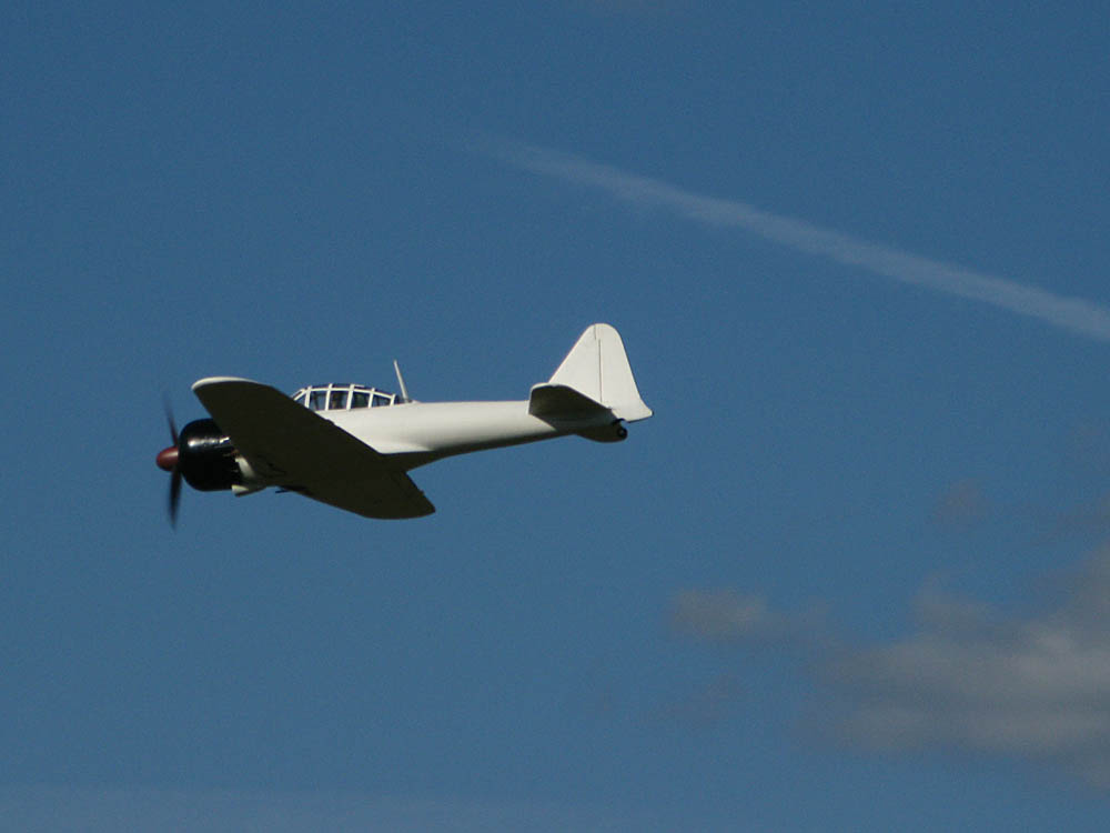

@Aluminum Overcast , that sliding canopy looks great. can you please post some pictures how you have made them.
Old 02-24-2011 | 12:15 AM
  #350
Joined: Sep 2007
Posts: 268
From: Waterford, MI
Default RE: CMP Zero Makeover
Thanks, but the canopy is simply cut in two and the back half is tucked under the front. Rail line is just chart tape. Simple and looks the part but it is not functional. I just couldn't add any more time or weight to this project to add function to the canopy. The canopy is the stock one just masked off and sprayed with white Klass Kote primer to add thickness. As it was I created the headrest etc. but the interior is nothing to look at really. I just wanted to have a solid bird to fly with my group and along the way experiment with a few ideas I had. Larger Zero will have working canopy faired in, as well as full cockpit detail.
Model is painted completely with Klass Kote paint, Actually white is only primer (weight savings) insigs and numbers are also painted. I have a few more things to add as far as lettering and a few additional washes. I really want this to look like a wartime zero (very dirty and flaked) not a museum piece.
