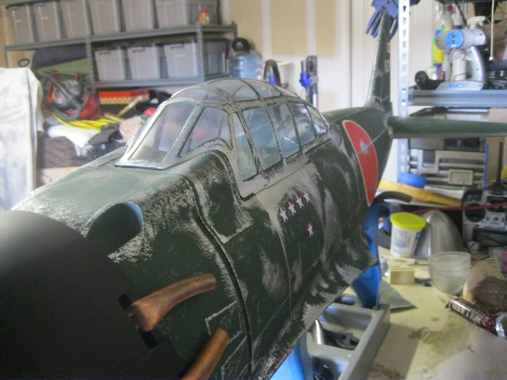

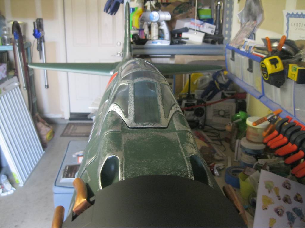

Here's is a pic of mine at the moment....I just couldn't leave it alone lol...

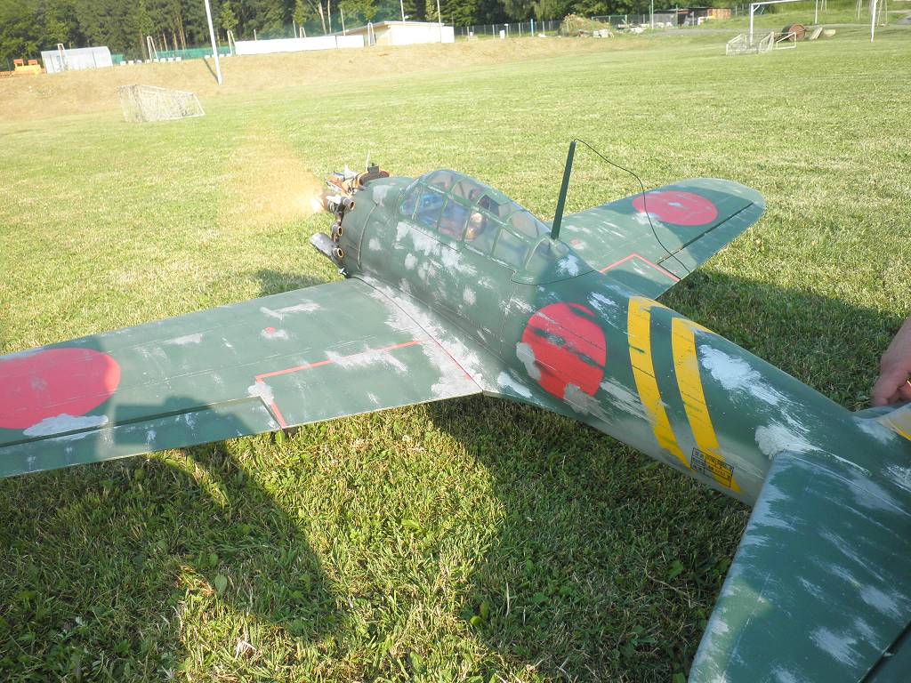

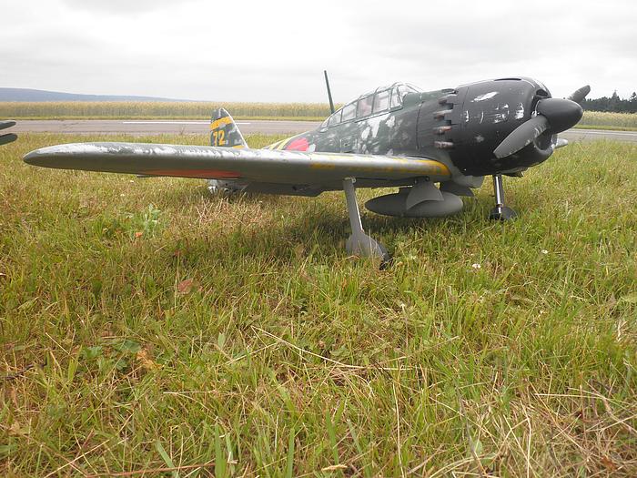

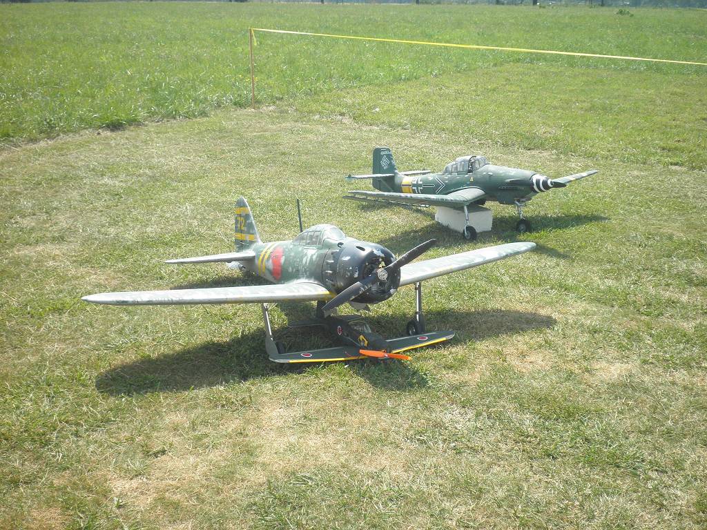

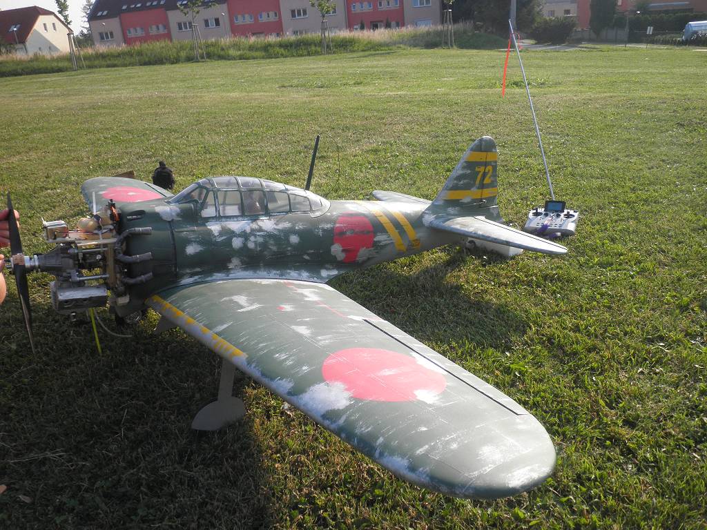

Nice job Casey!
Your Zero looks much better than my one. I´m looking forward to some other pictures.
Here is mine.

Thank you Prekin,
It is the 82" version. I wanted to keep this one simple, (but I also love alittle detail) so I wanted to test out a method to give it some "pop" without it being a total rework. I tested with Testors aluminum and silver enamel paint, on some old composite flaps until I had an idea of how I wanted to do it. I found that the aluminum looked good when applied, but "grayed out" a lot and became quite dull when dry. The silver on the other hand, worked quite well. It is applied with several different little pieces of sponge, to give different textures. I only have half of the fuse done so far.

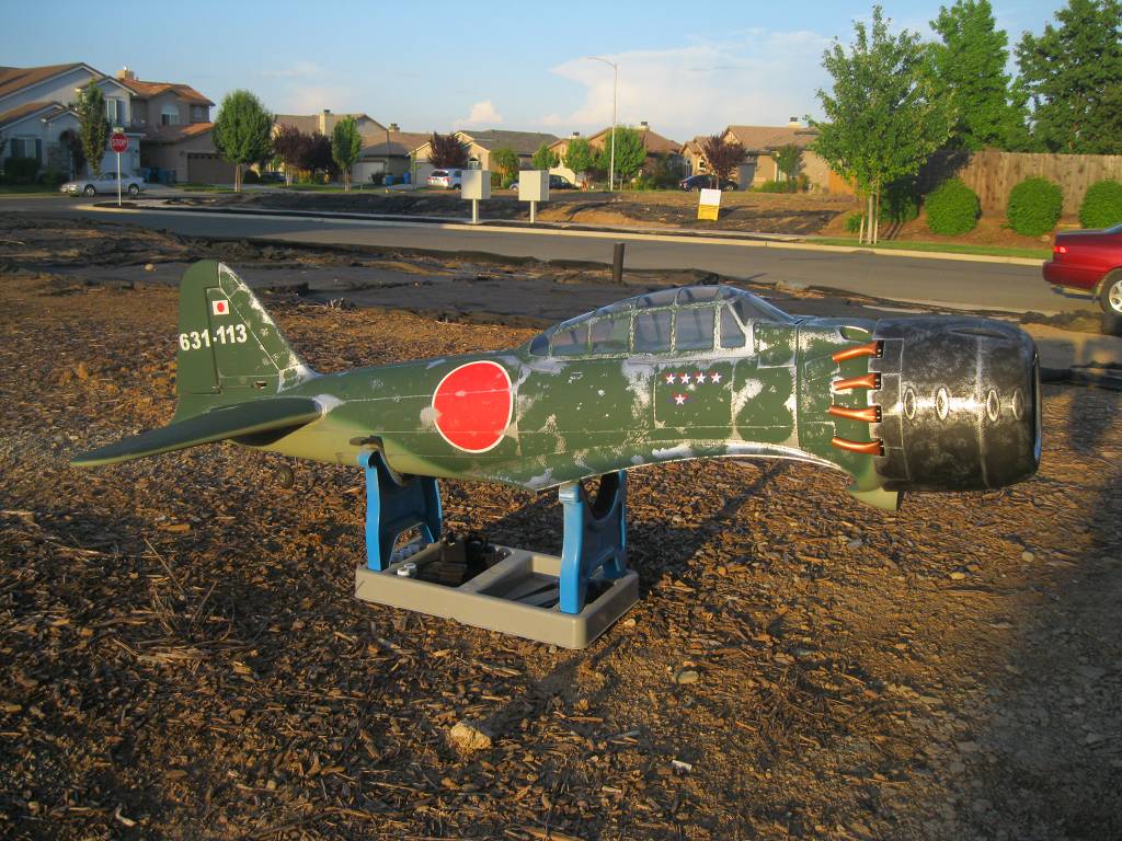

another shot.

I know, your is the 82", my one is also 82". The 82" verision has 631- 113 as a tail number.
When I add my Zero it into the "CMP 120 Zero ARF Build thread", I didn´t know about this thread.
So you want add only some outwearing without any rework? I did this thing with my ESM Stuka, and many people like Stuka than my Zero I think that the outwearing on my Zero is not very successful job. It was my first experience with the plane and silver or aluminium color. []
Which paint did you use?

I used the silver, as the aluminum seemed to turn a dull grey when it dried. The silver really shines though!

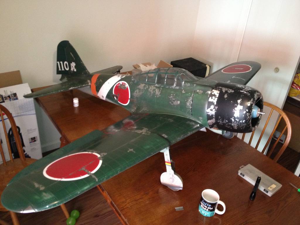

Well I got the thing sitting on the dining room table/workbench :-) one step closer to working on it again

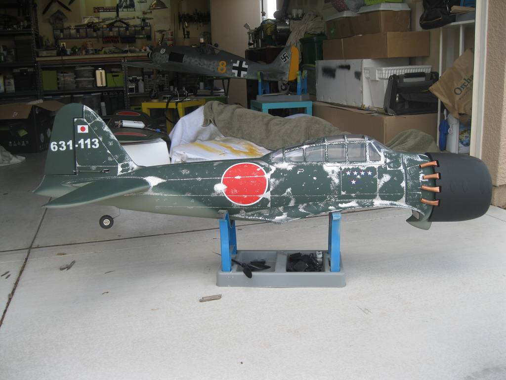

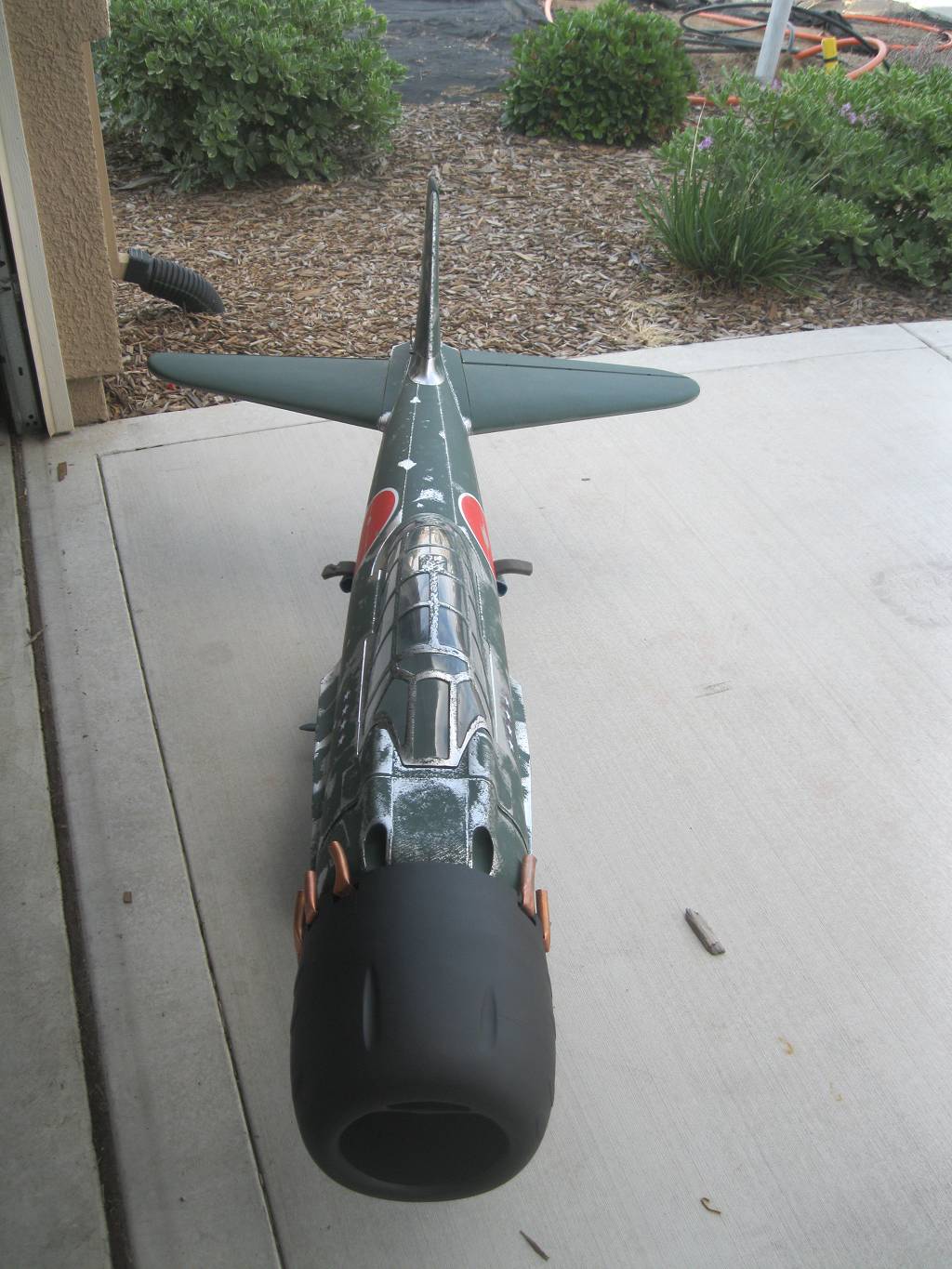

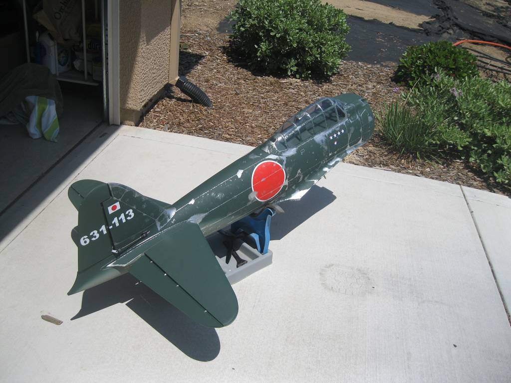

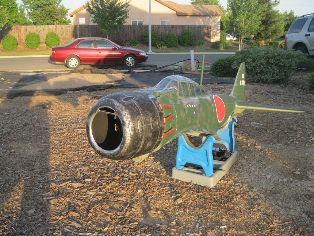

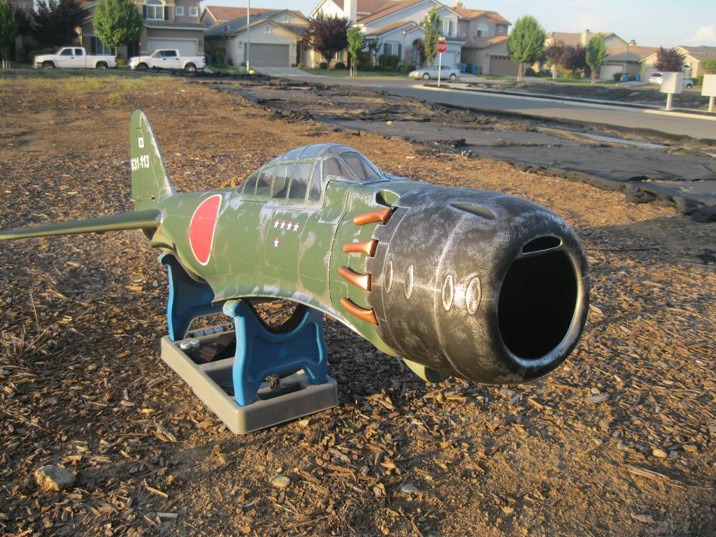

Glad to see you bring that beauty back out!
here are a few more pics...
it may be abit much for some, but I really wanted that worn paint look, and not the chipped so much. I wanted it to look like it was worn down in the Pacific sun and sand. I went alittle heavy where the pilot would enter and exit the plane. I'll work on the cowl abit tomorrow if I can. I have to figure out exactly what I am going to do on the wings and tail....I guess I'll figure something out...
When I'm done, I'll hit the whole plane with steel wool to really distress it abit more.
I'll heat the copper pipes up red hot with a torch as well, this will give them a well used look.
Casey

That's a really good job! I like it in front of the canopy. Where the sun has beat down on it the most. Looks great on the top surfaces. Maybe you can think about carrying that effect out towards the back of the fuselage on top by the back of the canopy. And then the tops of the wings need to look like the top of the fuselage. I'm looking forward to the finished project. Good luck with that black cowling LOL you're doing a great job I like what you have done

Thanks 77chickenhawk,
that's probably what I will end up doing to the wings and tail, as well as the rest of the upper fuse. I've found that if I dip the sponge in the paint and then blot it until its almost dry, I can get a nice, random stipple effect.

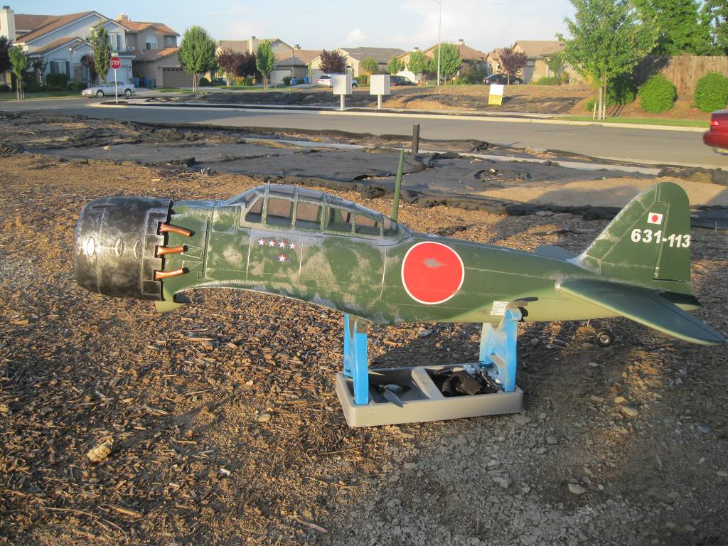

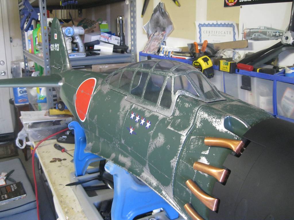

I got a moment to work on the cowl abit. A little blending here and there and the fuse will be done. I will probably put the tail wheel in that I have from Earl Anune.
http://jensendesigncom.ipage.com/store/page2.html
man this has turned out much better than I had imagined...that silver paint was the way to go, it really pops in the sunlight.
