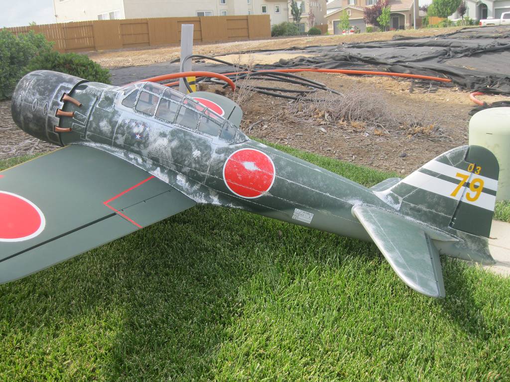

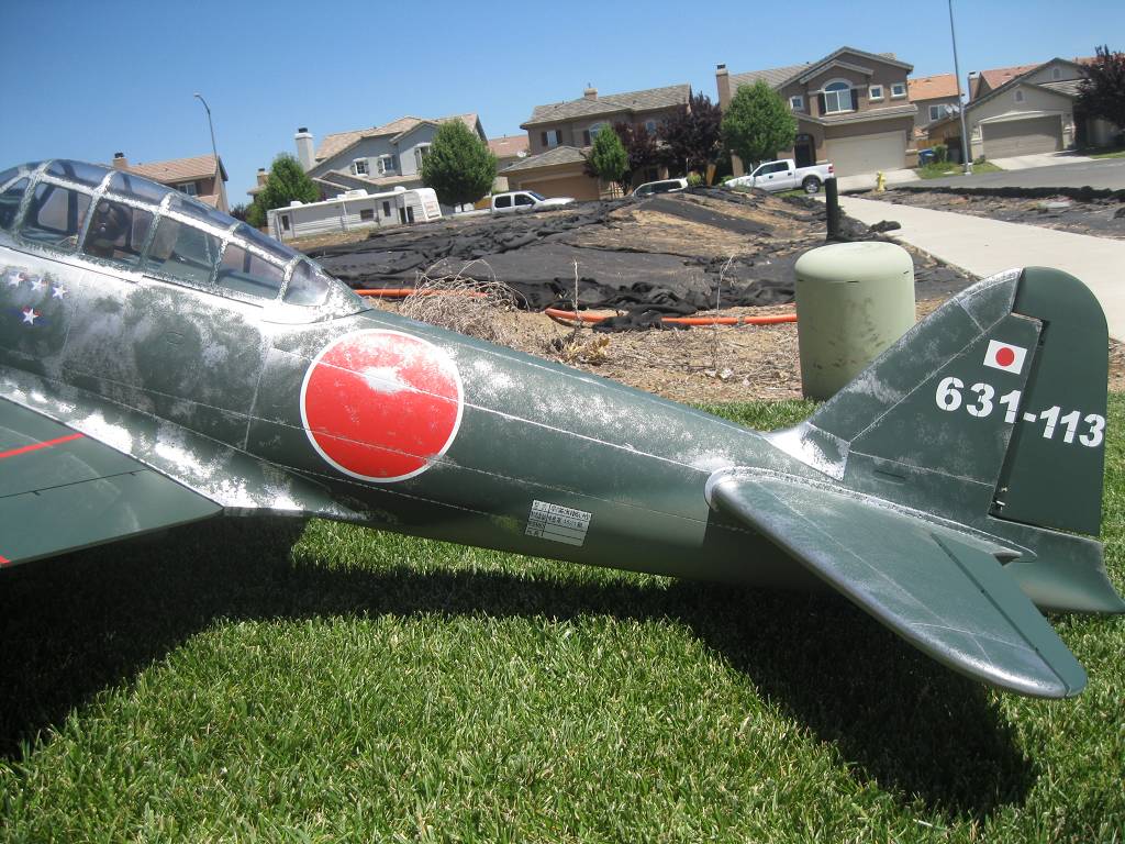

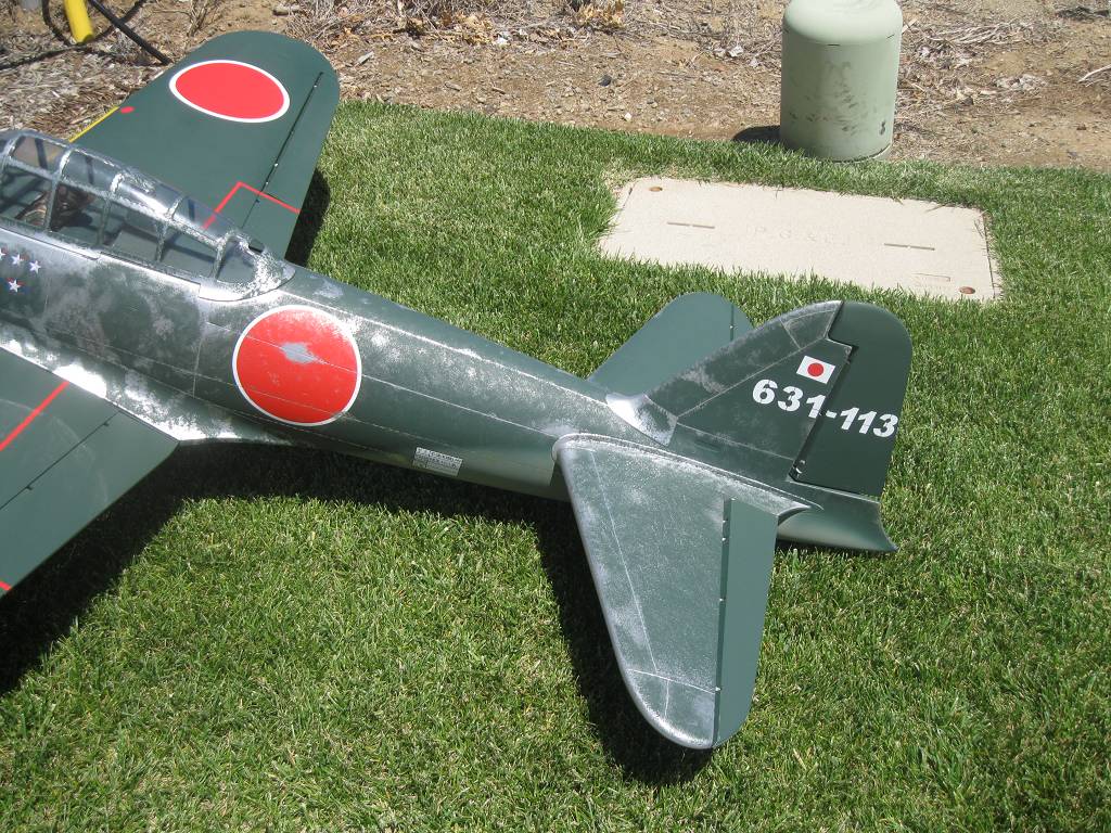

Well, a little progress made. I've "faded out" the rear upper area of the fuse, bringing it down the sides just abit. I've also started messing with the panel lines, and weathering of the horizontal. I started by using a silver pen to draw them on, then painted over this using a sponge cut to a wedge. Then I would blot out a sponge until it was almost completely dry. This was what I used to "fade out" and wear down the paint.

You can see in the first picture how lightly it is been applied to the upper portion of fuselage, Then in the second and third. You can see how sun on the silver paint really makes it pop.

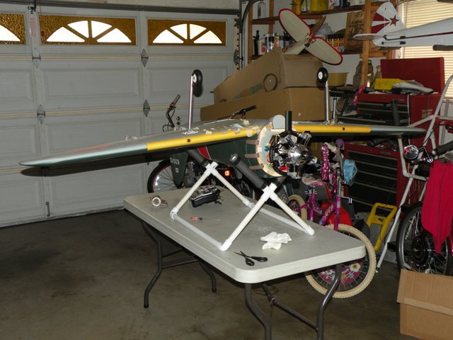

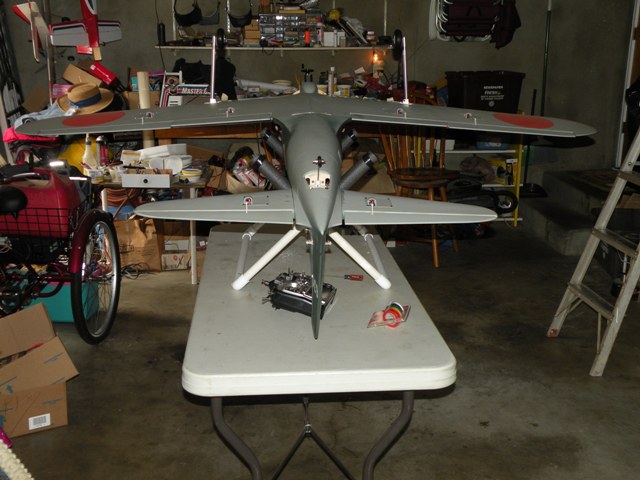

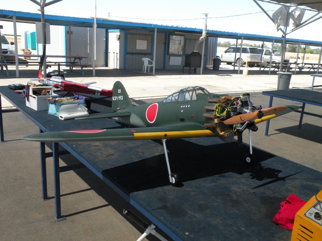

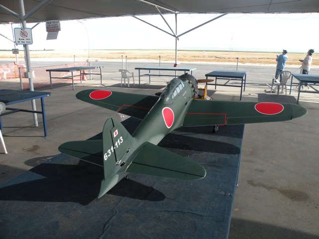

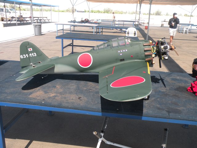

I am making more progress on my ASP 400 radial engine powered CMP Zero. It is nearing completion and should be ready for first engine runs in the near future. I completed installing the radio componets and the batteries today, adjusted the control throws and also checked the retracts before I glued the retract inserts into place. My luck continues to follow me though, because one of the retracts quit operating as soon as the inserts were glued into place. Oh well, I just have to have a few challenges in every build I do.

My ASP 400 radial engine powered CMP Zero is now ready for engine break-in runs. I pre-oiled the engine well. First I removed the valve rocker covers on all five cylinders and oiled the valve train well. I also placed oil in the crankcase vent and hung the engine nose down. Oil was seeping from the front prop bearing and the valve push rod tubes. I rotated the engine frequently to insure that oil was distributed through out the engine. I sure hope that the engine is now well lubed and I don't have any premature faliures due to lack of lubrication. I noticed that the valve train was quite dry so I'm sure it was wise to do the pre-lube. I still have a problem with one of the ESM electric retracts though. The motor runs continously and nothing happens. There does not appear to be any way to disassemble the retract so I guess I will have to return it to TBM.

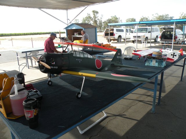

I had the good fortune of running my ASP 400 five cylinder radial engine for the first time today. The engine started easy and ran quite well. I managed to get a full hour of run time today. The engine is running pretty well and I am not sure how much more break-in time will be necessary before beginning to fly the CMP Zero. Here is a short video on one of the latter engine runs http://www.youtube.com/watch?v=7u06n...ature=youtu.be

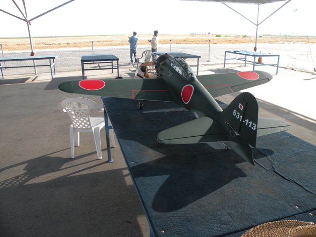

The maiden flight of my ASP 400 radial engine powered CMP Zero did not go well today. The flight started well, it took off nicely, had plenty of power and only required a small amount of left and down trim. However, a minute or two into the flight, the engine began to loose power. We pulled the power back and gained some power back but not much. We had plenty of altitude so we set up for landing. The weather was a bit on the breezy side with a quarting wind. Everything seemed OK on the landing aproach until about one foot above the runway we caught a strong gust that popped the plane up to about three feet above the runway at a speed that was too low resulting in a stall and fall to the runway. We could have prevented that if the engine would have responded to throttle but it would not. The fusalage is in perfect condition but the stall and fall did considerable damage to the wing. The landing gears went through the wing on both sides. My good friend and I do these maiden flights together and he felt so bad about the damage that he took the wing home to repair it (he was on the sticks for the landing). The plane seemed a bit on the tailheavy side for landing but seemed OK for flying with the CG set per manufactures specs at 145 mm. I am not sure why we lost power on the engine but the most likely cause would be going lean during the flight. I had the needle valve open two turns and the engine ran great on the ground. This was a disappointing day but all is not lost and the Zero will probably fly again.

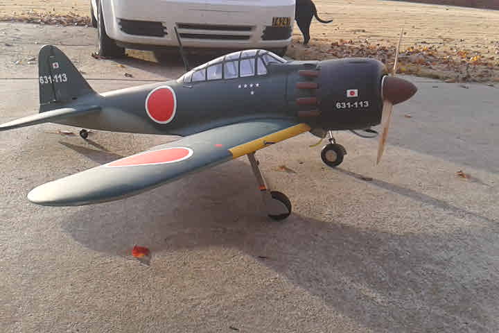

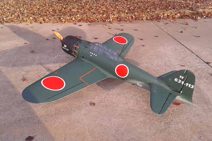

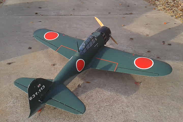

We here is a pic of mine. I am almost done with it. All i have to do is test run the engine and then put the cowl on. I hope to do the maiden this week is the weather holds

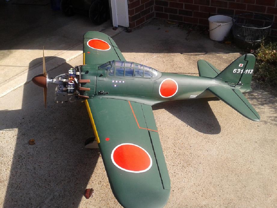

Well I am done with the plane and it weigh's in at 20lbs. I have an RCG 50 for power with a valley view 22x10 prop. I am getting 6700RPM on the high end and a good 1800RPM at idle. I have ESM electric retracts that work great. i have cycled them over 100 times with no issues. Here are a few pic's. I will going doing more detail after I do the maiden.

Nice!! I hope to start mine after Christmas. How much, if any, weight did you add for balancing?

This is my second CMP Zero so I knew it needed a lot of weight up front. I desided to build up the cowl and firewall area with some Fiberglass to strengthen up the front. When we were done with the cowl it weighed 1.5 lbs and feels like it is as solid as a steel door. I also used 3/8" plywood and cut a new cowl ring from it. There are five layers of fiberglass on the inside of the fuslage nose area. All of that fiberglass added to make this Zero a lot stronger then the original one. After doing all of that and installing a RCG 50 for power I still had to add 6oz of weight to the front of the cowl to get it to balance at 6"(155mm). I hope this answers your question?
