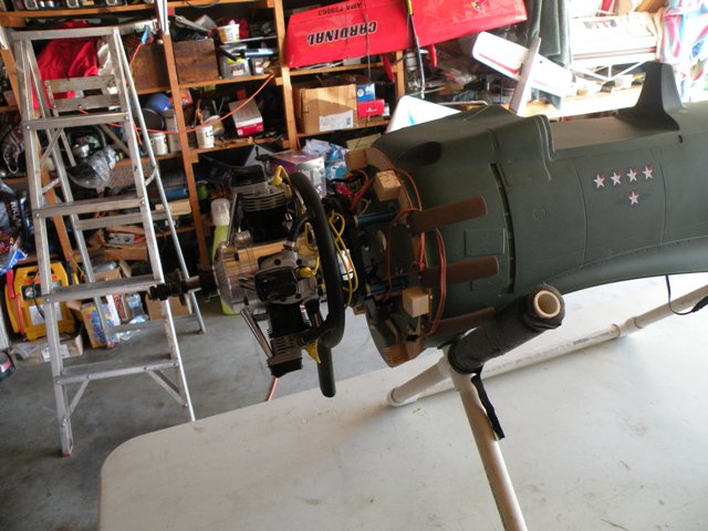

Here is my current work in progress - CMP Zero powered by an ASP 400 five cylinder radial, Microsens on board glow system with balancer and Kelco Exhaust ring. This project is moving forward but progress is slow. Someday, I may even finish it. One thing for sure, I will do some serious pre-oiling of the engine before it runs for the first time.

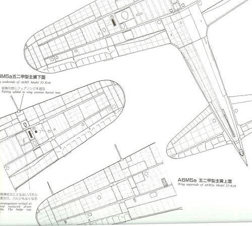

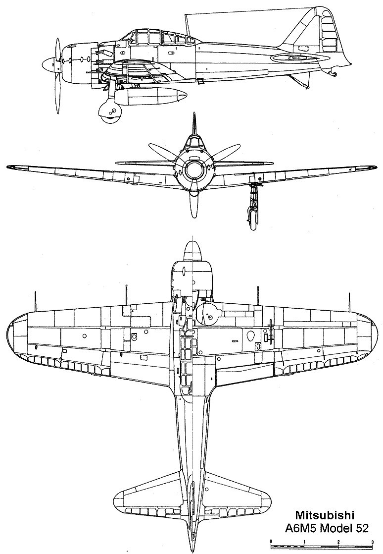

Hey would any of you gents happen to have even a basic set of three views that shows panel lines (that you could post)?
My thoughts are.... I could paint the panel lines on the wing and tail surfaces, and then weather accordingly. I just don't happen to have any books on zeros, and in my initial searches the web, I haven't found any three views that show panel lines.
Thanks!
EDIT - I just ran across a set, thanks guys
Casey

I do have 3 views for ya! let me put it together and shoot it to you. What I do is enlarge 3 views to whatever scale that I am building and start tracing

Here's the set I used.
Also do a google search of A6M5 zero images and there is a wealth of nice photos from museums around the world and you can tweak the 3-views from those as well as get a good look at the details that stand out as important to you.
Looks really nice already, though

Those will work perfectly sir!
Thank you!

Glazier,
Looks like fret`s is the same one I have
