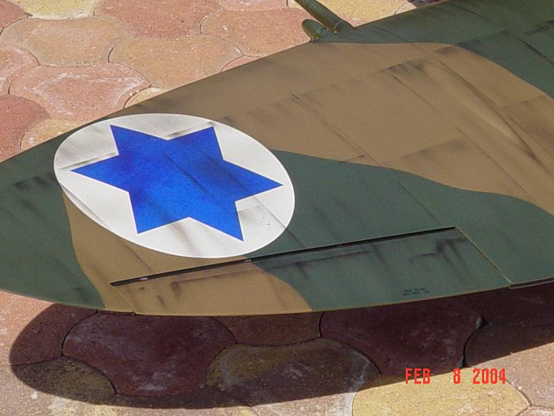

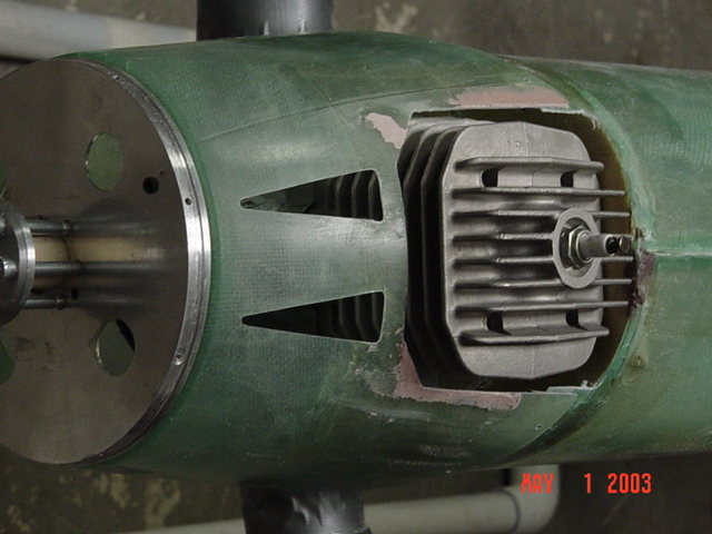

Here's mine. 3w-70 for power and functional scale exhaust. Flies great and floats to landing. Mark.

And to Mark, great looking Spit Mate. I'm sure I have seen this models pictures some where before.
I like it. No doubt you have some good vertical with the 70cc.

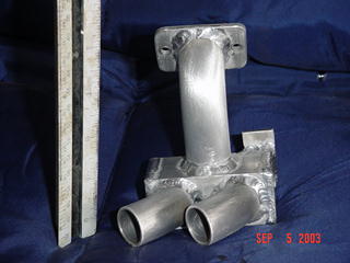

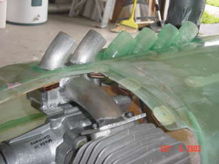

Yes Mark, how about some pictures of the engine install and exhausts.
Did you use a prop shaft extension?
Brad

Thanks Len and Brad. I posted a few pics below. The 3W-70 fit rather well into the nose with a little persuasion. The firewall former had to be released from it original placement in the fuse and set back about an inch or so in order to obtain the correct protusion of the driveshaft from the fusealge tip opening. Then I created a customized firewall to accomodate the engine. The muffler also worked out very nicely. I wish I could take full credit for it, but I "borrowed" the idea from Evan Quiros who did the same thing in his YA Spitfire. You can see the muffler placement in the pics, too. I also attached isolated pics of themuffler after I fabricated it.
