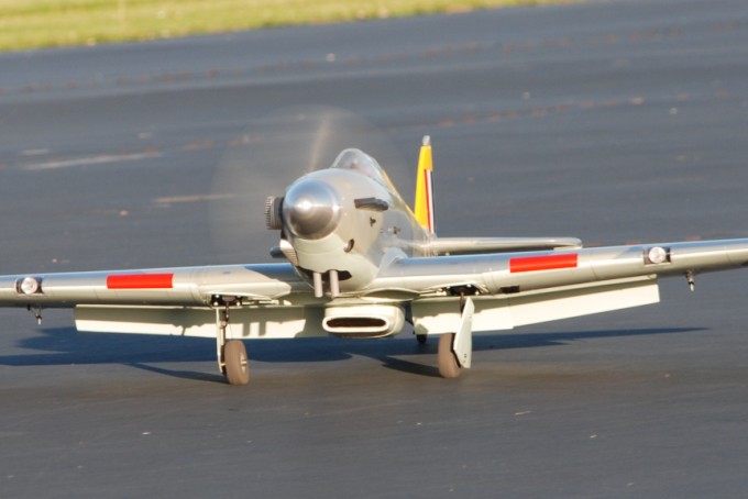

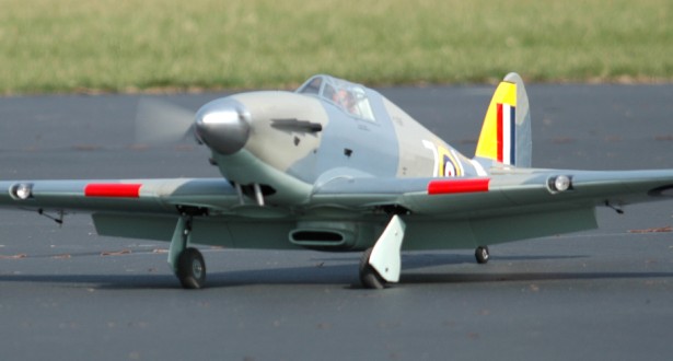

Default RE: CMP BF109F BUILDING THREAD
I have a VQ .60 size Hurricane. It flies fine and is a pretty nice plane. I stuck some Robart mechanical retracts on mine. Legs are a bit close together. Not as good a deal as the CMP 109 though.

Excellent pics! I'm not trying to bust up the CMP 109 thread...but I couldn't resist when I saw the urricane in the pic.
I've ordered my 109....
time will only tell now.

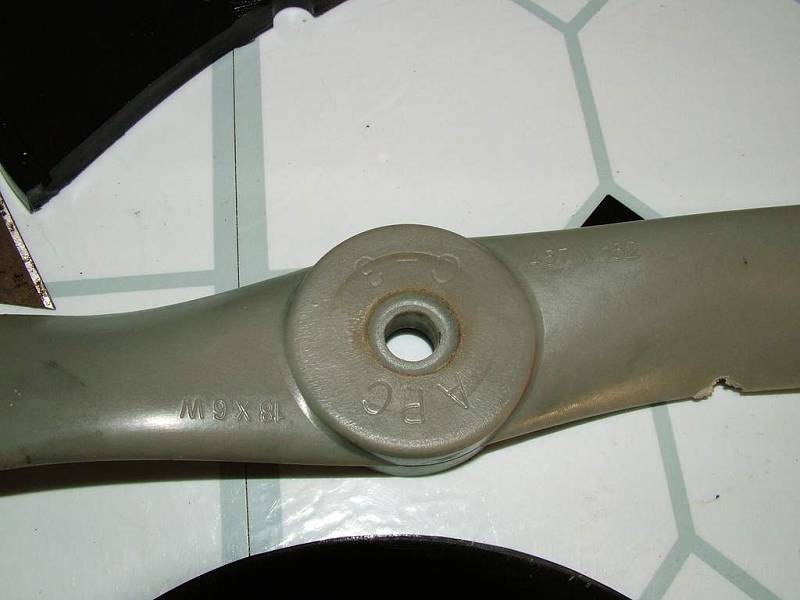

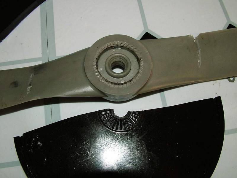

i see that you guys dont like the spinner, are these things exploding while at high rpm???
here is my solutions to the spinner 1 my setup was a ASP180, APC 18*6 prop and the trusty spinner...... 1 (engine mounts) throw away the one that comes with the plane, it will only end in tears if you try to use it as its too flexible hard mount it in a fassion like I have shown a few pages back......2 Prop the APC has a large hollow section on the back of it, this plays havoc with the spinner so you need to fill it with epoxy putty, but here is the trick as you do it bolt the spinner motor and prop together hard before it sets, this will put some groves into the putty in the corect place for grip on the spinner, you have to be accurate with this, then ballance the prop using the velcro method and do the same to the spinner if you dont fill the back of the prop the contact point on the back is very small and will cause it to snap........ 3 spinner screws CHUCK THEM IN THE BIN they are very soft and will break, get some cap screws m3*10-12mm

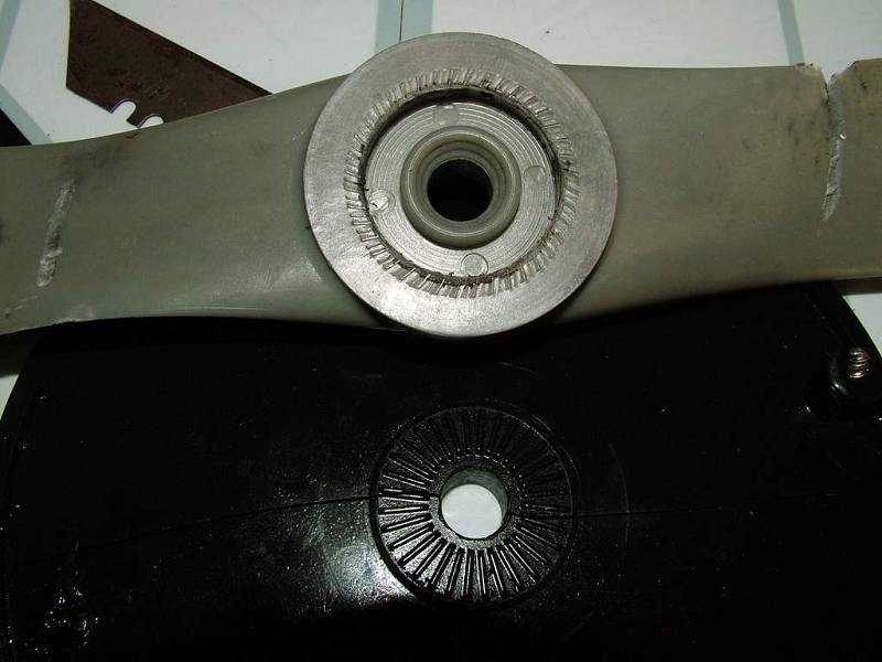

If you look at the spinner you can see a raised grip area on both sides for the motor and prop to bite into, then look at the prop you can see how little contact the knurled "grip" made ,what I did was fill the cavity on the back of the prop like I stated above giving full contact between the prop and spinner

Its not a big issue when using an electric motor IF using say an APC E style prop. There is plenty of surface area, but good suggestion when using a normal APC prop

LOLOLOLOLOL yeah a big thumping four stroke doesnt have a soft start...........

When I saw the raised section of the backplate, I machined mine off. Still the backplate will fail. If not at firstt, then on the slightest nose over.
I turned a 4mm aluminum one for my spinner. Its seems to correct all the wobble.. Secured the same way with 8-32 socket screws. My only concern is the large 4mm backplate I made may bend my engines shaft upon impact. Unlike a plastic one that may break and absorb some of the impact. I may drill holes or make a few groove in the backplate to make it a weak point.
Note: On start up I would keep everyone and everything extra far away from the front and sides of the the spinner/prop arch if you use the factory original backplate.
Steve

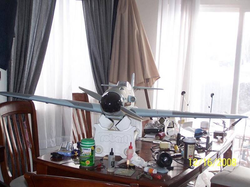

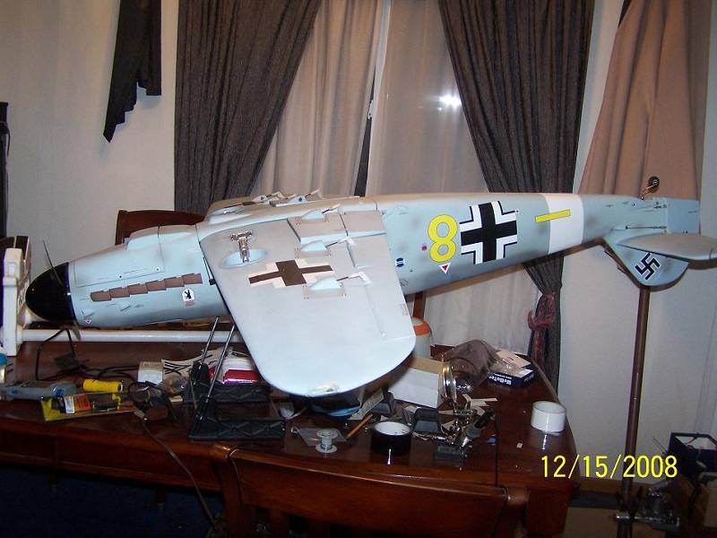

Well, here are some pics of mine. I am still thinking of adding some yellow paint to the chin scoop area and plan on eventually adding the spiral thing to the spinner(I just havent found thin masking type tape to do it yet).
I honestly like the looks of this plane better then my KMP overall. What I dont like is the fragile nature of the fiberglass. When I was drilling out pilot holes for the screws(hexbolts with blind nuts) to secure the chin piece, a chunk of the fiberglass broke off. It was small enouhg to keep hidden when the chin piece is affiex, but still it worries me that with regular repeated landings, the plane will start to crack apart in places. Already, I have large paint cracks around the vertical stab area. But, this plane just looks so good, I may get a spare from AK.
Note...I used window screen mesh material on the face of the turbo airscoop just like the real plane and the scoop is functional to direct air onto the 2x 5s 4900mah lipos
