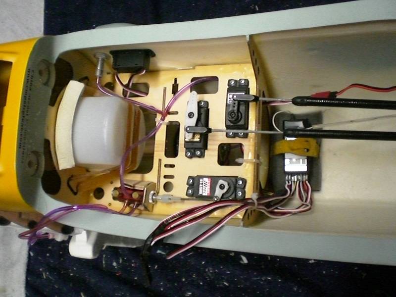

nope not yet the electrics are not set up as yet that just was a temporary setup to check the motor, so how is everyone routing their electrics? I did try the magnet thing for the air vent but was not happy with the result... glued it in the end, what about the routing of the servo leads and air leads from the wing? how are you doing yours? are you using extension leads from your receiver? or plugging straight in

I'm using servo extensions. My air retract system,along with the servo and air valve are all in the wing so I don't have to worry about the air line connection.

I put the Y-connection right where the lead exit the wing. Extensions on the receiver give you something to plug into. Two air connectors for the retracts. Six plugs total, four for the servos and two air plugs.

Here's a photo of how I routed the wires in mine.
