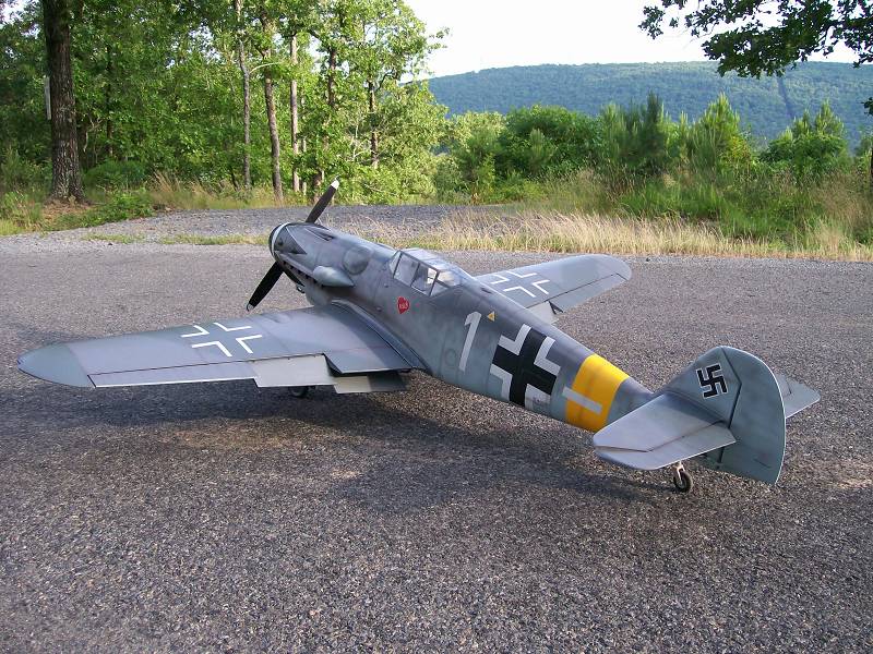

Here are a couple pictures Itook of my CMP 109 which has undergonea bit of a face-lift. I took the pictures in the setting sun and the colors are a little washed out, but you can get the idea. I will send more pictures if requested. Basically, I stripped the covering, filled in the balsa and glassed the wing. I converted this to Erich Hartmann's second G-6 which involved adding humps to the wings and fuselage and painted the bird in authentic RLM 74/75/76 color scheme after adding panel lines. I made the "spoiler" radiator flap fixed and have the flaps all linked with bellcranks and activated with one servo. I drilled out the exhausts for scale appearance and weight and added a more scale tail wheel. I used Shindin retracts moved to a more scale position and raked foreward with William Bro wheels. I have a working canopy with instruments and bullet-proof glass head rest. I use a Saito 180 with Dave Platt spinner. (I had bad experience with stock spinner). The final weight is between 13.5-14 lbs dry which surprised me, but I am please. I haven't flow the plane yee, but still have to add mast and other details and let Poly-U finish cure well. Thanks you all for many good suggestions that I found invaluable during this build.

That is a great looking airplane! How did you mange to drill out the exhausts without breaking them? Iconsidered doing that at one point but I became concerned with the part splitting or cracking on me and then not being able to get e replacement. Ihave been trying to get the wheel wells replaced for mine (they came cracked) and have had no luck.
What tail wheel did you use and is it retractable? Did you leave the steering mechanism stock, or changed it? I am making my rudder a pull-pull and am considering setting up steering in the same manner.

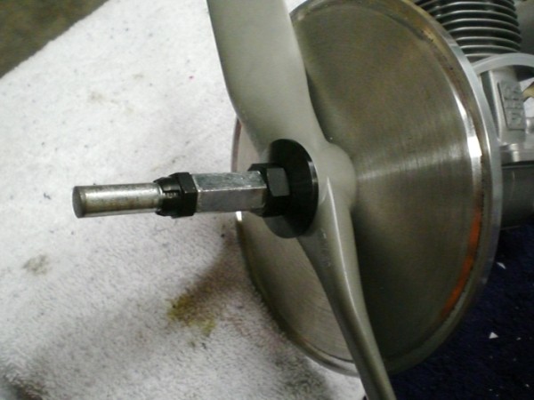

I would also like to know how you solved the problem of the spinner adapter? Were you able to purchase one off the shelf, or did you have to have one made up custom?

I made my own adaptor for the Platt spinner. Used a stand off and a bolt. The stand off is machined so it fits right into the two part nut that came with the OS 1.60. It turns true and has given me no problems. My tailwheel is from Hobby King for about $6. It's a bit stiff as I mounted it but works fine. I could have used some tail weight, so a retractable tail wheel would not have been too bad, I just didn't want to mess with it.

Hey Guys,
Thanks for the compliments, especially since I used many of your ideas for the changes. First of all for the tail wheel, I did just as Hot Rod Todd did with a very similar steering mechanism, using clevis control over the ball link. I ordered the 120 size Dubro tail wheel from Tower, but it looks to be the same. For control rods I made one for the elevator that is internal just as described by Steve (Scale craft), but I am using 4-40 pushrod systems for both the rudder and elevator. I run the plastic tubes nicely through the holes in the bulkheads in the fuselage which places them on the side so that I had room for a cockpit. I was concerned about this at first but because that are secured by each bulkhead, there is not slop at all and very little binding if you make sure you line up the holes in the bulkhead precisely.
For the spinner adapter, I ordered a Vortech xx-long adapter from Dave Brown Products and it fits perfectly( $8.95). He has them in nearly every thread imaginable.
For retracts, I got the Shindin Machine ones for the KMP 109. The quality is great and Lenny is easy to work with. I used these so that I could move them inboard rake them foreward. I am spinning an 18 inch prop and even with these longer retracts,I get only 3-4 cm of ground clearance. I use the technique discribed by scalecraft for the location and rake, but I mounded the retracts on a 3/8 " plywood u-shaped plate that mounts to the repositioned beams inderneath. In the event of a bad landing, it will usually break between the plate and the beam and save the wing. This is easy to repair. The well wells are 1/64" ply which bends pretty easlity around corners.
I cut out the air intake and added a screen and for the exhausts I used a dremmel with an olive shaped burr and carefully drilled these. I did crack one and just used a little epoxy and microballons for a quick, sandable repair.
I think the quality of this bird is crazy for the price. The covering really was pretty good and held tighlty when I tried to strip it. The balsa of the wings was maybe a little soft compared to what I would have used, but not that bad. The spinner is a bit dangerous (I bought two and had one backfire and literally explode) The canopy is not the prettiest clear plastic, but it held together when I cut it up to make a functional canopy. I wish I could get a Galland hood to make Hartmann's G-14, but I am not so good making canopies. I built the Platt 109 in the past and this looks as good and is lighter which I can't believe. I flew that baby at 15 pounds with a 90 back then!
I added a couple more pictures, but I will take some more in the shop. That was my son's camera and it does poory in bright sun. Thanks to all you guys who have given me these ideas.

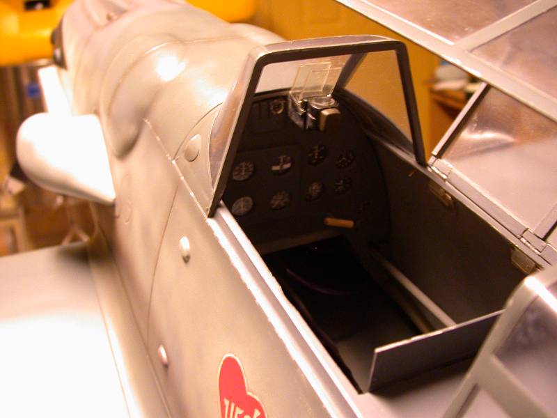

Ineed a figure for this plane to finish out the cockpit below. I have a Dragon figure Erich Hartmann, but I really need a flight helmet for this. Blue box used to make a Luftwaffe pilot with nice gear but I can't find it any more. Any suggestions?

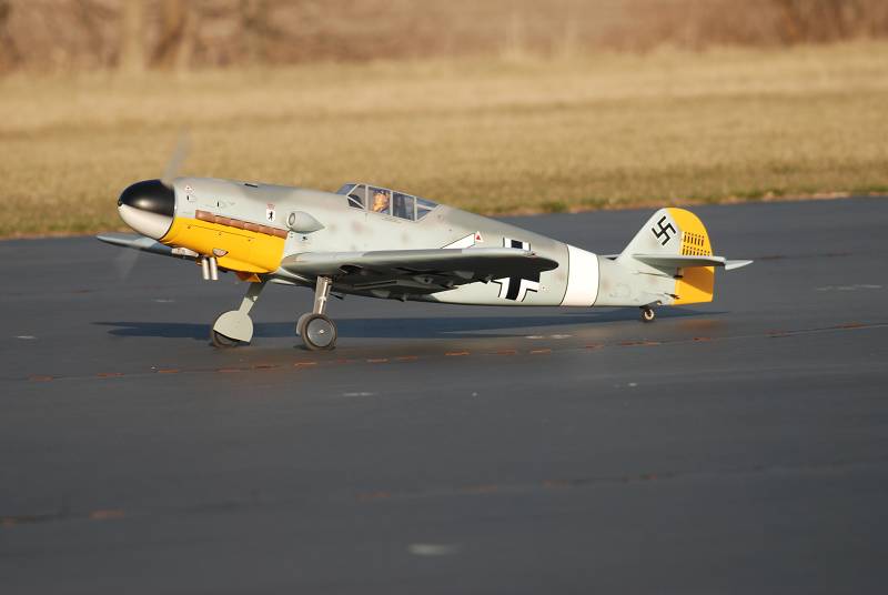

Paladin, what did you do to add all the weight to your plane? 18.5 lbs is awful heavy for the wing area it has. It will fly, but it won't fly slow. You'll have to come in fast and allow plenty of time to build speed on takeoff.
Sethorion, I would not think that moving the gear would be worth the effort. It will make the plane ground handle worse, and you would have to completely change the wing structure to get the gear mounted farther inboard. The gear is not halfway down the wing, but it is a bit farther out than the real thing. Getting the gear long enough and the wheels big enough will also be hard. I think the gear looks pretty good at the field, and I haven't had any comments about the stance being too wide.
