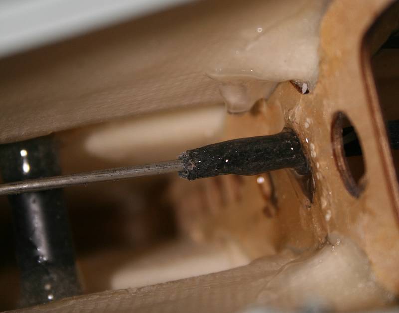

i ran the epoxy i used to fuel proof the wood up onto the foam about a half inch from the maple EM, just to protect the maple. i don't leave my planes inverted for any length of time, so the foam is unprotected. never had that problem yet, if it gets soked i'll scoop it out and refoam.

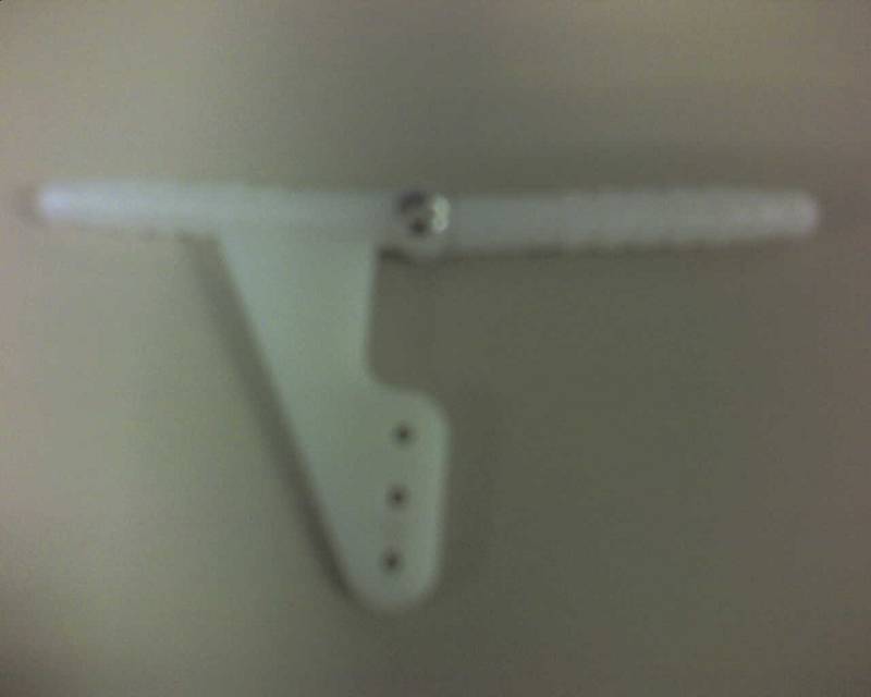

I also have a question for the forum: Has anyone found a replacement for the control horn/hinge combo? I am afraid the one's provided in the kit are a bit weak; they seem to have quite a bit of lateral play. I plan to replace the kit supplied hinge points with Robarts, but I can't find a manufacturer that makes a model with the integrated control horn like the one shown below.
I am also looking for a replacement for the one with a dual horn like the one used on the rudder as well.

Thanks again for the reply. I will use the Robarts for the pin hinges, and the kit supplied with the control horns.
I will have to do some research on which Futaba servos meet the specifications, and use them for control.
