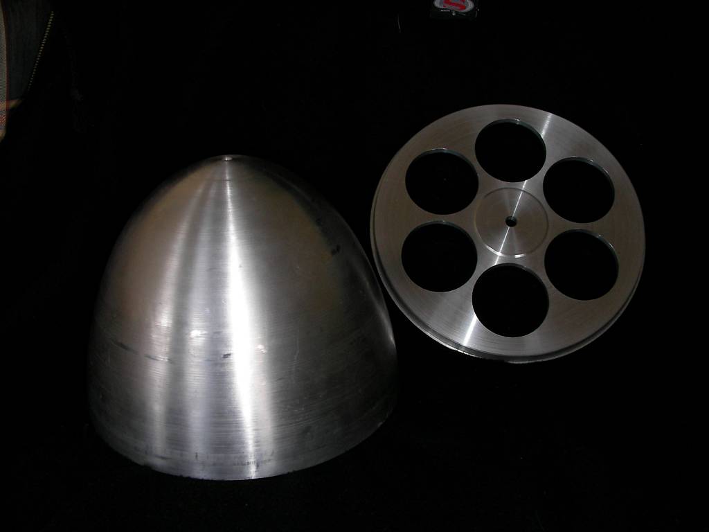

Somewhere in the early posts I have pics of the CMP spinner with my aluminum back plate I turned for it. It works. Or check youtube for "CMP 109" . I put my first flight on there.
But i stay clear of all my spinning parts on any plane. And keep them away from others as well. .Always
Steve

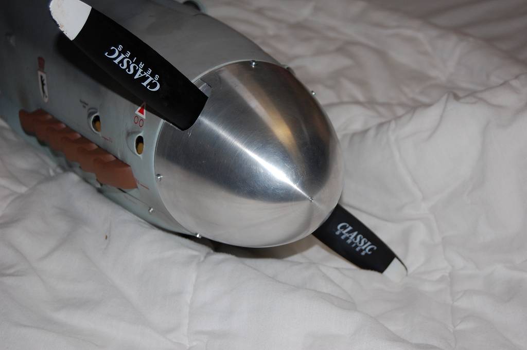

The promised pics.
regards,
Eric Schumacher, Netherlands

Thats a very good looking spinner. Down side is that its more than 1/2 the price of the whole airframe!

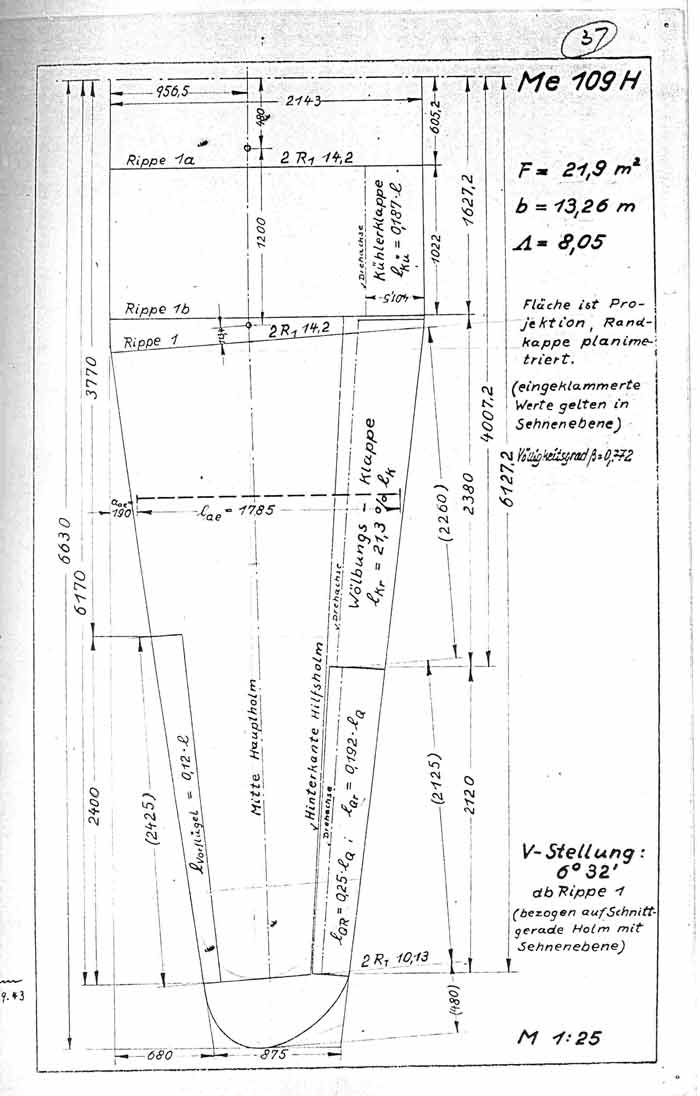

Stumbled on this thread and it's really interesting to see how scale this CMP ARF can be made. Just wonder if anyone has ever thought of converting the plane to a BF109-H version. A couple of H versions did fly over france but was later pulled out of production/service due to problems in wing fluter.
Any how, the H version has a wide wheel-base and big wing, so should cure all nasty landing habits? plus the wing mod is probably just adding in a centre section?
here're some pics. I've a few actual dimensioned blueprints of the BF109.

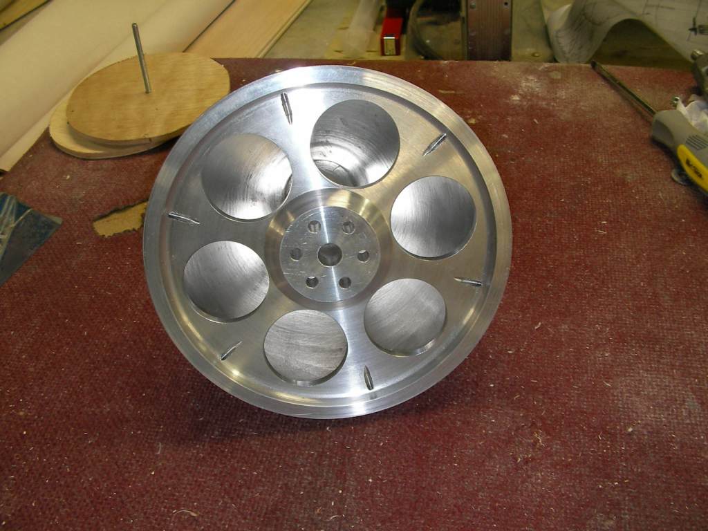

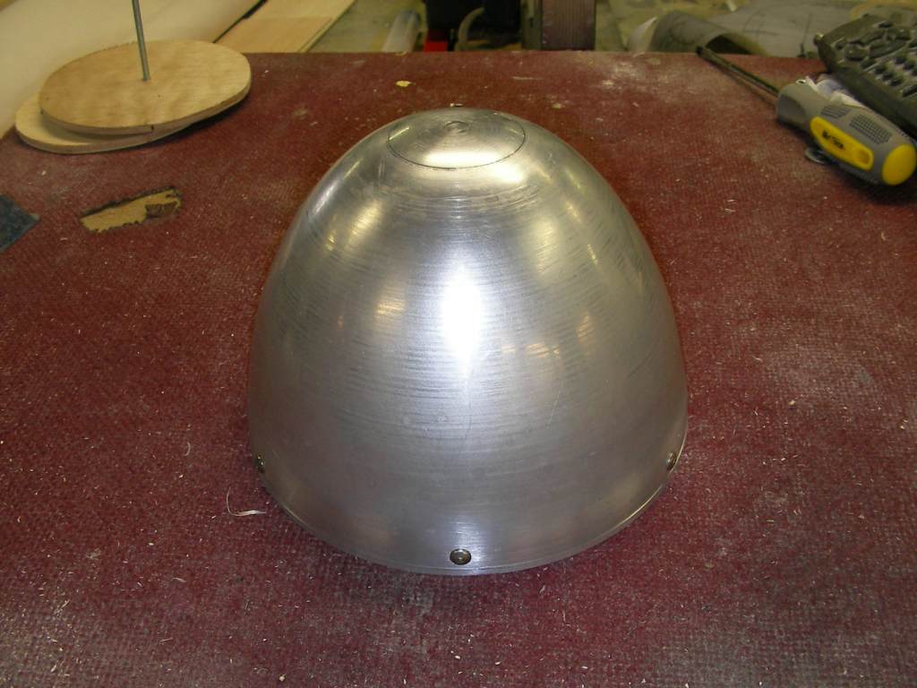

I was looking at the new pic's of the CMP advertisement and that ugly spinner that they have out on it. I was just wondering if there would be any intrest in a scale spinner for it in the $80 range? I have spinners for 2 other size me 109's . The start up cost is the worst for a new spinner and i would have to have about 10 people wanting one before I could get one made...
Here are pic's of my other spinners.... 6.25" and a 7.25"
