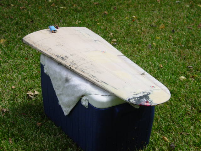

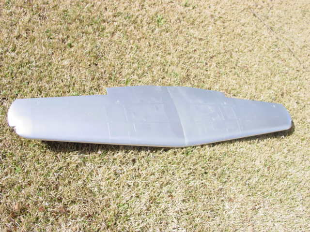

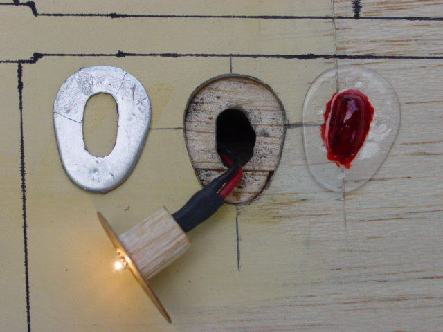

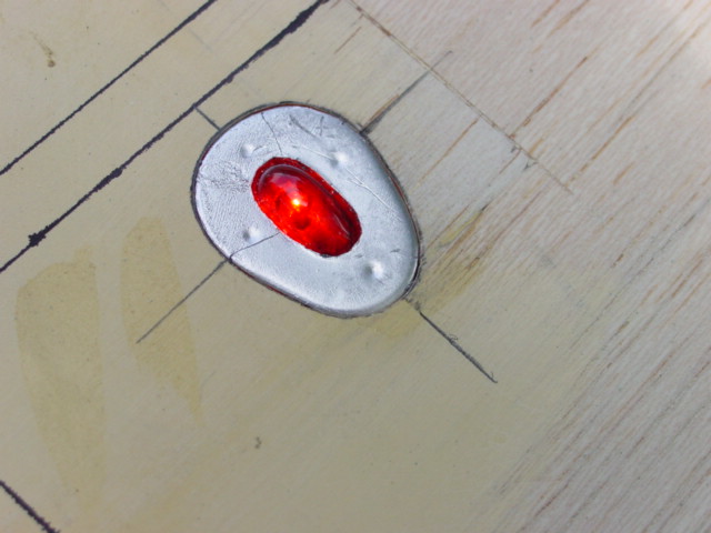

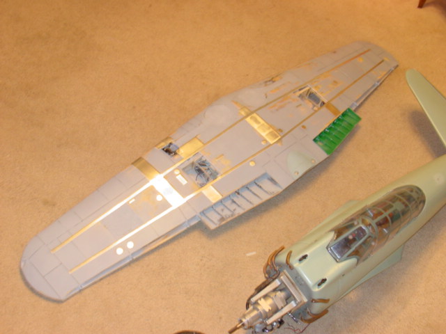

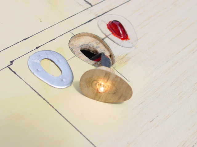

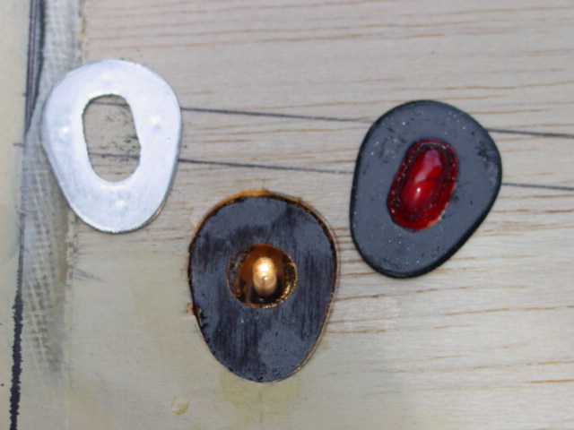

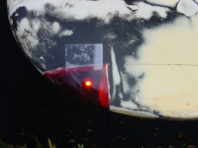

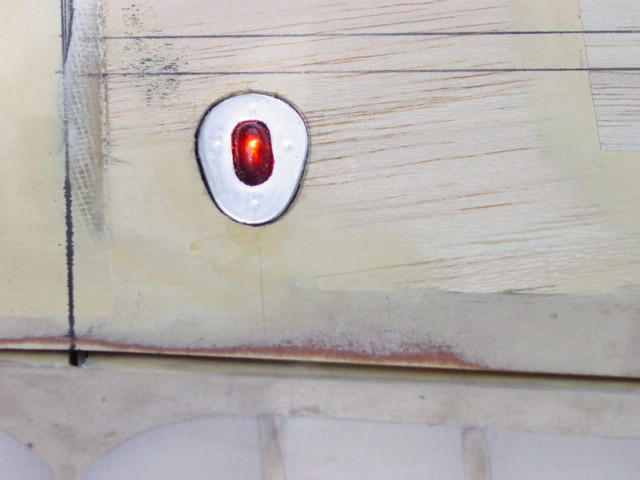

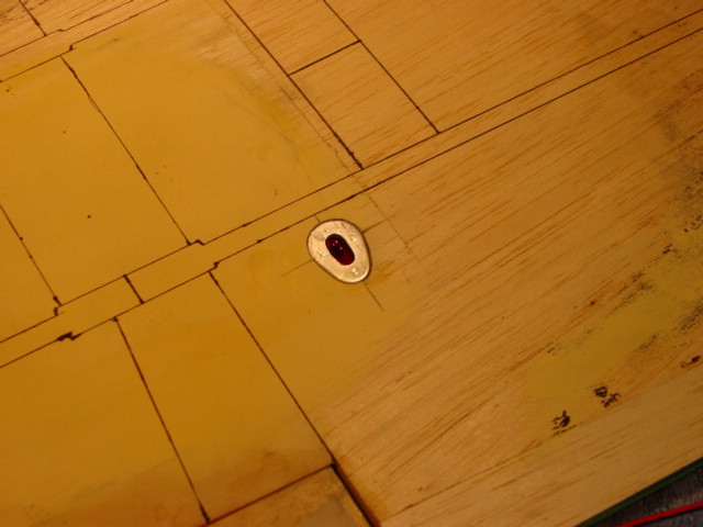

Back to the wing and some progress. Lighting is installed, tested and lenses/covers molded and formed. Left side now done and ready for joining and glassing. How did I ever get anything done without a vacforming set-up?[&:]
The lites are actually pretty bright and readily visible in the sunlight, camera doesn't pick it up so well though. All seven (7) lights can be lit with a single pair of AA batteries (3v); 5 xenon bulbs-2 in each wing top and 1 in the tail, plus 2 led bulb assy's (1 in each wing tip). Each of the lights are individually servicable without cutting or rewiring; basically PNP. They will be switchable by a micro-servo actuating a micro-switch.

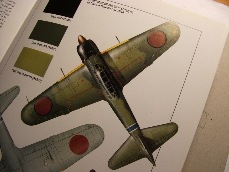

Not too much progress on this end over the last several months. Business has been just ridiculously busy, which is good for the finances but hard on family life and leaves precious little time for any meaningful progress on the build.

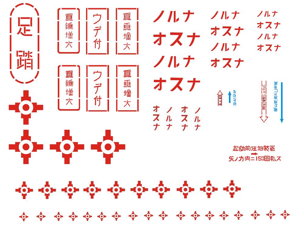

Anyway I have finished the glassing, joining of the wing halves and all of the chart-tape panel lines. All of the ink reference lines are done on the wing top and bottom for the foil panels and now I'm getting some of the foil tape panels done. About 80% done on one half of the wing underside and 15% of the other underside.
I am quite pleased with finishing my "definitive" IJN/IJA A6M Zero nomenclature package. Finally able to work the bugs out of my graphics program and maintain the clarity editing through several cyles of opening and saving edit sessions. It seemed I was chasing my tail for a long time with having to re-do things that had been finished in previous sessions that got corrupted or blurred in subsequent sessions.
I'm doing 61-108 so the ryanmark/ID stencil reflects that specific plane as well. I was able to produce a nice clear set of waterslide decals from the raw files and am sending a graphics package to Vicki at Getstencils.com for a price quote. Whether I end up using the waterslides of having her make me some dry transfers, get stencils will have the stuff in their inventory for future wants, needs and desires.
Still have to erase the dk green from the tail numbers, clean up the outline and monochome it. I may just make a mask and paint this one...It's plenty big to work with.

She had these before(attachment) and admitted that they were just "something we came up with that 'kind of looked the part' "
At some point soon I'll put up a placement guide for my set. The red page is almost self-explanatory but the black page is a bit of a wonder. There's two sets of three strut tags, two tail gear tags, arrows for the pull down step, arrows for the tail lifting/jacking point, a CG datum and all of the little tags for top and bottoms of the ailerons, elev's, flaps and rudder.

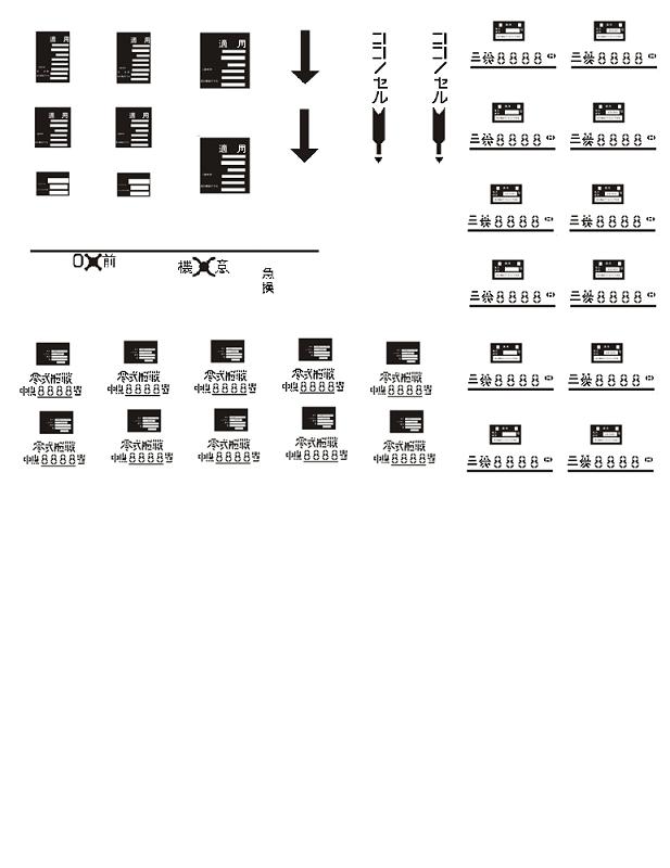

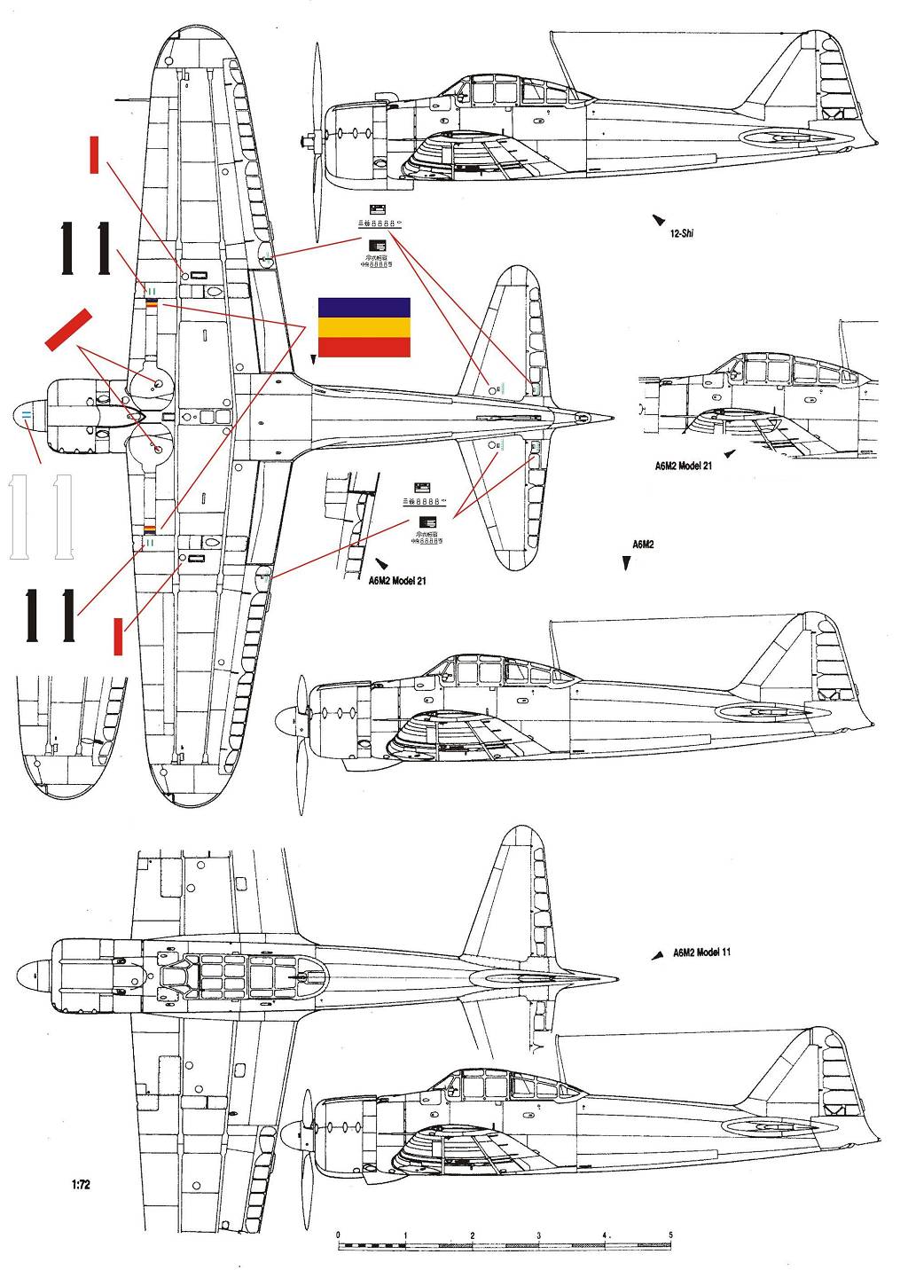

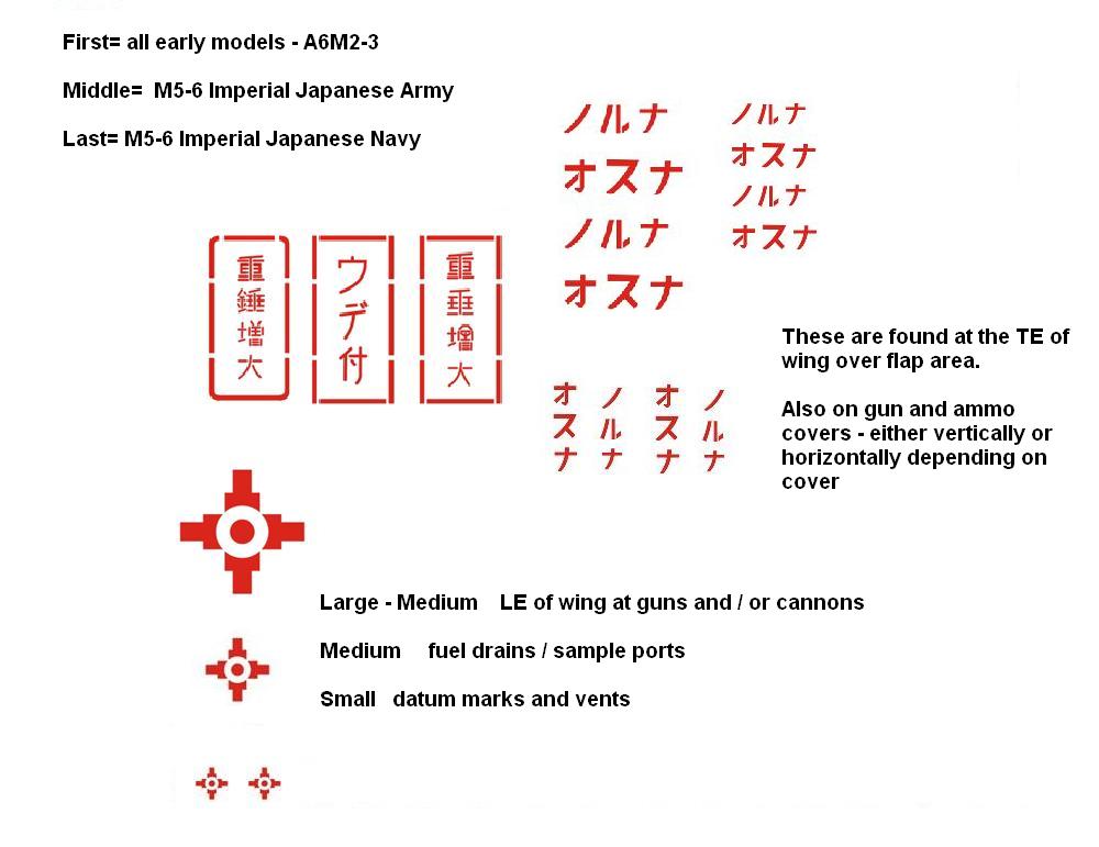

Per your request 77CH, and as promised above.
I made up the proofs to cover just about everything as there were some minor differences between Imperial Japanese Army and Navy as well as early or late models. I like the research and figure if I'm going to do it, I might as well do it as well as I can
The little 3 character "no step here" figures were usually always along the back of the wing over the flaps and had, more often than not, been walked on so much that they were well worn...is that irony?
The same figure some times appeared on gun and ammo access covers in both the vertical and horizontal orientation so I included a selection of sizes and orientations to fit all needs.
As far as the covers there seems to be no rhyme or reason to what's marked and what isn't...the same cover between right and left may only be marked on one side and a different cover on the other. In other words there are four panels on each wing for a total of 8...there may be 7 of them marked on one plane, three on another, and only two(both on the same wing) on another. Some had none. There's enough figures to do all 8...your choice whether to make it random.
Circles and dashes I plan to paint and if anyone decides to get dry transfers I'm sure they can do a page of circles and dashes and send off the proof/draft or copy them on to waterslide paper themselves They're on the placement chart, just not on the proof sheets.
The proof sheets are 8.5x11 and should download in 1:6 scale. The placement charts will expand in the quickview online and download to accomodate a 14x20" fullsize print

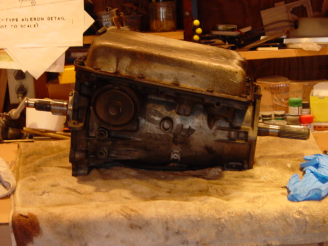

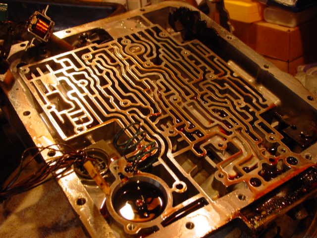

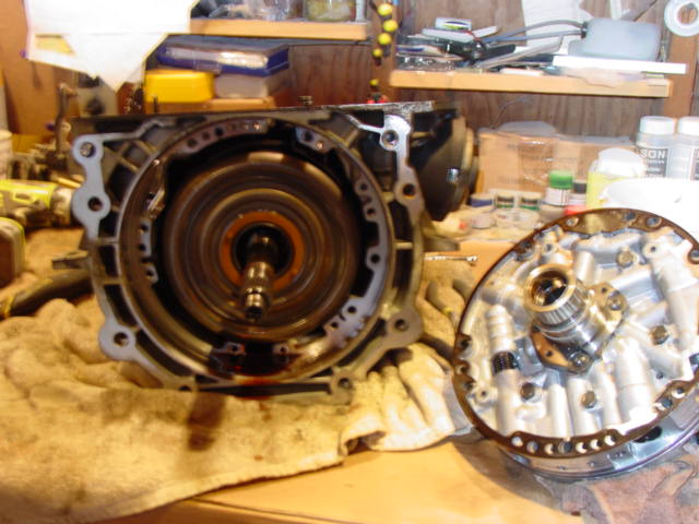

This is not the crap that I wanted on my bench for the past few weeks!! []
I guess shipping the boys off to school doesn't really change much...I still get all of their repair and maintenance jobs. This is the transmission from one of the boys' Chevy SUV. They thought it would be great fun to drag BIG rocks around a field with a cable/tow-strap. There went the first gear package and the sun-gear shell assy......I think sometimes my kids could screw-up an anvil with a feather.
It's done now and I can get back to more pressing issues....finish the Zero

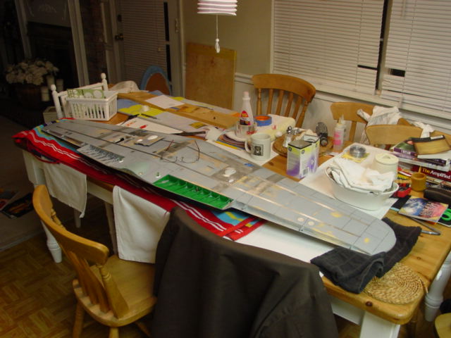

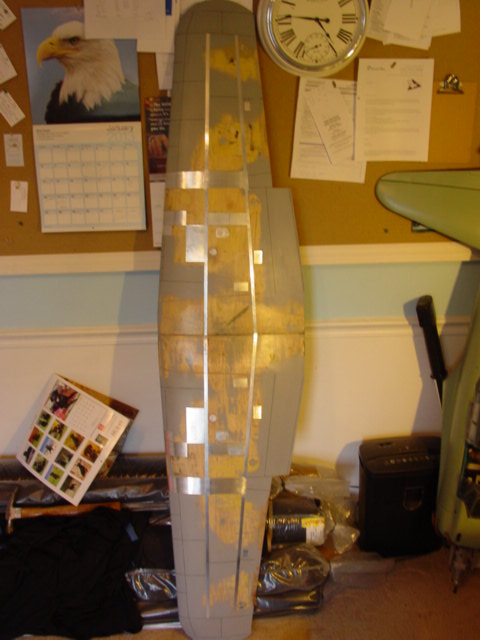

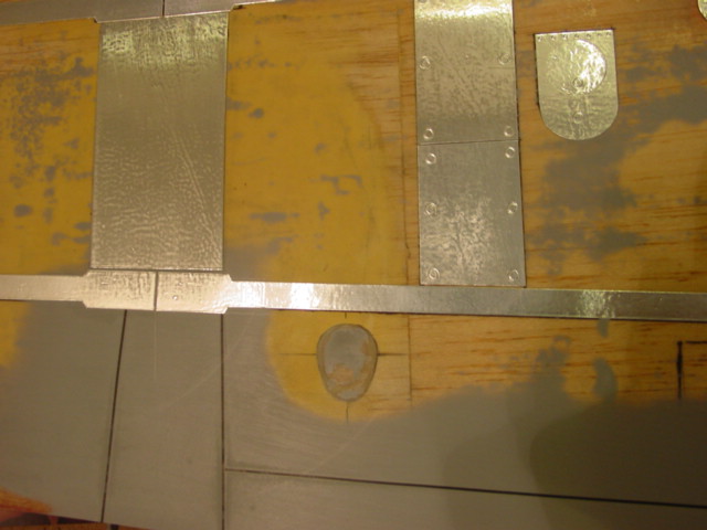

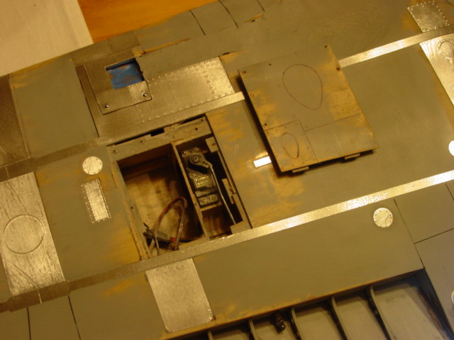

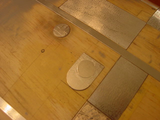

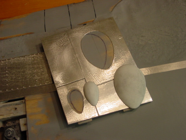

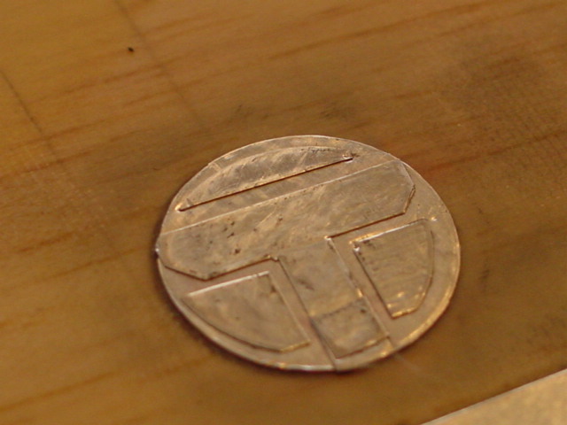

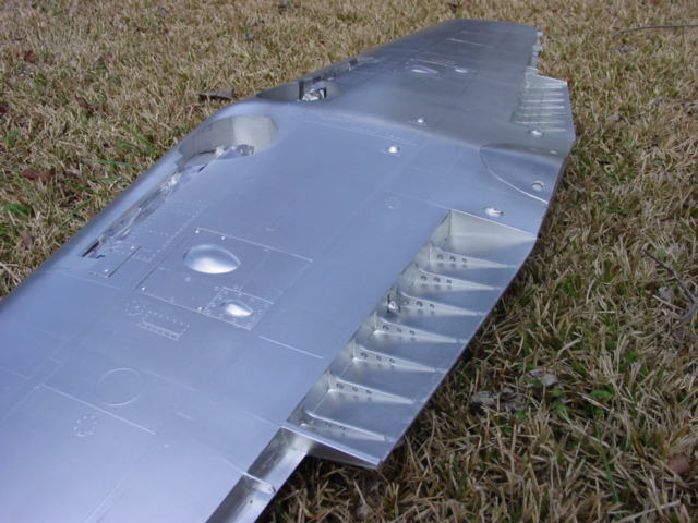

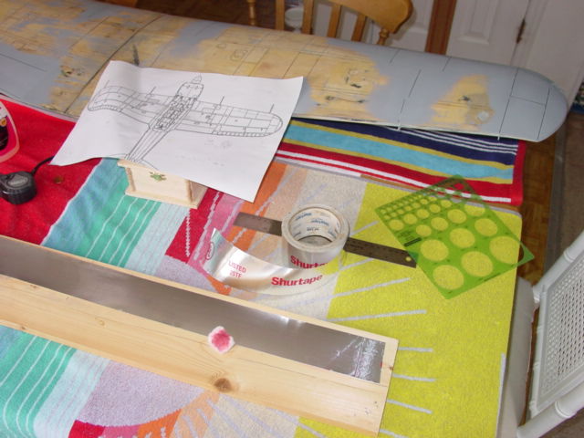

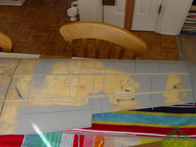

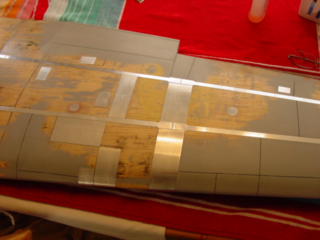

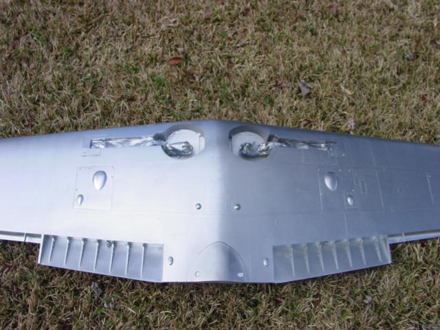

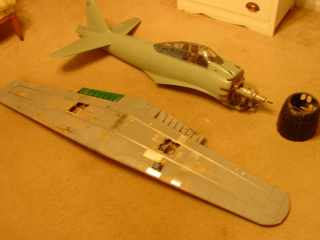

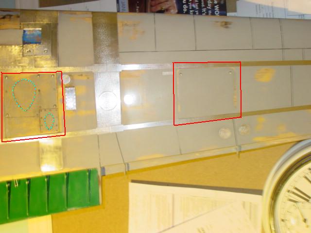

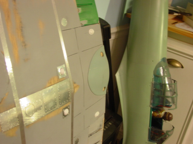

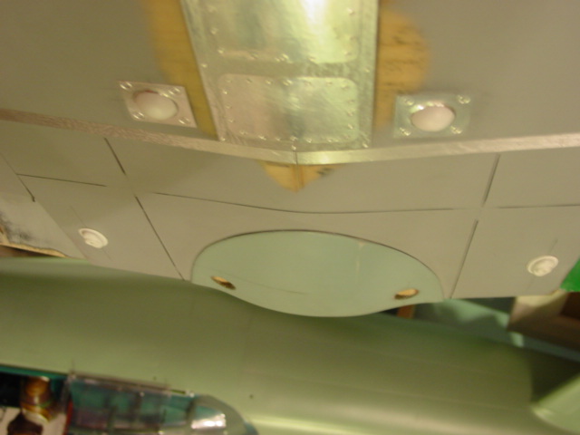

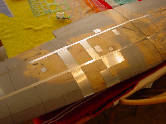

Weather has been bitingly cold so I took advantage of the kitchen table again for a full weekend of finalizing panels and getting ready for the silver base coat on the wing.....now that the kids' and wife's projects for me are done for now
1. There's somekind of oil on the tape and paint doesn't stick to the ink that it's labeled with so I clean it up with acetone or fingernail polish remover and a cotton ball. A light sanding helps too.

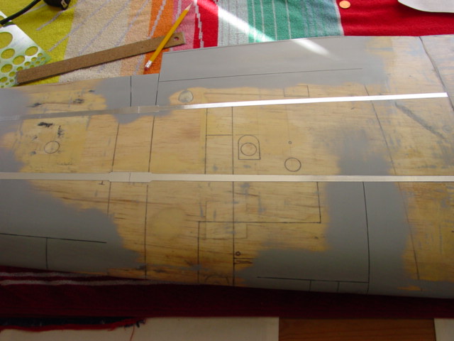

2, 3, 4. First down are the spar cap strips. The wing was lined with pen and ink prior to glassing and chart taped for panel lines not taken care of by the foil tape. The chart tape is still on and it's the black lines in the primer areas.

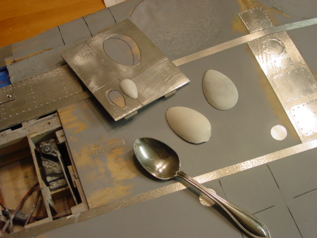

5. Some of the pen lines used as reference in cutting and applying foil panels.
6, 7. left and right wing bottoms done
8, 9. fuel cap and fuel cap detail.
10. wing top nearly done

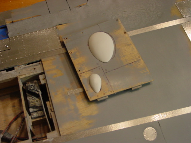

11, 12. The panels outlined in red are the servo access panels installed making use of existing panel lines. The dotted outlines are where the vaccu-formed blisters will go.
Finally feel like I'm making progress again.
What's on everyone else's bench this winter? Hopefully those of you down-under are flying, not building
Cheers!!

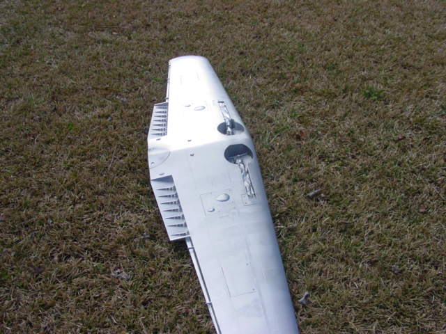

Finally! Some paint. Silver base coat done and good weather forcast for the weekend so maybe the primary colour and the camo coat then.....

Looking great Frets...love the flap bay.<div>

Sweet work frets, looks great.

Fantastic job frets, you're making me look lazy...
BTW, you and all your friends are WELCOME @ my place any day, just give me a few days notice so I can clean the house LOL
