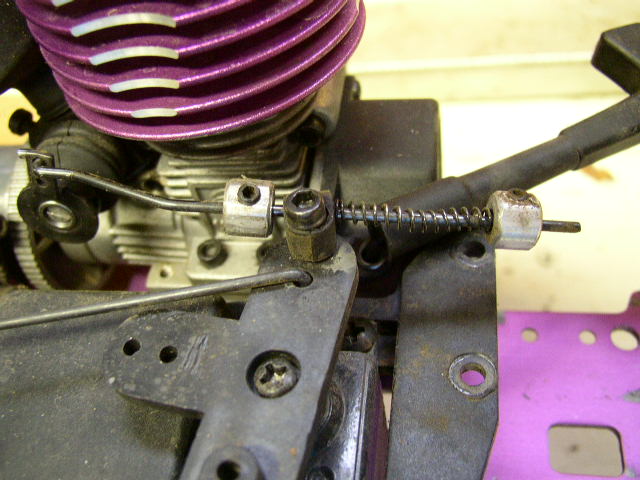

now im trying to adjust the throttle spring if some one could post a pik of there set up or help me adjust mine
Old 05-18-2006 | 05:10 PM
Joined: May 2006
Posts: 621
From: Glenwood, NJ
Default RE: Throttle Problem
Did you move the alum stops on the linkage? with the car and control in the on position. giveit throttle and brake then let it go to "neutral" position. there shouldn't be any resistance on the spring on the linkage and the front stop should be just against or slighty in front of the servo arm. also make sure before you move anything your throttle trim is centered on you hand control. 2 small knobs 1 for steering correction 1 for throttle correction just piont the small line straight up.

I'm trying to put up a pic of the buggy linkage. basicly the same

HOLY S%$# I DID IT TWICE! this is the buggy linkage in the idle position.

i dont know if this is right but when i use the break the spring has tension the it hits the alum. stops and pulls the rod back even farther pulling the carb shut and killing the motor ive tried the idle screw and that dont work either i was wondering if a shorter or softer spring would be better
Old 05-18-2006 | 07:05 PM
Joined: May 2006
Posts: 621
From: Glenwood, NJ

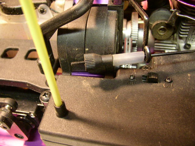

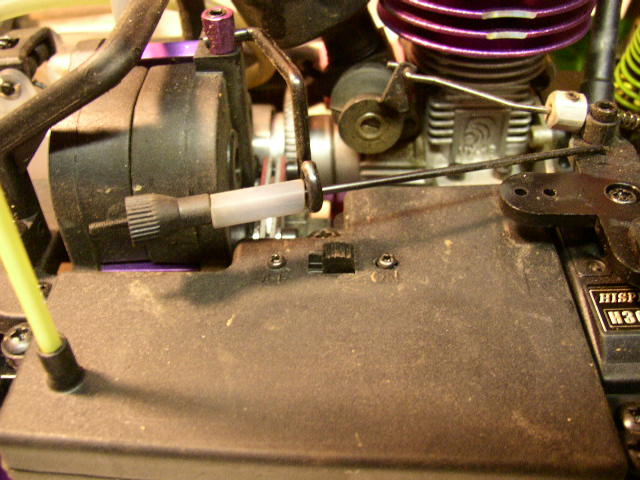

Try tightening the brake linkage. there's a thumbscrew on the brake linkage. with the throttle set like in the pic there should be little to no slack in that link. the little piece of tubing should just be starting to pull the brakes on. you could move the rear alum stop back a little to reduce the backward tension on the link to the carb. My brakes were really loose out of the box. if the servo has to pull to far back to actuate the brake it'll pull back too hard on the carb linkage. you could really tighten that link to the brake and when you release the thottle to idle the brakes will come on and stop or slow the truck.
Old 05-18-2006 | 07:11 PM
Joined: May 2006
Posts: 621
From: Glenwood, NJ
Here's more pics 1st is full throttle. 2nd is at idle and third is full braking.

Here's the truck. 1st @ Full throttle 2Nd @ idle and 3rd full brake. 4th is closeup of the thumb screw. I've got about 1/4" on link rod stickin out. OH see the little set screw that holds the brake arm to the top of the brake assembly? take it out and put Blue loctite on it and retighten it. I moved the link out alittle to get access to the on/off switch. If that screw falls out you're beat. Also loctite the set scews on the drivelines/ front and rear.
