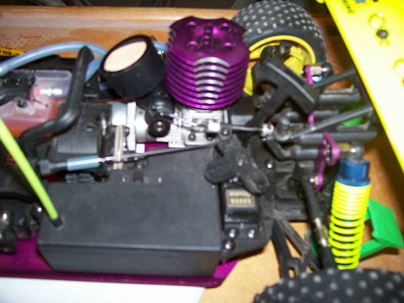

I got my Xp running but it wont stay running.I went bavck and redid all the stuff you guys said and it started right up.When I start it up i have to hold the brake or it takes off on me.It sounds like it keeps building up speed the longer it runs and once I release the brake it shuts off.I also have to prime it everytime for it to start. So I took video of it to maybe help to see if anyone can see whats wrong with.The first video is of the car running and the second video is of the throttle working.I beleave the problem is in the throttle somewhere but im not sure.

post a picture of your linkage, the spring goes behind the linkage of the servo horn, before the back collar nut.

sorry about the picture being blurry I hope this helps

Your servo horn is too far forward ... it looks damn near wide open.
If you look into the carb opening, how open is it?
Mine sits a little back, compared to yours being forward like that. Refer to the pics above for placement. Unscrew the screw in the middle of the horn and turn it back and put it back on and tighten it back down. See if that helps.

it may be the trim on the radio too, turn that down and see if that helps you out. there should be a 1mm gap on the carb opening when at idle and when you hit the brakes.
