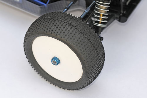

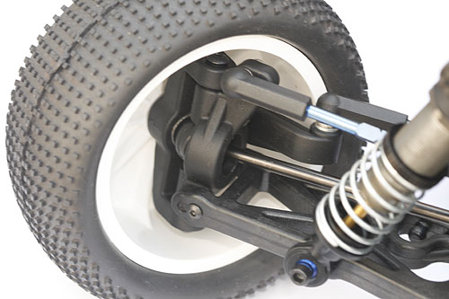

I took of my rear rims and put them on the front to see and the inner lip does rub against the plastics that hold the wheel hub and steering thingy. I don't want to shave anything off because what will hold the tire securely on the inside?
I wish I could go with rustler rims and proline 3.6" truck tires all around but im afraid it will rub on the front. Also I need all rears all around because front 2WD rims have no pins or hubs to hold the pins?
OK it seems RC10B44 have great offset for the front but these hex are 12MM I hope right? Couldn't find exact specs for it.
The specs say 32mm wide front and 40mm wide rears for the 2.2" on the redcat tornados, but the front AE rims say 27mm, with the wheels should add 5mm right?
I hope these work.

Ok I ordered 2 Dirt Hawg Buggy rears and fronts on 4 AE B44 yellow rims f/r for $40 total w/ shipping. This is a bigger ripp off than movie popcorn but I'm praying they fit. It's bad enough you are paying $10 for $1 worth of rubber, but they use "special M2 rubber" for "high grip" which really means for fast wear so you should buy more often...

I have HPI SS monster truck wheels and the inside spokes hit the hubs so i was afraid of hpi rims.
