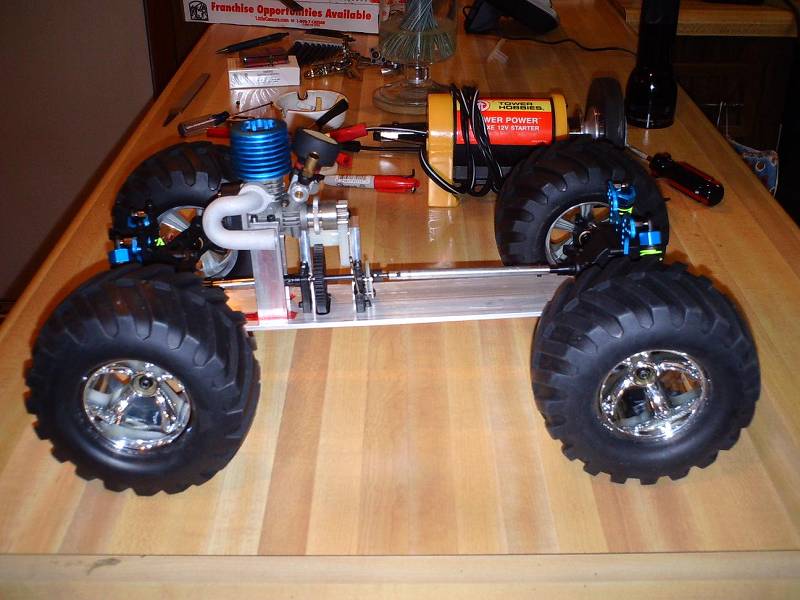

This will probably be the last project I do for a while. I couldn't make my mind up if I wanted a nitro crawler or just a high torque monster truck.
The tranny gear ratio is 12:1
I'm not looking for speed on this one. I had to mount the engine up front and backwards to rotate the correct way with using only one counter gear. If I used two counter gears, the ratio would be something like 24:1 and that would be slow enough for a crawler.
I am hoping to get this one done before x-mas.
Enjoy the pics!

While you've already done most of the engine mounting work - do you reckon you could spin the counter gear around and move the engine forward an inch and a half? Then you can make the cooling head stick out the 'hood' of the bodyshell I've always wanted to do that but I've mostly moved to electric stuff now.
You'll need to work around the steering somehow but I reckon you would manage.

ORIGINAL: el_tonto
That would be cool. I believe the head will come through the body where the windshield and the hood meet.
As of now, I don't have much room to play around for steering. I may have to make a linkage and put the servo on the other side of the tranny. And then there is the linkage for the throttle and brake.......hmmmmm....
I'm sure I will find a way to make it all work.
Thanks man.
You could always use a Y-cable and twin servos for any of those functions. e.g. one servo per wheel for steering, and perhaps a mini-servo for the throttle and a regular one for the brake or something. Then the linkages are a piece of cake.

ORIGINAL: el_tonto
I may have to end up using a servo for the throttle and one for the brake and another one for steering. (Like you said)
