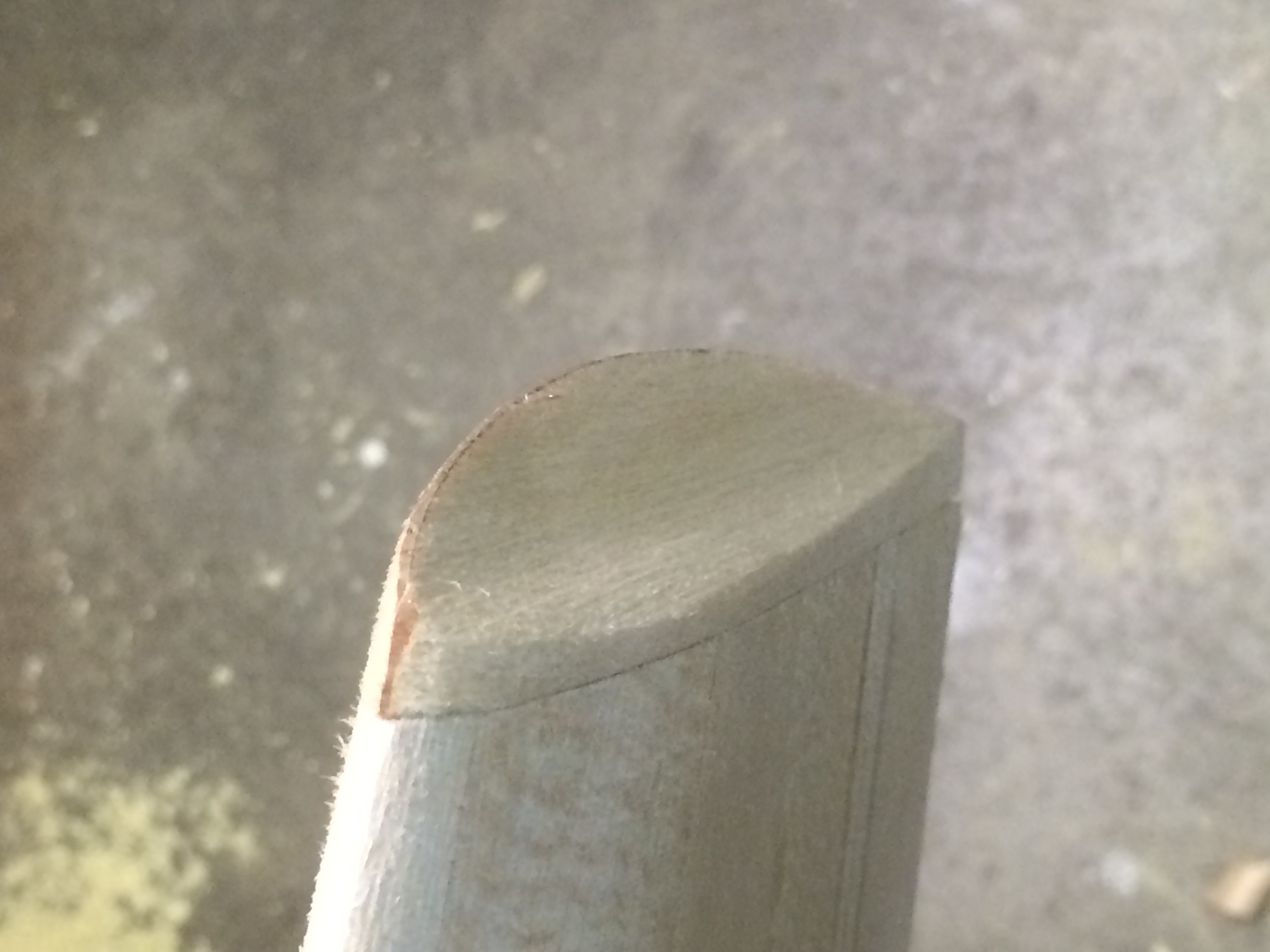

Old 12-13-2015 | 08:28 PM
  #31
tdstaf's Avatar
My Feedback: (11)
Joined: Apr 2005
Posts: 560
From: sacramento, CA

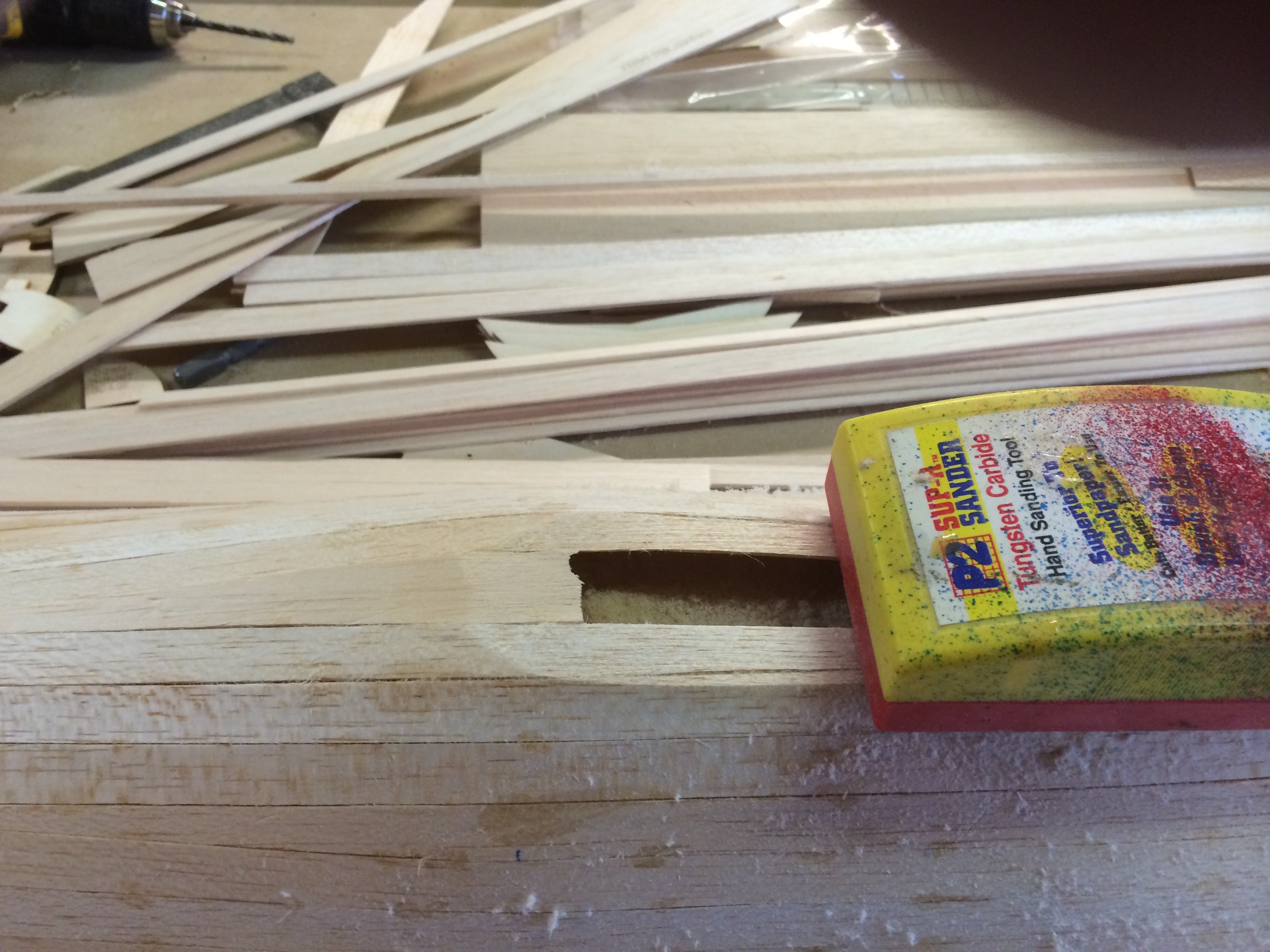

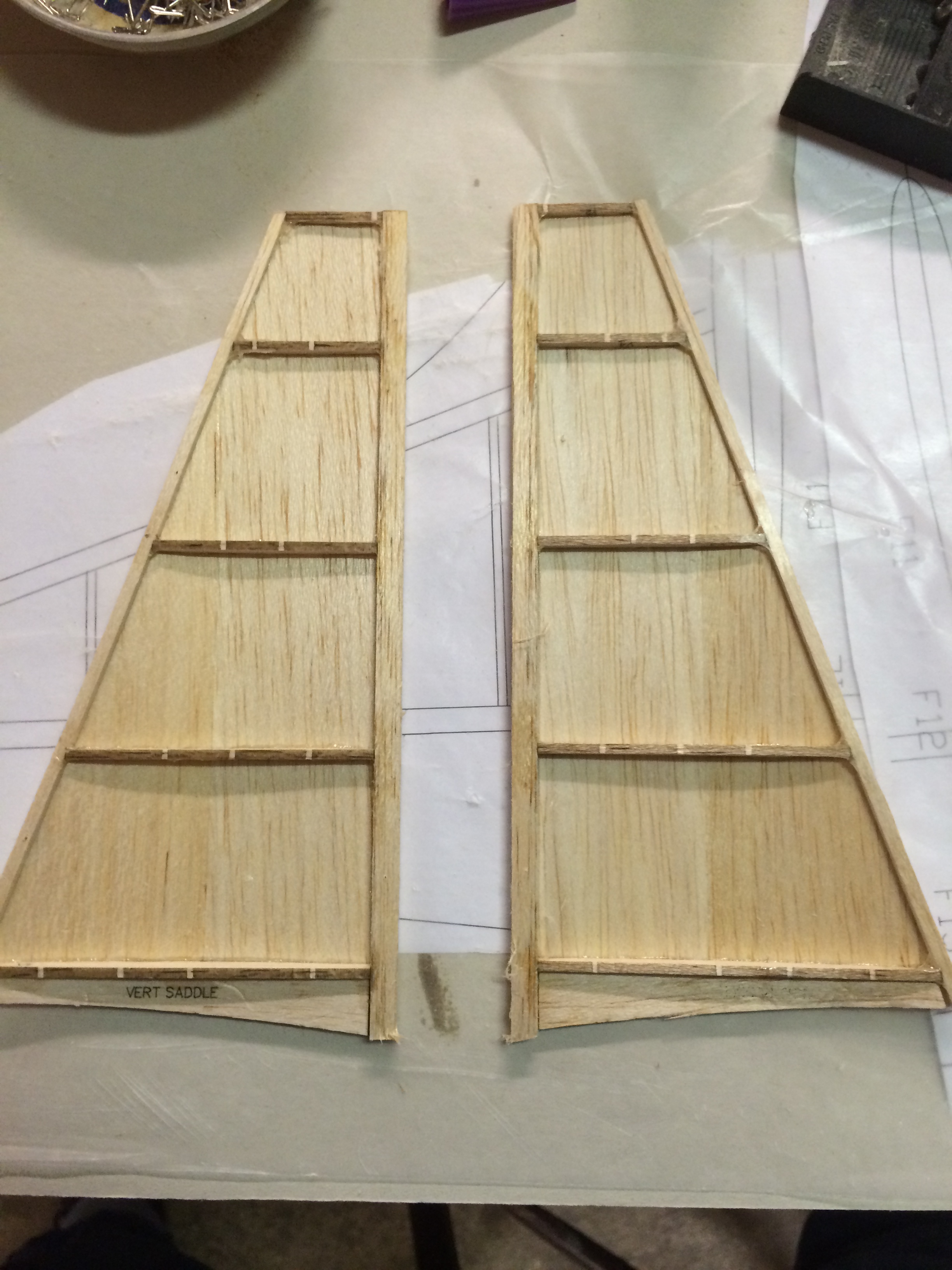

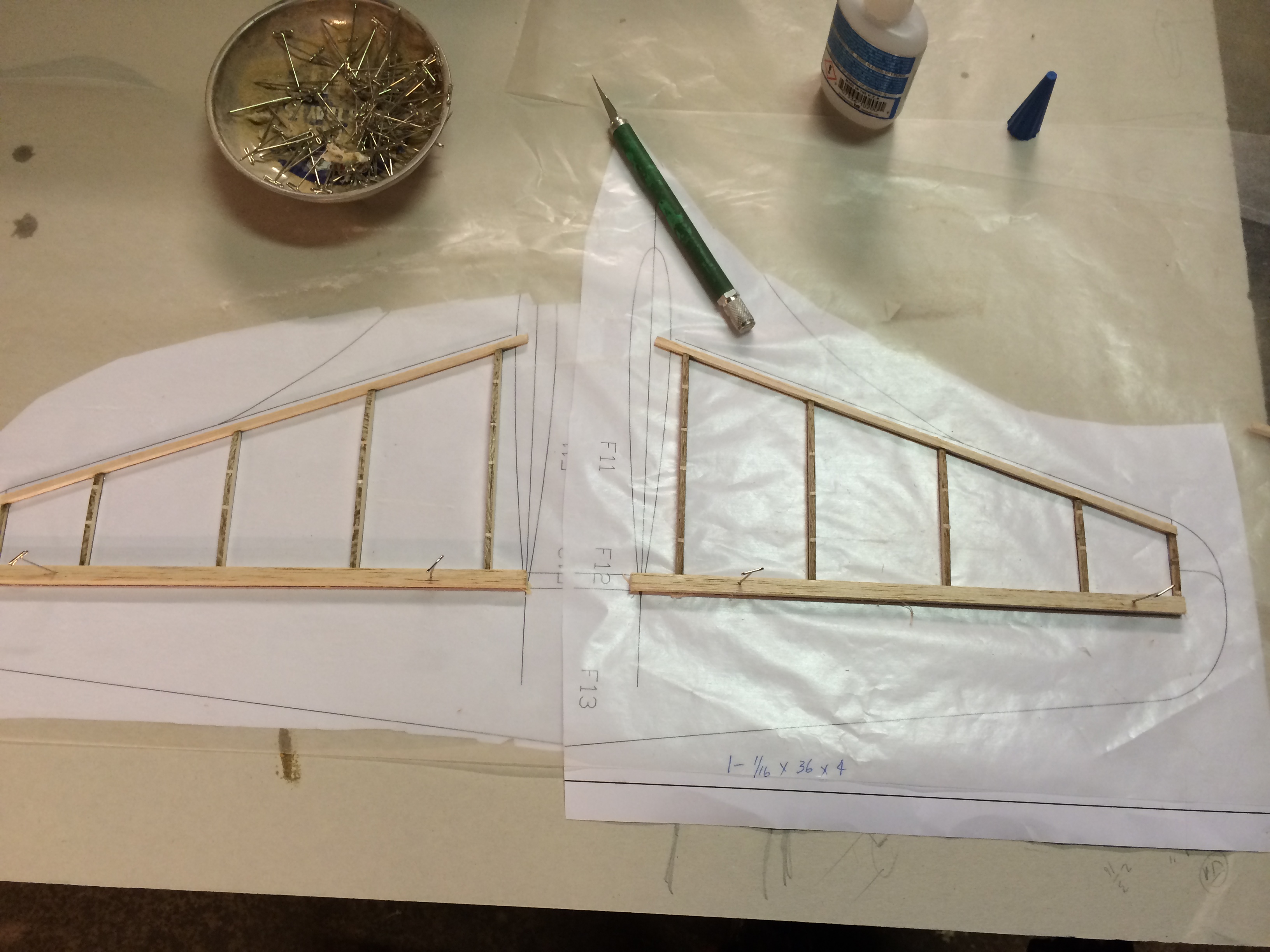

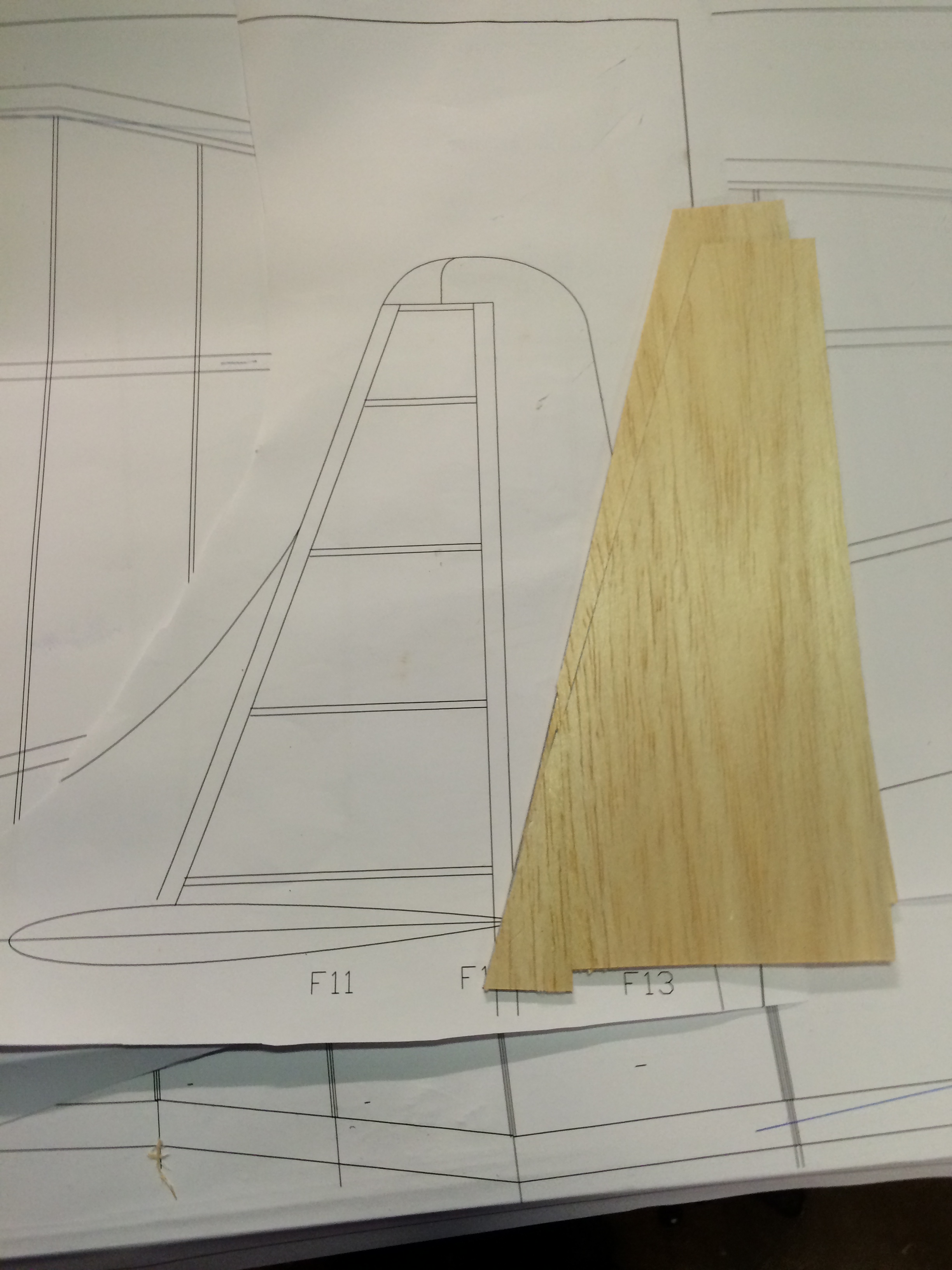

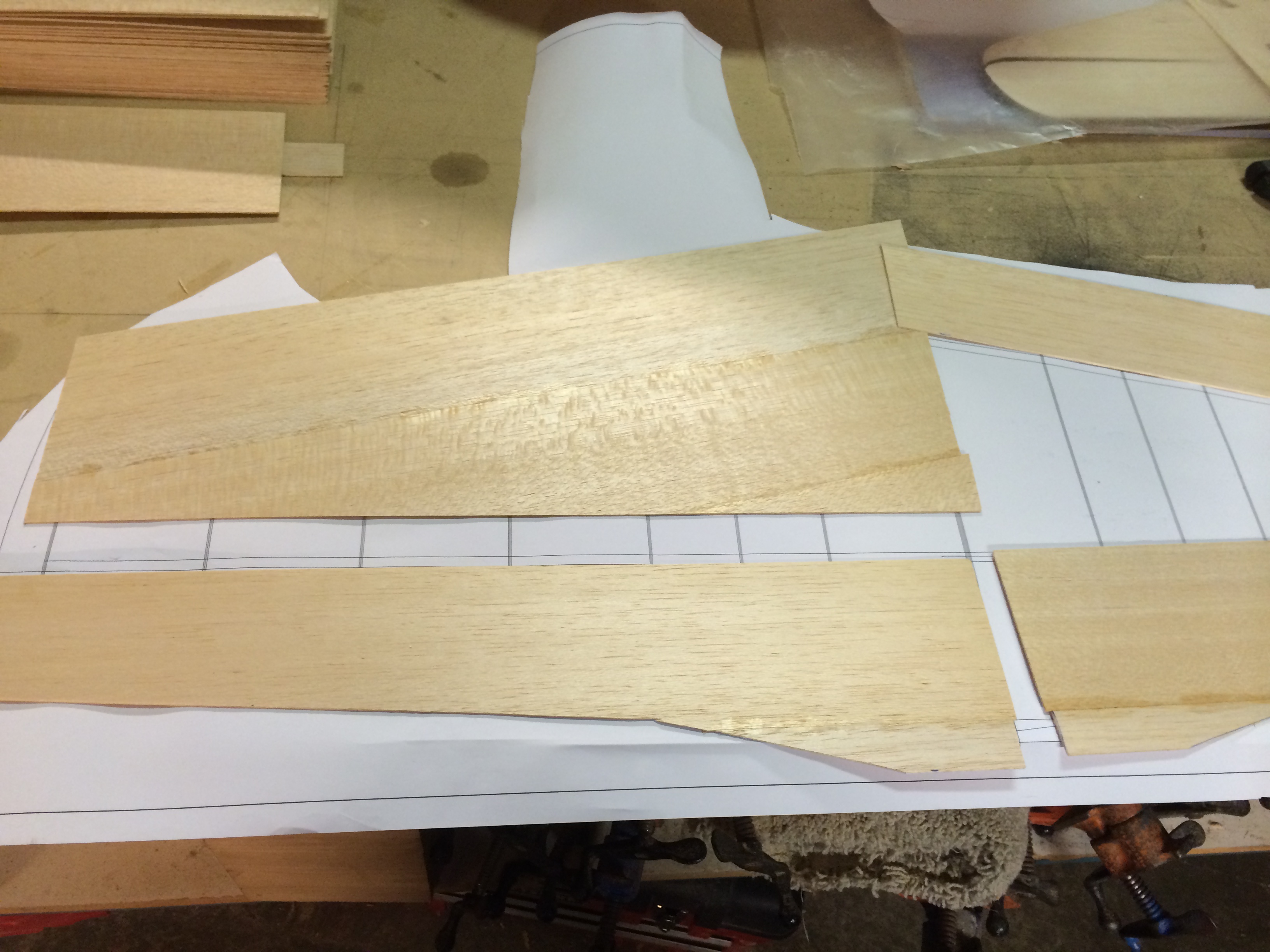

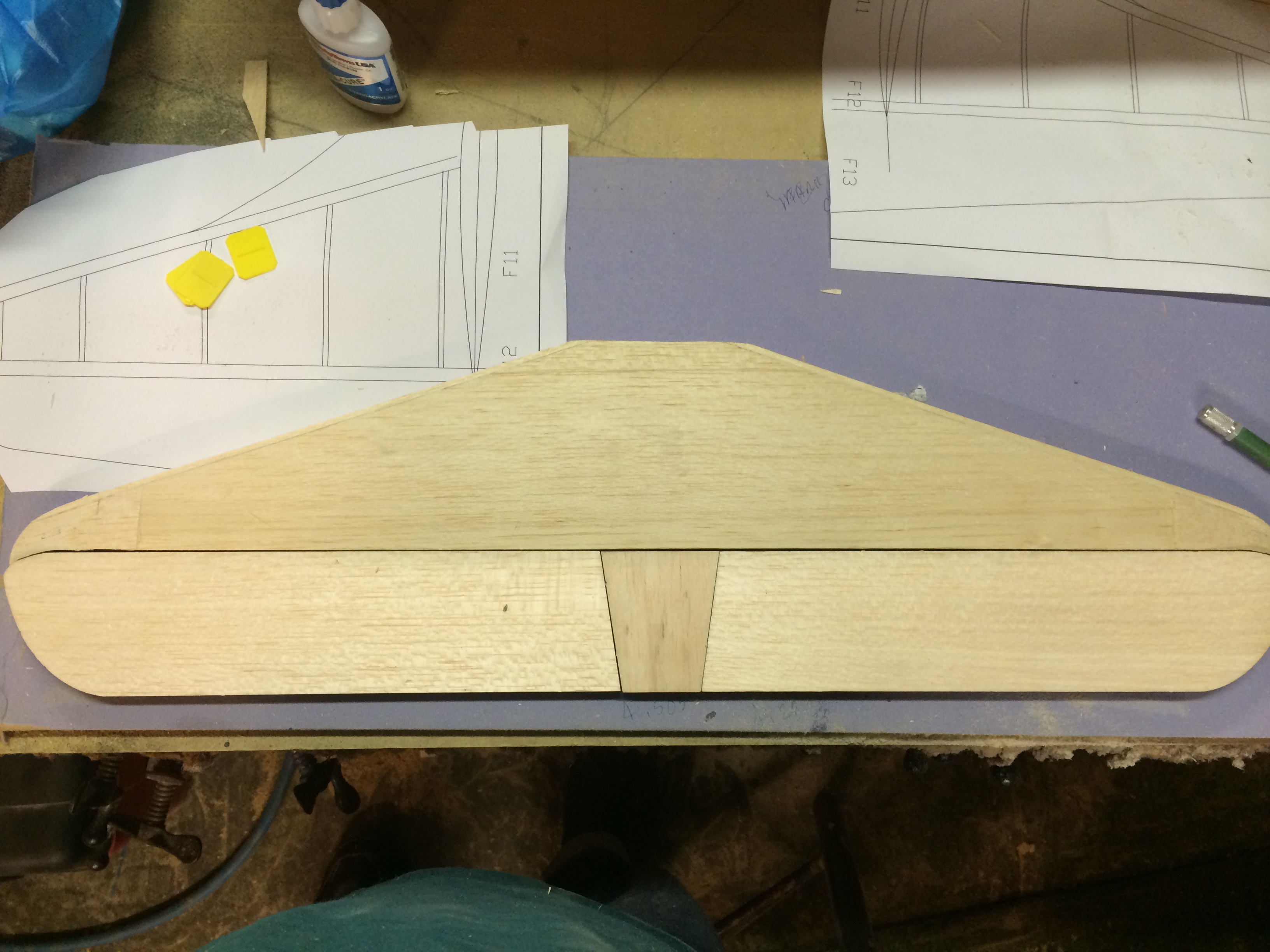

I've got in some work recently in between helping with the Czech Mate build.
Got the tips installed on the horizontal last week and was having trouble loading the pictures. The elevators have not been shaped as of yet I will have to wait until the fuselage is being build to decide on how I want to do the linkage for them so I decided to continue on to the vertical stab.
Here I pre cut the sheeting for each of the vertical halves.
Then following the same procedure as the horizontal. Framed up the two halves, shaped, sheeted and installed the vertical saddles on each half. Cut the excess sheeting, glued the two completed halves together and attached the top tip and leading edge . I will complete the final shaping when the fuselage if framed up.

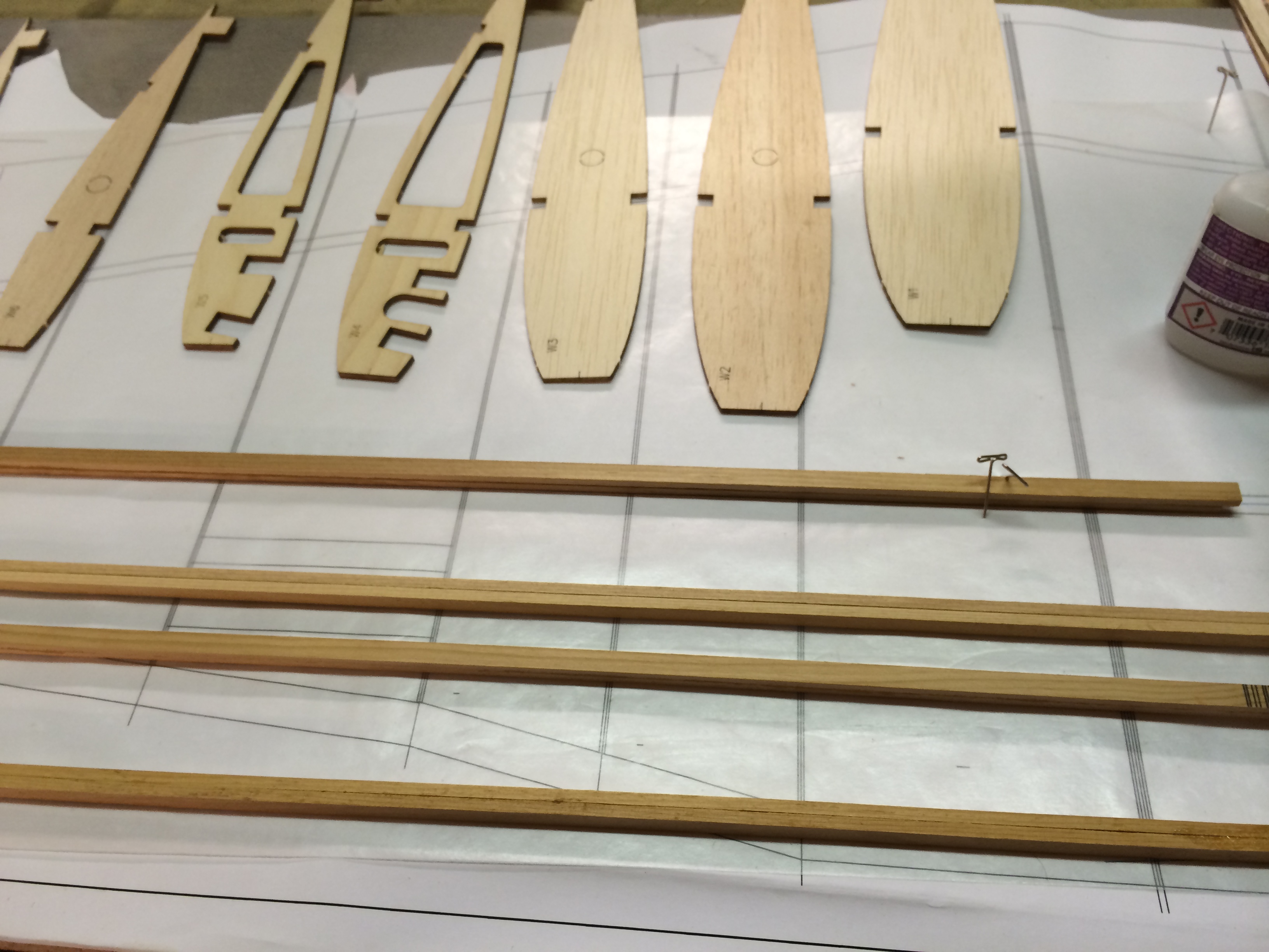

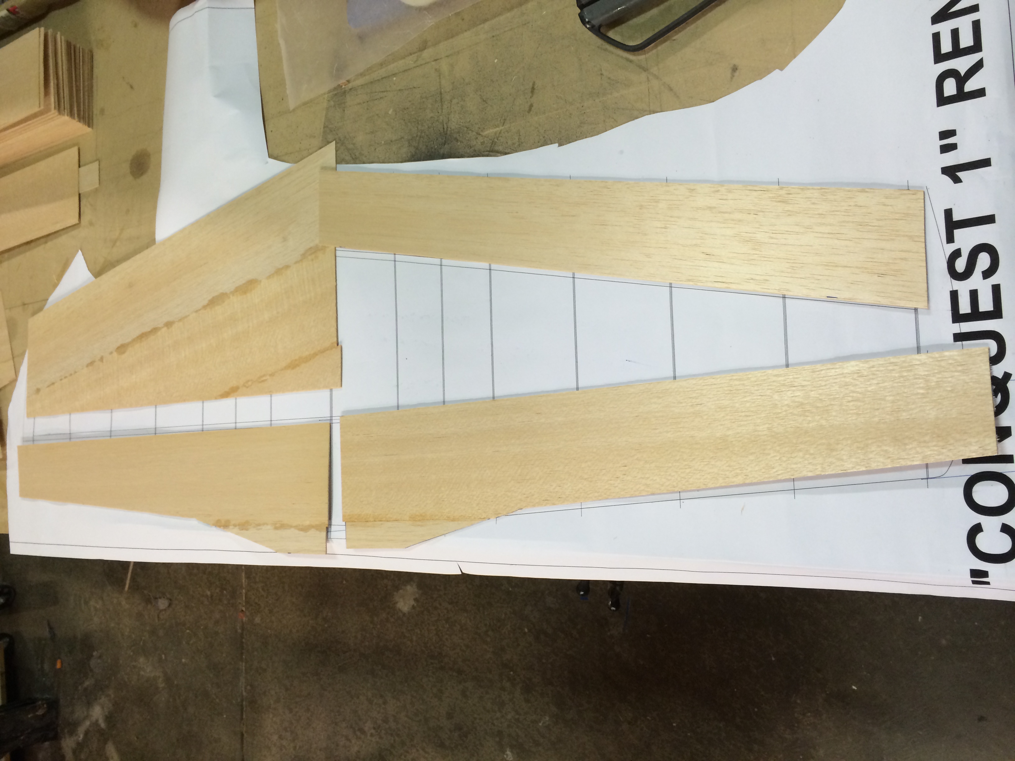

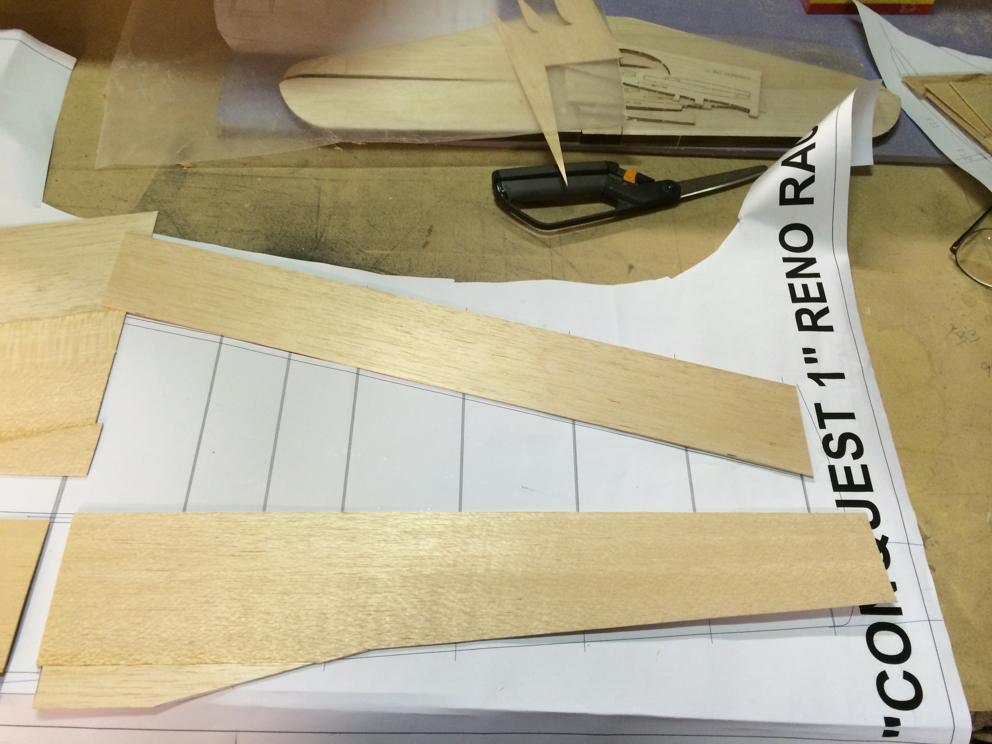

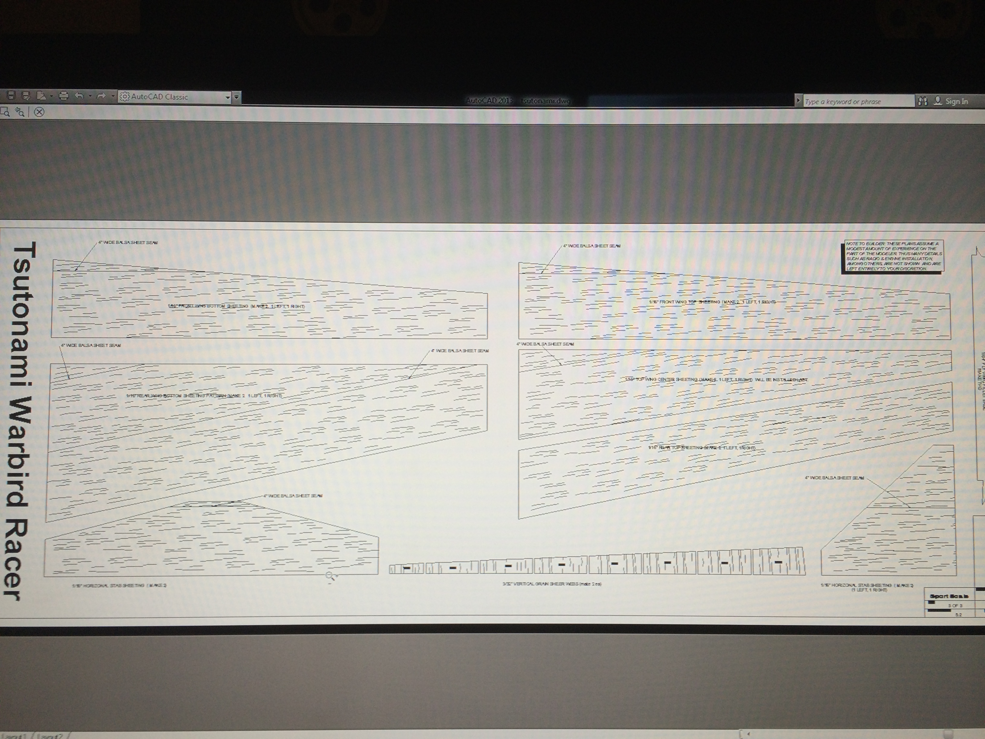

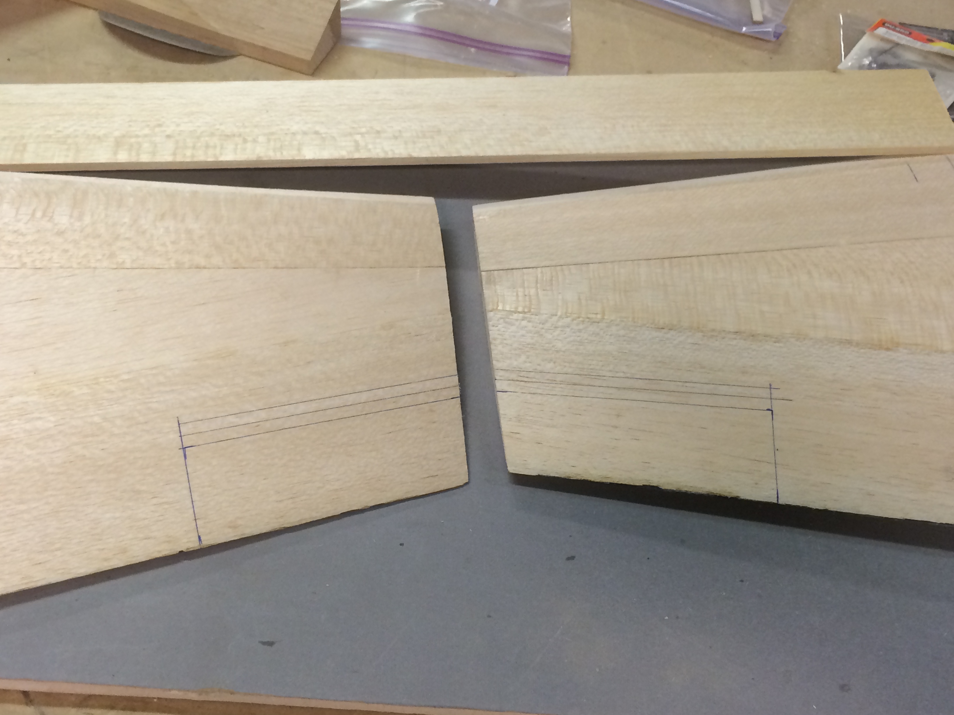

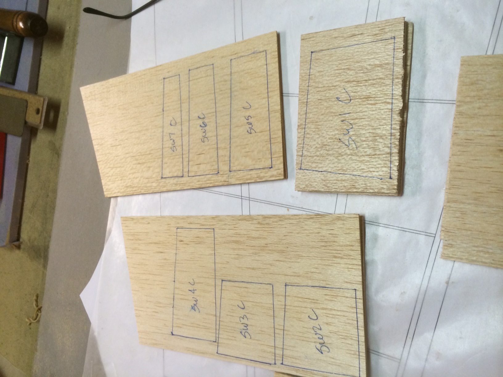

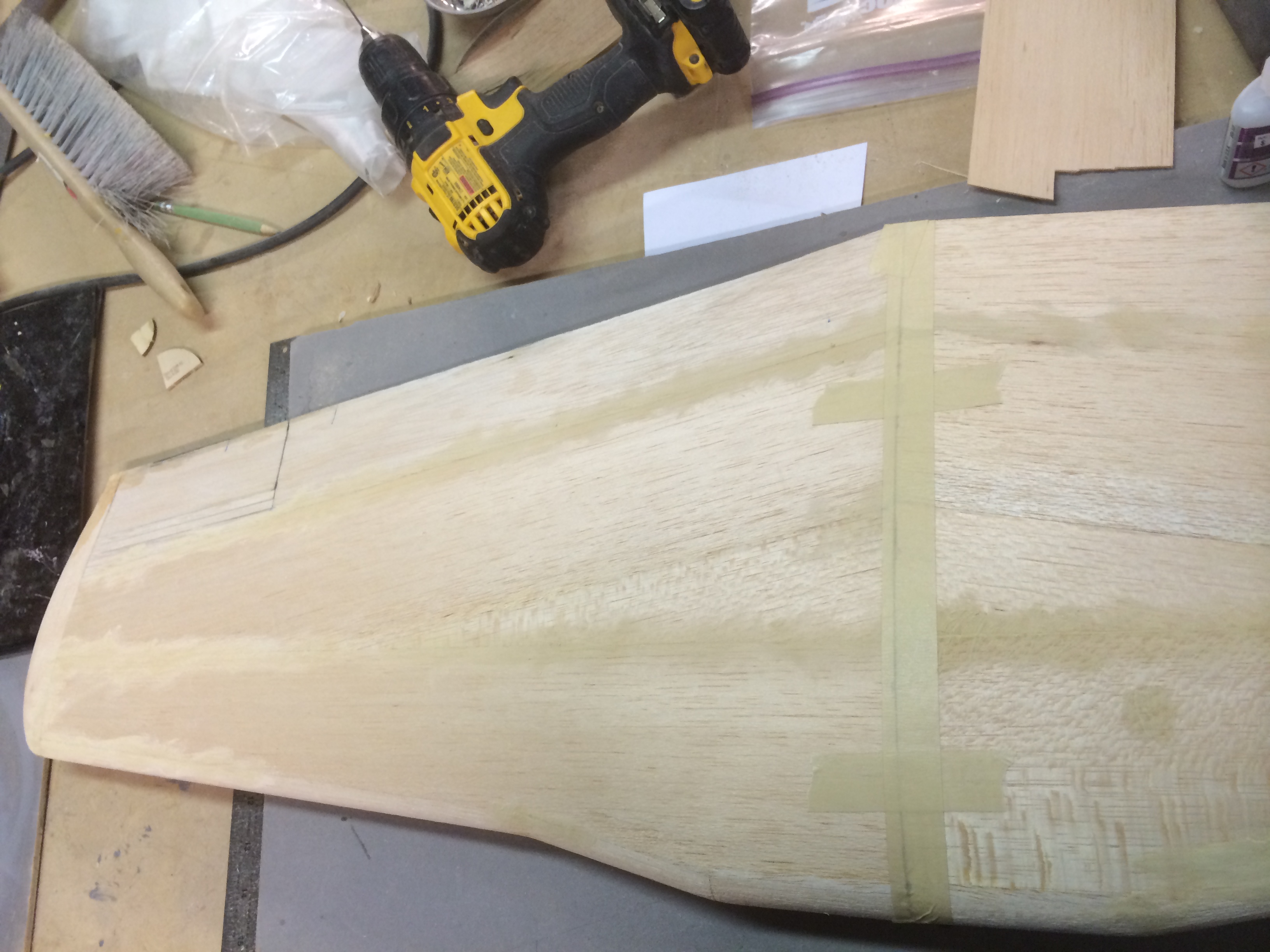

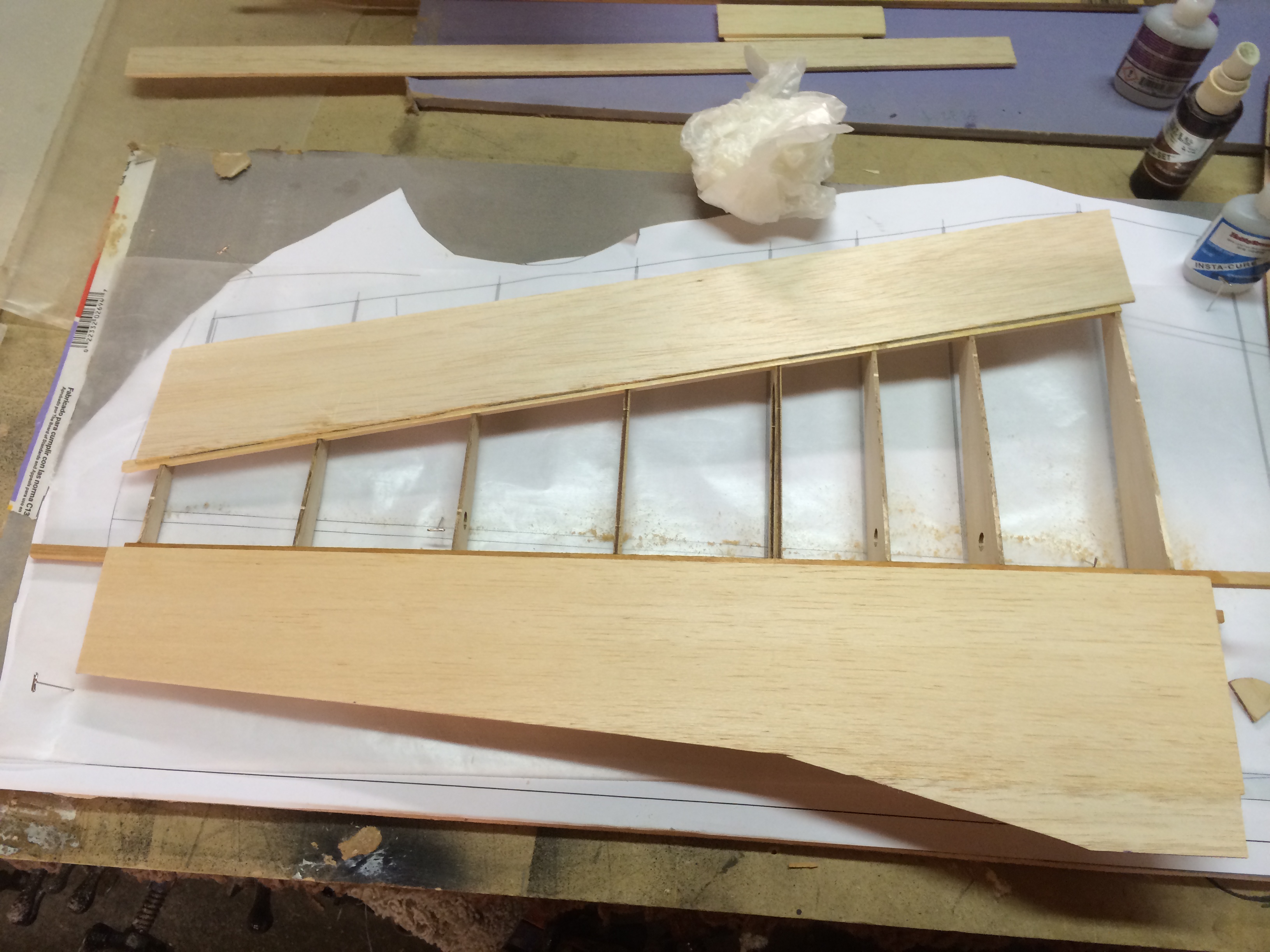

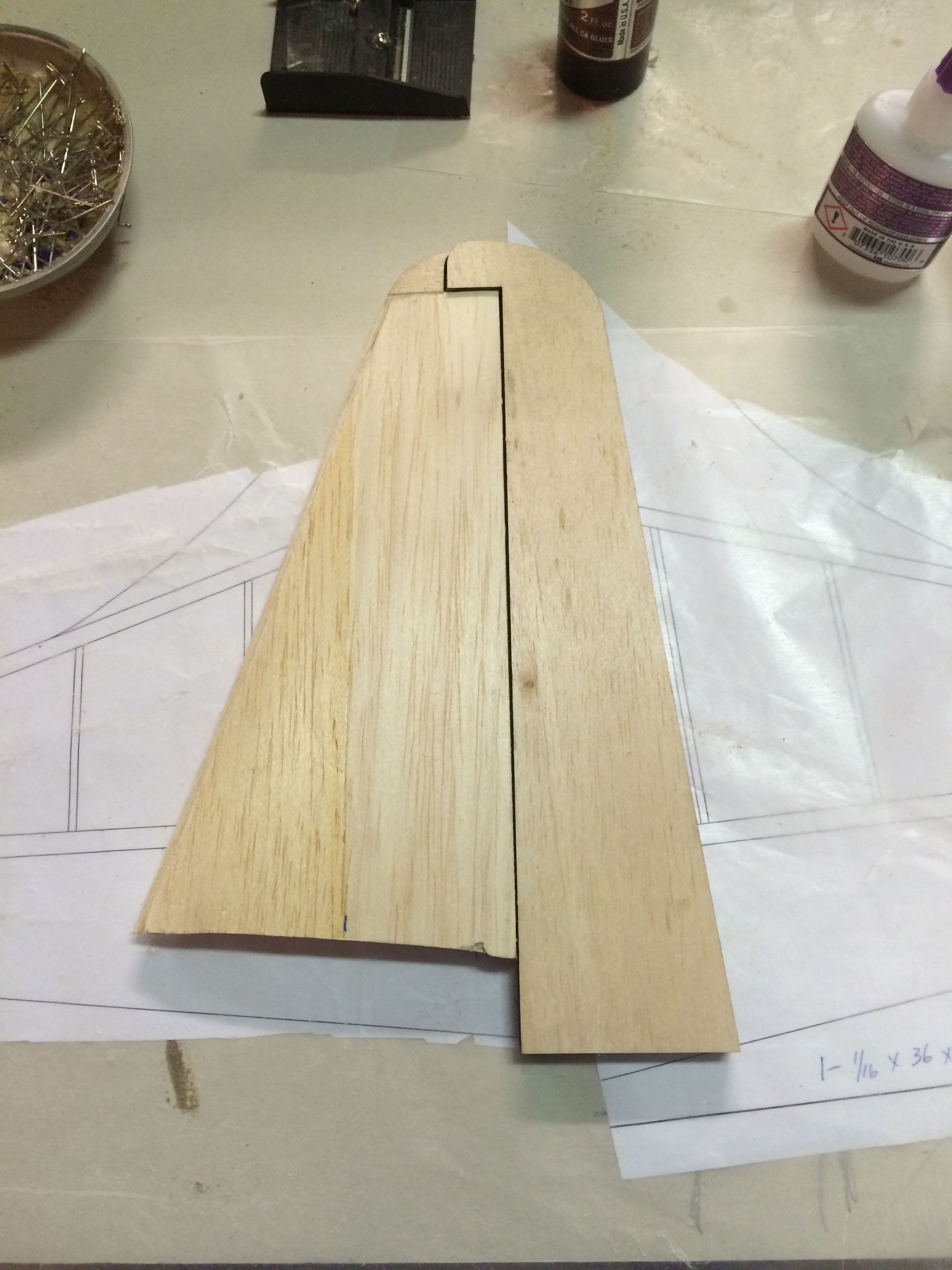

On Thursday I was able to start preparing all the wing skins.
Above is the top and bottom skins for the left wing panel. I think I'm going to start including an extra sheet that has the patterns for these skins with the plans.
Here is a screen shot of the drawing I'm working on for the Tsutonami. My hope is it will make it easier for the builder to prepare all the needed wing skins, tail part skins, and shear webs.

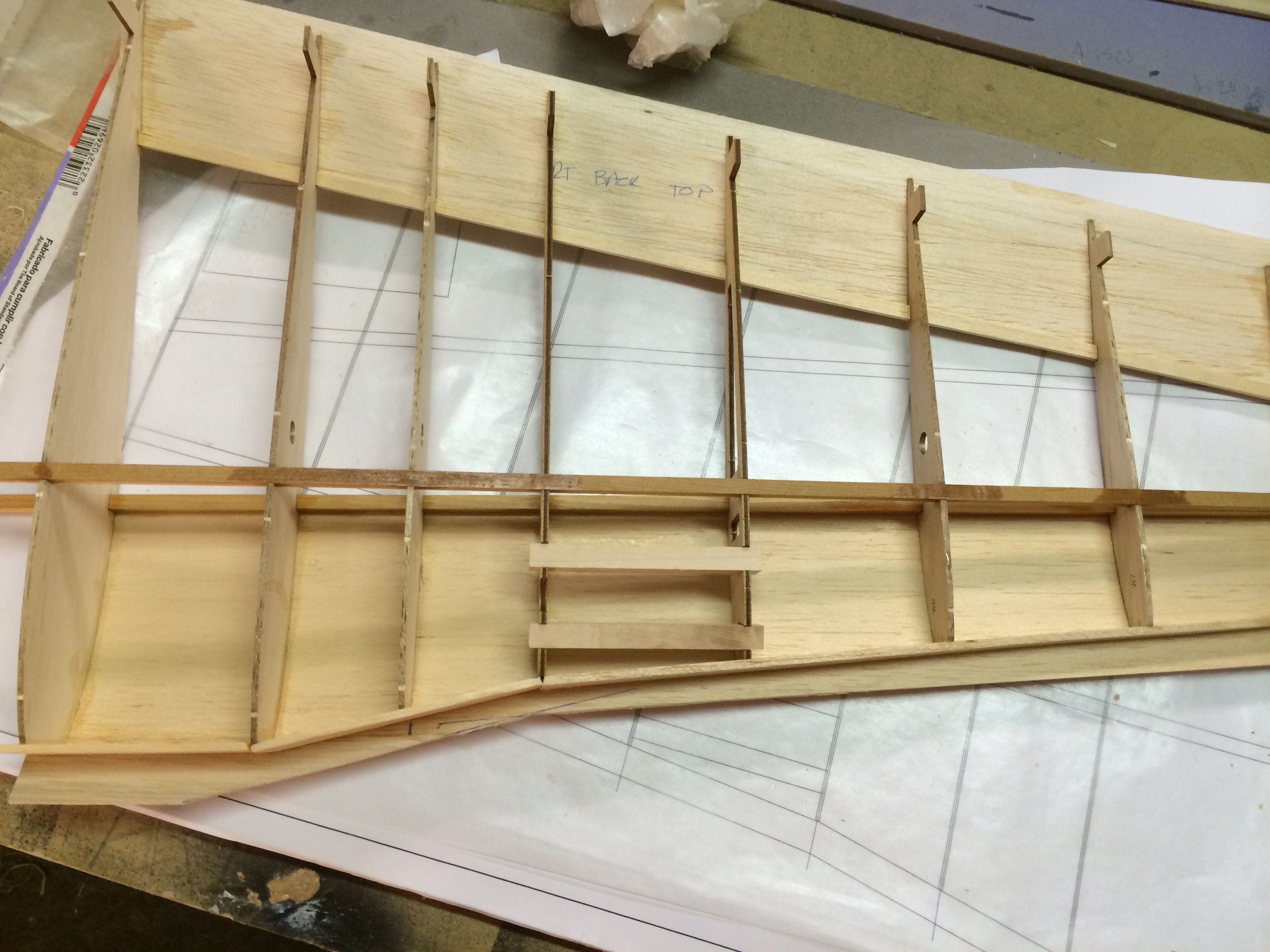

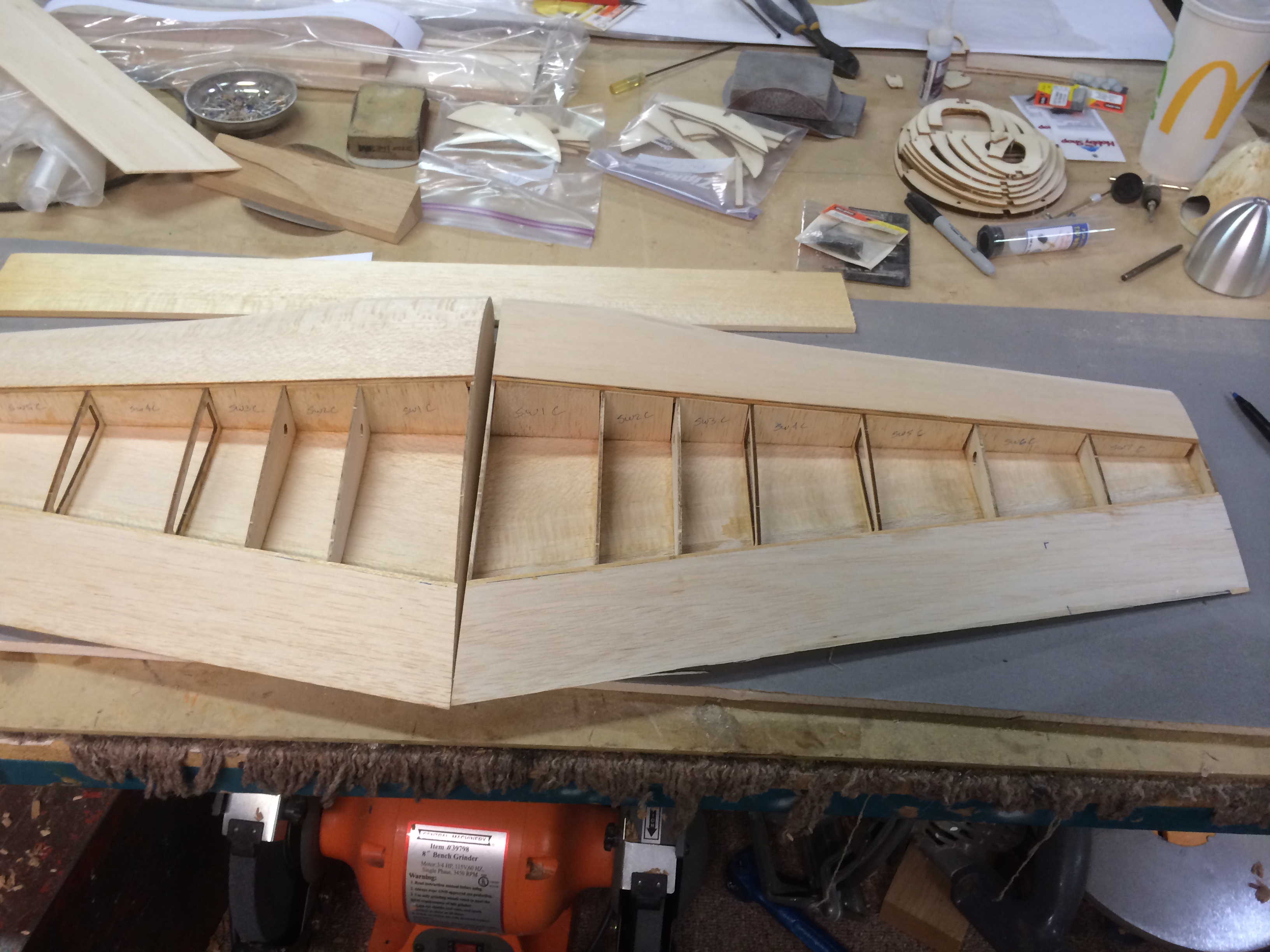

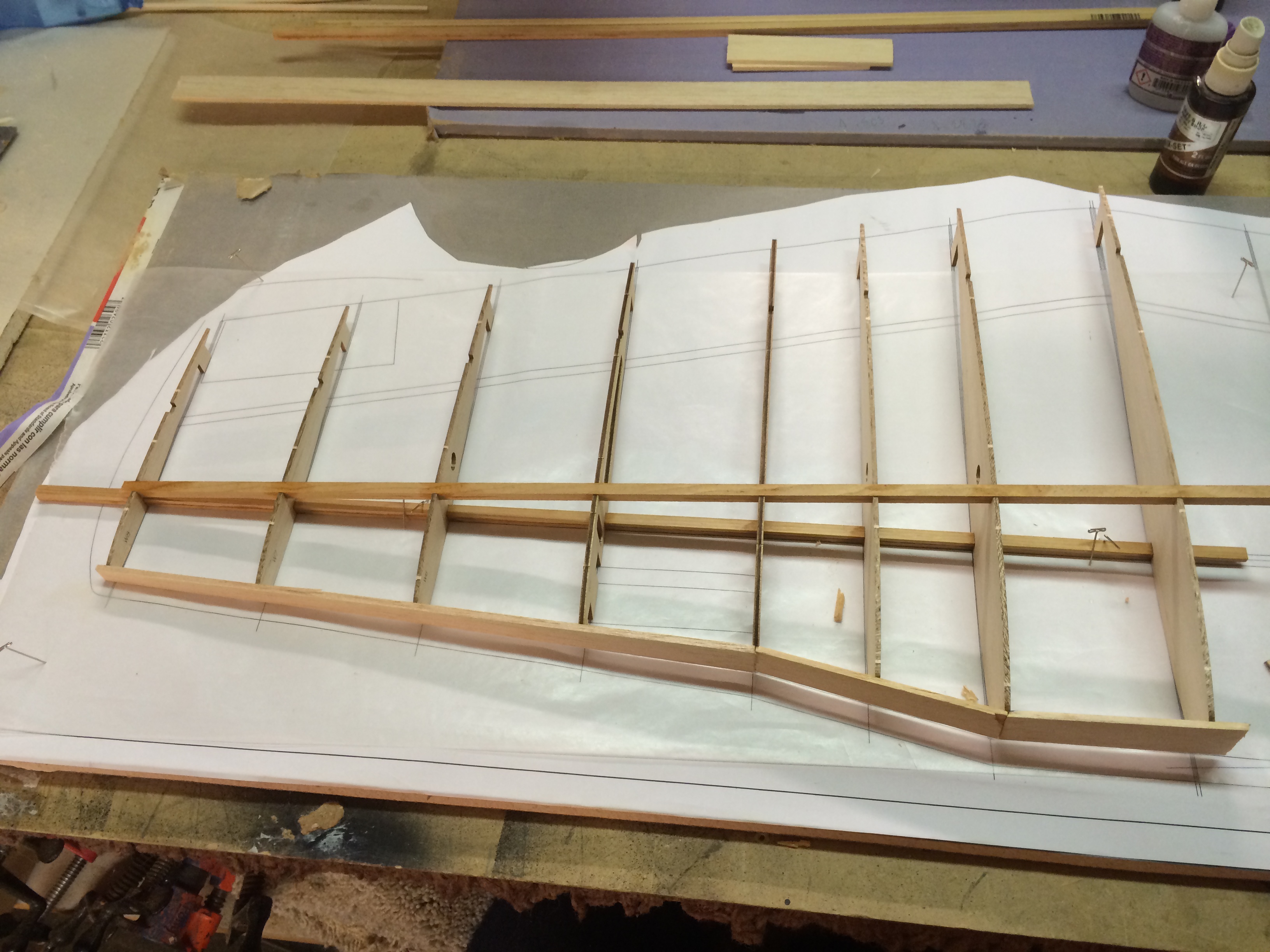

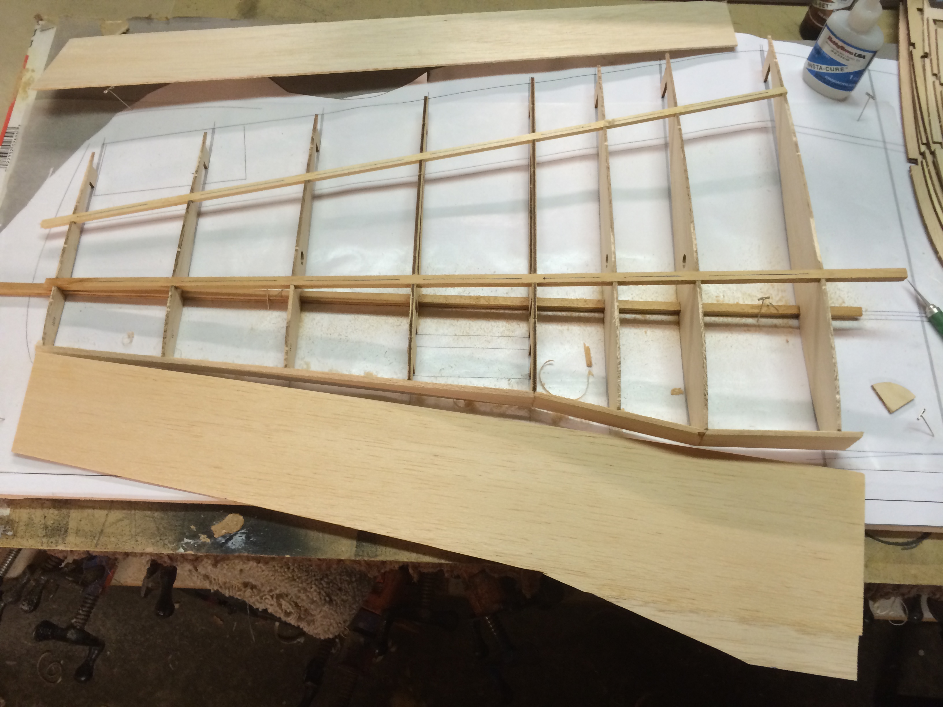

I've been working on the wings and haven't had time to post. Here are a few pictures of the rib layout.

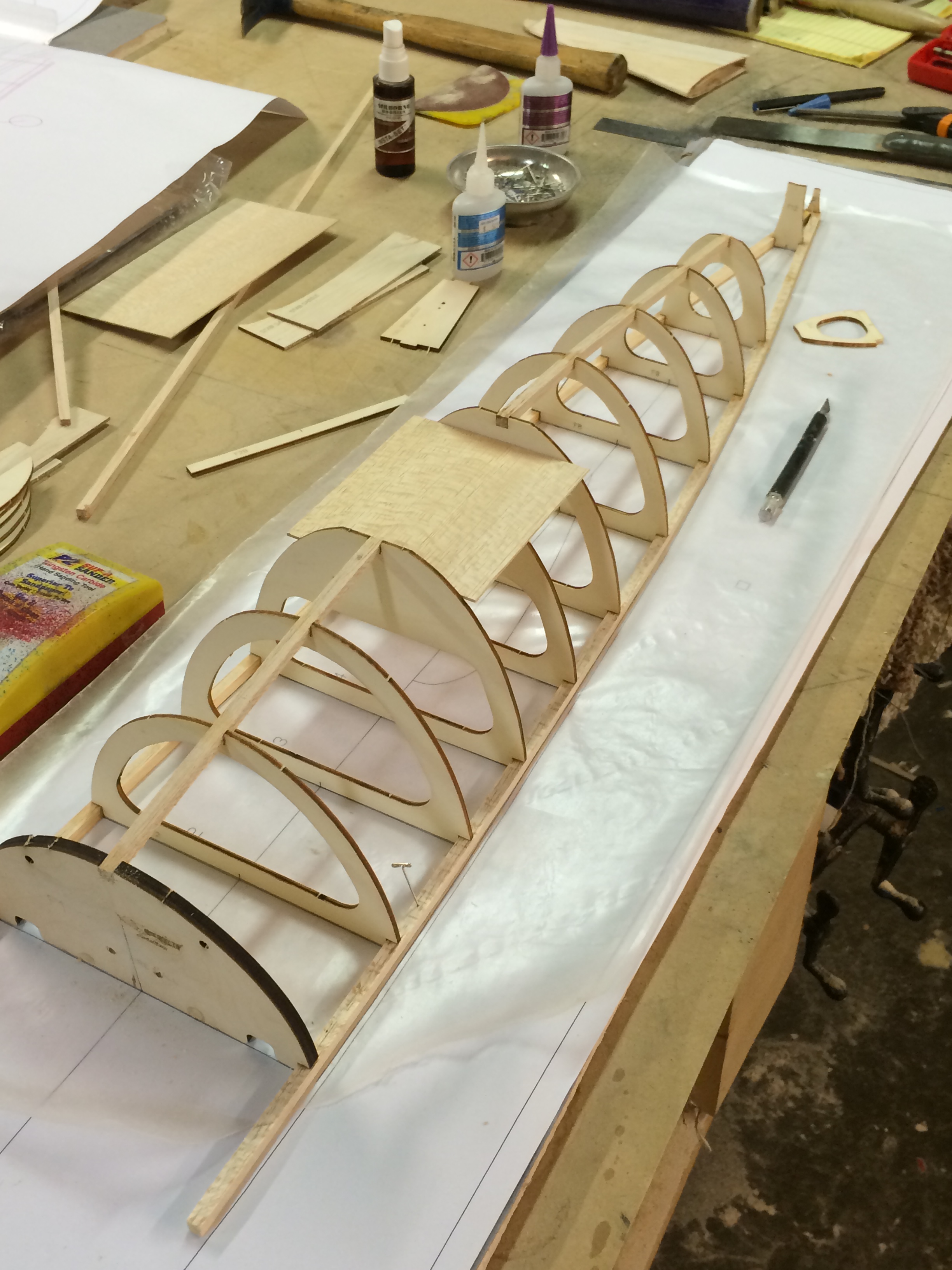

Old 12-29-2015 | 07:21 PM
  #34
tdstaf's Avatar
My Feedback: (11)
Joined: Apr 2005
Posts: 560

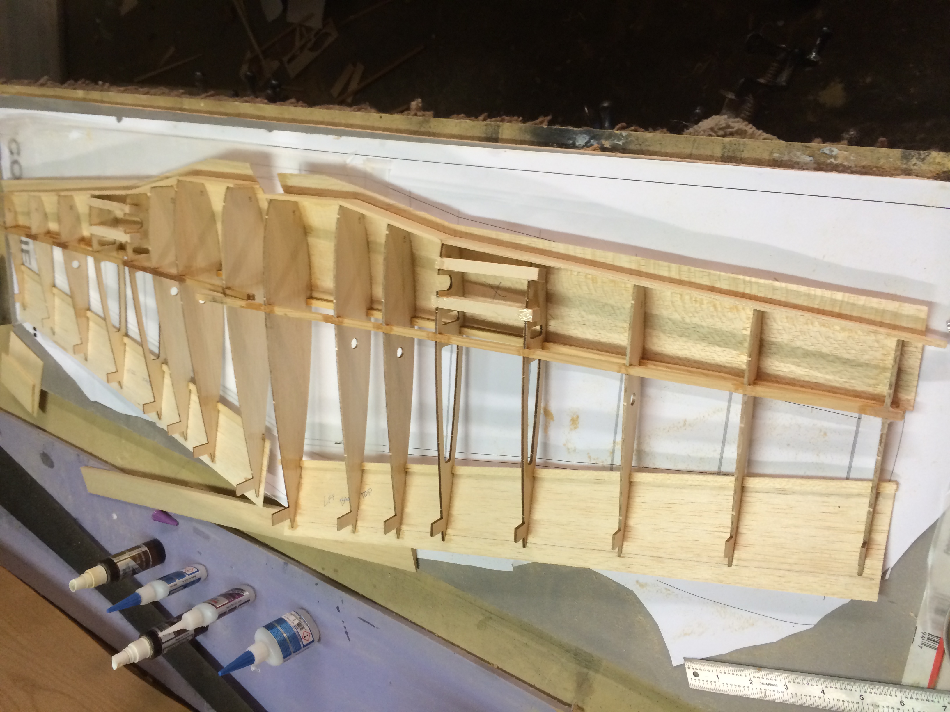

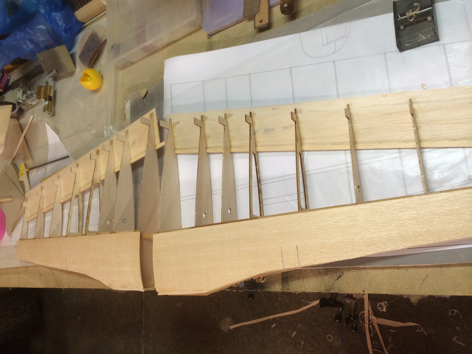

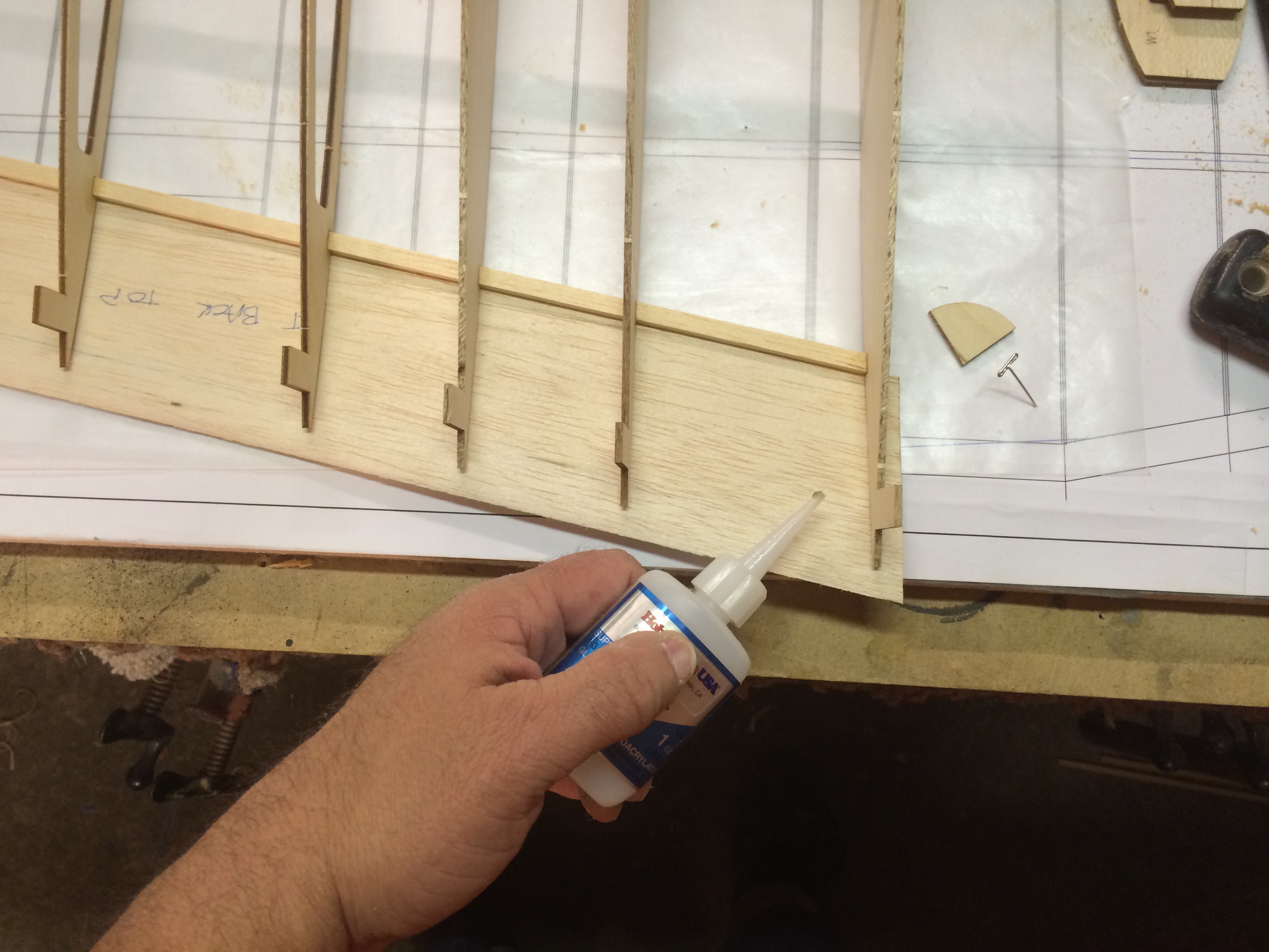

After getting all the spars in place I glued the wing skins that were prepared ahead of time to the spars from the center out with medium Ca.
Then I turn the wing over and glue the sheeting from the inside with thin ca working my way from the center of the rib to the out side using the bench to making sure the sheeting is firmly against the ribs.
When I finished with both wing halves I glued in the gear blocks with 30 min epoxy and let them set for the night.

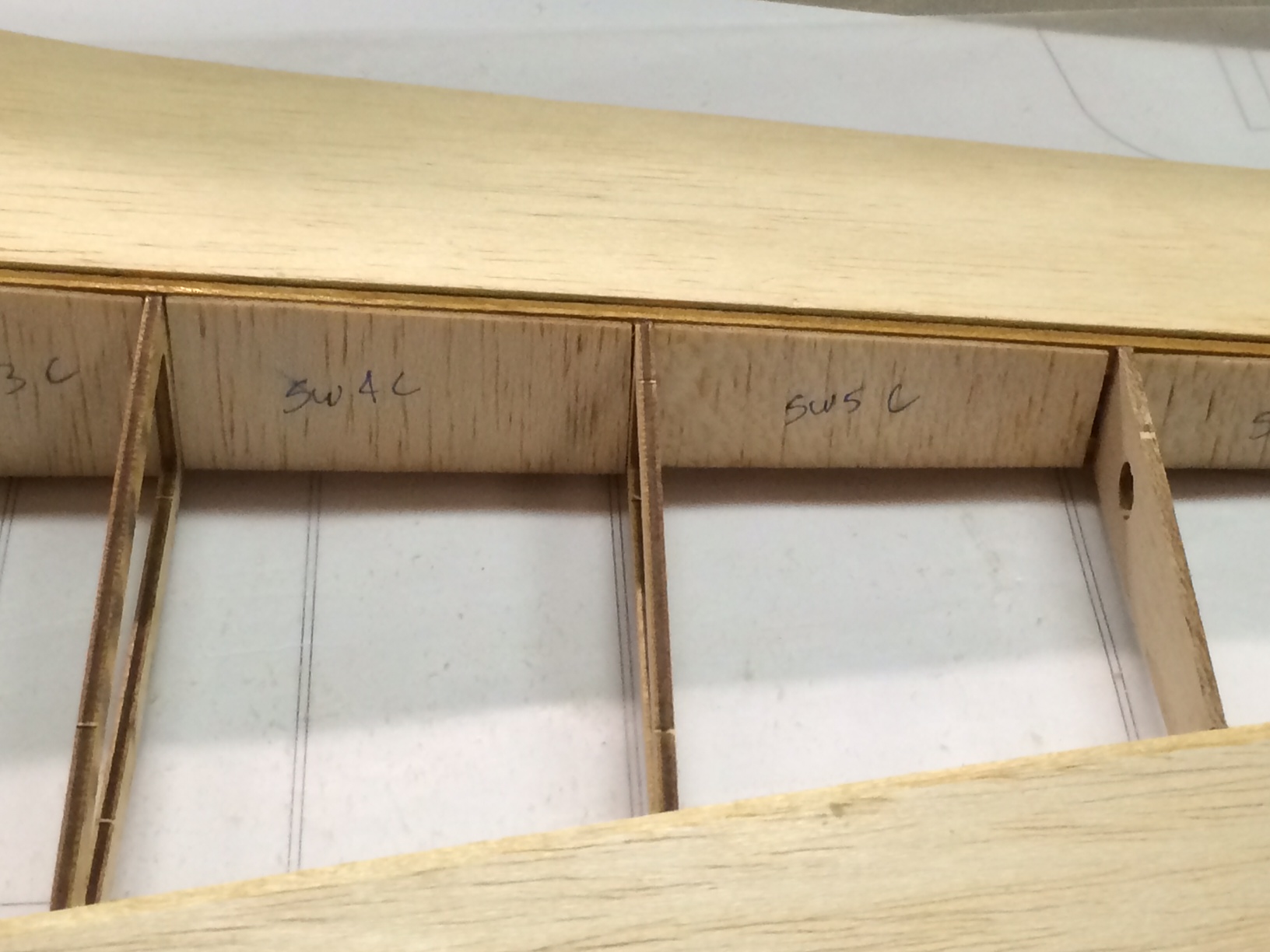

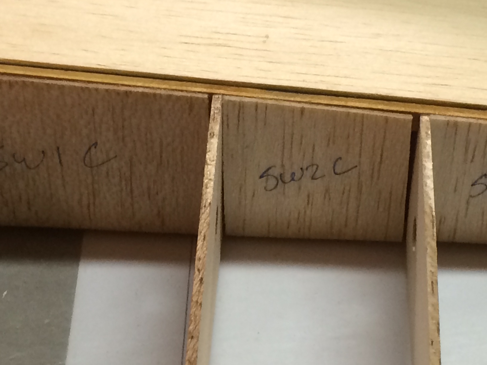

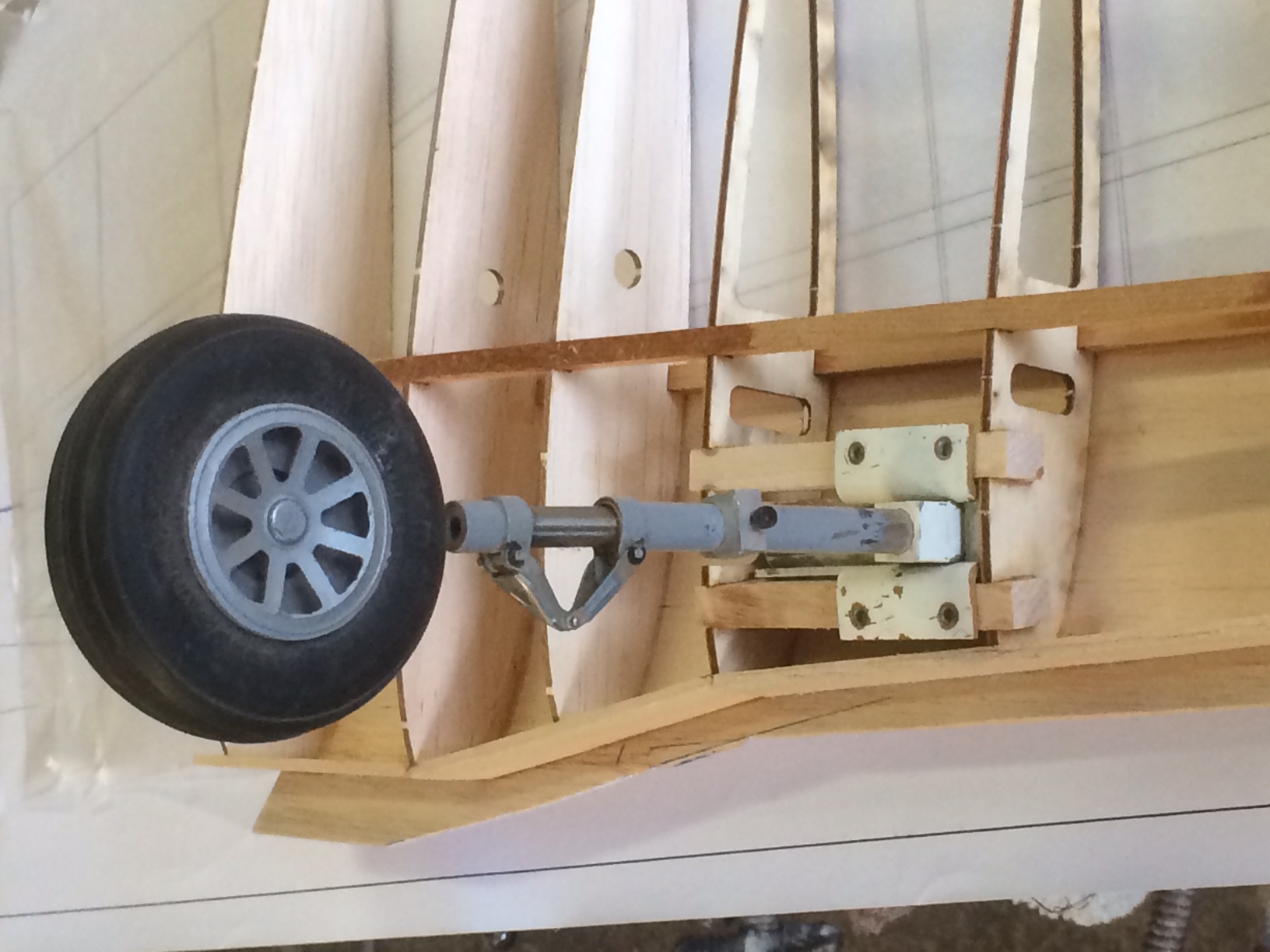

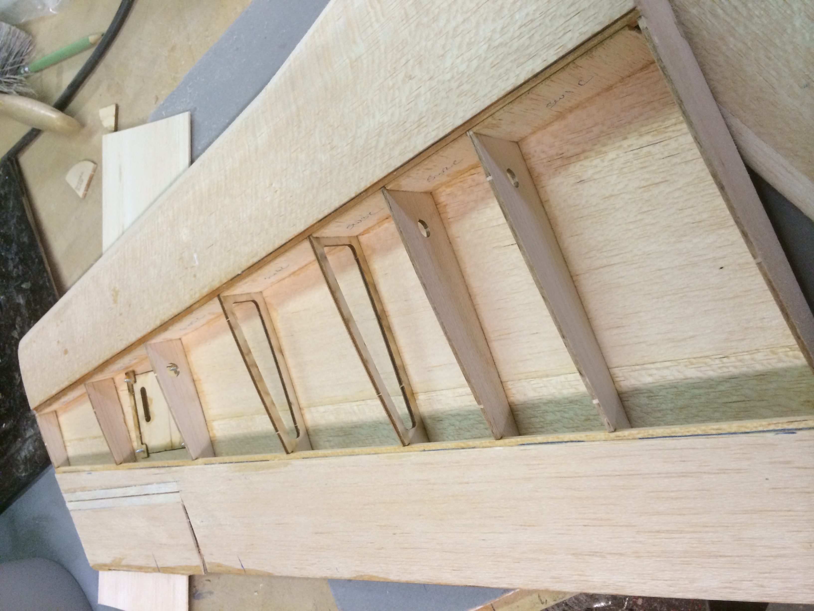

After the epoxy cured for the night
I fit the Spring air retracts. Drilled and tapped the gear blocks to fit 440 button screws. I will harden them with thin ca later.

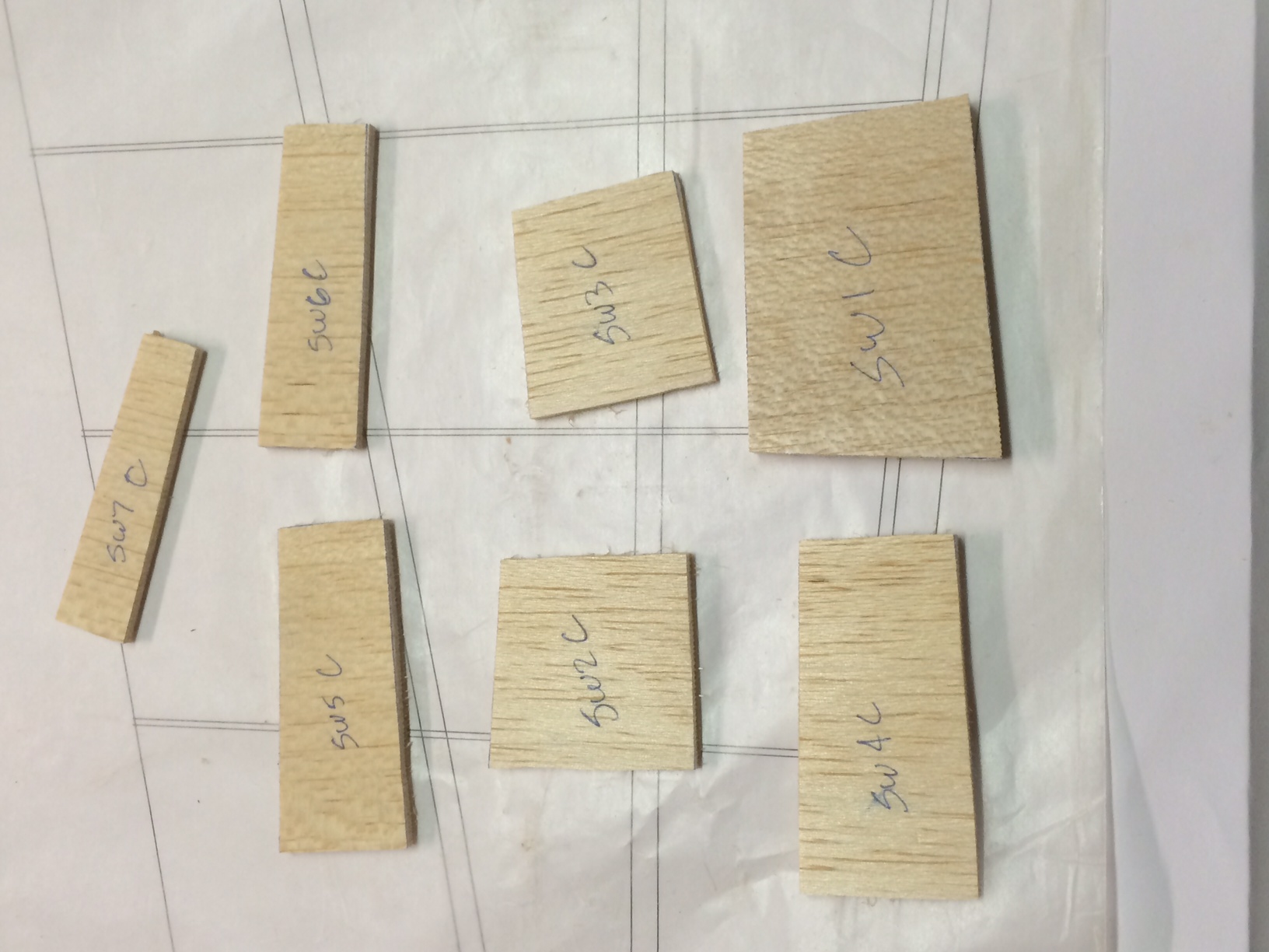

So after that was done I need to cut out the shear webs because I forgot to do it when I was preparing the wing skins (DUH!)
After those were done I installed the lower front bottom skin. This time I had to use the accelerator sprayed on the back of the wing skin and use medium ca on all the ribs, spar, and leading edge doubler. You have to work quickly by starting with the spar and rolling the skin to the leading while firmly holding it in place while the glue sets. (A tip on this is I work my way from the wing tip to the center of the wing as it is the largest area that you can keep elevated while you roll the skin on.)

Shear webs glued in place using med ca then I come back and wick thin ca on the joints to be sure they have good bond. (Do not use accelerator on these joints! It makes the ca brittle.)

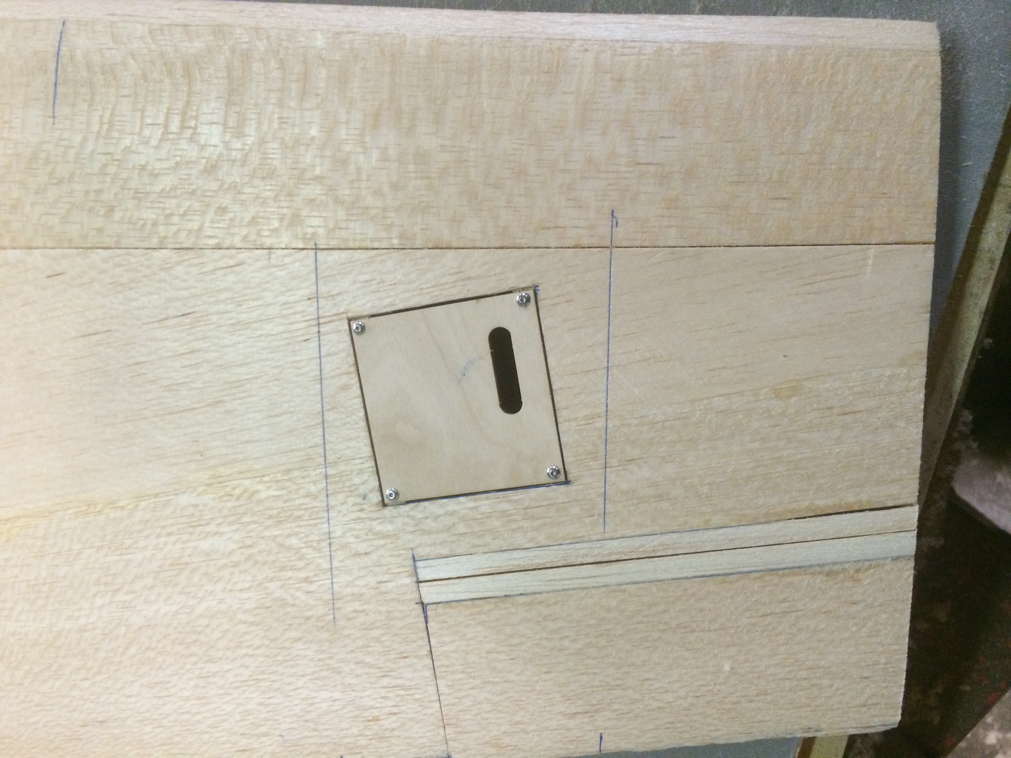

Just because there are no post doesn't mean nothing is getting done....

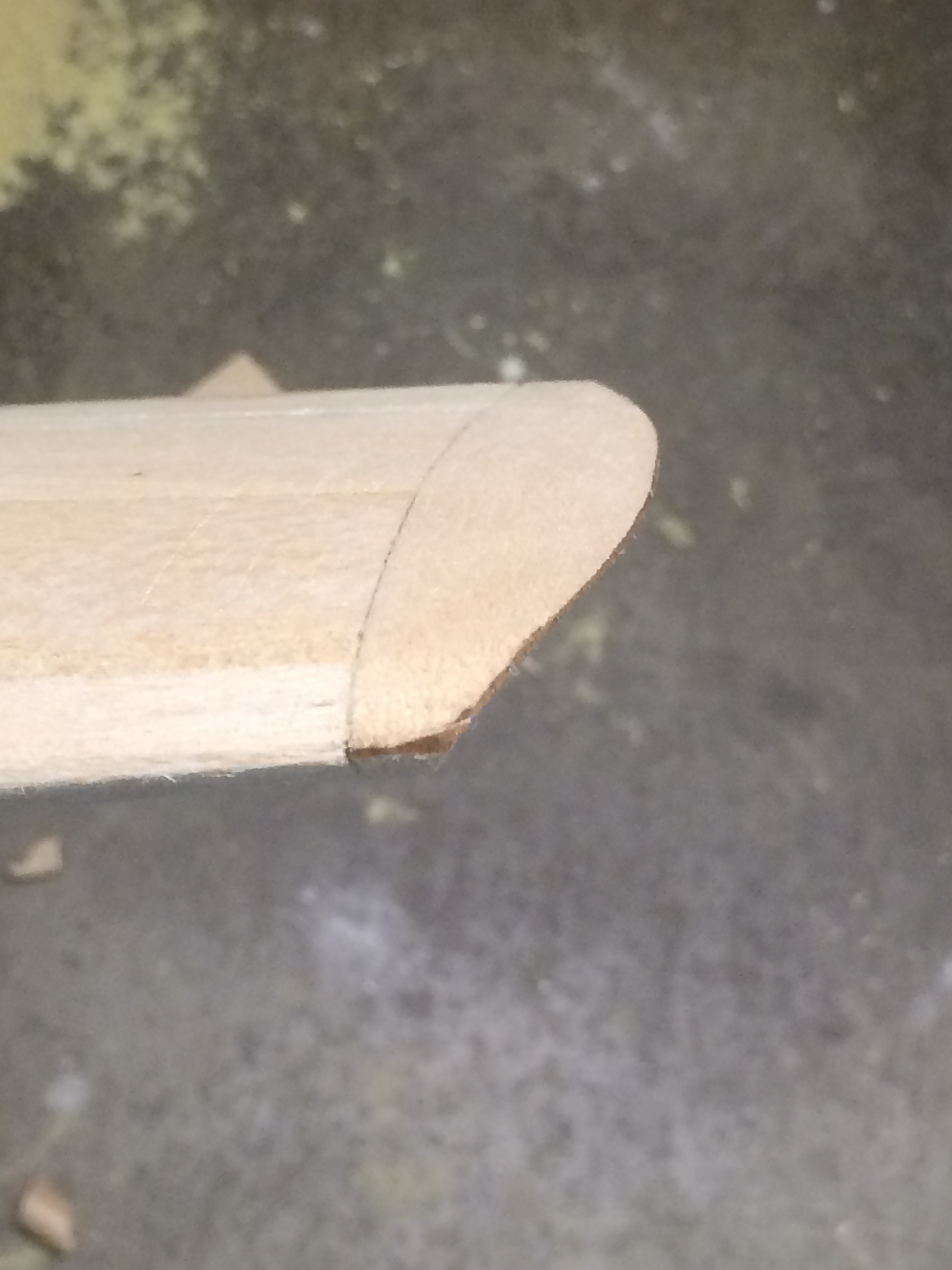

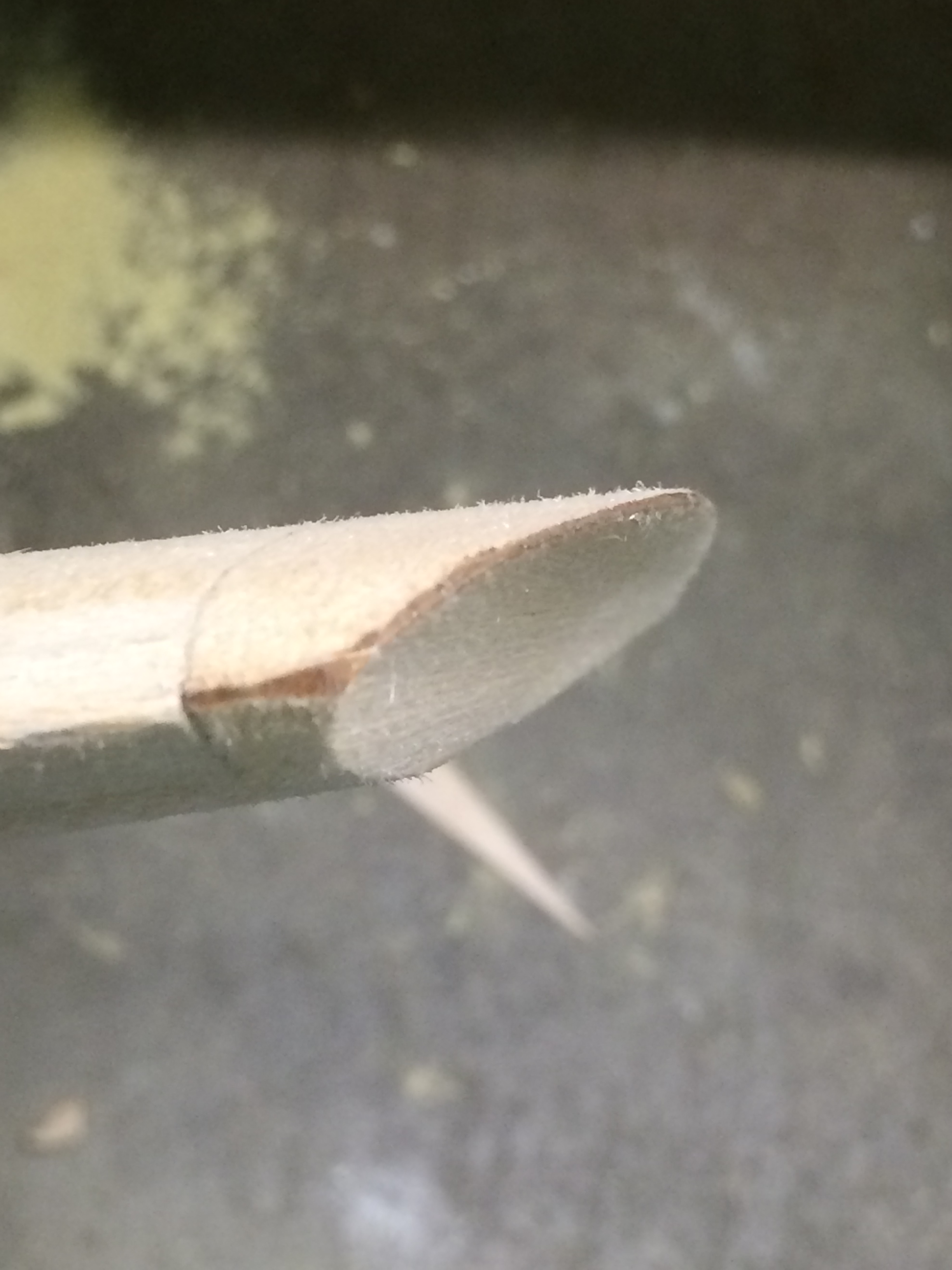

Horner wing tips..

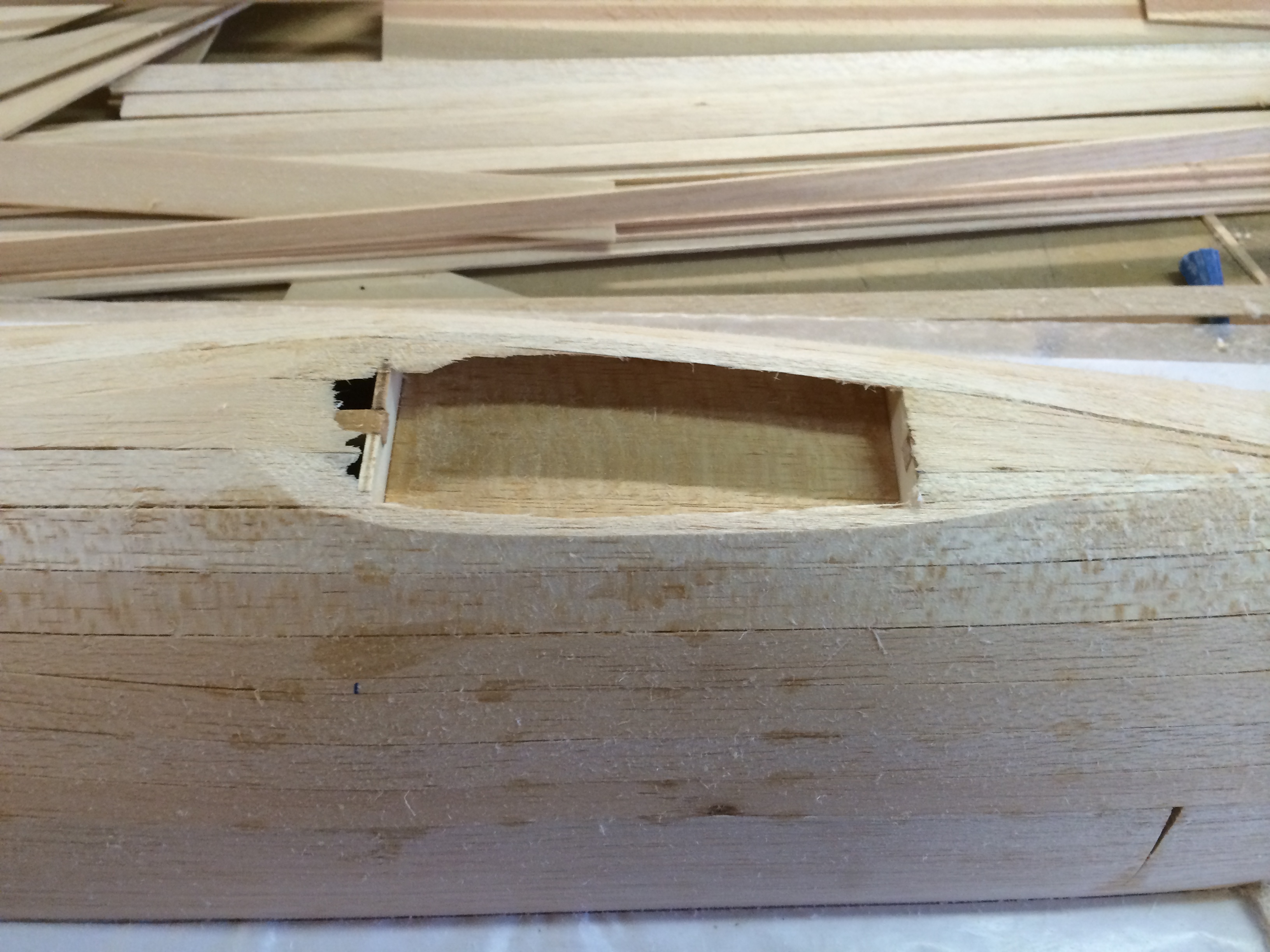

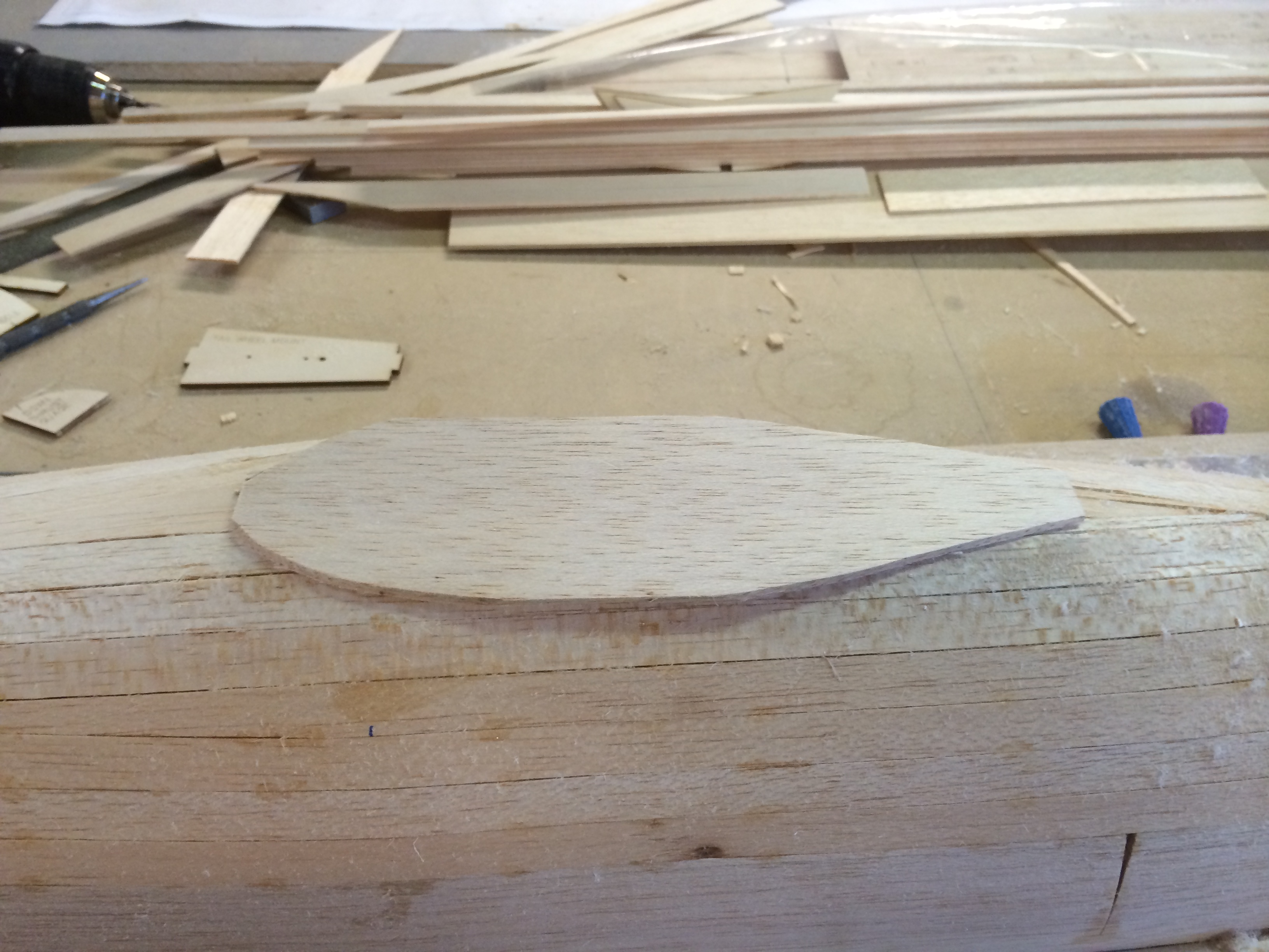

Fuse under construction...

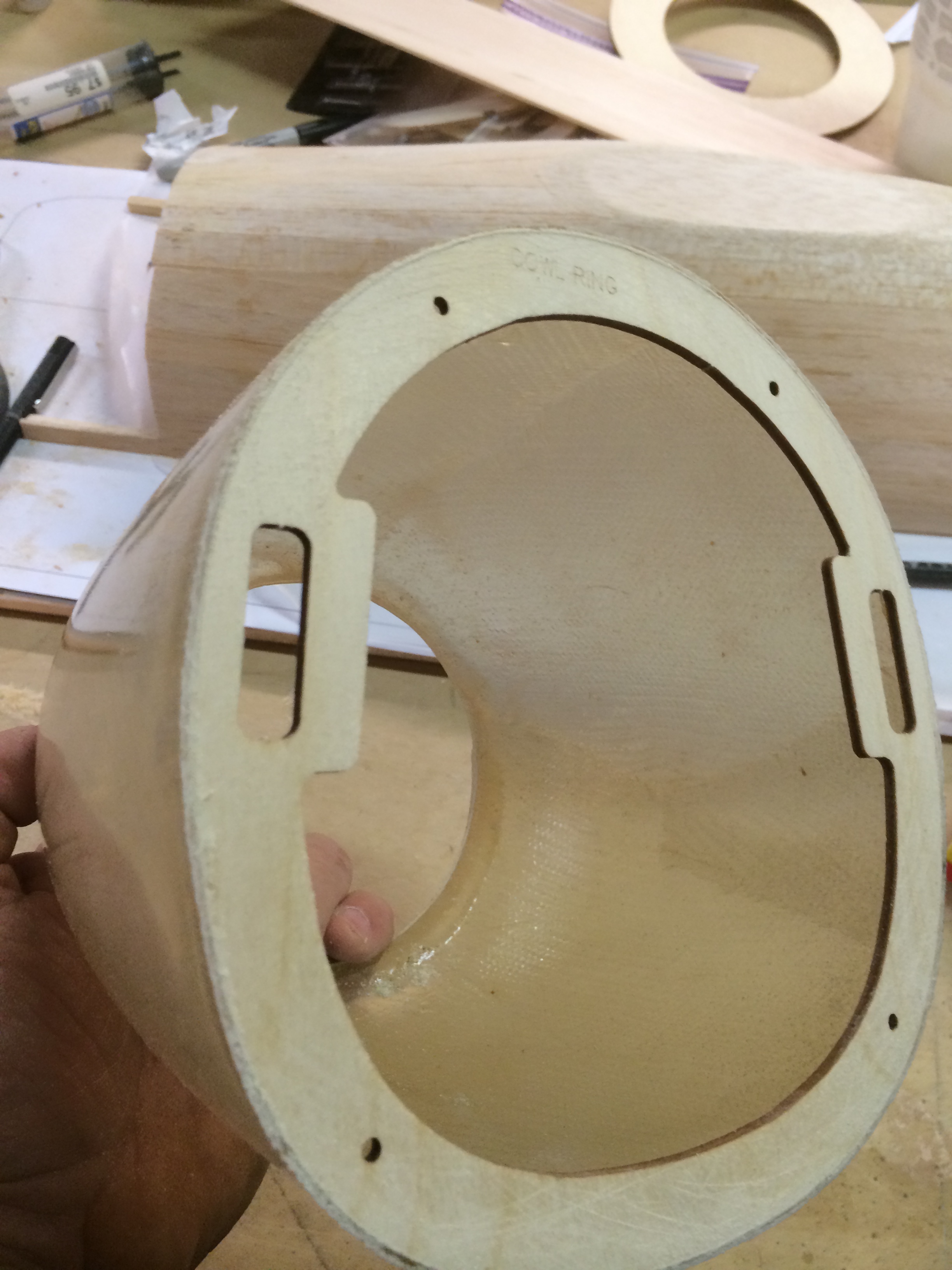

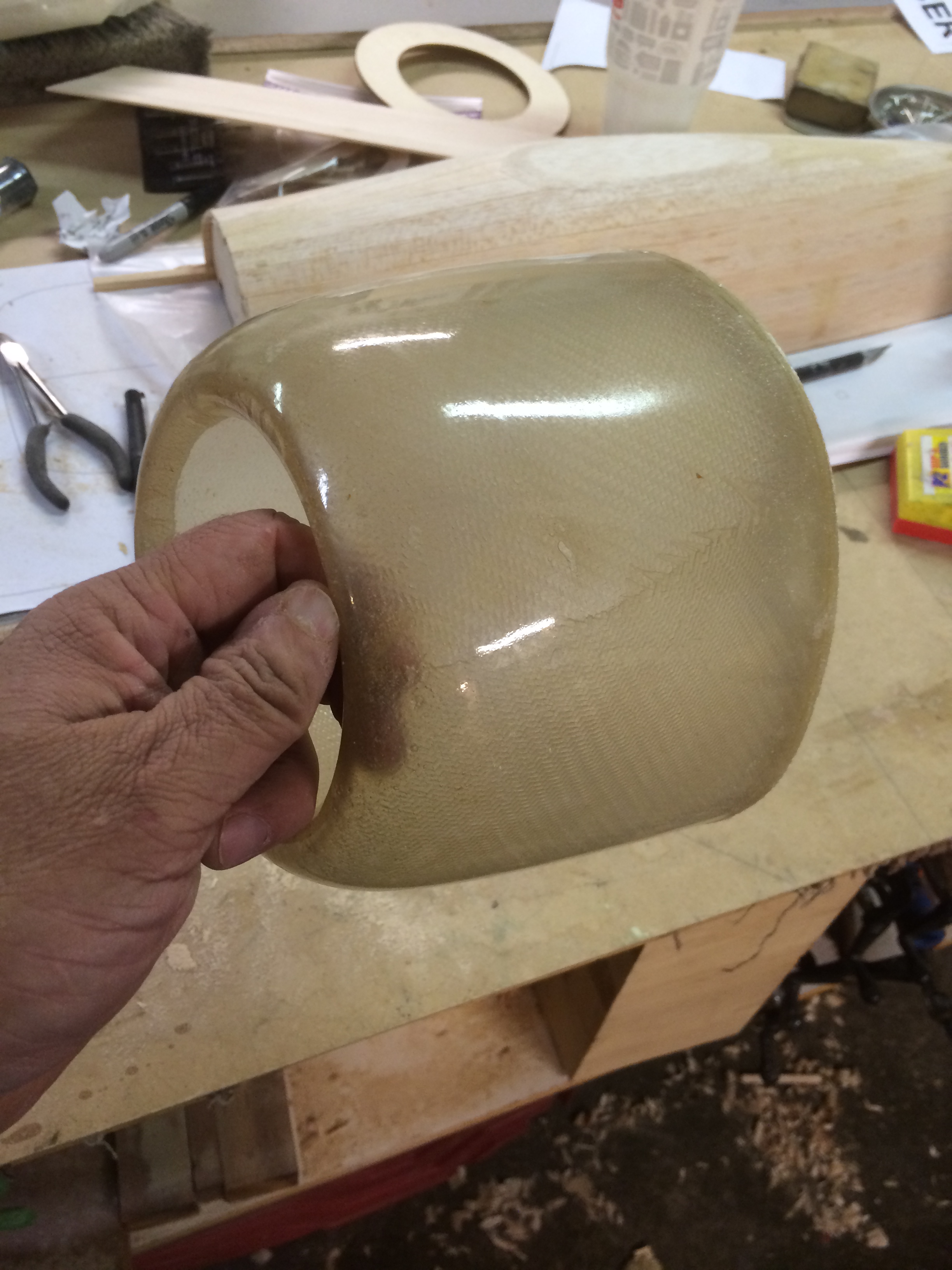

Mounting the cowl mount ring in the fiberglass cowl..
note... completed top fuse half in back ground..
