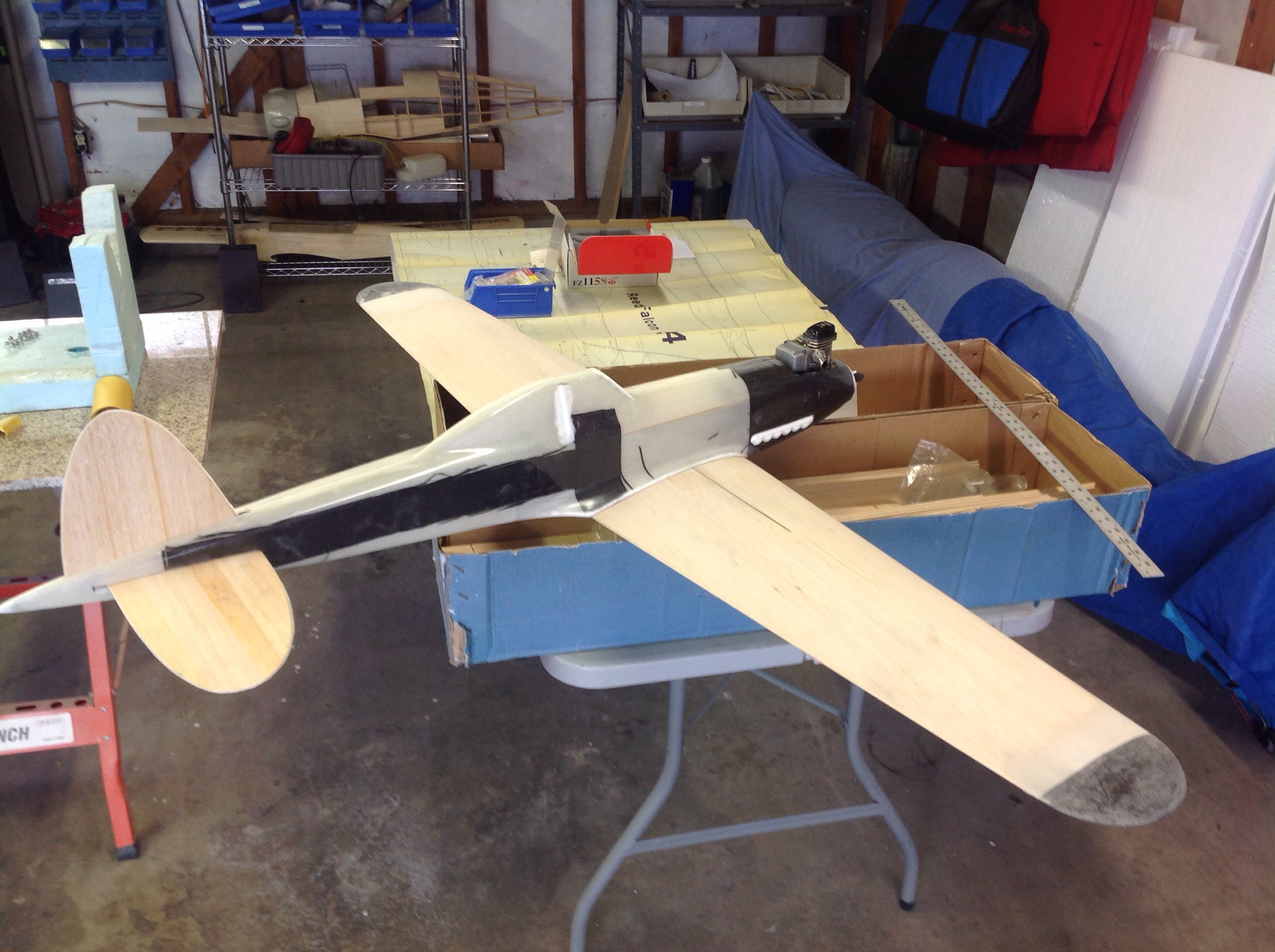

hello group, cool planes discussed and documented indeed!
i will post pictures of the plane I purchased and even further modified and plane to race with. i am new to all of this. i was hoping for gold class, but after seeing these planes and the aerodynamics, i do not stand a chance. oh well, silver class it is
world models p51 mustang. it is to resemble a reno racing plane from the 40's.
i got off of a guy in AZ and had it had a ys91. i took off the motor and replaced with 120. i got 3 of these motors off ebay and all were not good, sent them in to richard to fix. i did not know much about ys115 and thought 120 where the best , boy was i wrong. the cost to fix all of the motors stung a little- I should have bought 3 new - 115ws instead. oh well lesson learned.
wing is stock thickness, but shortened to 51", ailerons moved to wing ends. beefed up elevator push rods. the scoop was removed and therefore the fuselage has been modified. the tail wheel was moved to near the end of the fuselage. I did not do this and not preferred with this - and the tail wheel is not steerable. i will have to takeoff and land like a quicke. i tried to race in tucson but it was winded out, and I am glad I didnt (the 120s were still being fixed, so I stuck on the 91). I went over the plane again, put back on the 120 and I feel much better about trying to fly the pane and racing it. I am bummed I cannot make the SAMs races due to scheduling conflicts. I will give it a "college try" for the fresno race. i really have not flown the plane as I had a hard time getting the motors to run right. I will try to fly it this weekend in preparation to the phoenix race in a few weeks.
I am open to all feedback - the good and bad please. I am sure I have something wrong, i usually do. see you at the races!

Welcome! Glad you've caught "the bug" and are going to join us.
It sounds like you would like some feedback, so I will offer my comments (for what they are worth):
The extra retaining dowels at the leading edge of the wing are a good idea. Over the years, I have seen a few of the WM Mustangs' single plywood retaining tabs wear due to vibration at the center section.
It is good that all the control rods to the flying surfaces have Z-bends. If you are using metal clevises, I suggest using a nut hold the clevis tight. Again, I have seen vibration take its toll on the threads when this has not been done; resulting in effective loss of the control surface due to the clevis becoming stripped.
It is good that you have control going to both elevator halves. I would feel more comfortable with a carbon fiber rod (such as those available from Dave Brown, or at Central Hobbies), replacing the wood dowel and heat-shrink tubing, if you are racing in any class besides Bronze.
These race engines are very torquey. I strongly recommend you have a steerable tailwheel so you can make course corrections, as needed. Although my club's rules do not state anything specifically about this, as one of the SAM Contest Directors, I would have some concerns about the safety of operating as powerful an aircraft as this, without one -- especially in a crosswind. Safety is key, dead-sticks happen, and you may have to land suddenly with another plane still on the runway. You will want to be able to steer around another plane in such a situation. If for no other reason . . . to be competitive, consistency is the key; and, to ensure you get up and down consistently without damage and much wasted time on repairs stressing you out throughout the day (and cutting into your time to socialize and have fun with everyone come race day), a little work now will make you much happier in the long run.
Just my two-cents. I hope they are helpful. As a fellow Silver racer, I hope to meet you soon!

gtm,
Though the rudder will work ok with enough air flow over the surface, once you slow it down, youll need control. Plus at beginning of take off youll need to turn that thing to the right..... I suggest ditching the scale location and installing a tail wheel off the rudder/fuse (easy fix). I remember meeting you in Tucson. "Hormel Food"?
Old 03-11-2015, 07:15 AM

Originally Posted by MFLOOD3800
gtm,
Marty,
I put all mine in the scale location and prefer them there. By doing so there is less stress on the rudder and rudder servo. Also if the plane has to ditch because of dead stick with gear up the tail wheel is not going to pull out of the rudder or damage the rudder.
(there I go giving up secrets... darn it).
Skids
Old 03-11-2015, 02:54 PM
  #119
MFLOOD3800
My Feedback: (51)
MFLOOD3800's Avatar
Join Date: Apr 2004
Location: beaver, UT
Posts: 1,662
I have heard of the stress as you say, but havent had an issue with mine yet. But others do echo your concerns. I have noticed the control seems to be better the farther back you go, though as you stated, there are other sacrafices when doing so.
I think the big issue here is he stated it wasnt steerable at all?
That needs to be addressed in rules some where.
He needs total control of that thing at all times.
That was pretty much my intention in my posting

yes I agree marty. so simple to put one on the plane no matter where its at. cant do a good take off with out one. just make an adjustment to the rules. champ race version 1.1

Originally Posted by Jimmy Skids
Marty,
Skids
Your secret is safe with me Jimmy, I will remember to do that to all the (Mustangs) I built. LOL

Just got off the phone with gtm, and he will be getting a tail wheel assembly installed soon. He is a dedicated racer and has plans to create a good fleet that will make all of us jealous. Cant wait for the races to get here already.
Jeff, i will be making a change to the rules shortly

What I nightmare to fix but I was able to rip out the old tail wheel assembly and replace with a steerable tail wheel system in the exact same spot.
Thanks everyone one for the advice. I feel a whole bunch better of ground control of the plane!
I have 2 more questions
one mentioned about the metal clevis on the surfaces, to fix do I just put a nut butted up against the clevis? Or Should I change them all to plastic?
also one of my previous photos showed the inside of fuselage with the glue on firewall. Does it look like there is enough glue on the firewall? Do I need to pin the firewall - what does that mean and what does that look like?
do I need to glass the wing 3-4"? I doesnt look like it is.
i have already preordered 2 spitfires and was able to acquire a new ys115ws. Hope I get those in time to get and build by the November race

the metal clevis looks fine to me as long as you have a Z bend on the other end.
now a nut tightened up against the clevis will remove slop. the biggest thing i can tell someone new to race is have very good centering servos and ZERO slop. On your ailerons and elevator have a decent set of servos.
