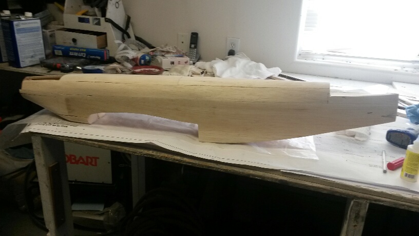

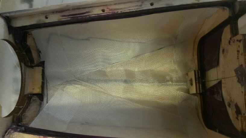

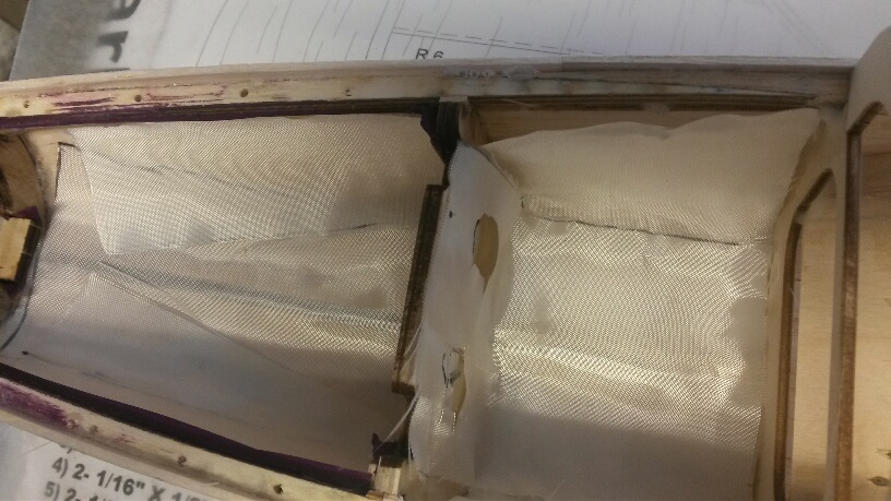

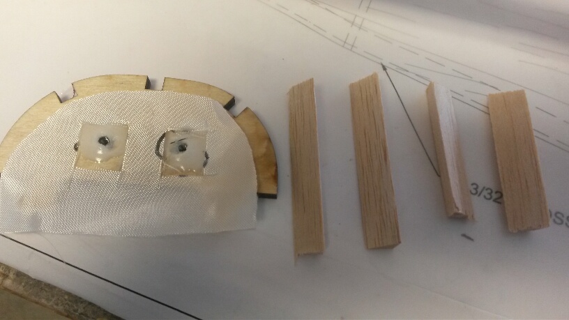

I went out early today before I got busy with work to get the inside of the lower cowl assembly glassed with pre-cut sheets to size needed,
After this sets up ( I used extra time), I will then look into cutting the removable lower section away.
Im quite nervous that some of my CA and epoxy may have gotten into areas it wasnt suppose to, but hopefully I had enough monkote in those areas
While I was glassing and clothing the inside bottom cowl for strength , I also tri-stocked both sides of fire wall and glassed the back side of fire wall only with cloth after making sure they were square and being careful to not get epoxy in my blind nut areas.

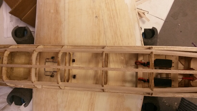

Old 03-07-2016 | 06:10 PM
  #55
MFLOOD3800's Avatar
My Feedback: (51)
Joined: Apr 2004
Posts: 1,662
From: beaver, UT

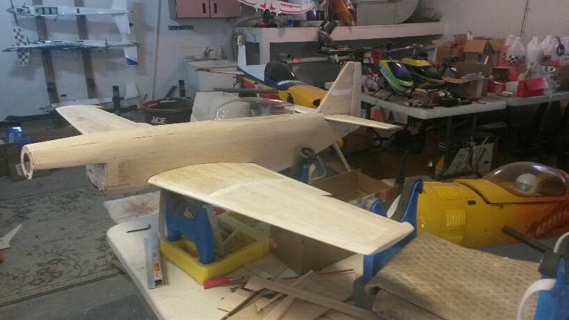

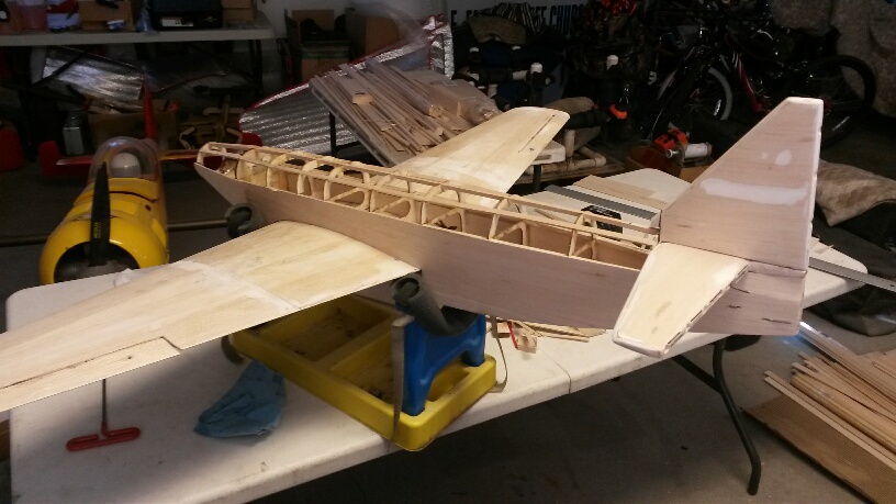

Here are the pics of the top ribs installed, the glass work all done, the wing mounted with 1/4x20 nylon bolts ( I tapped and threaded the bolts straight to the wing mount support and added the two front wing bolt areas.
I also have the tail ready to install, will wait til it is covered.

Looks l,ike the patient will live doctor!

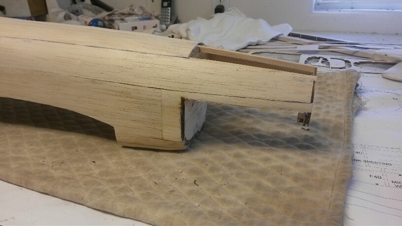

Old 03-08-2016 | 05:30 PM
  #58
MFLOOD3800's Avatar
My Feedback: (51)
Joined: Apr 2004
Posts: 1,662
From: beaver, UT

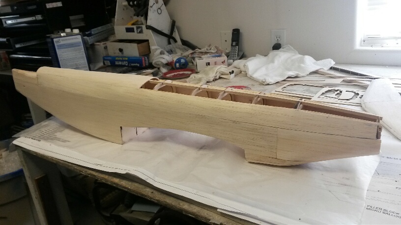

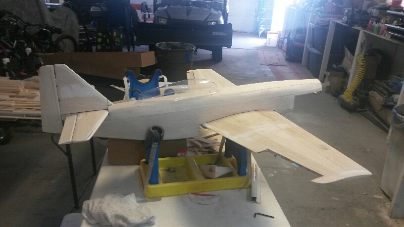

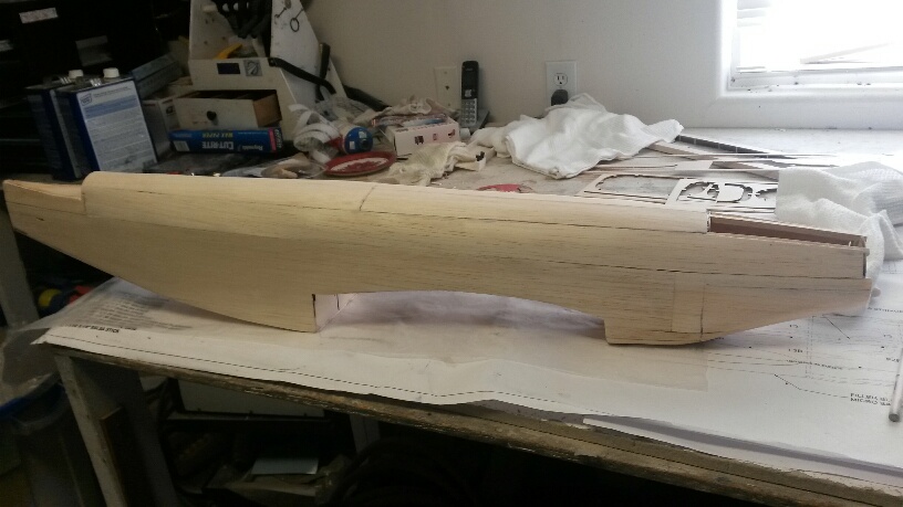

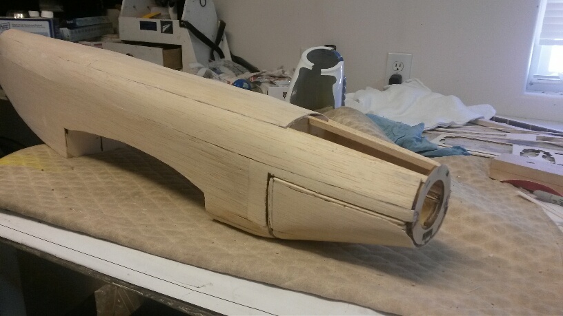

Got the fuse planked completely other than the top front hatch area - I wanted it open to see where the bottom cowl should be cut at.
It feels good to get it sheeted !!
The Tail is sanded and fit and ready to glue once covered.
The wing has been test fit and ready to cover
The fuel tank (16 oz) has been placed in to ensure it fits
- I shouldve drilled the fuel line holes thru the fire wall, but forgot, so now I will do it when the bottom cowl is removed
Cutting the bottom cheek cowl is gonna be a chore.
I had marked the areas at one time, but with my sanding I eventually removed them. I have the horizontal area cut loose already, but the firewall side edge and bottom is being stubborn
I took a break , charged 8 lipos, 3 planes,2 radios for a race this weekend, and fired up a new Viper to maiden sometime this week as well.
So much to do as I prepare for a 3 weekend blast from Utah to Az to Cali racing.

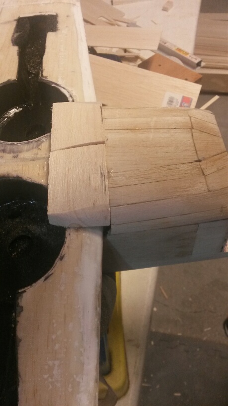

Old 03-09-2016 | 07:40 PM
  #59
MFLOOD3800's Avatar
My Feedback: (51)
Joined: Apr 2004
Posts: 1,662
From: beaver, UT

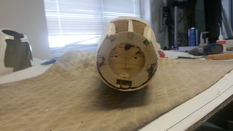

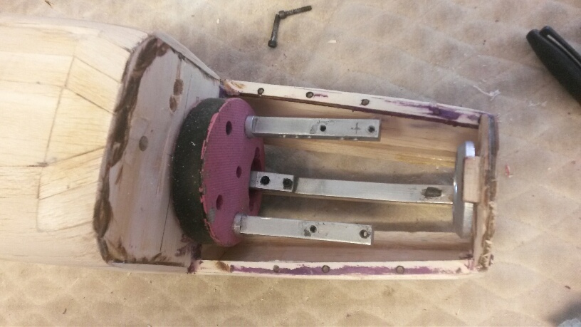

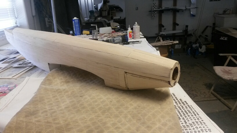

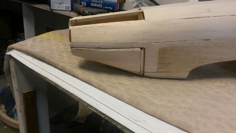

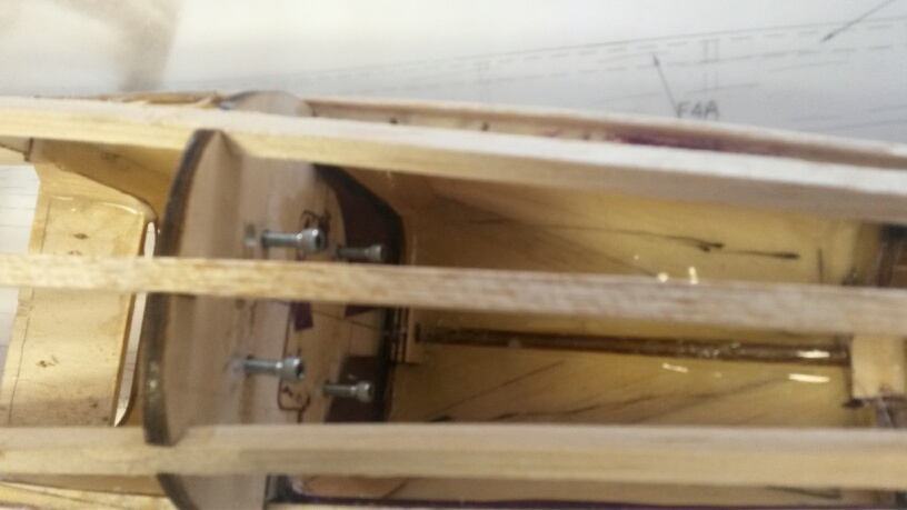

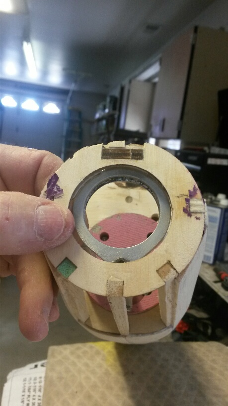

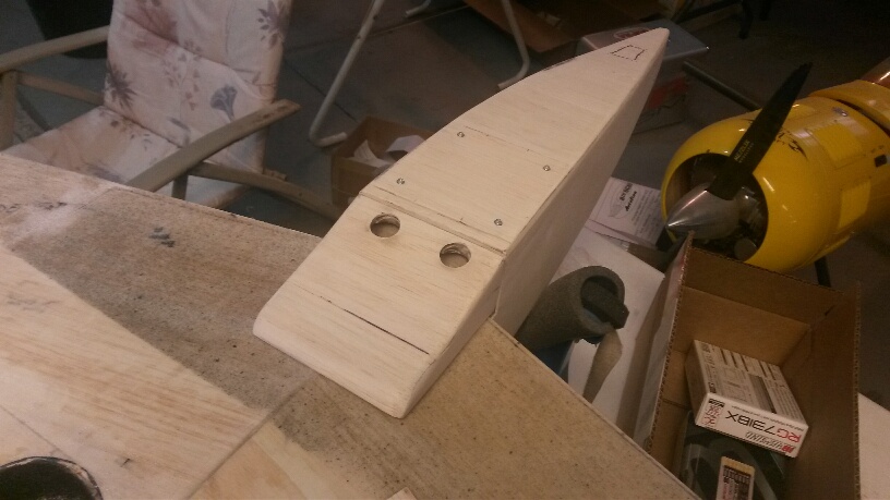

Finished all the planking on the fuse finally.
I also cut loose the bottom cheek cowl (some repair work was needed as I got carried away with glue)
I pre installed the engine mount to make sure it all fits, I even put the engine in the mount.
I drilled two holes thru the fire wall for the fuel line
- I will use a 3 line system in my tank as I do on all my YS engines.
- one line goes directly to the pick up nipple
- one line goes directly the pressure nipple with a "T" that exits bottom of plane for releasing pressure after a run
- one line goes directly to bottom of plane or out fuse cowl side for fueling and defueling
I also shaped the top air scoop (not pictured) and will cover it before installing it on top of fuse front end
I am beginning work on bottom air scoop and frt of wing filler to fuse
- I will epoxy these directly to the wing so building these requires the wing on the plane

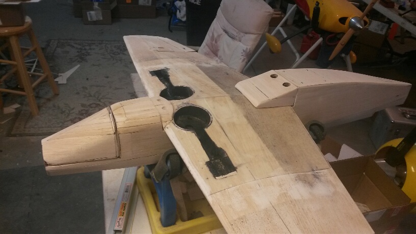

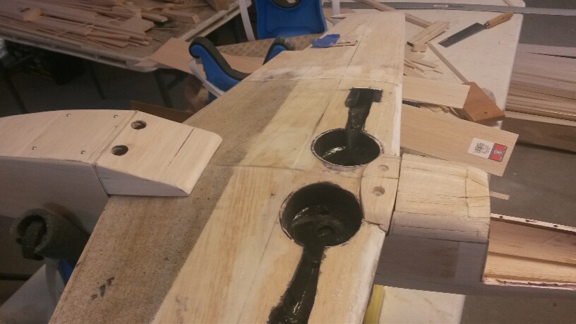

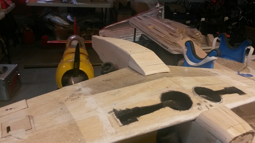

Old 03-11-2016 | 05:22 PM
  #61
MFLOOD3800's Avatar
My Feedback: (51)
Joined: Apr 2004
Posts: 1,662
From: beaver, UT

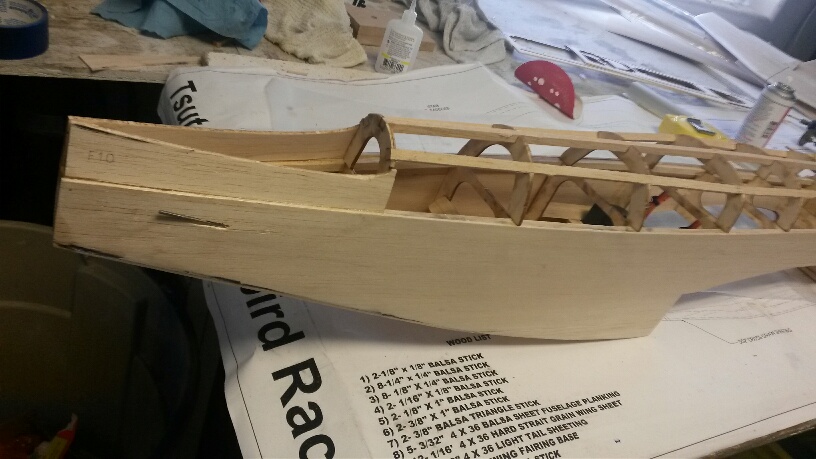

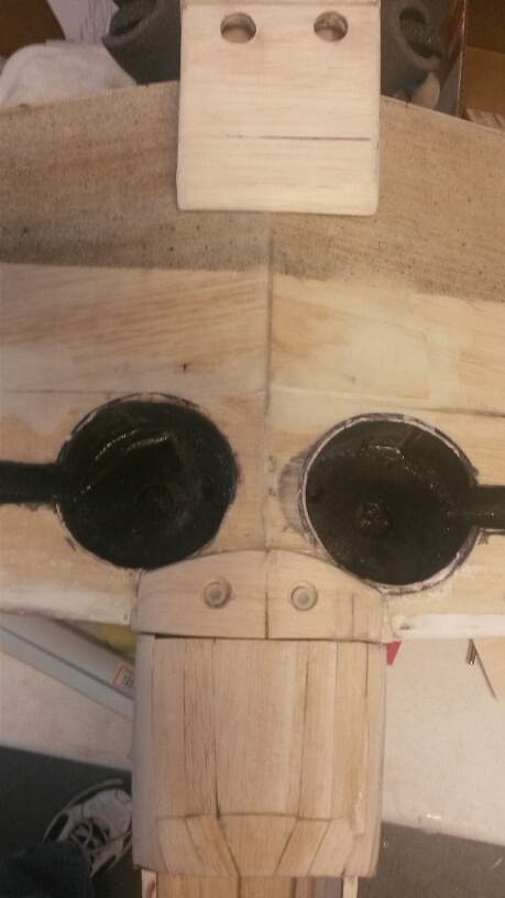

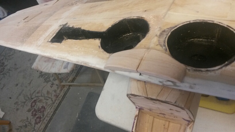

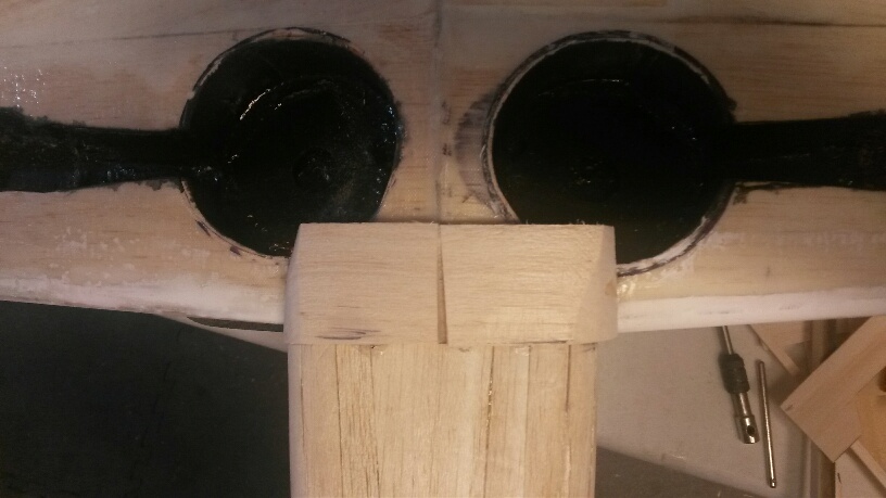

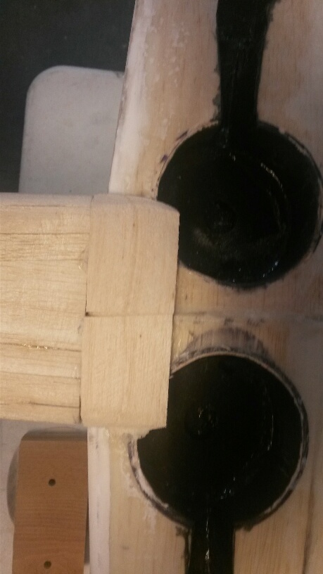

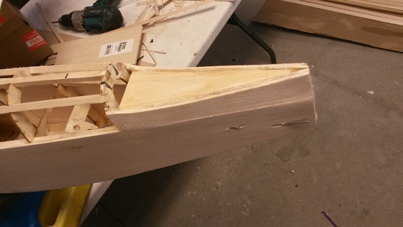

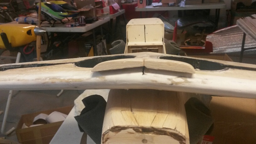

Spent my last days here in Utah getting the fuse done and wing along with air scoop and front wing filler.
The front scoop I just used 3/16" balsa frame work with 1/8" sheeting reinforced with tri-stock and 1/4x1/4 as well.
I will glue this piece to the wing once it is covered.
The front filler part of the wing/fuse area I used solid balsa stock, shaped it and glued it directly to wing.
I feel pretty good about the amount of work done in this trip.
Basically what is now left is the filling and sanding prior to monokoting.
I once again also had to take a peek at what it looks like so far along .... I know I know Im a new beginner builder and couldnt resist seeing some fruit from my labor.
Now its time to get back to some races, and more traveling for work.
