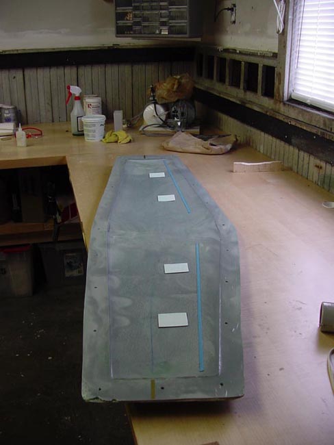

Here's some photos of my latest mold. It's for my composite .60 size Tsunami and I laid the first wing up in the mold today. Final results should be seen Monday. I'm planning on racing this plane at Sacramento in March.
The blue stripe is trim tape used to make a ridge in the mold and the white squares are the servo hatch bay recesses.

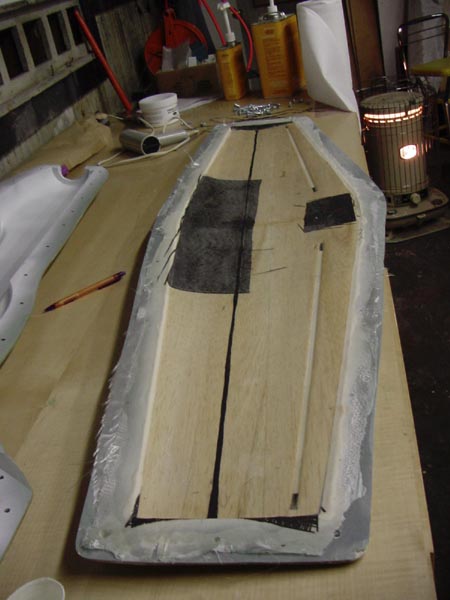

The mold was prepped with mold release, a coat of primer sprayed on and then layup began. The surface is 2oz glass, then 1/16" balsa, then 4oz glass with some carbon and other reinforcements. Right now, it's waiting to be put in the vacuum bag

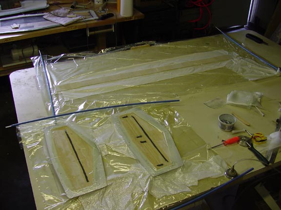

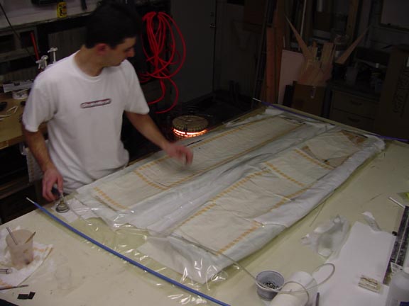

Default wing halves in the bag
Here the wing halves are in the bag and I am making sure everything is ok as the vacuum bag sucks all the air out. On top of the glass on the wing panels is "peel ply" which is used to soak up resin. Some paper towels are on top in case the there is too much extra resin and needs soaking up. When the wing is dry in 24hrs, the peel ply is removed and it takes with it excess resin that it soaked up, thus reducing weight.

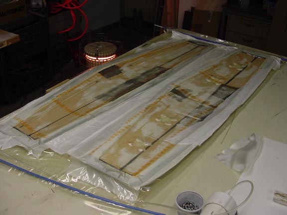

Old 02-17-2002 | 04:34 AM
My Feedback: (10)
Posts: 1,445
Received 20 Likes on 20 Posts
From: San Jose, CA

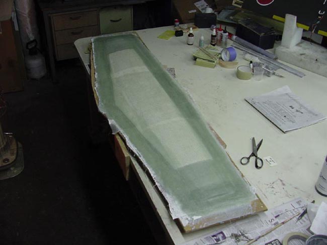

Default vacuum on
Here, the vacuum system has sucked all the air out of the bag and you can see the peel ply and paper towels sucking up the excess epoxy. Any "white" areas are where there was just enough epoxy and there is no excess being absorbed.

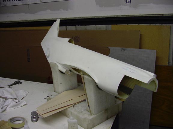

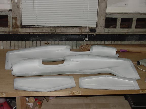

Default Next up
Next for layup is the fuse and tail. These molds have been prepped with mold release and then primer was sprayed on so that it comes out of the mold ready to sand.

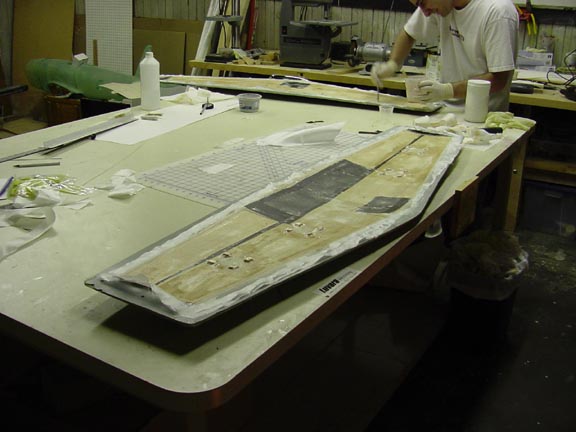

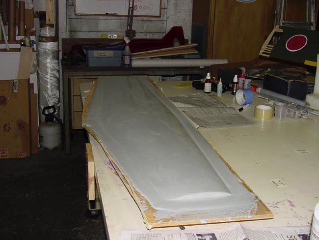

Default how the wing mold is made
In case anyone is wondering how the wing mold is made, the next three photos will show you.
This is the wing plug all sanded and polished with a "splitter plate" going all the way around the wing. Mold release is applied and then it's time to start mold making.

Default Slurry coat
After the wing has the splitter plate around it (so that two halves can be made - top and bottom), a surface slurry coat is applied. Here it is epoxy with grey pigment and microballoons mixed in. A good, thick consistency is mixed and then spread all over the wing. A brush spreads it around and it the surface coat eventually smooths itself out. Let this dry and then it's time for reinforcement.

Default Reinforcement
Now it's time for reinforcement. Time and patience is needed here as layer after layer of heavy fiberglass is laid on top of the dry surface coat. In the end, some Aeromat and then a smooth layer of cloth is put on top to finalize this half of the wing. Once this is done, it's then time to remove the splitter plate and do the same process all over again for the bottom half of the wing...

From: San Jose, CA
Default fuse out of the mold
Here's a fuselage out of the mold that's under construction. You can see the primer was built in to the model in the molding process and has virtually no pinholes!

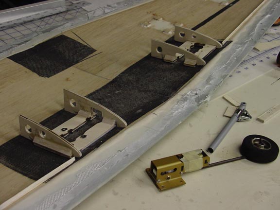

Default Composite racing wing
Center panel with retract structure. Spent a few hours laying this out and then making templates for future use. Will glue them in tonight or tomorrow. The main spar will butt up against the rear of the landing gear ribs to tie things in. The balsa near the leading edge is there to keep the "splooge" (mix of epoxy and structural filler material which is laid around the perimeter of the wing) from seeping into the wing when the mold is closed up. This ensures that there is a good bond on the leading edge.

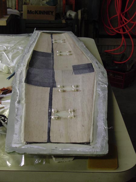

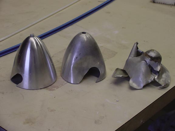

My stock of Tru-turn spinners for the Tsunami. Racing has its high mortality rate and it hit me at two races. I'm not proud of this photo, but heck, there's $200 sitting there in spinners. The one on the right probably hit the ground at close to 190mph. The 3rd one, on the left, hopefully won't end up like the others!

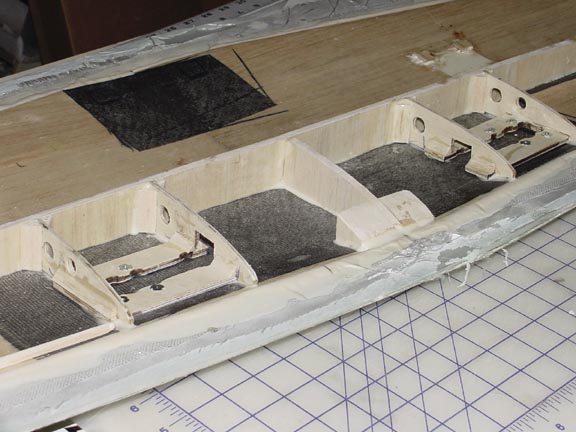

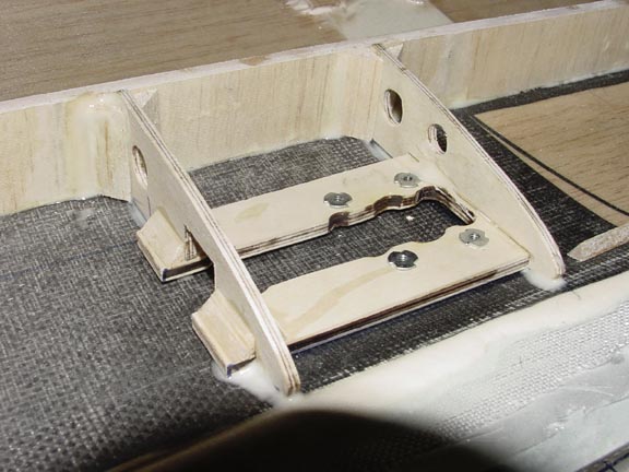

Main spar and anding gear structure area glued in place. The center rib/wing mount block supports were also installed for the LE.
Old 02-19-2002 | 05:26 AM
My Feedback: (10)
Posts: 1,445
From: San Jose, CA
Closeup of landing gear area

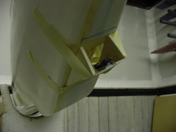

Chris's (my brother) neat exit scoop. The real Tsunami used this as an exit door for the radiator spray and heat exit. We're using it as a hatch to get to the servos and put the switch in there. Why the servos in the tail?? Wait till the next photo!

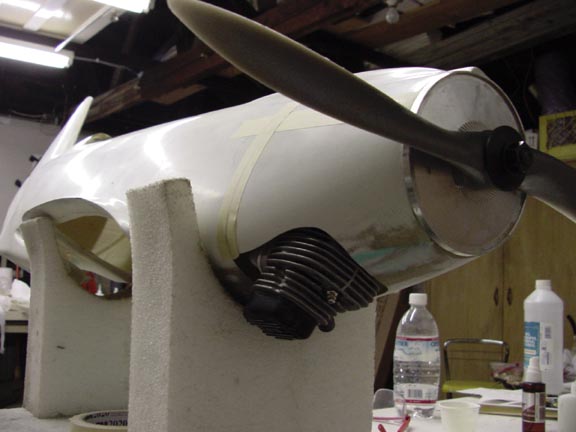

Well, the reason for the elevator and rudder servos in the tail is because of the huge Enya R 120 being stuck in the nose as is apparent by this photo. That's a lot of motor.
Old 02-19-2002 | 05:32 AM
My Feedback: (10)
Posts: 1,445
From: San Jose, CA
Close up of the Enya 1.20 in the nose.

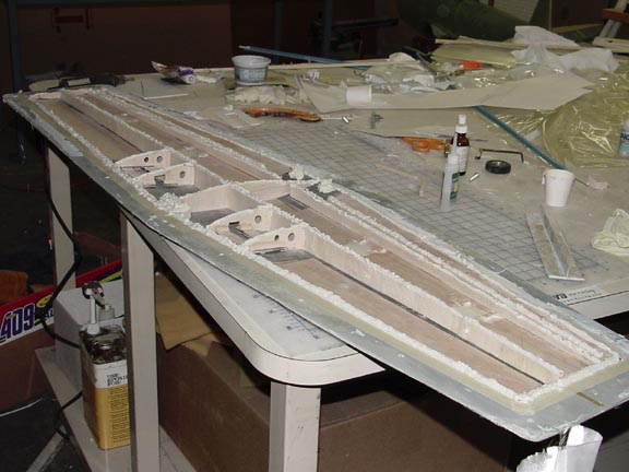

Okay, back to the wing. All spars/supports in wing and a syringe was used to apply a mix of epoxy, milled fiber and some cabosil along all the joints. I was probably too heavy overall with this, but it's the first wing and I don't want to miss any spots. Better to be safe than sorry.
