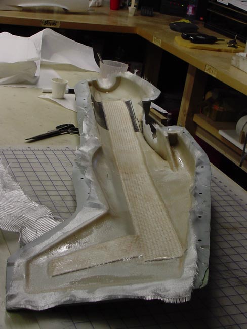

Next for layup is the fuse and tail. These molds have been prepped with mold release and then primer was sprayed on so that it comes out of the mold ready to sand.

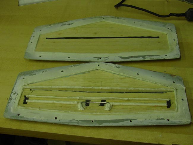

I'm somewhat an amateur at molding. Started making parts a few years ago and progressed over time to what you see here.
I like to use a "gel coat", primer, or something to reduce pinholes when molding. I find that I get better results and it's just been a habit. A lot of places paint or put a gel coat of some sort on in the mold. I've just followed suit.
I have been using PVA as my main mold release and are trying some other waxes now as PVA tends to give a lot of imperfections. After I apply the mold release (whatever it is), I spray on the primer, let it dry, and then do my layup.
Man, I'd love to CNC all my molds!
Mine are all hand-made.
For a splitter plate, it tends to be what I have around the garage. I have generally used wood shelving with a smooth surface on it, or it can be plastic, or metal. It is hard to make sure that they are perfectly flat and I do get some good parting lines, but not perfect. Works for my type of usage I guess. Basically, I make a cutout of the profile of the wing or fuselage, drop it into the splitter plate, center it where I want the parting line, and then use clay to fill in the voids.

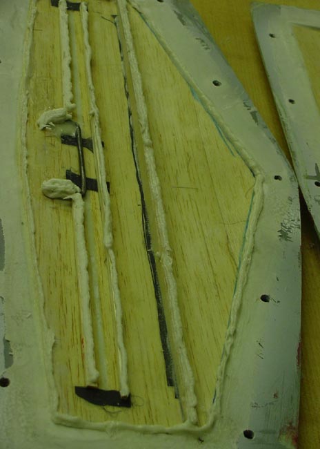

On the composite stab, I put a main spar (just endgrain balsa) and then maybe a 1/8" balsa center rib and some stringers or wood near the hinge line. What I put near the hingeline depends on whether or not it is skin-hinged or going to be conventionally hinged. Other than that, it's hollow.
I'm going to finish the stab shown in the pictures tomorrow and possibly lay up another wing or fuse this weekend. More photos to come...
Michael

My compliments on sharing your learning experiences. Sounds like your molds are in great shape, but you need some experience with layup techniques.
I suggest reading how the RC glider guys build composite planes. Particularly F3B models, which often see loads greater than 18g's over 3-meter wingspans!
Wing Weight
I suspect all of the weight of your wings is contained in unnecessary epoxy. I have vacuum bagged quite a few wings with either balsa, carbon, or fiberglass skins.
The main task is to:
1) completely wet out the cloth
2) Immediately get all the epoxy you can off of it. Use an old credit card, or squeegy. You have to work very gently with light weight cloth or you will stretch it. The strength of any epoxy (FG or carbon) matrix is in the combination of the two. Extra epoxy adds nothing to the strength, only weight. You should target a 50% epoxy by weight. So if you are laying down 3 oz / yd^2 and 2 yards of cloth (for 6 oz cloth weight), you should plan on using no more than 6 oz of epoxy.
Yes, balsa will soak up the epoxy. You can thicken it with cab-o-sil (or similar) a little to help the absorpsion.
You want to get all the epoxy you can out of the layup (after completely wetting out the cloth). The surface of the cloth should look almost dry after using the card to get as much epoxy out as you can. Certainly not shiny, just kind of damp.
I also suggest you stick with 1/16 balsa and not go with 1/32. You need some thickness in the skin to give it strength (resistance) to deformation.
I suggest a fairly light weight FG cloth for the surface layer only. This will give you a smooth finish for painting, etc. and many fewer pinholes.
Spar Comments
You mentioned using vertical grained balsa for the shear web. This is fine. What about spar caps? You need something to take the compression/tension loads. I suggest either pre-preg carbon from ACP or CST. For formulas to calculate the strength you might need, see the following link:
I'm not sure how your spar is built, but if the spar takes all the bending loads, then the skin only needs to be able to take up the torsional loads (twisting). This is best accomplished, as others have mentioned, by using all glass on a 45 degree bias to the spar. This 45 bias cloth layup will also help keep your ailerons from warping.
Trimming the edges
I suggest completely trimming the extra cloth. Before joining the wing halves, completely trim all surfaces so that they are perfectly flush with the surface of the flange of the mold. This is easiest done while the epoxy is partially cured. Easy to cut with a single edged razor blade, but stiff enough to hold it's shape. Then you require a relatively small amount of spooge (epoxy & cabosil) to join the wing halves.
My best wishes to you and your project. I am hoping we can all learn from each other.

#72
My Feedback: (10)
Pulled the stab out of the mold this morning. Came out pretty nice. I used just wax for release on this mold and it came out good. Only complaint is that when painting or primering the mold, you have to gently mist the paint on, let it flash, and then come back and shoot an even coat. Otherwise it will act like there are spots of moisture on the mold. Could have been my gun, but the PVA did not seem to do this. However, PVA is water soluble. I need to put a moisture trap on this compressor.
Total stab weight was only 4.6 oz!
If you notice in the above photos that I put carbon near the ends of the hinge line. This reinforcement is too much and makes the hinge hard to move.
Michael
Michael
