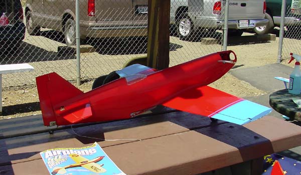

The funny thing is that there is a F1 revival going on with a lot of new Q40's based on F1 planes.
The full scale Miss Ashley (aka Vendetta)
Photo from AAFO's MA2 Slide Show
California Speed Pros (Lyle Larson) Vendetta
Rusty Van Baren's Miss Ashley II
Both photos from the PylonWorld.com QM-40 Planes List

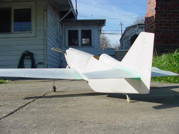

Not much new today on Chris's Tsunami - nothing that a photo will really show. Made elevator and rudder pushrods, installed a control horn, put the rudder post in, did some filling, etc.
In other news
- Props are on their way from Australia (yes, you read that right)
- Painting will *hopefully* happen this weekend (17th).
- Soon to be released will be the Luvara Air Racing webcam. Yes, watch us build in the garage live! Since I recently installed DSL and a wireless router, we'll be able to take a laptop out to the garage and hook up a webcam. Might be interesting to watch our construction! - more info to come.

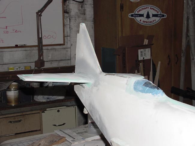

So, here's a photo from today. Canopy is mounted, taped over and filler applied around it. Most control systems are in. It's getting there...

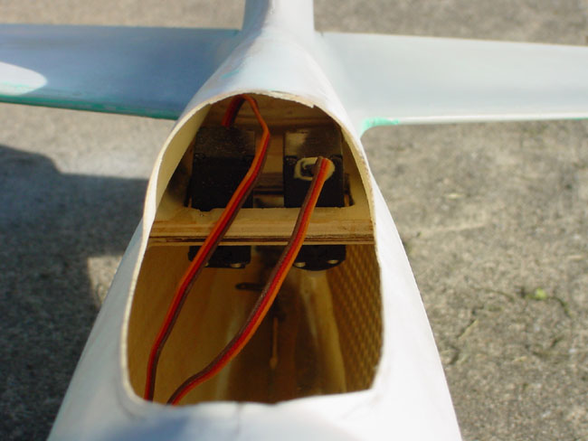

What did you use for a firewall, plywood? Was the firewall glued inside of laid up glass? How thick was it? I finished the molds for my 25% Edge 540 and laid up the first parts today. I did add a second layer of 6 oz. cloth around the firewall area but I am unsure of the ply thickness. I know some pattern guys that fly 1.20’s with only 1/8” lite ply behind the glass firewall. That does not sound strong enough, yet I don’t want a sled.

My firewall is actually nomex honeycomb with glass on both sides, 3/8" of an inch thick. It originated from some floorboard in a 747! I have a friend that works at an airline and gets old floorboard material which he gives to me from time to time. Works great for R/C!
I've seen 1/4" or 3/8" thick endgrain balsa with carbon and glass bagged over it on 75 cc motors. Something in that arena is about right.
How big is your firewall dimensionally?
