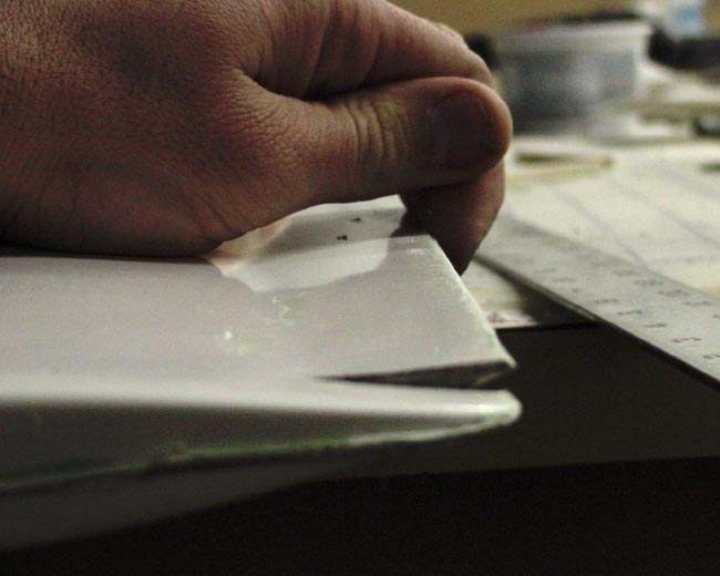

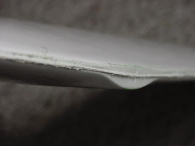

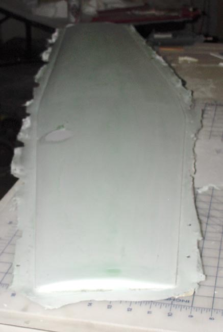

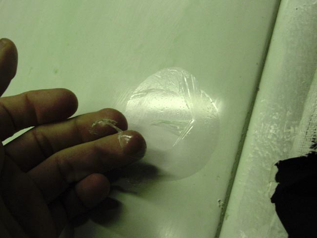

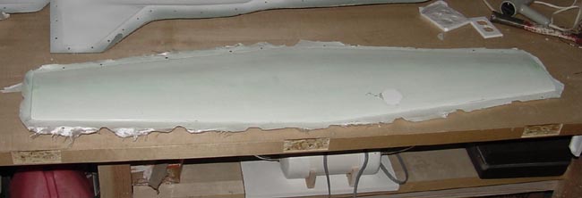

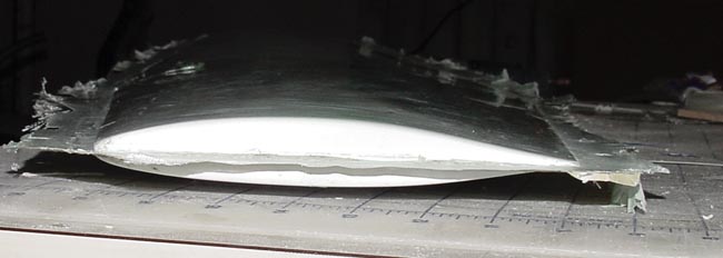

Okay.. final results are in... Wing came out pretty good. It's about 6 oz over what my foam wing weighed, but that is not surprising since some of the things are way overdone on this wing. Next will be at least 6 oz lighter! Live and learn
Here's some photos. I apologize for the lighting. It's hard to shoot this white surface in the garage with flourescent lights and I'll take some better ones in a few days. It was a long day today and I'm going to be a couch potato for the rest of the night...
Profile of the laminar flow airfoil
#35
My Feedback: (10)
Profile of the wing. Note that there are 4 servo hatch bays. There will be flaps and ailerons on this wing. Both the flaps and ailerons will be used to help the airplane turn in what is called "camber changing". About 5 degrees of downward deflection on both ail and flaps will be used when the elevator is pulled up, creating lift.

Looks great. That laminar airfoil looks like the one you sent me about a year ago. It looks to be a variant of Naca 66. Very similar to the Vortex and Neme-Q Q500 planes.

The airfoil is probably the same or close to what I sent you. Did you build a wing with it? I sent it to several people and have heard nothing back.
I started with a Nasa-Langley nlf-213 and modified it to get what is there. I played around with another airfoil since I designed this one that is much better, but I was not about to re-mold the fuselage to make it fit!

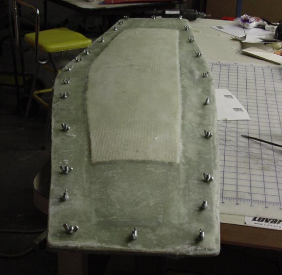

I'm sure I can be wrong and my brother will elaborate.. I worked on the wing today and took some pics with the camera, and I'm sure he'll post them later tonite!
