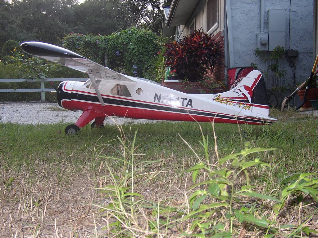

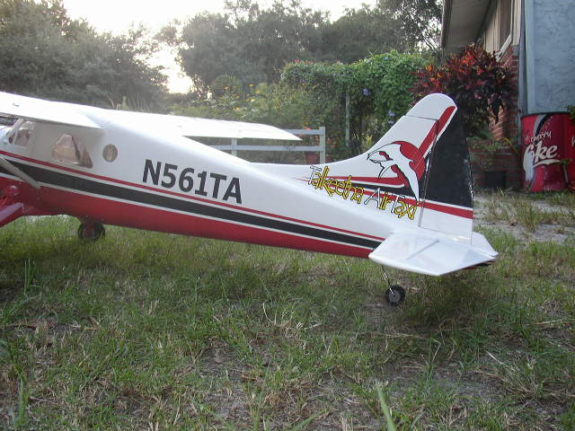

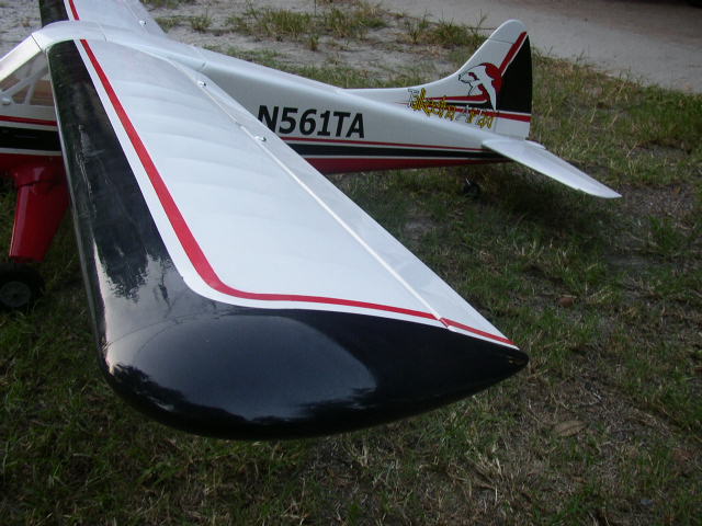

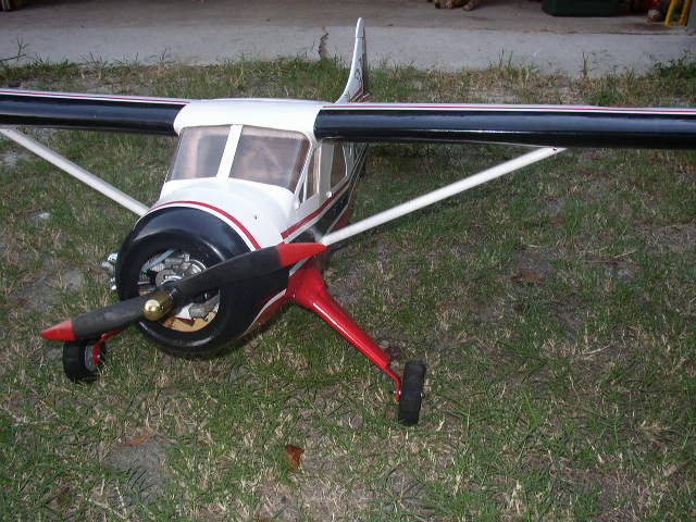

Hi,
Well there were a lot of issues with the ARF that Troy Built did not address directly, only stated they would contact China and let them know about the problems. They offered for me to bring it to the building to look at but given the folks that work there, I may know more than them. I passed.
I have flown it four times and it is very scale in take off, scale flight, and landing is easy. Mine has wheels and I just purchased 5 inch DuBro inflatables. I wanted 6" to match the Tundra buggies in Alaska. I was there for 12 years and rode in plenty of them on land and water. I would have more flights but Hurricane Ida took care of that, wind has been howling. May go out tomorrow.
The only neg. flying characteristic is it tends to high bank, chandelle turn, with little aileron input. For a flatter turn I add about 20% rudder and it goes to scale like turn. Note the cheap foam wheels supplied. Axles broke and bent on first hard turn. Had to replace both.

P.S. I put a Saito 180 in the nose with a stock muffler. It took approximately 2.5 pounds of lead and a Higley monster nut to balance to specs.
It does not struggle. It screams. To get to scale speed I drop the 180 to quarter throttle and fall asleep.
I run 50/50 30% heli fuel and cool power M/V 15%.

Decals: In the pictures above I had a graphic company in Arizona miniturize the same logo for Talkeetna Air Taxi in Talkeetna Alaska. They are the guys who fly Denali (McKinley). They were about $24 and then went online for the N Number about $5 each. I'll try to find the names for you and get back.
Roger

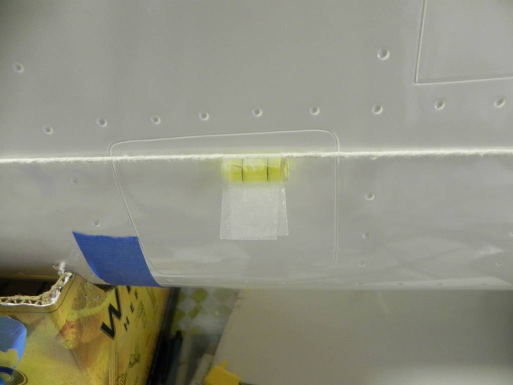

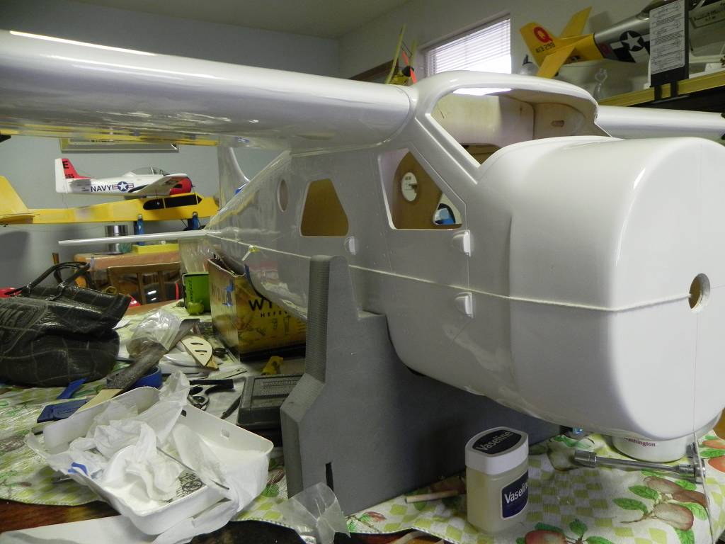

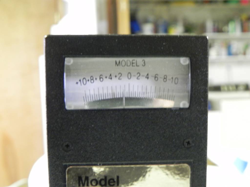

After five pages on this plane, no one has mentioned the Horizontal stab is molded at +1 degree positive incidence. If you used the molded Wing Root template and Matched the Molded wing Root as instructed one will end up with a Positive + 2 0r 3 degrees positive wing incidence. I will fix the Stab and Make it Zero with the leveled fuse. I read one fellow set his wing incidence to +2 degrees. Is this number not too much angle of attack? How about 1 or 1.5 Degrees, this wing is over 2" thick. BlitZ
Old 06-08-2011 | 09:05 PM
  #124
Joined: Nov 2008
Posts: 2
From: East Wenatchee, WA
Default RE: KMP Beaver: Just started, looking for feedback
ok, I'm going to Kit Bash the Crap out of this thing! My next maneuver is to set the wing incidence to 1.5 Degrees.
