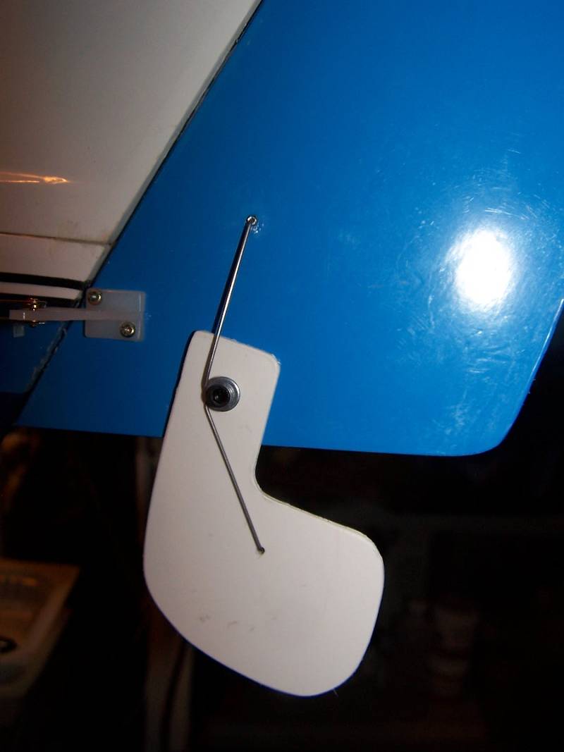

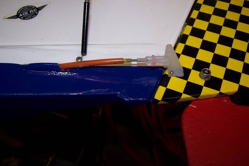

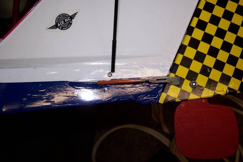

Joe, can you put a picture of you hookup to the rudder. Mine looks a little wierd and seems to bind a bit. Since the rudder is not exactly straight, it seems to be square with the rudder but not with the wire connecting to the servo.
#28
Keth,
Is this what you are looking for?

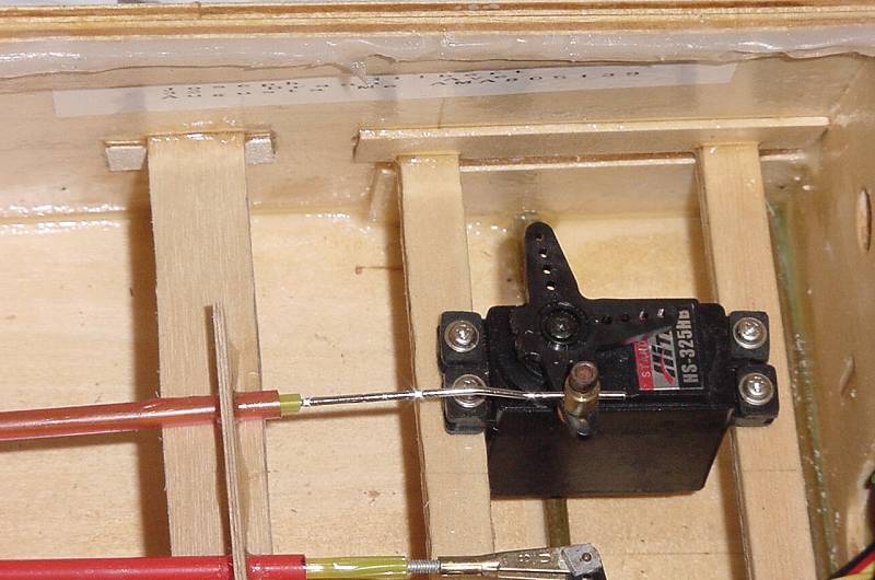

Also is a photo showing reinforcement for the nyrods at the servo end. I found its a must to support the nyrods.
I original bought a TT 46 Pro for this plane and took the 46AX off my Ultrastick and mounted the TT in its place to break it in so there would be no issues float flying. It performed as well as the 46AX on the Ultrastick I left it there and used the AZ for SM. The TT is a good engine.
Joe

Mine looks exactly the same. Had not thought about supporting the nyrods, but that is a very good idea. The rudder when is engaged just makes the hook up look a little out of alignment. But, mine looks exactly like yours.
Thanks for all the help. I will let you know how my first flight goes. Do you have the landing gear hooked up. It is a pain. I am considering not using mine at all.

Still working to finish the seamaster. I have just been flying this spring and I wanted to get some more flying time before I take the Seamaster out. Two questions. The tail brackets are hooked using wood dowels. Do the dowels go through the fuse and then you attach the brackets to the two ends?
How does the spring loaded rudder drop down when you land?

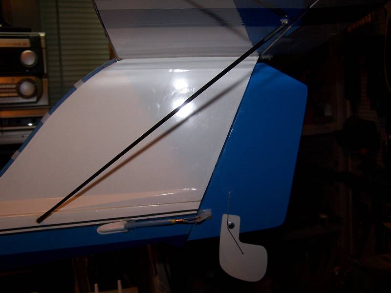

I am putting together another Seamaster now - this one is an electric - and did the tail brackets a bit different. I ran a 1/16 brass rod thru the fuse, CAed in place, bent the ends up for the proper angle, and slid a carbon fiber tube over them. Secured with epoxy and microballons. Seems quite secure. Used a bit different angle. Brass rod also on the horiz stab trailing edge.
The rudder spring is quite flexible - made from thin MW.

Cool. It looks like you tied the rod to the back this time instead of the front or middle. Is that correct?

I did connect the strut to the rear of the horiz stab this time. Another of my flying buddies did that and it looked better.
