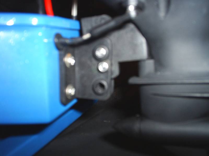

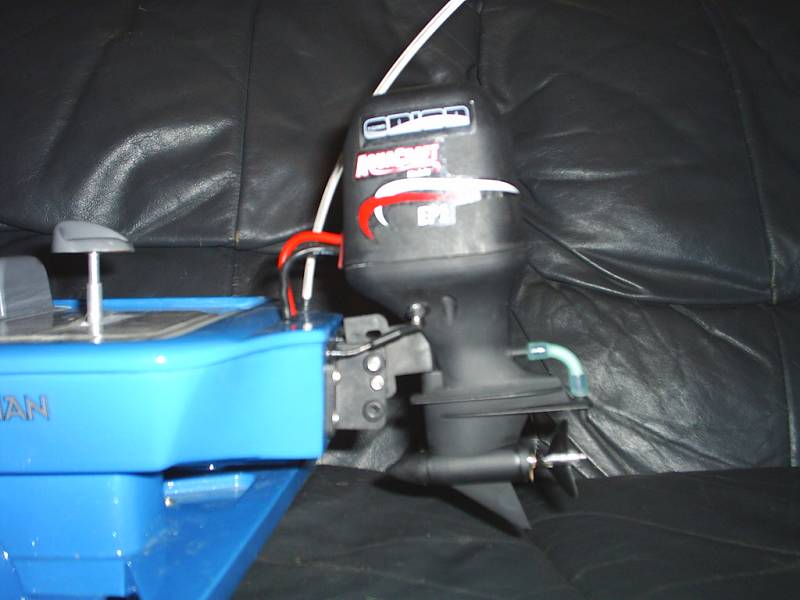

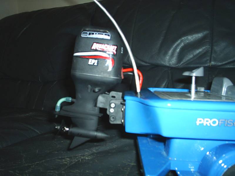

OK, I tried it out with the new motor and it does n't run any better, and it drains a 24mah battery in about 2 minutes. I know something is wrong but I can't figure out what it is. I have since modified the motor mount and have the centerline of the prop shaft just bellow the bottom of the boat. Part of the prop should be out of the water now so it should be able to turn up alot more. Any suggestions? Could it be something to do with the esc? Out of the water it turns up alot more than the stock motor but under a load it seams to turn about the same. Should I get a smaller prop? I have a 1.65"pitch, how small would I have to go?

The motor mount mods made all the diference in the world. The runtime is now about the same as the stock setup. Ironicly, after testing a few different props, with the motor lifted so high, it runs best with the stock prop.
The reason for the handling problems is that in order to acheive maximum lift and minimal drag, the thrust angle and motor hight force the boat out of the water on takeoff. As for handling at speed, I think it has alot to do with the fact that the boat it not build to go fast.

I guess with the motor mount mods the prop is running at or near the surface which works with your new motor which revs higher than the stock. I don't think this would work well with the stock as I find it cavitates very easily already without bringing the prop closer to the surface. The motor revs way up and the boat slows down. I find mine (stock version) handles best with the motor trimmed in slightly and a 7 cell pack for additional weight in the front. The trim is just right - riding on the back section of the hull but without hopping. Anyway I think the hull should be able to handle considerable speed provided enough of it is in the water and the water is calm. Maybe more power (i.e. more cells) is the solution although this would likely require changing the ESC and maybe the motor.

I had the same trouble when the motor was lower in the water. It still cavitates sometimes but for some reason it seam to not cavitate as much. I'd try it with the stock motor if I were you. I'll post some picks in a minute. You will see that even with the mods, it can still be adjusted back to the highest stock settings, but it if doesn't work, it's reversable. As for tearing it down, it's fairly easy to do. I'll run throught it and post a step by step w/ picks a little later.

Here's a couple picks of the old setup
