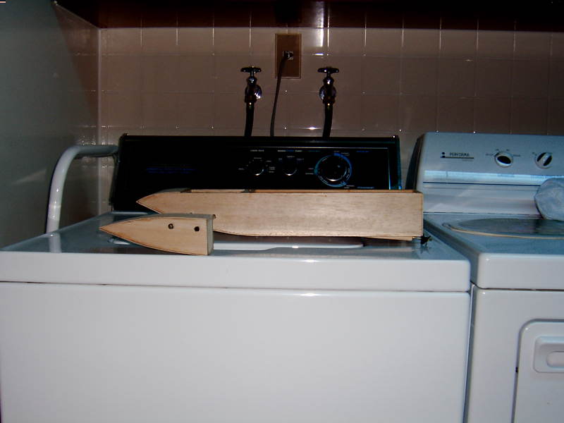

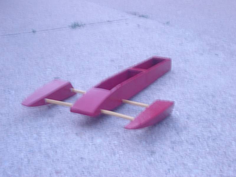

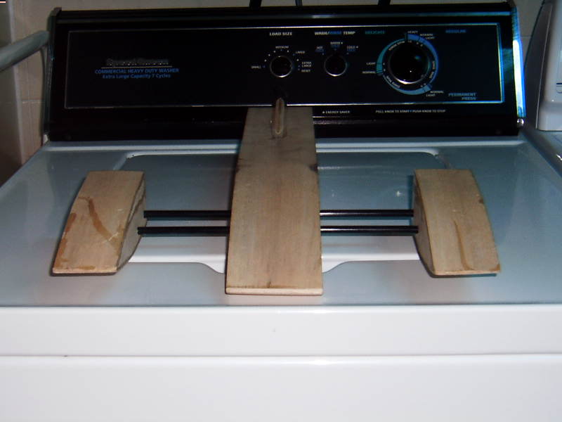

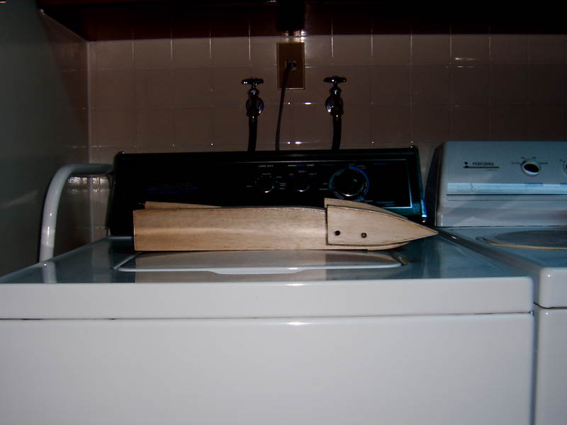

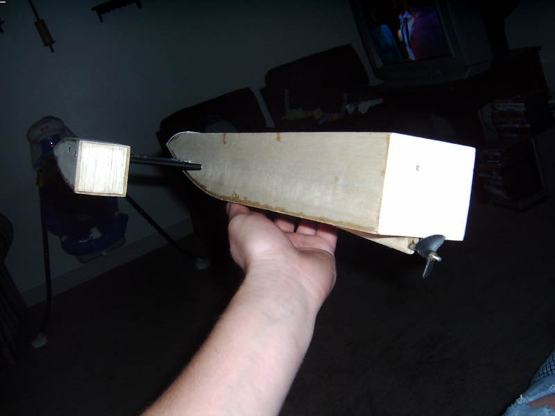

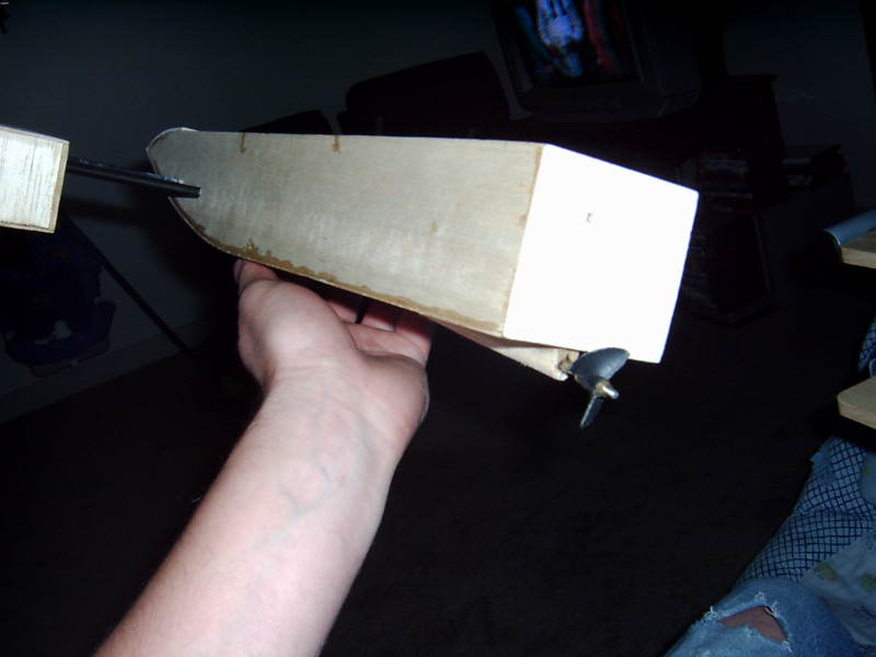

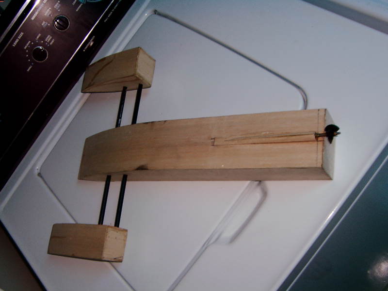

i built this thing to see if i could, but havent finished it. i was initially going to going to make it a straight shaft submerged drive, but i am having second thoughts. should i finish it and change it to surface drive,cut down the freeboard to lighten it, add rear ridepads, and narrow the front sponsons, or buy plans and build a proven design? ill try to post up pics.

keep doing this one it looks great. im building a rigger at the moment too.

is this rendition of an outrigger that bad? should i crush it and put it in my fishin worm garden?

you could make it a ship wreck at the bottom of a large fish tank (haha)
lol its cool
i would try to make every think longer and less crazy angles
there are preditor plans if you want them ?

I built a rigger last month off the predator plans and this is what I ended up with.
http://www.rcuniverse.com/forum/m_4435355/tm.htm
I downloaded the plans off the internet, burned them on a disk, and took them to a local blueprinting shop. They cost like $1.50 a sheet! So needless to say its not going to be the last.
I did have trouble with the sponsons but after a couple of tries they turned out good. If you dont want to cut the sponsons yourself both Blew by you boats and Climate boatworks both have sponson repair kits that come with everything you need to build sponsons that will fit this rigger and are race proven shapes. The climate sponsons are all wood while the bby sponsons are plastic. They dont offer them on there website but just email them for a price.

sure i got a lil bit ahead of myself building this thing with no plans or prior knowledge of building riggers or hydros, do you guys think itll plane out? think the skeg will cause too much cavitation?hmmm, are the sponsons too flat and wide? too much contact with the water?if i put 3/8" shoes on the back, it would effectively be surface drive when on plane, but it being straight shaft, the thrust angle would be pointed down a few degrees..

as i said i have no prior knowledge in building rc boats at all, but plans is definatly the way to go. Alot of the angles are right there and already proven to work very well, plus they are very important. Also having hardware that has an adjustable strut is a must. I have the plans too if you want them. Most blueprint places print the plans in the pdf format they are in, or to can look at them on your computer to get a good idea of a proper rigger. Also you can see what wood to use, mine is 1/8 hardwood and 1/32 and 3/32 liteply.
