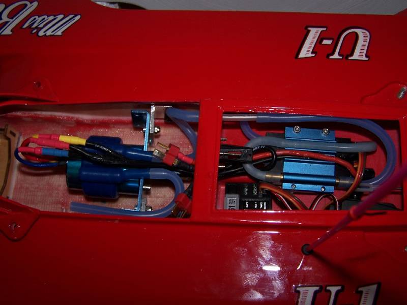

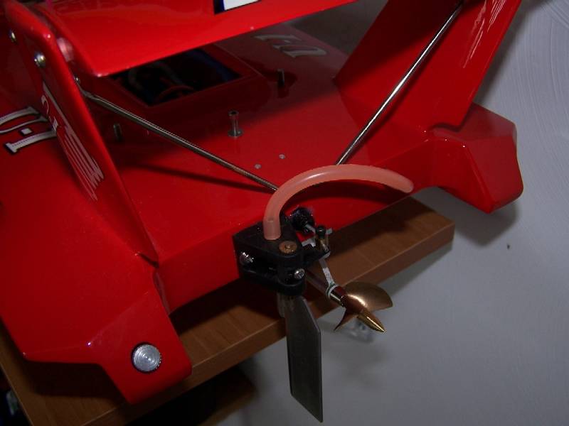

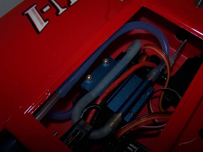

I have completed a conversion to electric.
I used the 1/12 Miss Bud flex shaft hull
Here's a [link=http://www.rcflix.com/photopost/showphoto.php?photo=2727&cat=583]Video[/link] of her run with crappy 1800mAh batts.

There was absolutely NOTHING hard about this conversion. I used the motor mount from a 1/8 miss bud, cut it down, mounted the SV27 motor & mount to it. Bolted it right in. The shaft & rudder are stock. The servo & receiver are where they were intended. The SV27 ESC is with the rest of the elect. and the batts went up front where the gas tank was. The hardest part was making 2 cuts in the aluminum mount from the 1/8 bud, which took me 15 minutes to size, cut, and install.
The SV27 motor is an 1800kv I replaced it with an ammo 2300kv motor, plus I have replaced the 1800mAh batts with EP4200's

Old 06-20-2007 | 10:17 PM
Joined: Feb 2007
Posts: 328
From: Virginia Beach, VA
Default RE: conversion Miss bud
Dirtysouth31 converted his Miss Vegas. It's heavier than my Bud. He runs the ammo motor and 3800mAh. He runs at 28Mph according to his GPS.
I can't wait to see what my lighter Bud will do with the same ammo motor and EP4200's

Old 06-21-2007 | 06:50 AM
Joined: Feb 2007
Posts: 328
I'm sorry Dookie. I wasn't offended at all, I apologize if you thought I was. I guess it was a bad use of capitalization on my part.
Just trying to emphasize how easy the convert was to do. You are right, it does draw attention. I love the fact that it runs quiet & I can run her in just about any lake without having to worry about the gas/nitro restrictions. If after the motor & batt upgrades, all I get is between 29-31 mph, I'm happy with that! Just as long as I beat that darn Vegas!
FYI The batteries were cheap temps anyway. I had to know if the weight in the nose would pose a problem before spending the $$ on good batts.
...almost forgot to mention, I don't have the radio box in there.

Old 06-23-2007 | 07:49 PM
Joined: Feb 2007
Posts: 328
Dirty's Vegas clocked 28mph on his GPS.
My Bud just clocked 37mph on his GPS today!
I got'cha Dirty!
37.2 (garmin e-trex) isn't bad huh Dookie?
