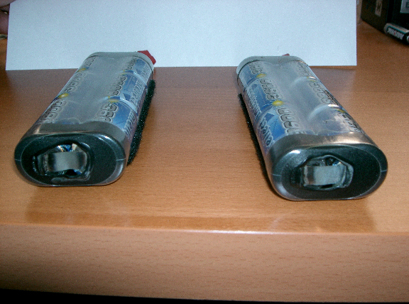

On the topic of IB batteries, here's a pic of the IB 3600 packs I ran the day my motor fried. They were brand new stick packs on their first charge. I knew the puny tabs connecting them might get a little warm, but this is ridiculous. Those packs had a hell of a punch, I'm sure the extra voltage they dumped out was part or the reason the motor got so hot. Imagine what 7 cell IB packs would have done!
I have since soldered them into side by side packs with deans bars, and heavier gauge wire.

That is probably the best justification for upgrading to Deans 12g wire and real connector bars on your packs.

Rooski[sm=thumbup.gif] That is exactly why I don't like stick packs. I always run flat side by side packs with good battery bars and 12awg wires and deans connectors. Especially on high amp draw applications.
PS aren't those the intellect cells? I didn't know those were the IB cells

YEp, those are Intellect IB 4200 Cells

Wait a minute. I was under the impression that Intellect Battery cells were IB cells. I don't think they are. IB 4200's are made by Epic. They have a white label with IB in big black letters.
Either way, those Intellect 3600's had all the power I need...the boat just flew with them.
So the touchy IB 4200's you guys are talking about are not Intellect cells right? In other words, I don't have to tiptoe around while charging these.

I do stand corrected. Your are 3600's. The ones on Steven site how ever are IB 4200's I really don't hink it make a differance but they are really nice cells

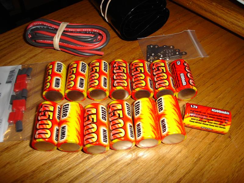

I also bought 14cells of these new 4500's. They should arrive Sat or Monday.
I will be building them side/side with bars and 12ga leads.
I use Astroflite 112D chargers $130. I charge my 4x 6c-GP3300's at the same time @50min at 4.5A.
Breaking them in:
1- Slow charge @2A until peaked, wait 2 hrs then discharged @1.5A down to 0.90v/cell. Then wait 60 minutes.
2- Slow charge @2A until peaked, wait 2 hrs then discharged @1.5A down to 0.90v/cell. Then wait 60 minutes.
3- Slow charge @3.5 A until peaked, wait 2 hrs then discharged @1.5A down to 0.90v/cell. Then wait 60 minutes.
4- Slow charge @4.5 A until peaked, wait 2 hrs then discharged @1.5A down to 0.90v/cell.
I will post the numbers after the initial 4 break-in cycles.
Then posting 10 "Real world numbers" gained in my SV27 with cooling mods and worked Prather Bronze 220 2-bladed prop.. Charge at 4.5A and run them twice a day, at least 2hrs between charging from 1st run.
-WL

They read as 3A slow/6A fast WOOT!!!!! Means low internal resistance= lots of power R-R-R [8D]
Making the packs after dinner......... and start the break-in process.
-WL

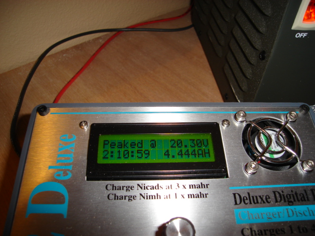

The break-in has started. This is 1st charge at 2A.

Nice packs. I'm bet they'll be awsome. tell us how they are.

1) 1st Charge at 2A
2) 1st Discharge 1A
3) 2nd Charge at 4A
4) 2nd Discharge 1A
5) 3rd Charge at 5A
-Charging 3rd cycle @5A now.....
-WL

it took 4 hours to discharge !!

That is a NICE charger. I was looking for a better than average charger after being gone for a few years, and that one looks awesome! Forty cells off of 12v? Wow. Can you get it to cycle packs automatically?

Nope, buy a Trition2, or 2 would be great ... once they are in stock at TowerHobbies, I'll order 1 myself.
But I had the 112D from my airplane days, it's still a good buy at $130 and goes up to 8A&40cells
-WL

After 3 cycles it shows @4250mah average down to 0.90v/cell usable capacity. Will see if they wake up a little once they see 40-50A and 6A charges.
Once my Watt's Up meter arrives, I'll make an adjustable discharge system to do from 5A-50A.
-WL

Nice pic, Waterlogged. And yes that is a nice charger. I want t Triton2 but that is nice. and again I like the way you did the pic.
