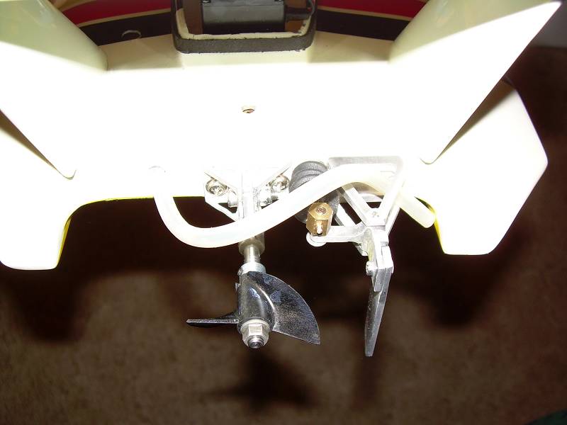

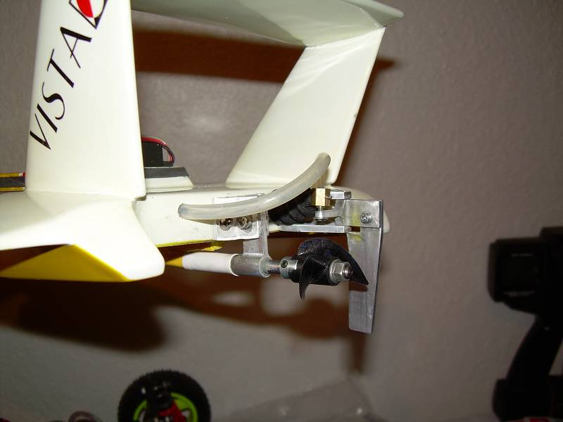

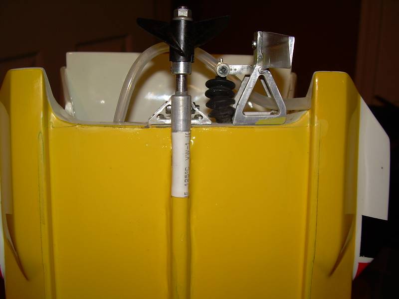

Done,but not run...yet.Anyways ,here it is with 130 flex,and mini strut and rudder from mhz,graupner speed 600 race and jetti 600 navy,should be fun with 36mm prop.Almost forgot to mention,I had to rip out the stuffing tube and put in a bigger one to accept the 130 and teflon sleeve,also to bend out the subsurface drive angle and get the proper surface drive angle,worked out great.,and will probably be real fast,now I need a turn fin...
