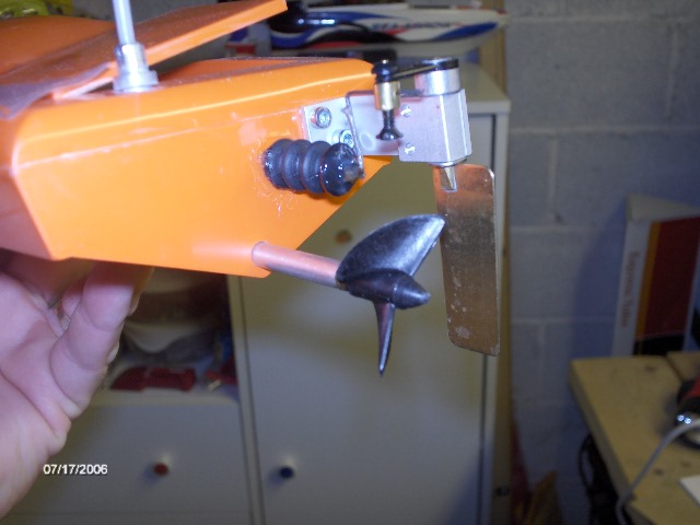

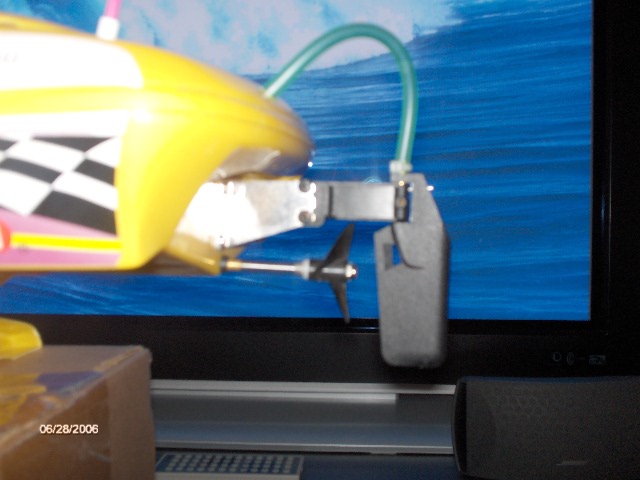

Yes, that would be correct as long as you want it to turn equally boat ways. Or you can put the rudder off to the side but it will turn better one way that the other. You can get the Stock Rudder for the aquajet from offshoreelectrics.com it will work perfect for your application. You only have to clear the prop by 1/4". I was amazed when I saw the aquajet for the first time. The rudder was so close to the prop I thought it would hit for sure. Here is a couple of pics of different set-ups. You are also going to need a longer shaft because the stock one is not going to be long enough.

Thanks wheelnut! So now a longer prop shaft, and a rudder long enough to clear the prop? Any other parts i will need to complete this? Also i wanna upgrade to a medal prop, would the x440 but a good one over stock and how many blades? Im thinking a rudder like [link=http://www.offshoreelectrics.com/proddetail.php?prod=ros-mini-rud]this one[/link] with the 2 inch setback or [link=http://www.offshoreelectrics.com/proddetail.php?prod=ros-rud-dualpu]one like this[/link]with a 2 inch setback. Im thinking the first one will be best. I want my boat to turn equally both ways, so i will mount it behind the prop! Also do you think some turn fins would be necesseary for stock? Im gonna run this boat stock for a while with electronics anyways! Well thanks in advance!

I don't think that rudder will be set back far enough at 2" and 4" seems like too much. The aquajet rudder titled
Product ID: ose-bj10-bj11
Rudder with standoff bracket
$8.99
is set back 2 1/2" and seems to be perfect for the application.
As far as props go you will have to do some experimenting. Start off with the stock prop and see how she runs and what the temps are like, Then prop up from there. Turn fins are not necessary but can help the ride of the boat out alot and they can be had pretty cheap.
