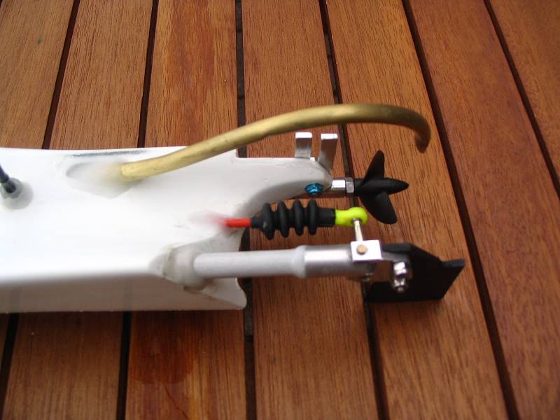

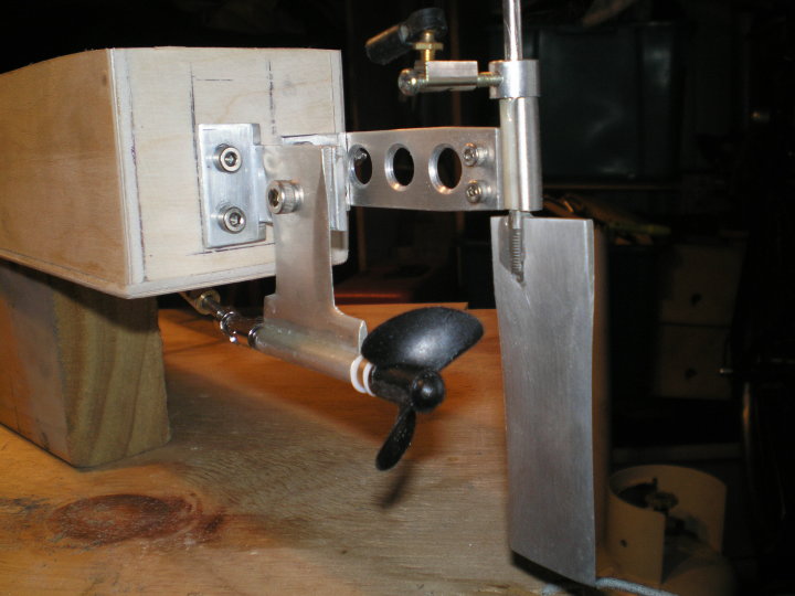

o.k ….. progress report !!
I have now made the running gear that I will need for this little boat.
Yes, made!! 3 days in my shed with a set of files, a hack saw and a bench top drill-press………oh and heaps of sandpaper.
With a few bits of alloy extrusion, tube and a piece of 4mm stainless rod,
I have produced a rear strut and mount, a rudder on a long offset mount and the shaft(s) complete with a motor to shaft coupler.
I am running a uni from the hull shaft to the strut as this is much cheaper than getting flex and couplers etc.
Photos to come soon.

Simon your uni joint version sounds great, what will be the approximate angle between hull shaft and prop shaft? Could you post any fotos of the uni joint,strut, rudder etc? I might try this option too, since I have in my spares a little Graupner universal joint.

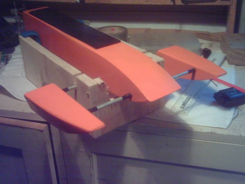

Huge progress today, it was raining all day !!
Pics of progress so far.
There are pics of how I chose to mount the tubes in the main hull and sponsons.
I am running ¼” thin wall alloy tube to join the sponsons to the hull. This is a sliding fit inside the mounted tubes.
Yes I know that there are no outer skins on the sponsons, that is because I ran out of good wood adhesive, we will go to the hardware store tomorrow to sort that out. That is the bonus of the Big Red Truck is that we can park outside any store we want.
I have made a water coil and pick up for the motor but am as yet undecided as to whether to use it. I have started another thread on this issue.
I need to wait a day or two before I can begin painting as the weather here is very damp and cold. The rest of the station would object to me using the drying room as a spray booth.
Once it is painted I will take it to the local pharmacy who has very accurate scales and weigh it: Hull only and hull + running gear inc motor battery radio rx etc.
i.e. Bare weight and ready to run weight.
My 6yo Daughter has some interesting suggestions for a colour scheme and my Wife agrees, o.k so do I !!

Wow Simon that is some beautiful metal working job! Have you operated your drivetrain out of the water to check for vibration? But I guess it should be alright, everything looks stiff and strong.
Is your strut made from one piece aluminum, worked using just files and a drill? It looks great, as if it were a machined part.
Have you checked the C.G. position? You might need to place the batteries to the extreme front (even touching the front sponson mounting tube!) to get this right. so maybe you could do a trial component and battery fit to check it out, I couldn't believe I had to push my cells so far to the front (in fact bury them in the hull

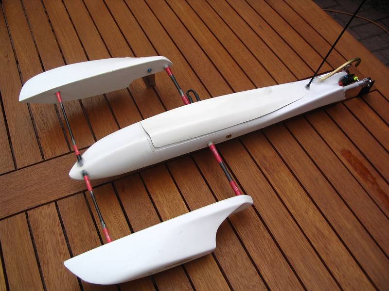

Hi,

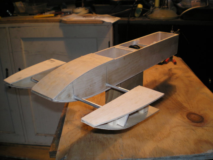

I just finished my Lindenau Executive H1 rigger and does it fly baby , yeah !!!
Right now there's a Feigao 380/6 in it but I ordered a Lehner 1535/6 wich should take it over the 60Mph barrier on 7 cells.
Enjoy.

ORIGINAL: andreasturb
)I have done a dry run and there is minimal vibration, not none but not enough to worry me.
CoG is a bit of an issue at the moment and you are right, i do have to post the battery pack all the way under the foredeck up to the forward sponson tube.
It now has a coat of filler/primer on it and I will start on the topcoat tomorrow, we are all going out to the hardware store to choose the paint colour.
I just want this thing to get up on three ponts as intended and to spit a nice big rooster tail in the process.
No fliping
No rolling
No sinking [X(]

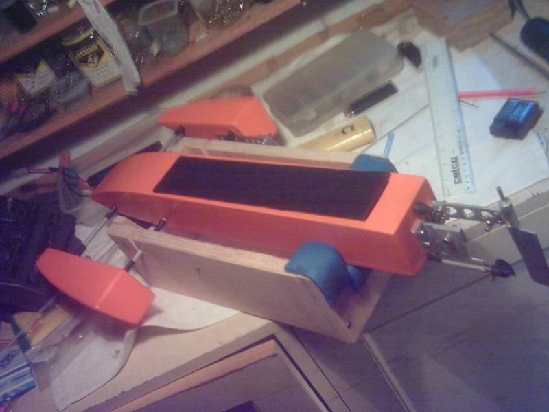

Here are a couple of pics of it sitting in its cradle ready for a final
electrical fit out. The esc should arrive tomorrow, it is a Great Planes Electrifly C30, 30A fwd only
I will give it a go in this boat and if it is not the go then I will swap it out with the 60A fwd/Rev unit that is in my development mono.
Having fwd only is going to be new to me !!
The plan at the moment is to run it and see if it will lift its tail up without the aid of rear sponsons.
I have set the forward sponsons wide for stability in the turns and may narrow them later.
I see no relationship between sponson to hull gap and straight line speed. If anyone wants to throw an opinion in here please do.

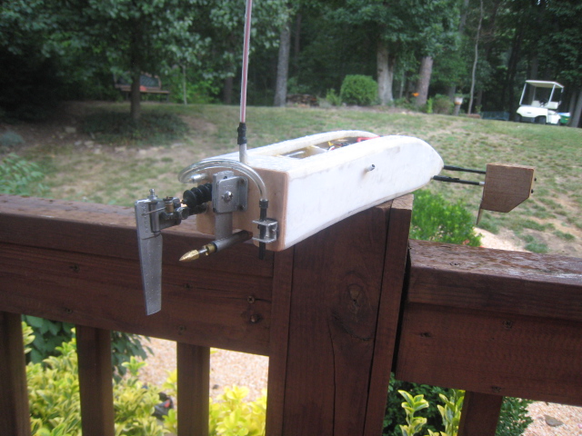

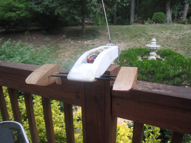

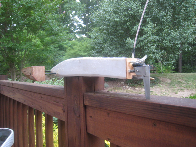

looks great simon, you have really came a long way with it. heres one that i built out of 5mm styro, then covered it with real thin cloth and epoxy. the rear sponsons made mine faster on the one before this, so i built them right into the hull on this one. im using an outrunner on this and water cooling the base by having my motor mount go right through the hull and exposed to the water. that square piece is the alum that you see in the pic of the bottom. these outriggers are fun, no matter how you make them.
good luck.
john

I ran it today with two different props.
35x1.4 = 35mm dia x 49mm pitch converts to 1.4” x 1.9”
40x1.4 = 40mm dia x 56mm pitch converts to 1.6” x 2.2”
Wit the smaller prop not a lot happened. [
Once I put the bigger prop on a few things began to show.
I had fitted a set of rear sponsons or ride shoes. This helped to lift the rear up.
I think that the trial ride shoes were a little deep as the nose went down at full power.
I pulled the ride shoes off as they were only taped on and I found that the 40mm prop had close to enough lift to get the little boat up on the plane as it is supposed to.
I have now made a set of less aggressive rear ride shoes / sponsons / lift pads, F-it call them what we want, and I will trial them in the morning.
I have gone back to another pond that is closer and has no wind thieves [>:] so I have all the water to myself.
]Once I put the bigger prop on a few things began to show.
