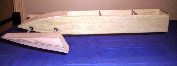

Hi guys
Please find my progress so far on my first rigger. Im looking forward to order the hardware next week from offshore electric. Actually i will test with a magnetic mayhem motor first , then go with a brushless motor.
Planning to order the following
Octura Coupler Flex Hex 5mm to .130 Cable
dh-kstubing K & S Brass Tubing tubing size: - 7/32" Diameter pn#130
cen-g82108 Cen Standard Servo
grp-2317.40 Graupner K Series 40mm
ros-21-strut Speedmaster 21 Strut
Round or Flat Bottom Strut?: - Flat Bottom Style -
dh-100 Pushrod Seals
Is that going to be ok, btw no cheap rudder in stock [:@] any ideas
