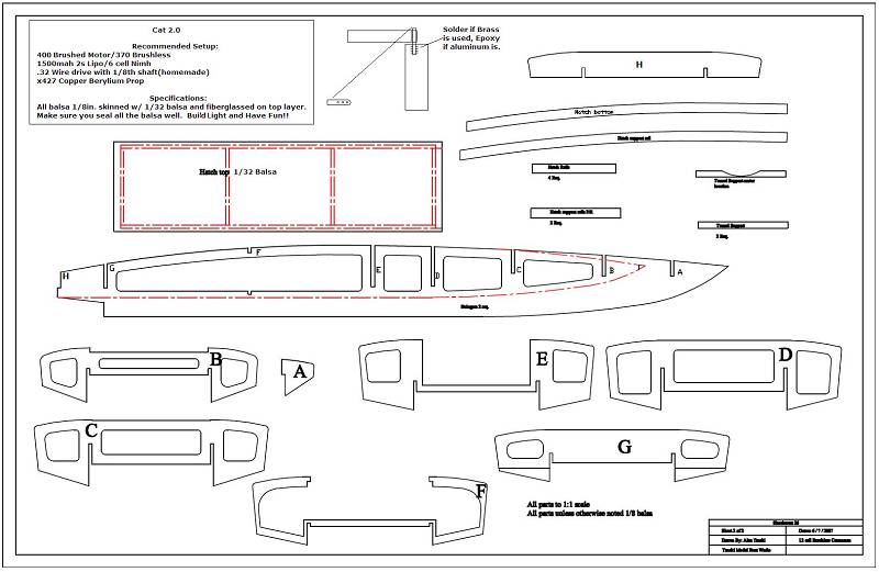

Im building one too, i modded it a bit and its a bit smaller, ill post a pic of the modded plans

Remarkably similar to mine. Intresteing. I'd start a second thread when you begin building. I'm not kicking you out of mine but it would be really confusing. I'll be following closely whatever you post.

Ok ya i will start a new thread. It is your hull, just modded, There arent any steps in mine(Easier) and it has a widened tunnel and i also changed the back end and added and "h" bulkhead so it wont be rounded.

I saw that H. I'm probaby taking the rounded corners out of mine too but in a differnet way. DId you modify the drawings?
Old 03-12-2008 | 02:02 PM
  #35
Joined: Nov 2006
Posts: 1,299
From: Hudsonville, MI
Default RE: Scratch Build - 29" Balsa Stepped Cat
Not too much. The main parts are the same except no steps. Would you like me to send you some? pm me your e-mail if so.

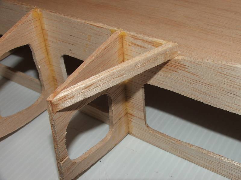

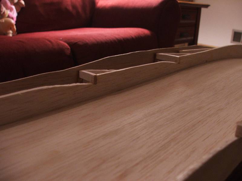

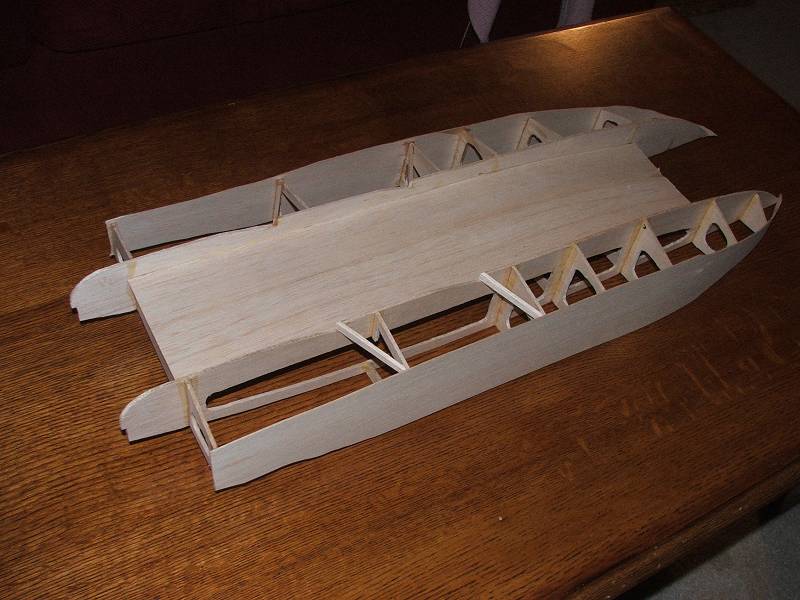

Need help:
Scratch builders; Is one form of CA glue better than another for bonding balsa? I had a bottle of crazy glue (with the little squeeze buttons on the side) and it bonded fast. Not so fast that I couldn't slide the parts together but about as fast as I like, and seems pretty strong. Well as small tubes do it gave up the ghost when I was on a roll. I happened to have a 3 or 4 pack of some other super glue that I bought on the close out rack at Ace one day. Any way I'd swear I was working with water. It will eventually bite but it doesn't seem the same. (still works on my fingers)[&:] Am I nutz? Is there a big diff from one brand to another? Is there a preferred brand for doing this kind of work? I'd appreciate some advice, although I'm probably done for the night. thanks
Old 03-17-2008 | 09:36 PM
  #44
ryan_t888's Avatar
Joined: Jul 2005
Posts: 5,524
Received 6 Likes on 6 Posts
From: Hamilton, ON, CANADA
Scott,
I prefer thick CA as soft wood, especially balsa, tends to soak in most of it. If it soaks in, it doesn't work as glue. Sometimes I would have to apply a thin coat to let it soak in, and then another to glue my parts together.
Ryan
Old 03-18-2008 | 04:29 AM
  #45
SV27dayton's Avatar
Joined: Dec 2006
Posts: 2,302
From: Centerville, OH
Yea I tried that. Second coat wasn't much more successful. So you recommend the gell type. I like using that stuff anyway. I'll pick up some of that.
Old 03-18-2008 | 07:09 AM
  #46
CadillacDTS2001's Avatar
Joined: Oct 2005
Posts: 6,449
From: Tottenham/Orillia, ON, CANADA
for wood boats the best is to tack it together with CA.... TACK IT and then tack the bottom skin on and then take a small paint brush. with some wood glue and glob it on the joints and work it in...... VERY strong!!! he sure to get the water proof kind
Old 03-18-2008 | 11:16 AM
  #47
SV27dayton's Avatar
Joined: Dec 2006
Posts: 2,302
waterproof wood glue? Also do you have a prefrence on the type of CA. You can't tack if it don't get tacky.[:@] I think I like the paint brush idea.
Old 03-19-2008 | 09:33 PM
  #48
SV27dayton's Avatar
Joined: Dec 2006
Posts: 2,302
Update. I've put the skin in the tunnel and on the sides. I'm going to use a sanding block to get it down to the frame in the propper shape. Then I'll carve the outside of the step into that and then put the bottoms on int three pieces/side due to the steps. LHS had some good "medium" CA glue that's working better for me. Still weighs less than a quarter pounder with cheese

make sure the sanding block is LONG that way it can ride on the frames and you will get a perfect edge that matches the height of the frames.
