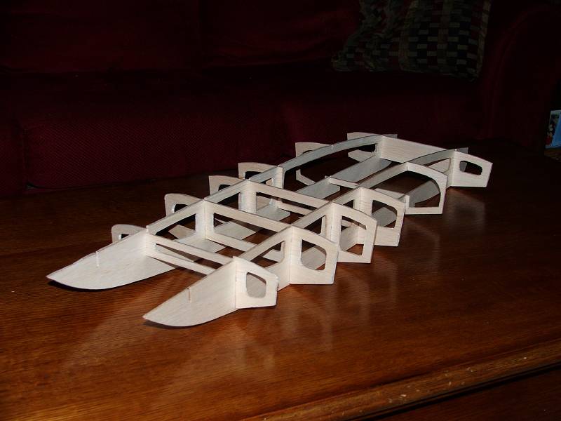

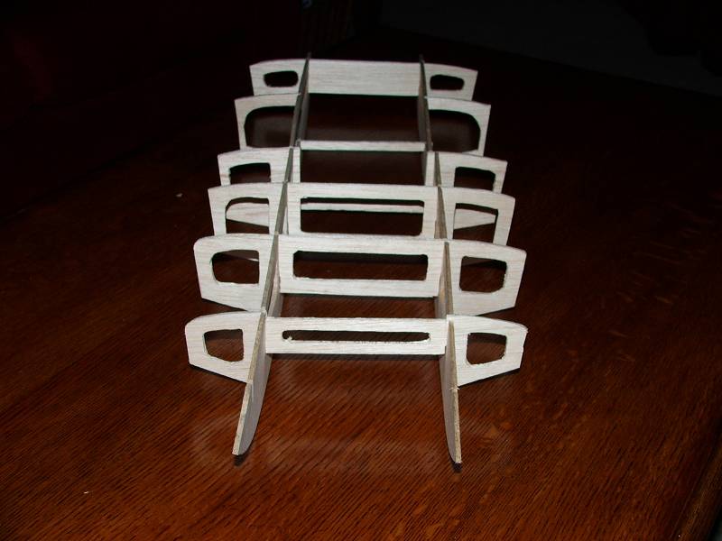

Well since everyones complaining that the forum is dead, I figured I'd begin posting on my current (1st) build project. I saw a post here about a year ago about a balsa cat and couldn't forget about it. "Shockerman" designed the original one based on picture of a full sized Callan Marine boat. There's a great build thread on RRR. Ive increased the size from 26 to 29 inches, full scale and then added about another inch to the width of the tunnel. The boat will be about 29" without the running hardware. Right now I plan on skinning it like he did with 1/32 balsa under 1/64 ply and then coating it with urathane. Power will come from a 9XL through a hydra 120 to a standard flex drive and either fullers or SM hardware. I'll start testing on 12 cells with likely a 637. I'm thinking of making some changes and puttin the rudder on a pylon further back and directly behind the prop. Any advice or feedback is welcome.
Word of warning I have a lot of other things on my plate so this one will require some patience for all of us.
Dayton

Same here, how hard can it be?[&:]. I'll tell you what I did but I won't garuntee that it's the best way. I think it's all a matter of stregnth vs. weight, but I have a feeling that this boat will be strong and light by comparison any way I do it. The question is to I want to copromise weight for stregnth or stregnth for weight? I think I'll go farily conservative and keep it pretty stout. I still need to do some research before I apply the second layer of wood.

They do look the same. Yours was cut with a laser and mine with a scalpel. That would have been faster. I'd have tried to cut it on our abrasive waterjet but as you know I only have the prints. Did you get that from Shock? Did you widen the tunnel on yours? I bought some additional supplies this weekend, but no progress as of yet. I'd say I think about it for at least 1/2 hr a day but no action right now.

no i did it my self. its not hard when you are good at cad.
i did widen the tunnel and did a bit of changes to the sponons

Next "step" no pun intended is to put a 1/32 skin of balsa over the all the bottom surfaces. I plan to start with the tunnel and then the bottoms of the sponsons followed by the sides. Then I'll urathane the interior, add foam and then do the top. Then repeat with 1/64 ply, and urathane the outside. Im not sure how I'm going to bond the ply to the balsa but I'm going to try to cross the grain as much as possible to increase the stregnth.
